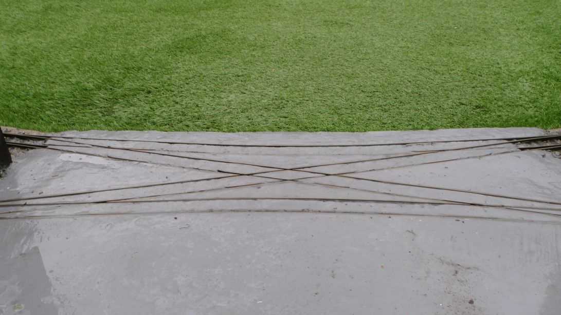

Here's my contribution.
I'm not telling anyone how to do it, but what I did and what works for me:-
[attachment=0]MR190712-001.jpg[/attachment]
The patio step is the main access for washing line (crucial!) and steam-up meetings etc.
[attachment=1]MR190712-002.jpg[/attachment]
Yes, it was raining this morning!
[attachment=2]MR190712-003.jpg[/attachment]
The astro turf shows there is no need to drag a mower over the track, but the wheelie bin makes the crossing for veggie bashing.
After 4 years, it's standing up well.
Best to move the points apart so the moving bits are clear of the concrete.
The fine detail around the frogs etc is "enhanced" with Isopon filler.

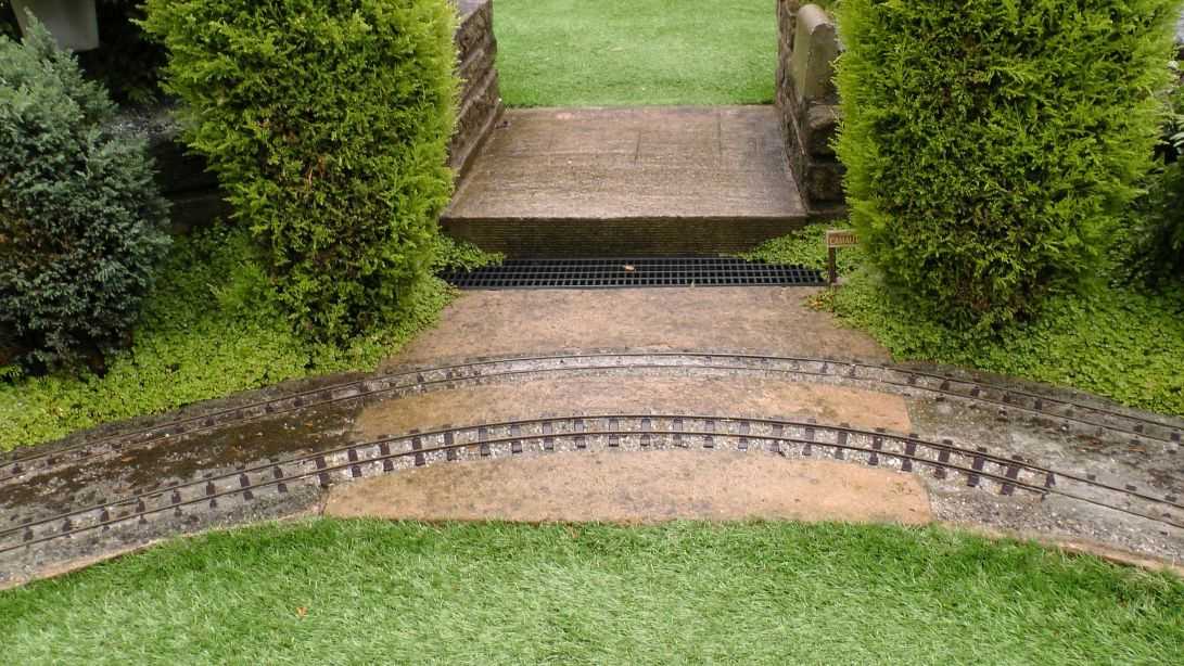

On the other side of the grass:-
[attachment=3]MR190712-004.jpg[/attachment]
This step was cast in situ, and the nearer track had to be lifted and re-levelled some time later.
It all seems to stand up to walking over it.
