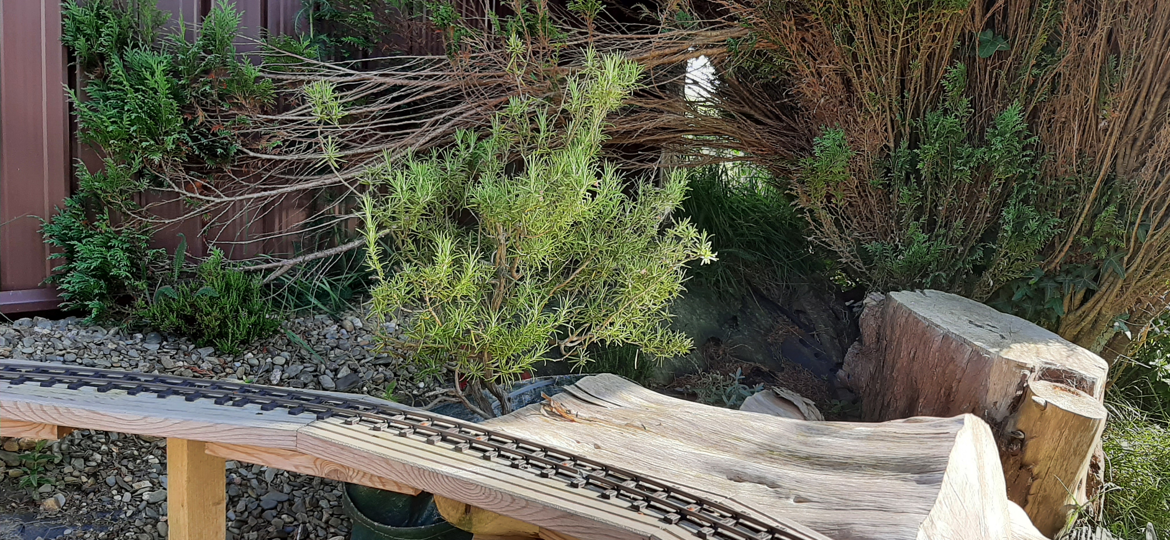

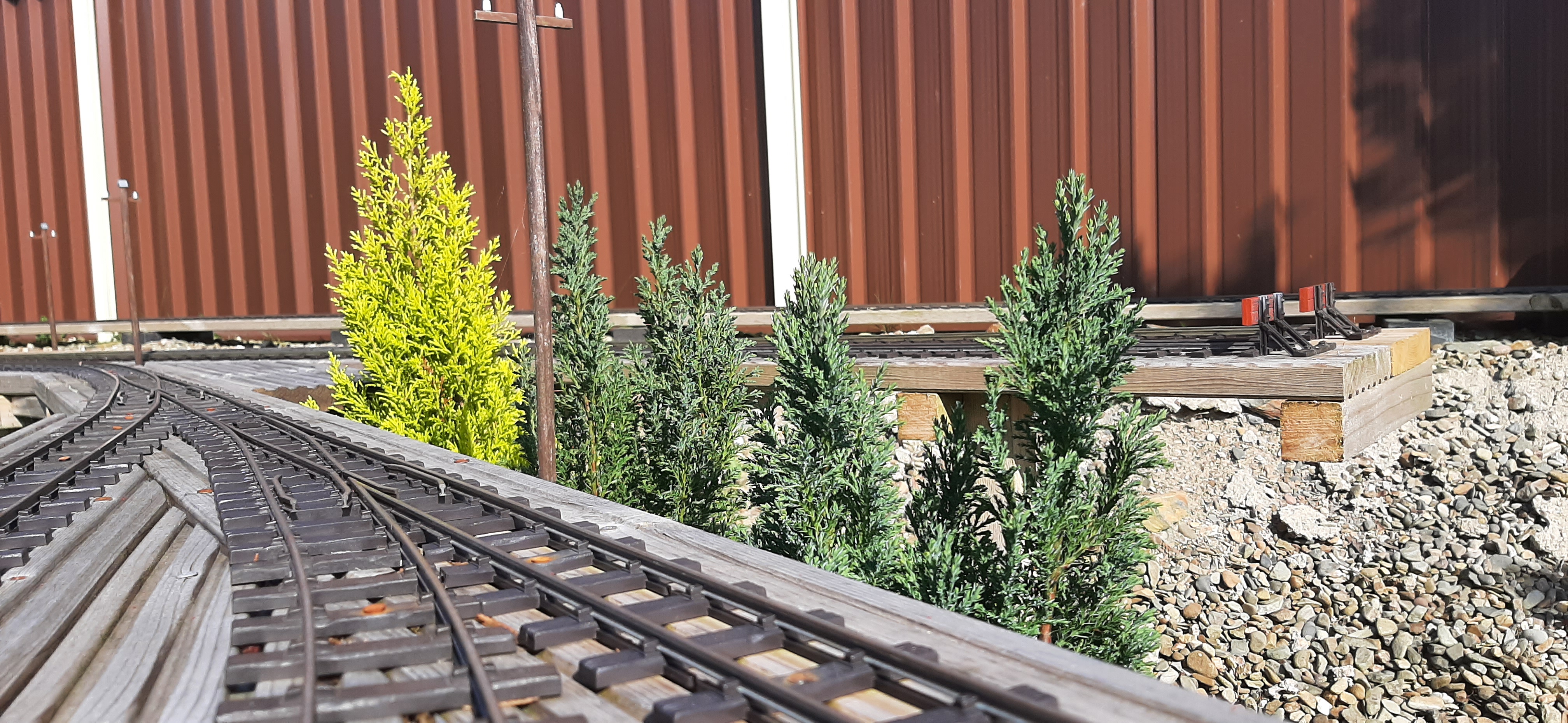

Scenery on the line is developing using various evergreens which are pot bound and a discarded windswept rosemary bush placed line side. The shrubbery on the curve helps to hide the fact that the line is a tail chaser.

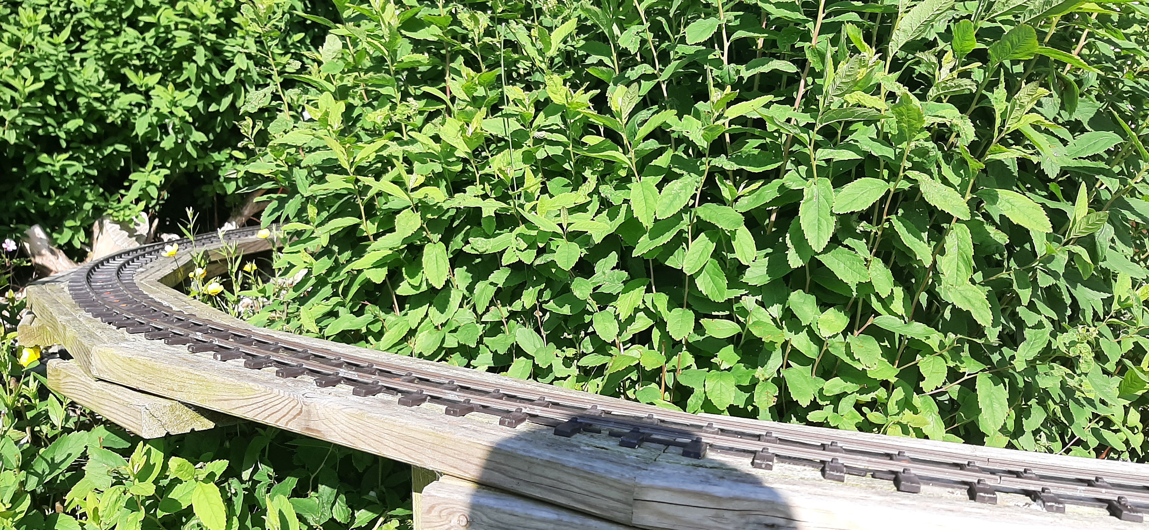

Scenic break.
Scenic break
Scenic break

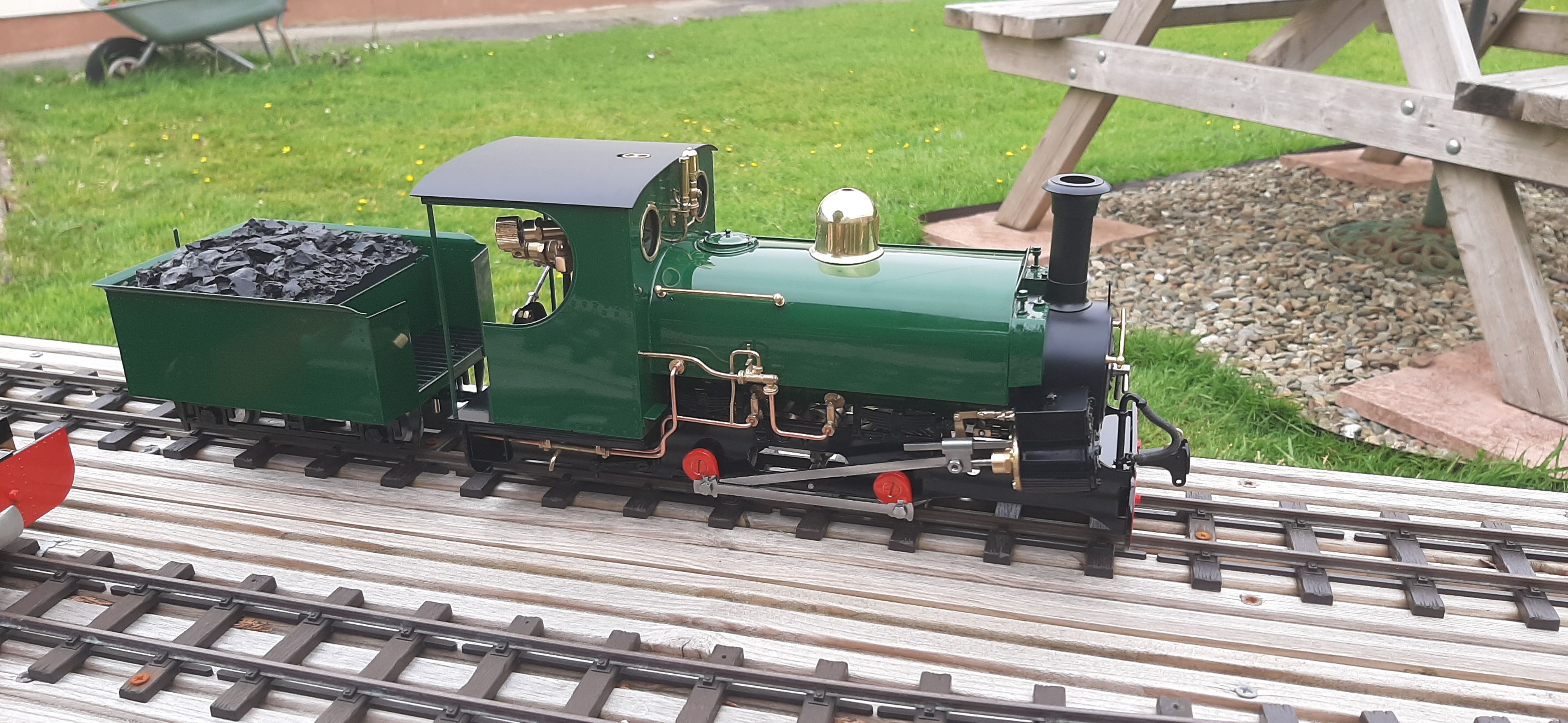

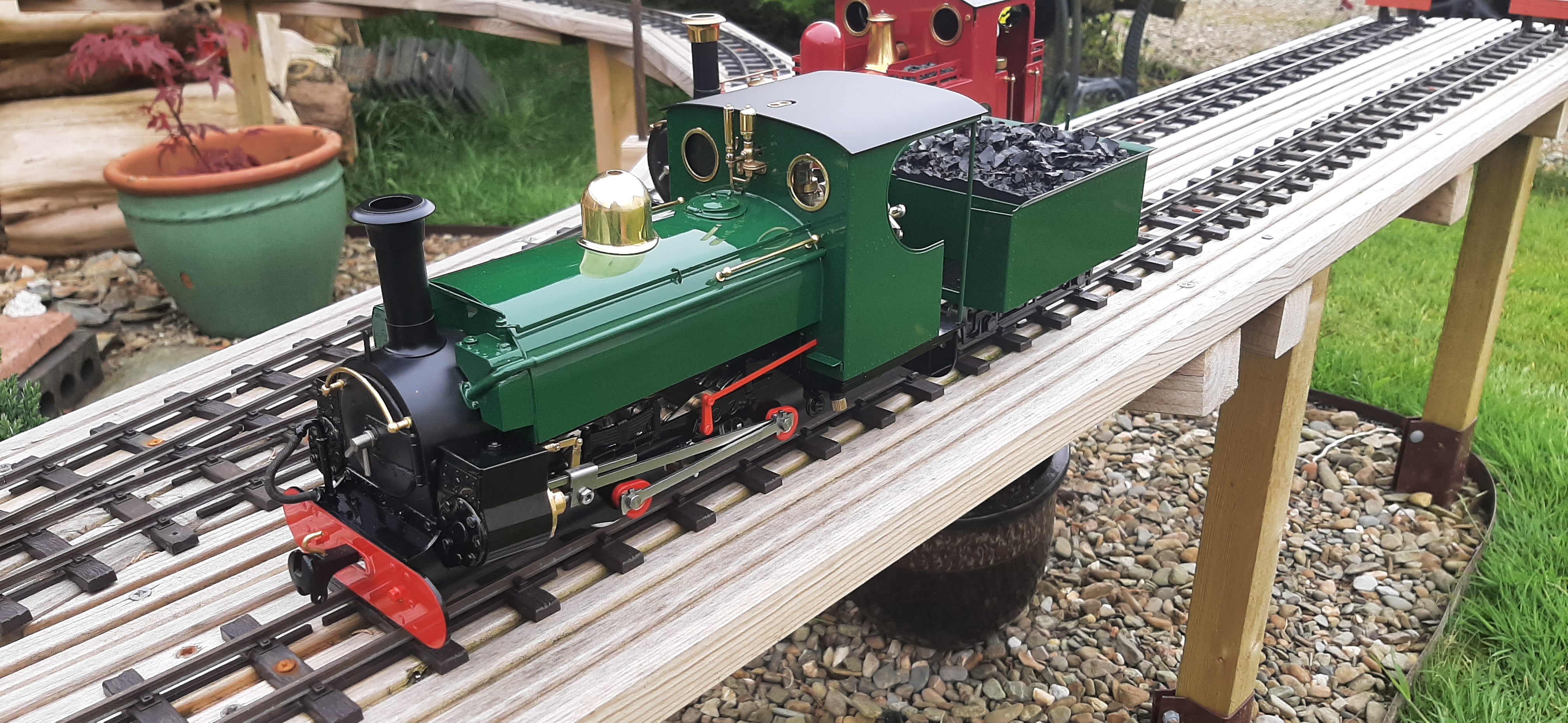

Lady Anne's new running mate Linda arrived today . Hopefully Linda will be a lasting Soulmate as Dylan steamed off in a huff. This is my first Fosworks controlled and first water top up loco so a bit of practice is on the books.

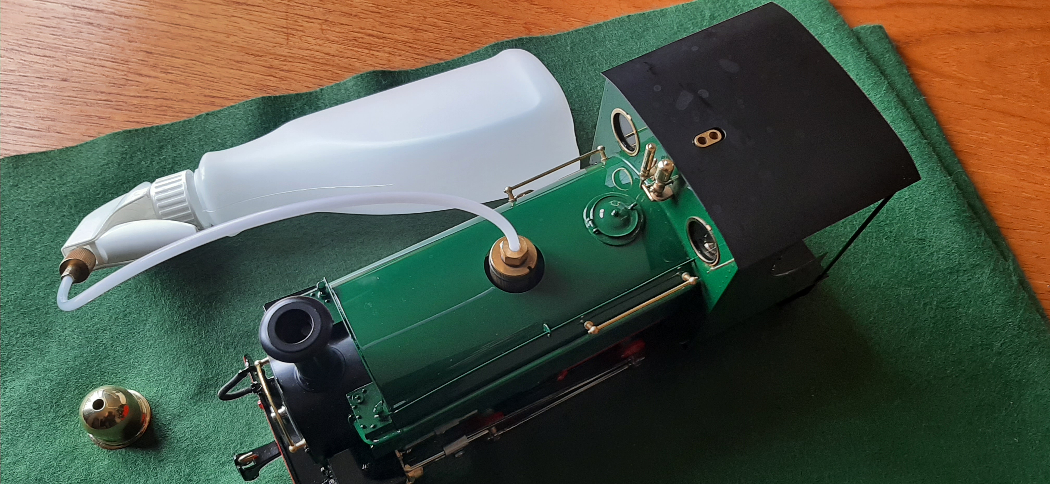

After Running Linda for the first time I now know Why there is a sight glass and a water top up facility on the loco .The boiler capacity is much smaller than my Lady Anne and my previous loco Dylan. Normally once the gas has run out there is about 80ml left in the boiler, a sort of fail safe. But I noticed after approx 15 mins of running the level in the sight glass was very low so I turned the gas off. I didn't have the supplied top up bottle at hand. The boiler can be topped up via a non return valve fitted in the brass boiler plug. which is under the brass dome.

Post by Preseli Chris » Sat Jun 29, 2024 4:18 pm
Like this.

Preseli Chris wrote: Sat Jun 29, 2024 4:08 pm The boiler can be topped up via a non return valve fitted in the brass boiler plug. which is under the brass dome.
Ah! That sounds like the same system I have on my Regner Challoner. Not being a steamie, I assumed all live steam locos were similarly equipped. Does that mean that without it, you have to release steam pressure in the boiler to top it up?

The top up system acts like an injector. Without it one has to let the pressure drop and cool down before replenishing. The Reger locos are very good .I almost bought one recently it was at a very tempting price . I like the way they are low geared.
