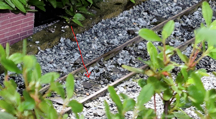

Hydrostatic Dazza wrote: Fri Oct 27, 2017 9:32 pm I wish there was a way to hide, lose or disguise the screw heads fixing down the track. I will have to use stainless steel screws as steel here will be rust dust in 12 months.
Try brass ( not plated) screws. Within a few months they weather down to a brownish yucky colour that disappears against the brown plastic sleepers. Countersunk are best but even roundheads become almost unnoticeable.

Snipped, philipy, "Try brass ( not plated) screws. Within a few months they weather down to a brownish yucky colour that disappears against the brown plastic sleepers. Countersunk are best but even roundheads become almost unnoticeable."
Peco SM32 sleepers are hollowed out underneath, so the counter sink would have to be shallow. #4 G screw might work. I will get some samples and have a gander. At the moment I have sample #6 round head stainless.
