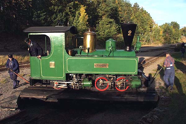

Never thought I'd see an 0-4-2-0T...
Big Maple & Little Oak RR
Posts: 1142
Post by Old Man Aaron » Thu Dec 14, 2023 11:53 pm
dudeface wrote: Thu Dec 14, 2023 2:08 pm Never thought I'd see an 0-4-2-0T...
Look closer, it's an 0-4-4-0T. Looks like a Decauville? Would be well at home on your line, Rik. 8)
And I thought your Leader was huge, Bertie. :salute:
dudeface
Posts: 402
Location: Southern Wisconsin
Post by dudeface » Fri Dec 15, 2023 12:00 am
Ah, I see. I thought it was a modified 0-4-2T.
Posts: 839
Post by drewzero1 » Fri Dec 15, 2023 12:03 am
Look again, there's another drive wheel hiding behind the rear cylinder! All those rods and levers make me a little dizzy. :shock:

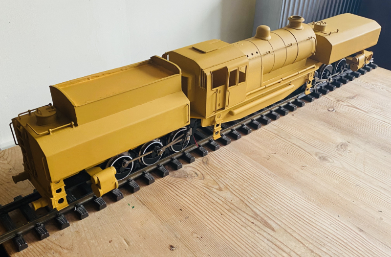

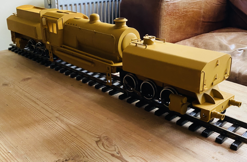

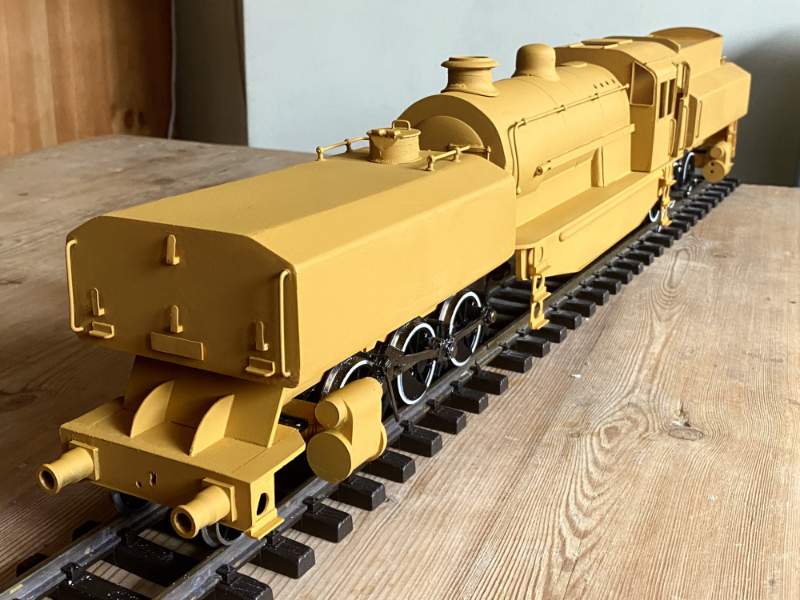

Post by BertieB » Fri Jan 05, 2024 11:08 am
The whimsical ‘Light Garratt’: still missing leading and trailing axles at both ends
It’s progressed a little further. I’ll admit I’d hoped to manage something with more (and more obvious) BR Standard ‘style cues’. And the central, boiler section doesn’t sit above the driving units as it really should (the protruding motors got in the way). But nonetheless, I like to think it’s turning out to be quite a satisfyingly chunky ensemble. I don’t imagine I’ll be building anything bigger.
It’s largely plasticard, with Bachmann motorblocks, additional wheels from Tenmille (though not yet fitted in these snaps) and metal fittings mainly from Walsall. Batteries and weights will be in the tenders, Micron R/C stuff under the boiler. And there are a few more bits to add.
Posts: 5957
Post by philipy » Fri Jan 05, 2024 12:10 pm
Superb build Bertie. Garretts everywhere atm.! :D
Post by Andrew » Fri Jan 05, 2024 1:23 pm
Lovely! And plenty of BR Standard features, I reckon.
Lined black?
Posts: 1142
Post by Old Man Aaron » Fri Jan 05, 2024 2:52 pm
A set of clacks straddling the boiler top, along with suitable firebox-top pipework and stubby boiler fittings, might lend a little further "BR-Standardism" to it, but I'm really grasping at straws - you've made a fine job already. :salute:
Posts: 5684
Post by Peter Butler » Fri Jan 05, 2024 3:24 pm
It looks wonderful to my eyes, another masterful Semi-scale interpretation.
Posts: 7845
Post by ge_rik » Fri Jan 05, 2024 5:31 pm
What a beauty!! Marvellous work!
BertieB
Posts: 425
Location: Scotland
Post by BertieB » Fri Jan 05, 2024 10:32 pm
Thanks for all the generous comments!
Andrew wrote: Fri Jan 05, 2024 1:23 pm "Lined black?"
It certainly ought to be — but I'm afraid I’ve been toying with an alternative, I'll have to do some tests.
Old Man Aaron wrote: Fri Jan 05, 2024 2:52 pm '...clacks straddling the boiler top, along with suitable firebox-top pipework..."
I’m treading on thin ice here, because (likely obviously) I really don’t understand much of this stuff. I did wonder about representing (what I assume were) clack valves on the top, front of the boiler — like on the LNER big Garratt. Later versions of the LMS Garratt, on the other hand, seemed to have had theirs removed! Huh?
Fortunately though, unlike Beyer’s many export designs, neither the 1920s LMS or LNER versions seem to have been festooned with external boiler or firebox pipework at all. So I’m pretending that a late 40s BR version wouldn’t either. Trouble is, as you imply, some BR Standards displayed quite a lot of firebox spaghetti…
This one's just a bit of fun though. My usual excuse.
