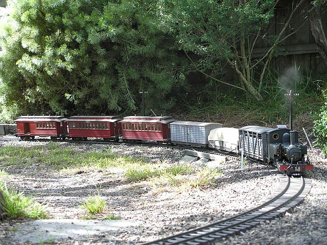

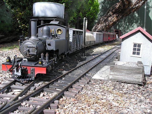

Some shots from today.
Leaving Warringine.

Arriving Nayook.

Posted: Fri Mar 31, 2017 11:29 am
Excellent photographs Grant... wonderful stock and good composition. As all landscape artists say, light is the most important thing to capture an image and you have it in bucket loads!
Posted: Fri Mar 31, 2017 12:28 pm
Peter Butler wrote: Fri Mar 31, 2017 11:29 am Excellent photographs Grant... wonderful stock and good composition. As all landscape artists say, light is the most important thing to capture an image and you have it in bucket loads!
Ditto - really like that shot of the train on the curve

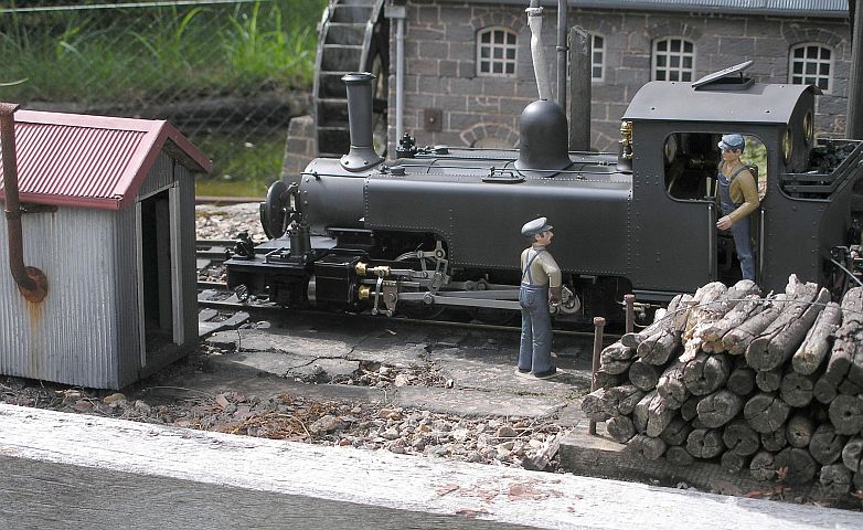

the bloke on the ground is the Bachmann figure who carries a lamp, he's had about 10mm added to his legs. The driver was given to me, so I don't know the source. Someone might know who he represents (movie figure?) he originally looked like this.
Railway Folk 013.jpg (14.58 KiB) Viewed 7430 times
He's been in surgery since then.

Luke Piestalker (I think)
Posted: Tue Apr 04, 2017 11:28 am
by markoteal
What a transformation! Great work Grant
