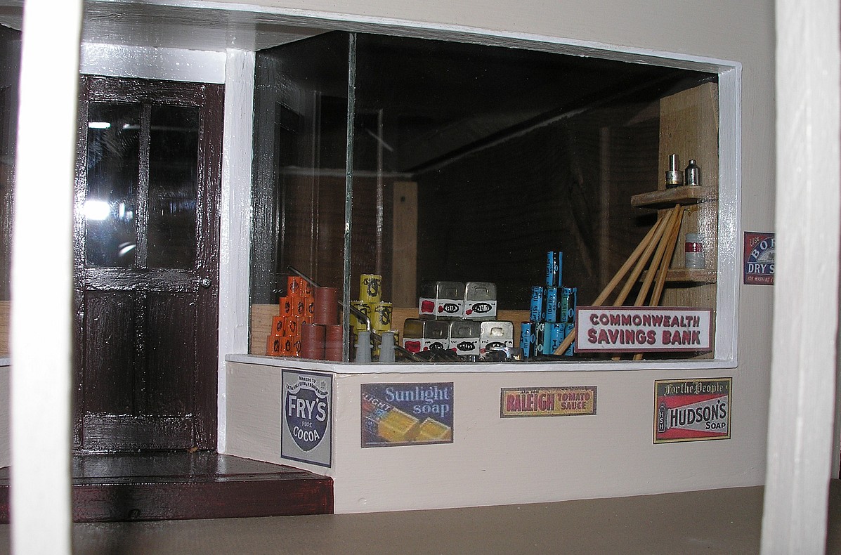

DCooper wrote: Sat May 30, 2026 4:57 am Do you have any hints of tricks for cutting such thin glass?
I seem to have about a 40/60 chance cutting glass, in favour of it breaking!
A "diamond" cutoff wheel in Dremel equivalent is best for thin microscope slides I have found, though getting slides is harder now. Of course I'm not fitting glass "into" a frame rather glueing it to a surface.
Railway Scenes 150.jpg (284.32 KiB) Viewed 2022 times
This night shot of the windows and door of the Nayook store is 1.5 mm picture frame glass and has been outside for years showing no signs of scratching.

Posted: Sat May 30, 2026 11:39 am
DCooper wrote: Sat May 30, 2026 4:57 am Glass would be much better for out doors.
Dan
I have been cutting glass throughout my working life as a picture framer and supplier of cut sheet glass to order, including different thicknesses, patterned glass and fancy shapes. There are no 'tricks' just follow simple rules....
1. Use a basic (cheap) wheel glass cutter. These are simpler to use than diamond cutters as those need skill to discover their 'cutting' edge.
2. Ensure the glass surface is clean.
3. Dip the cutter wheel in Methylated spirit to lubricate the wheel and give a smooth surface contact on the glass. ( IMPORTANT !)
4. Follow a straight edge to keep to the line required.
5. Press firmly.. NOT heavily on the cutter against the glass.
6. Slide the cutter slowly towards you.. no hurry!
7. NEVER go over the same cut twice. If you hear a grating sound that is NOT a cut.
8. Place the glass over a matchstick placed under ONE end of the cut line and press down gently at both sides . Alternatively place thumbs of both hands on top of the glass either side of the cut line with bent first finger underneath and snap by applying upward pressure.
Hope you find this useful.
Re: Hammertoe, my 16mm scale 45mm gauge Indoor layout
Posted: Sat May 30, 2026 2:13 pm
by LNR
Peter Butler wrote: Sat May 30, 2026 11:39 am Dip the cutter wheel in Methylated spirit
That interesting Peter, I keep my wheeled cutters in thin clock oil. I shall try Meths next time.
Thank You.
