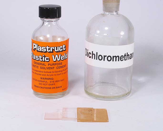

Anyway, this photo shows my last remaining and almost empty bottle of the 'Plastruct Plastic Weld' that used to be available here in Oz. It's the US version and the formula has changed over the years, as it used to contain chloroform, but is now dichloromethane (DCM) based.
The label has the statement "Multi-purpose, evaporative formula for bonding PLASTRUCT ABS, Styrene, Butyrate and Acrylic to itself or each other." US spelling and grammar, not mine........ :roll:
Plastic Weld.jpg (51.58 KiB) Viewed 7424 times
Out of interest I ran a test on a few off-cuts of acrylic sheet using this Plastic Weld and the few remaining drops in the dichloromethane bottle. The acrylic is Shinkolite, a Japanese made acrylic sheet equivalent to Perspex. Genuine 'Perspex' disappeared from the Aust. market decades ago.
Both 'Plastic Weld' and DCM bonded the acrylic so strongly that after being left overnight I can't break the bond by hand. The test piece is at the front of the pic., but taking a photo of transparent plastic is basically wasted effort. Since Plastruct Plastic Weld has disappeared locally, I'll have to hope my reserve supply of dichloromethane holds out.
Out of interest, I also tried MEK (2-Butanone in IUPAC speak). It stuck a piece of polystyrene to a piece of acrylic with a bond stronger than the polystyrene. However the bond between two pieces of acrylic wasn't as strong as the joint made with DCM and I was able to peel the joint apart with my fingers without the acrylic breaking. Much as I'd expected, as MEK works well on polystyrene, but also makes weak bonds when used on ABS.

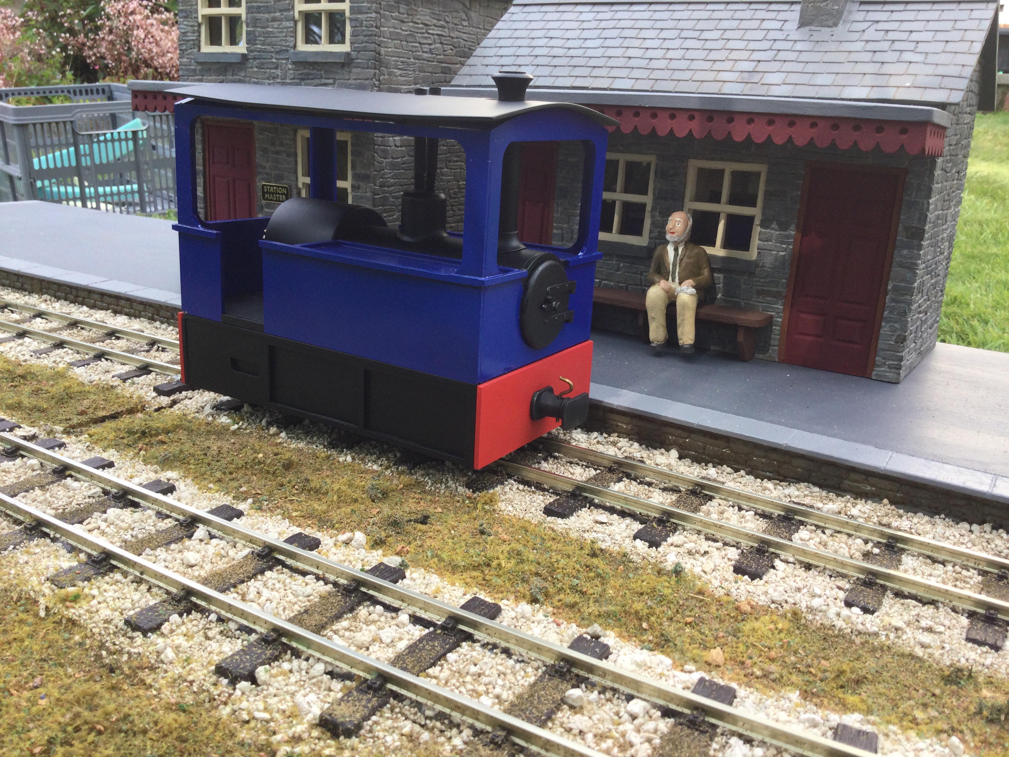

Whilst in primer there was some filling of some of the edge joints with Cataloy paste (knifing putty) followed by sanding and respraying until I was satisfied. Much more of this could be done by a perfectionist like our friend Peter B but I felt it was good enough for me.
The blue paint is a rattle can from the local (small) DIY store. There was a very limited range of colours. The blue has actually worked out well, it is quite a different shade to the dark blue of the 'Glaslyn' diesel.
The roof was the last piece of construction to be tackled. Difficult to see the end supports in the picture but the spaces for three more in the body of the loco are obvious. The kit includes centre bearers with an extra curved piece to be fitted on each side giving a reasonably solid item. A piece of 0.5mm black plastic laser cut to size for the roof and with a hole for the chimney and two for the safety valve outlet pipes is supplied. I felt this was too thin and so attempted to make a two layer roof from a new sheet of plastikard, laminating the second layer on top having first glued one layer to the roof supports. The supports and roof were held in place on the body with spring clips and the solvent run carefully between the loose three and roof and left to set. This formed a reasonable curved structure and could have been glued in place to the body, adding the second layer of black plastic glued quite well though there were some creases apparent. My trip to the Llangollen show yielded a sheet of 1.5mm material, a much better thickness, so using some solvent, scissors and brute force most of the thin plastic was removed and a quick skim with a Stanley knife got rid of the rest, leaving the three beams ready to try again.
Here he is again with the new roof placed on, once I have used glue (my present choice is Power Bond, which was on demonstration at Llangollen, and which so far I have had excellent results in using) the roof should fit tightly and the uplifted corners behave themselves.

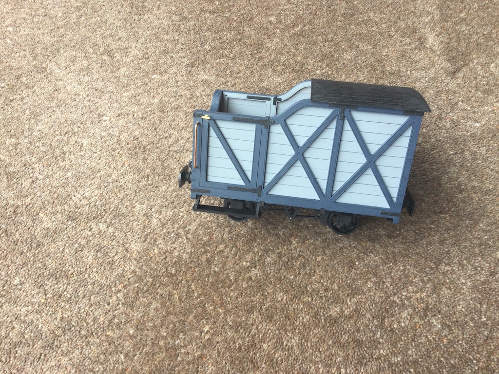

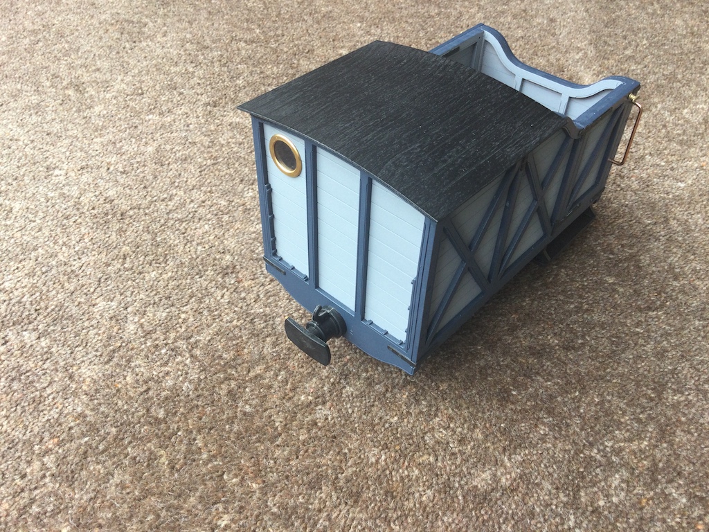

Next a Spooner Brakevan from Sixteen Mills. Having seen the one made by Peter B it was an easy choice for something from their stand at Llangollen.
spoon 1.jpeg (370.1 KiB) Viewed 7796 times
spoon 2.jpeg (484.65 KiB) Viewed 7796 times
spoon 3.jpeg (458.33 KiB) Viewed 7796 times
spoon 4.jpeg (458.08 KiB) Viewed 7796 times
A pleasure to build. The basic structure was glued together with wood glue, omitting the overlays. The chassis members were glued to one another in place but not to the body and the steps assembled as separate pieces. Each section and the overlays were then sealed with MDF primer and allowed to dry then primed in grey with rattle cans. I had not decided on a colour scheme and checking what acrylic airbrush colours I had thought light blue for the body and dark blue for the overlays might look good. I attempted to airbrush the overlays but kept having clogging problems, the paint probably being too old and so resorted to brush painting them. Trying the dark blue overlays on the grey primer gave me the final colour scheme! The overlays were fixed with canopy glue, as were the corner strapping, hinges etc. The side door handles are brass ones from Brandbright, the guards compartment door handle a white metal one. The ship's wheel was not included in the kit and I sourced a Mantua one. The portholes are included with the kit. A guard awaits painting. I did wonder about giving him an anchor to throw out when needing an emergency stop but have not gone that far (yet).
