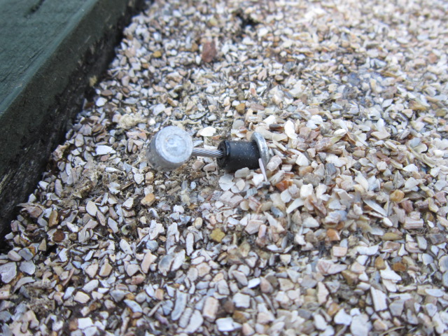

Saturday, I managed to check the fit of the point crank/connection. Also a trial run to check the friction of of the Shimano gear casing and the solid 1.10mm stainless wire with all the curves and bends through the drain tubes in the concrete track base to points and signal bases. All is super sweet. Next will be boxing, cement base for the signal frame that will live in a goods shed with removable back wall and roof. The plan is to have a weather box to cover the lever frame when not in use that is also inside the goods shed. 9 more signal kits are on order. All this is going slowly as I am very busy with my Reciprocating Steam Engine Ticket Training, steam, diesel and Railmotor training on weekends at the Mary Valley Rattler Railway, which is soon to commence passenger operations.

I do like this system of operating points, so neat and relatively unobtrusive. Do you know if the Shimano casing is available in long lengths? So far my internet trawl has not come up with anything over 2.1mtrs and I will need around 5mtrs for the longest run on my railway.

I have had a cable system operating on my railway for over a year now and can confirm the system works well and hasn't suffered from weather related issues either.
There are no cranks involved as the wire works on a push-pull basis and is able to allow a loco to run through a point set against it even though one cable is three metres long and has various curves in its run......

4mm Shimano STI casing is available in a 50 meter shop box roll.pandsrowe wrote: ↑Sun Aug 05, 2018 7:50 am I do like this system of operating points, so neat and relatively unobtrusive. Do you know if the Shimano casing is available in long lengths? So far my internet trawl has not come up with anything over 2.1mtrs and I will need around 5mtrs for the longest run on my railway.
You would need to get a packet of casing caps, do not use the alloy ones, they oxidise in no time at all. The black plastic with the rubber grommet are super.
Perhaps the local bike shop has a shop roll and they can you off a 5m length for a tener ?

The longest runs to points will be 3mtom_tom_go wrote: ↑Sun Aug 05, 2018 7:55 am What is the distance from point to lever out of interest?
The longest runs to signals will be 4m
Most are shorter.
I am using cable caps that have a rubber gromit in the end that helps reduce moisture and dirt entry.
Even though the casing has a Teflon liner tube, one smears a non petroleum type very thin grease on the wire at you thread it into the casing. "Slick Honey" is my favourite brew for bicycle cabling for many years and I will use it when I do the final installation on the POR.
