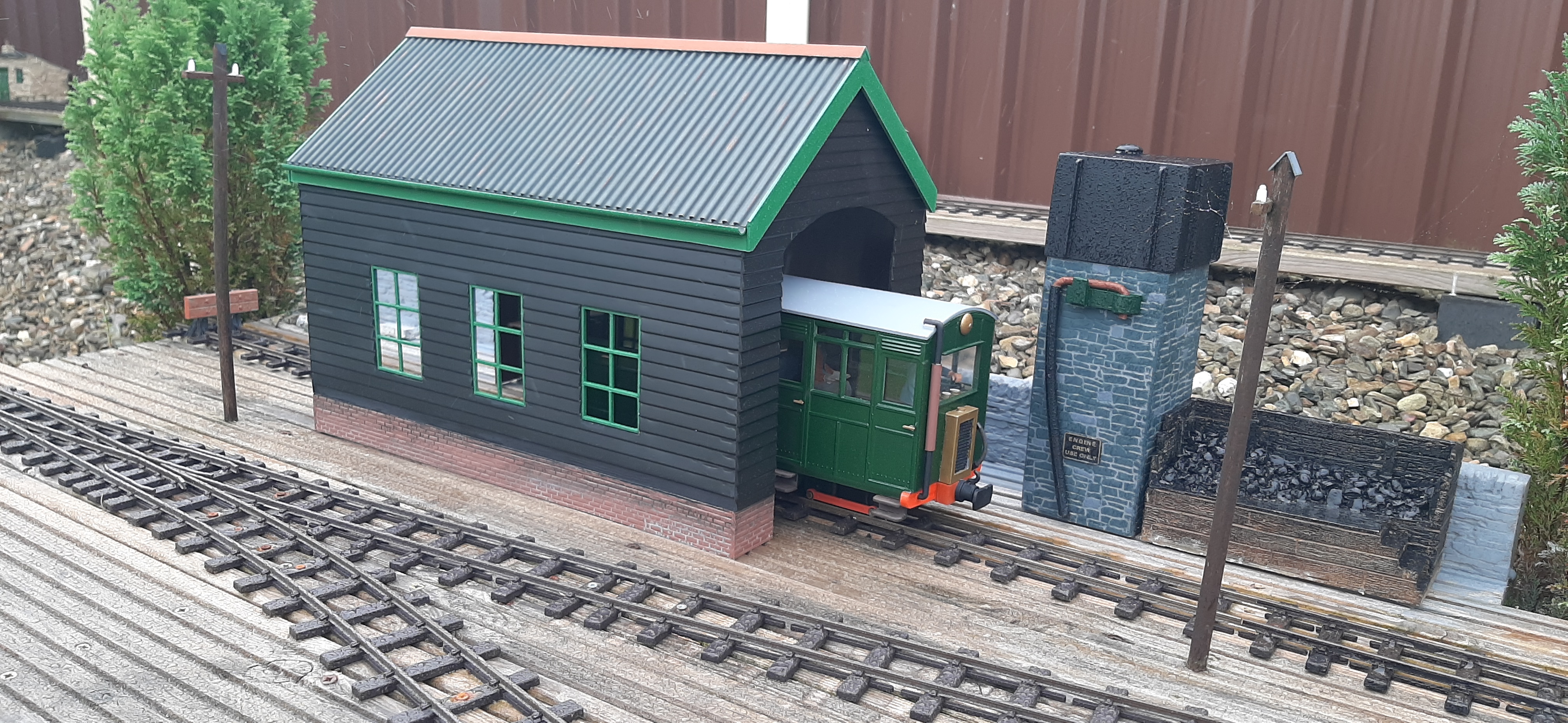

I wanted an engine shed for the railway . Various options are available , resin ,concrete and wood kits . The concrete cast kit is not an option due to weight,and the other options are costly. So on to my preferred option scratch build it .
The model's made from 2mm thick plasticard Sheets progress so far
The window frames have been fashioned from ex ratio n gauge kit sprues.
Next on to laminating the carcass

So after a day of scribing and gluing . This is the result.

I was able to do some more work on the engine shed today ,fitted some roof trusses and bracing ,filled gaps with miliput then as the weather was ideal with no wind ,I rattle canned the building .

I added the roof section to the engine shed and offered up my tallest loco ,an Essel Chattendon to get an idea of the clearance and proportions. All seems well .
Four sheets of a3 plasticard have been used so far along with 100cm of styrene angle strip . This is the biggest model building I have made , apart from making a dolls house some years ago.

The engine shed is almost finished . I have painted the roof, facia boards and gutter . Just need to attach the drain pips and make some doors . The coffee stirrers are a little under scale for the doors only measuring 5mm wide , so I went on the net and found some kebab sticks 200mm long and 9mm wide ,they will be ideal for the job .

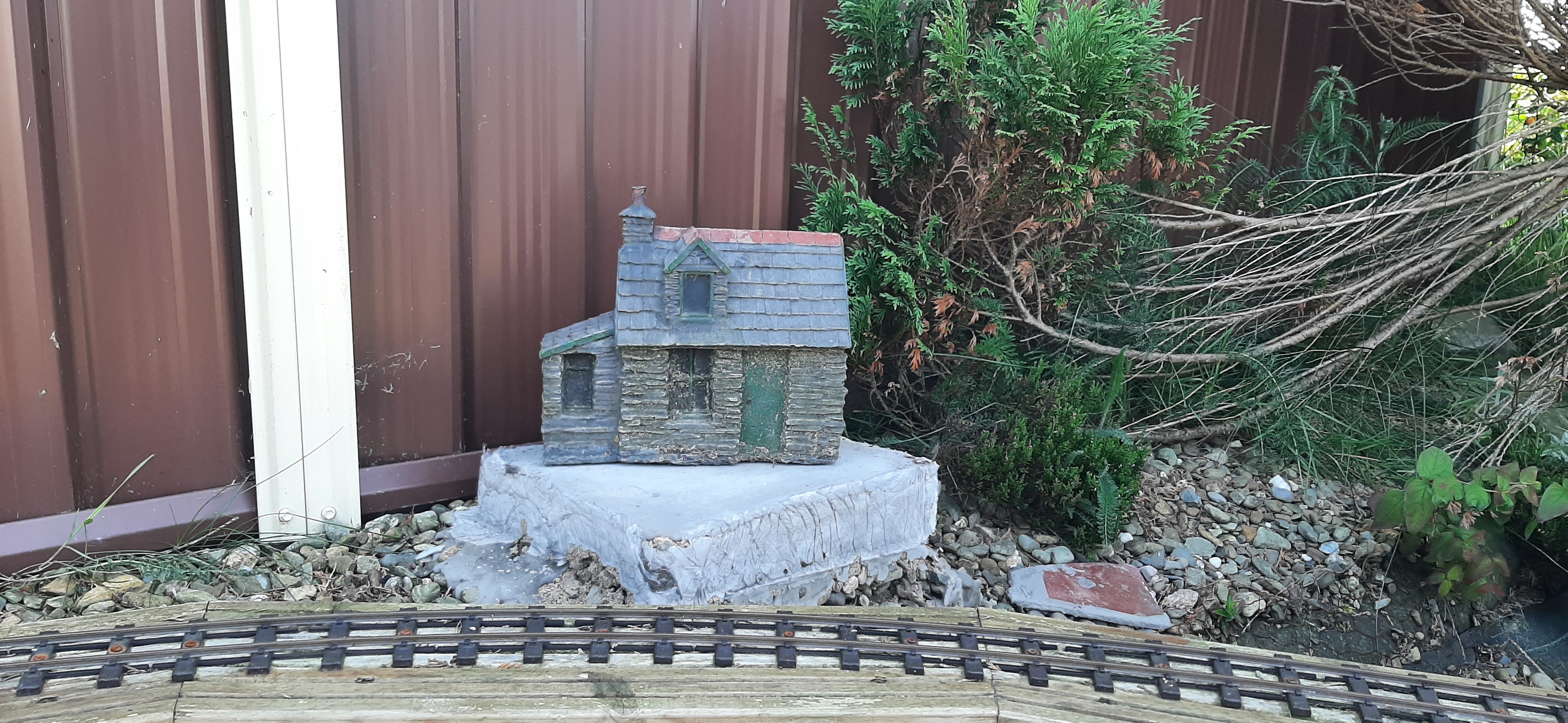

Thanks Peter. I have always made my buildings from plasticard in 2 3 4 7 and 16mm scale . its a medium that I am happy with . The only material that I would consider to leave out all year is Concrete . I was recently gifted a couple of concrete cast buildings , and for the first time I made a mini concrete plinth to place the building on
