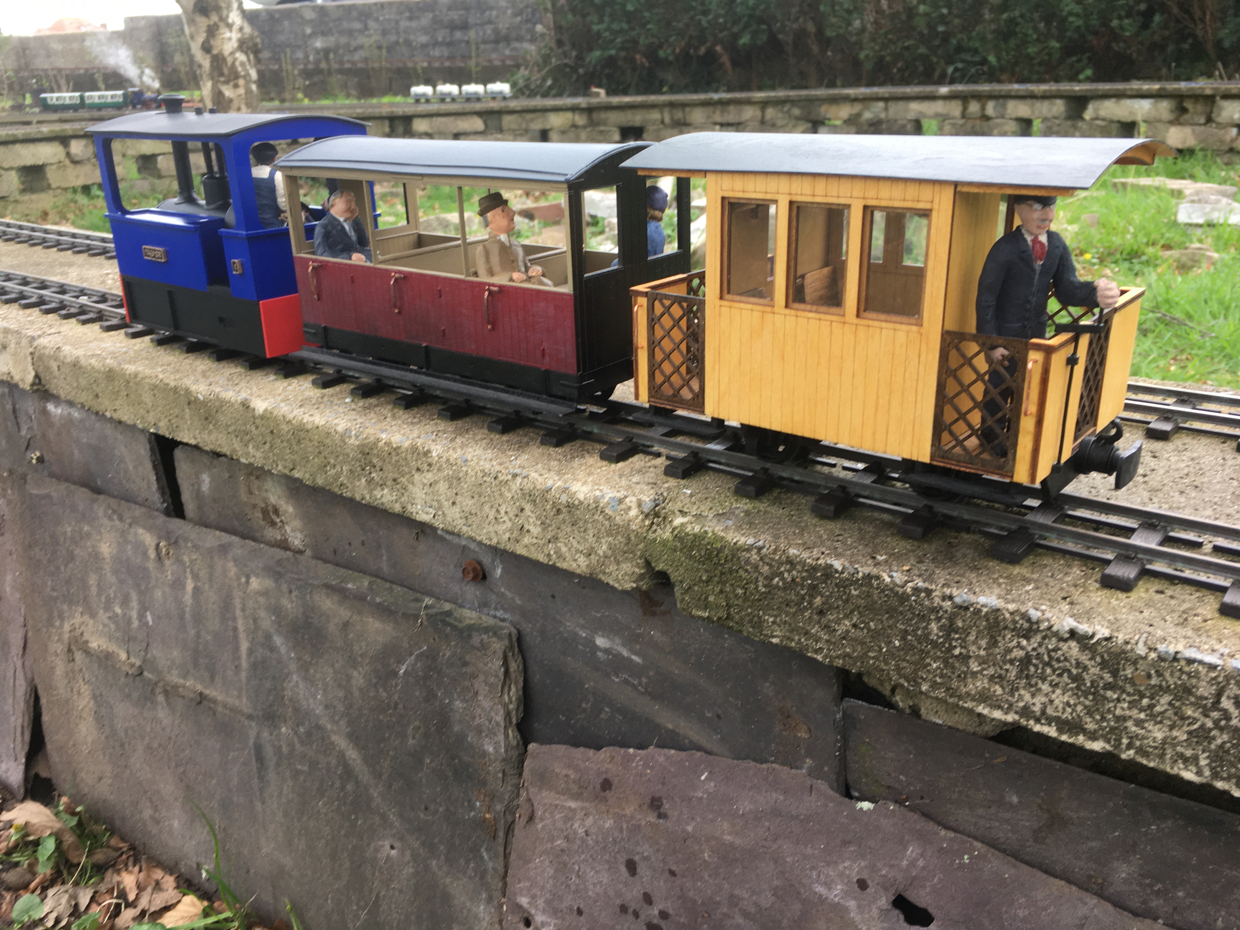

As suggested by Trevor earlier the balcony coach had a run behind Trefor the Tram at the Swansea Model Engineering Society track this afternoon.
A good day out was had by all. Many thanks to all the members there who made us so welcome,

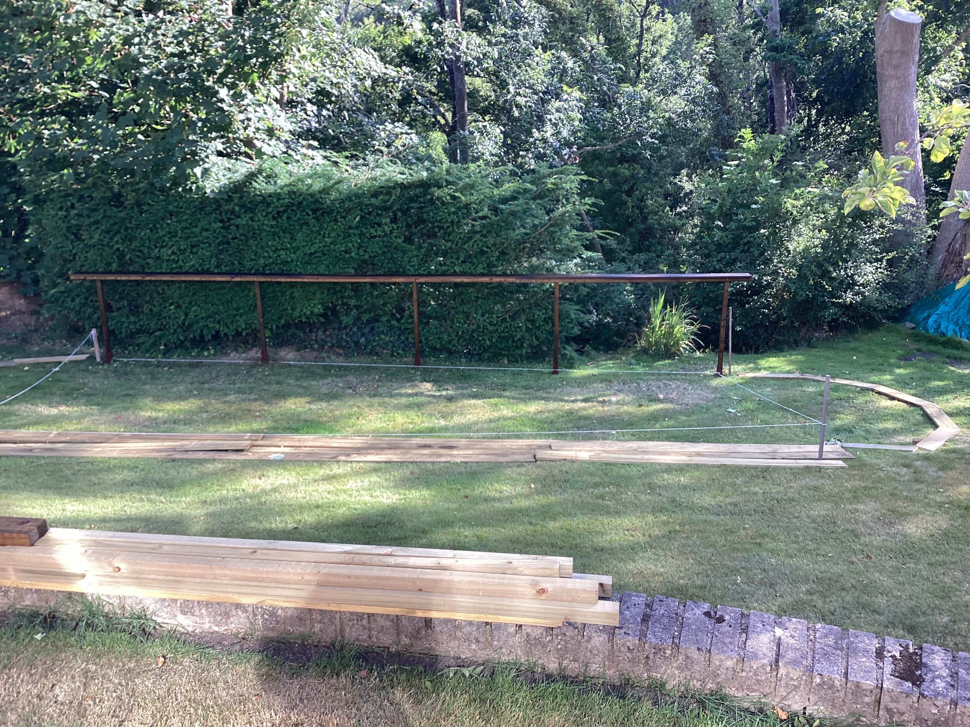

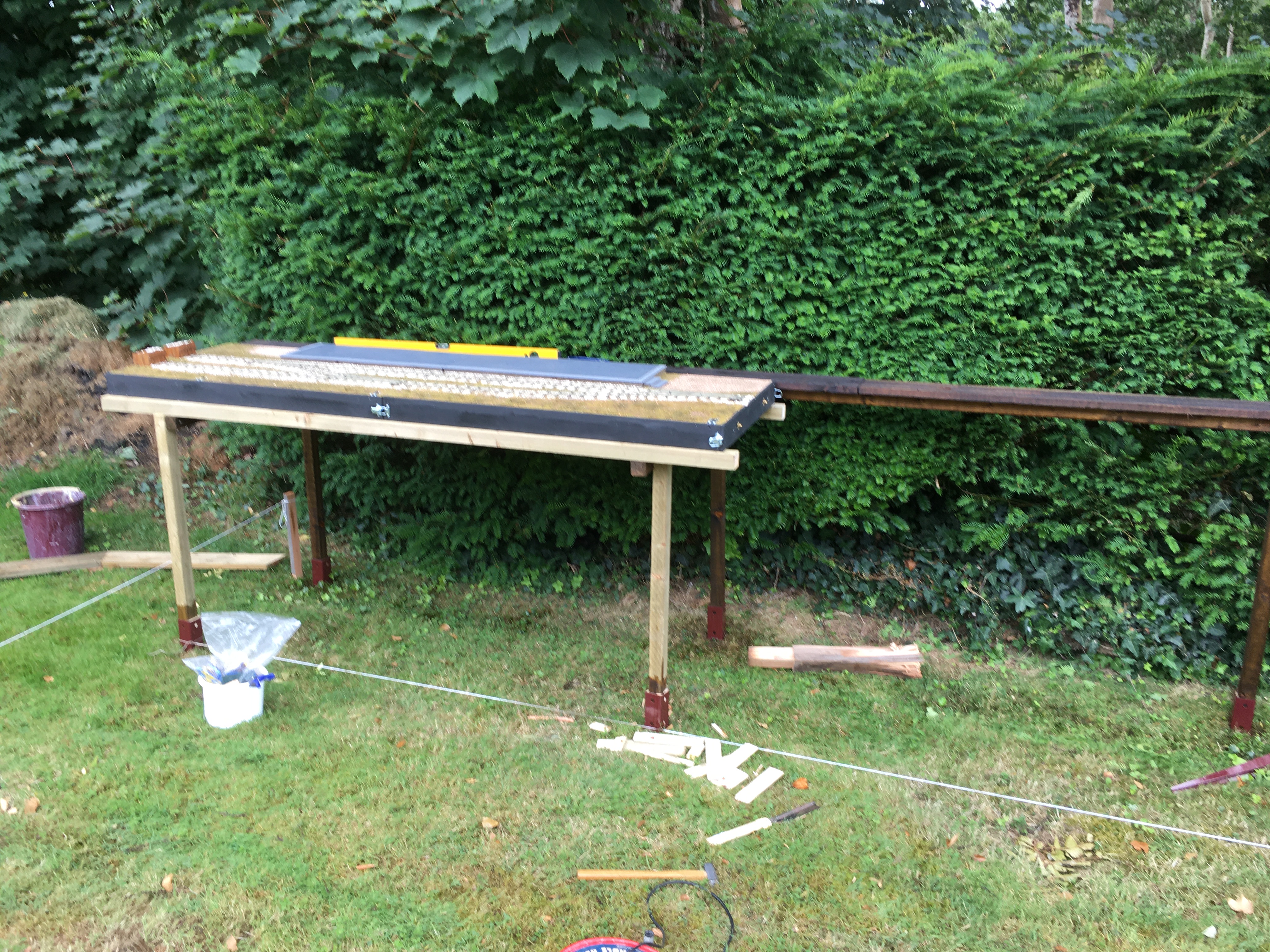

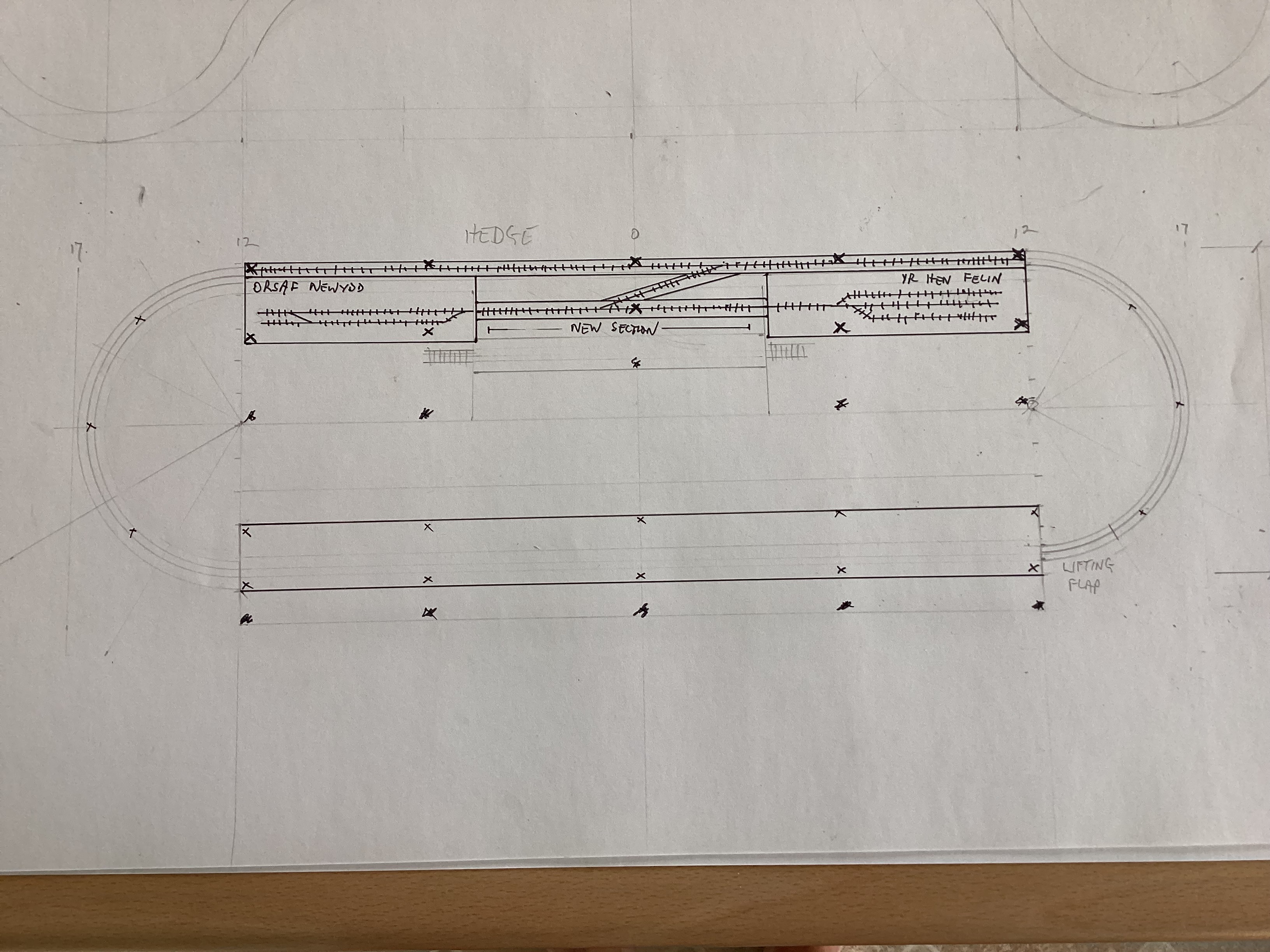

Following visits to running days on local group members layouts, inspiration and friendly discussions/arm twisting, things are afoot to incorporate Yr Hen Felin and Yr Orsaf Newydd into a larger layout.
A plan was drawn up:-
timber was sourced locally and fence post spikes online, the next picture shows the state of things at close of play last Monday:-
Posted: Sat Jul 08, 2023 10:17 am
by gilfachphil

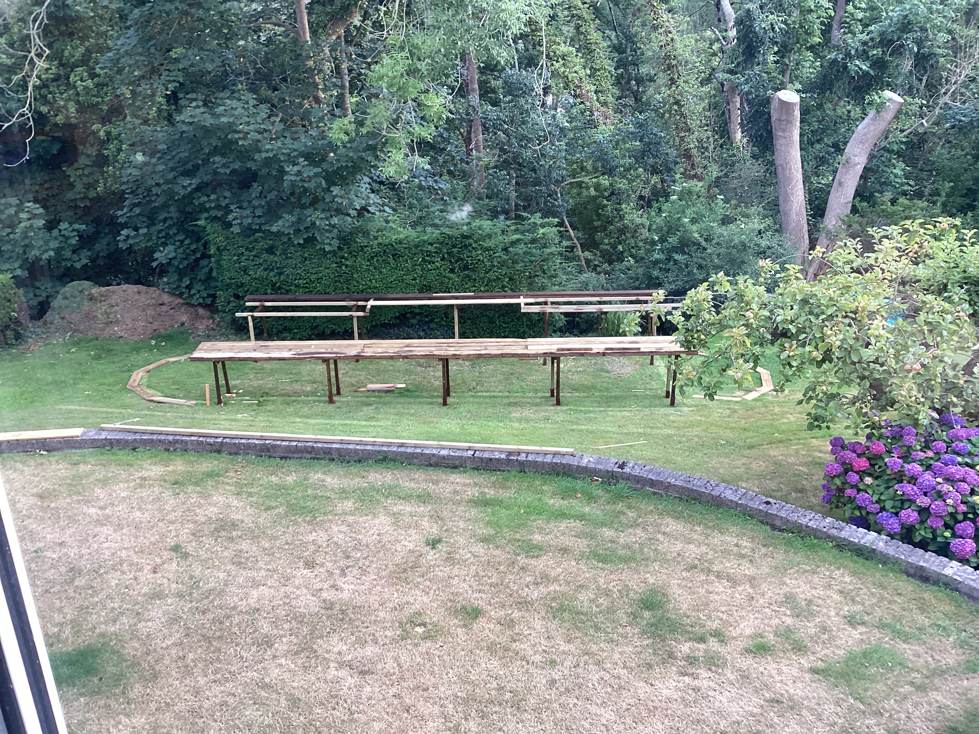

By the end of Friday afternoon, the fence spikes having arrived at lunchtime:-
The spikes are 50mm square ones, though a little oversized, and the timber nominal 50mm square though actually about 45mm. I cut slices from spare pieces of the timber and rammed them into the gaps to hold the posts stable.

and a proof of concept test:-
it works and the station section is only slightly different in height to the new track bed so no great gradients involved in getting from one to the other.

A lot of progress has been made in the last few days:-
the framework to support the two scenic boards is mostly finished and the front table similarly though not all of the boards are screwed down yet.

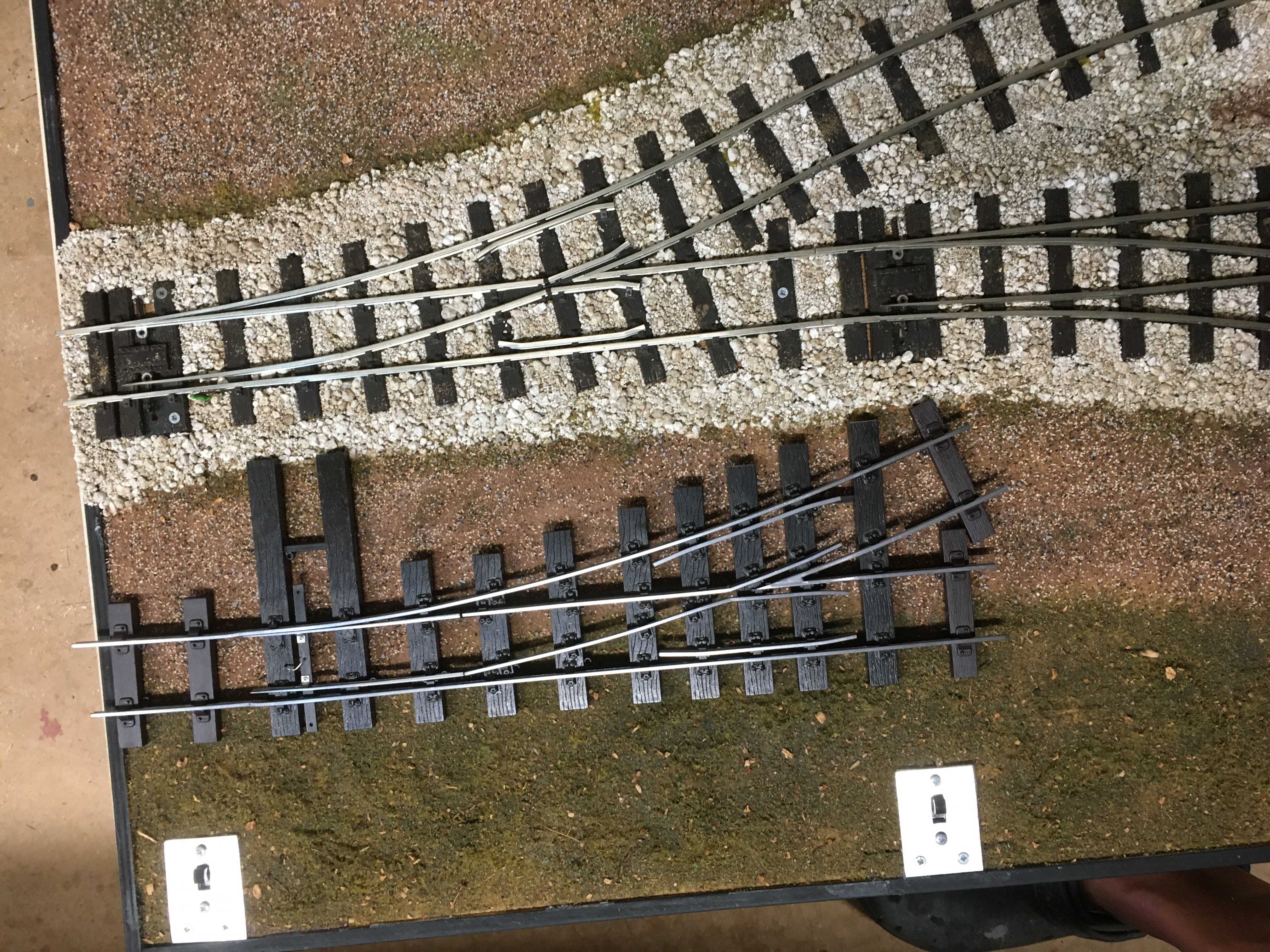

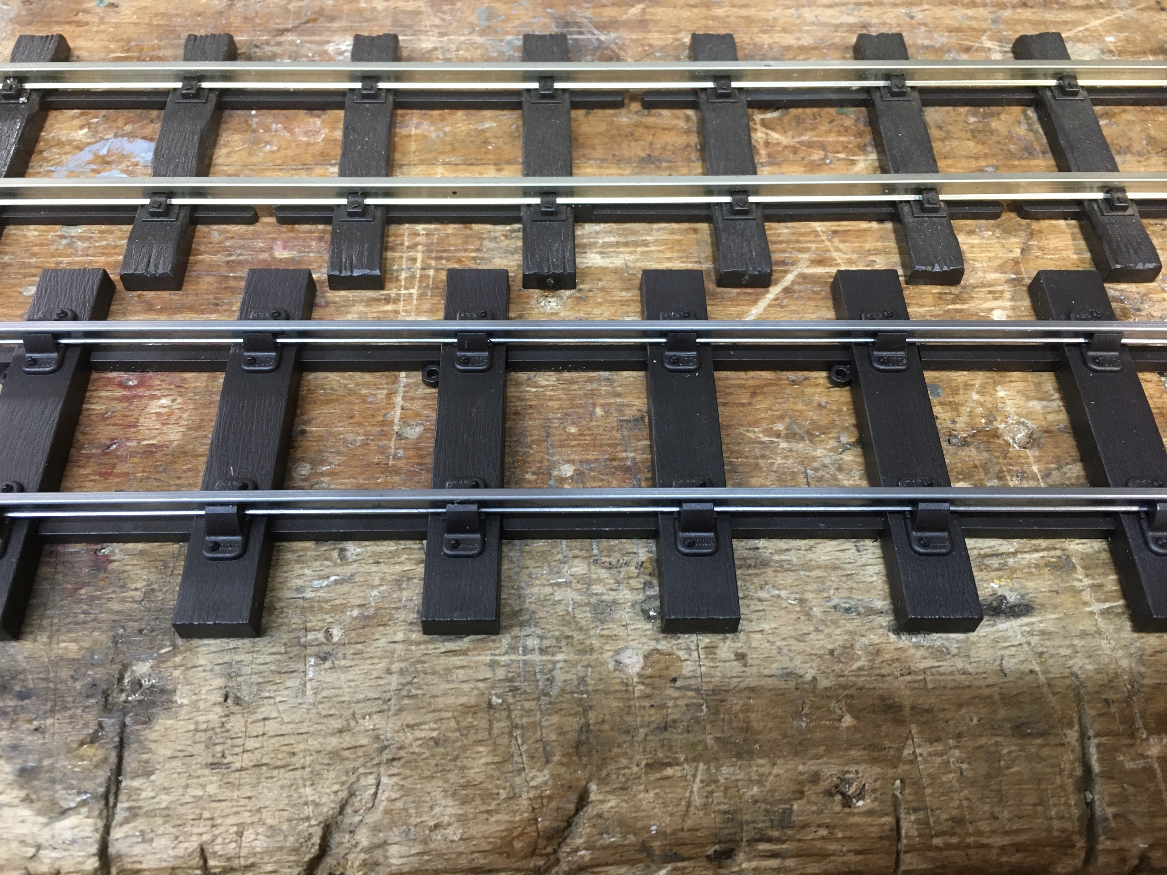

High winds and frequent rain today have driven me indoors so some Cliff Barker track has been assembled. The following photo shows Peco track to the rear and Cliff's track in front:-

for comparison, a Cliff Barker point beside a Peco one set into the ballast on the scenic layout
Posted: Fri Jul 21, 2023 4:57 am
by Old Man Aaron
That's some good looking track - and proper point throw timbers! I might have to get some of those..
The timber finish looks quite nice too. Is it oil or varnish?
