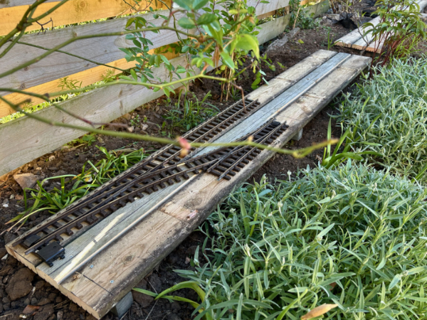

I’ve cleared a load of decking and anything that might get in the way and started on the trackbed, reusing some of the redundant decking, despite my previously stated commitment to avoid wood. It’s being supported on recycled plastic posts and not actually in contact with the ground. I think that’ll be OK for a few years. Height above ground will vary with the terrain.
I’ll cover it with cheapo, thin, roofing felt and screw painted UPVC window trim (it’s way cheaper than wood and doesn’t rot) along the edges to secure the felt and contain the 6mm chippings to be used as ballast, as before. It hardly represents realism, I just think it looks better than ‘bare track’. For curves I’ll use R5 and R3 recycled plastic boards, mainly from the previous garden (and no felt).

Test runs with the smallest, most forgiving loco
Inevitably, things haven’t gone entirely to plan, though I’ve done much of the track laying in ‘stage 1’, the raised bed area of the garden. I now have to do some brick laying (not one of my core skills) to reinstate a step into the raised bed (for weeding and track access) and then knock up a simple lift-out bridge to run across it.
It was forcefully suggested to me, by a (relatively) younger member of the family, that the opportunity for continuous running had be an absolute priority, even if it could only be achieved with small tank engines and short rolling stock. So return loops would be necessary at both ends of the (as yet far from complete) relocated, garden railway. I’d thought that within the limited space available at the raised bed end of things, it would just look too tight and too naff. I’ve had to concede however and include a R2/R3 return loop. I’ll have to attempt to camouflage it with judicious planting, which is desperately needed anyway.
An unexpected annoyance has been the volume of bird droppings ending up on the trackbed, which is messing with my planned ‘loose ballast’ notion. It would make cleaning it off unpleasant and difficult. Not yet sure what to do about that.
