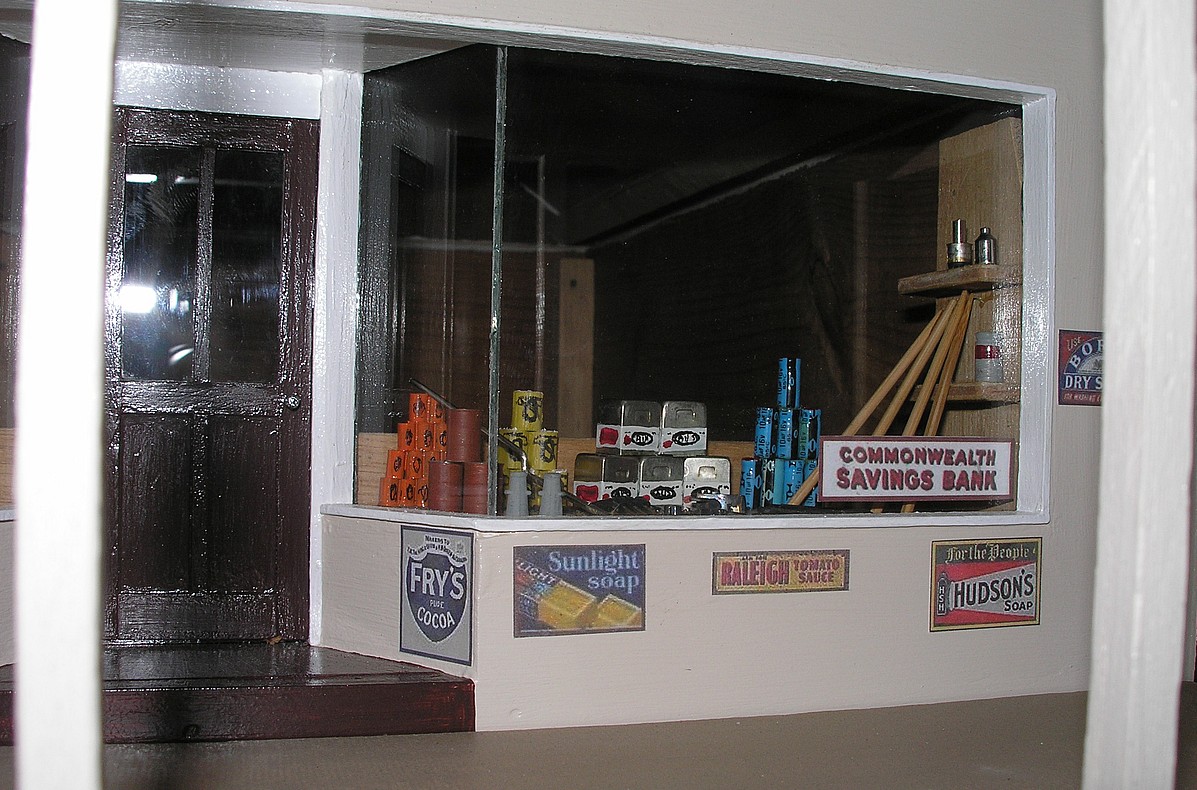

DCooper wrote: Sat May 30, 2026 4:57 am Do you have any hints of tricks for cutting such thin glass?
I seem to have about a 40/60 chance cutting glass, in favour of it breaking!
A "diamond" cutoff wheel in Dremel equivalent is best for thin microscope slides I have found, though getting slides is harder now. Of course I'm not fitting glass "into" a frame rather glueing it to a surface.
Railway Scenes 150.jpg (284.32 KiB) Viewed 2023 times
This night shot of the windows and door of the Nayook store is 1.5 mm picture frame glass and has been outside for years showing no signs of scratching.
