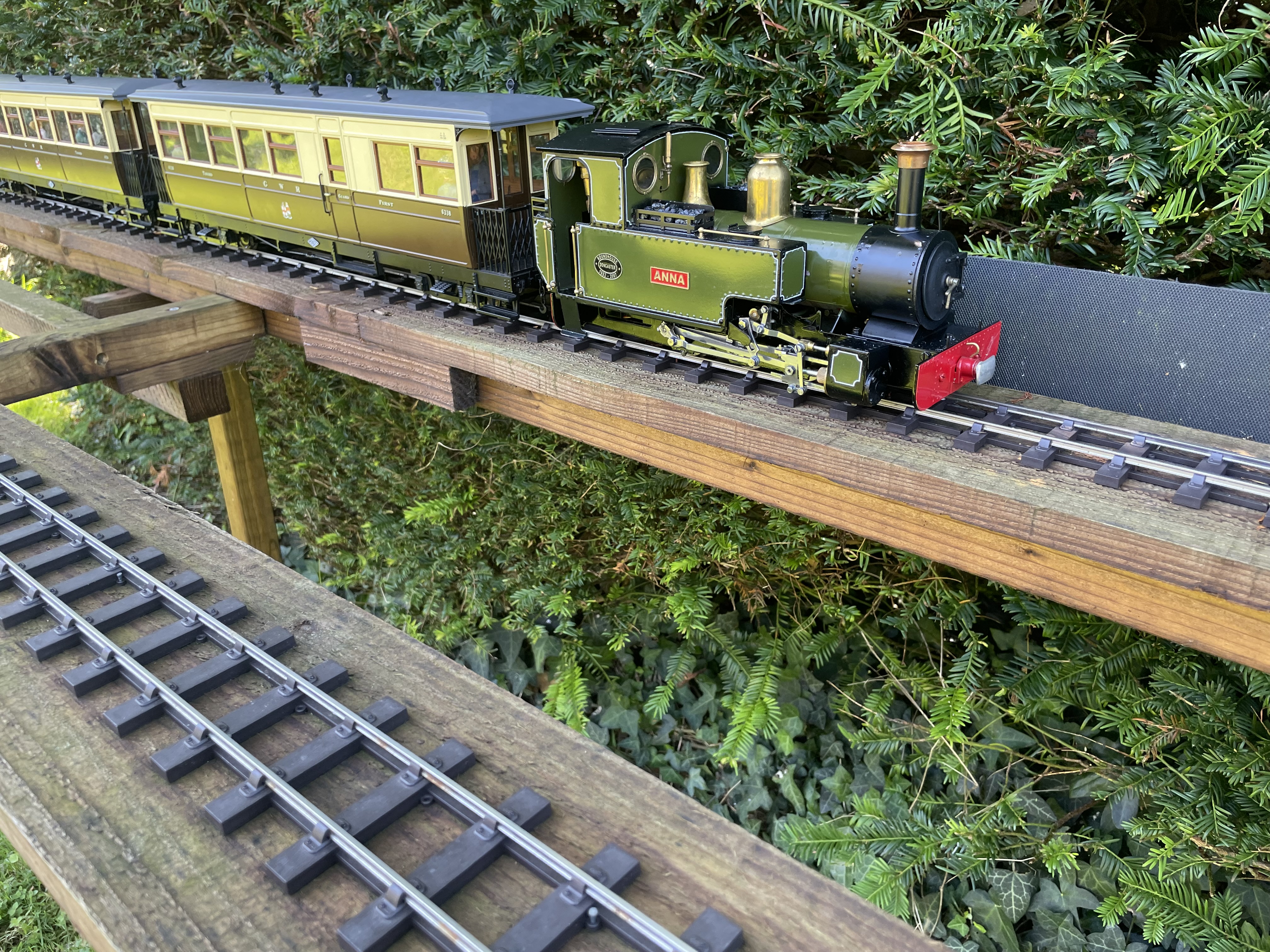

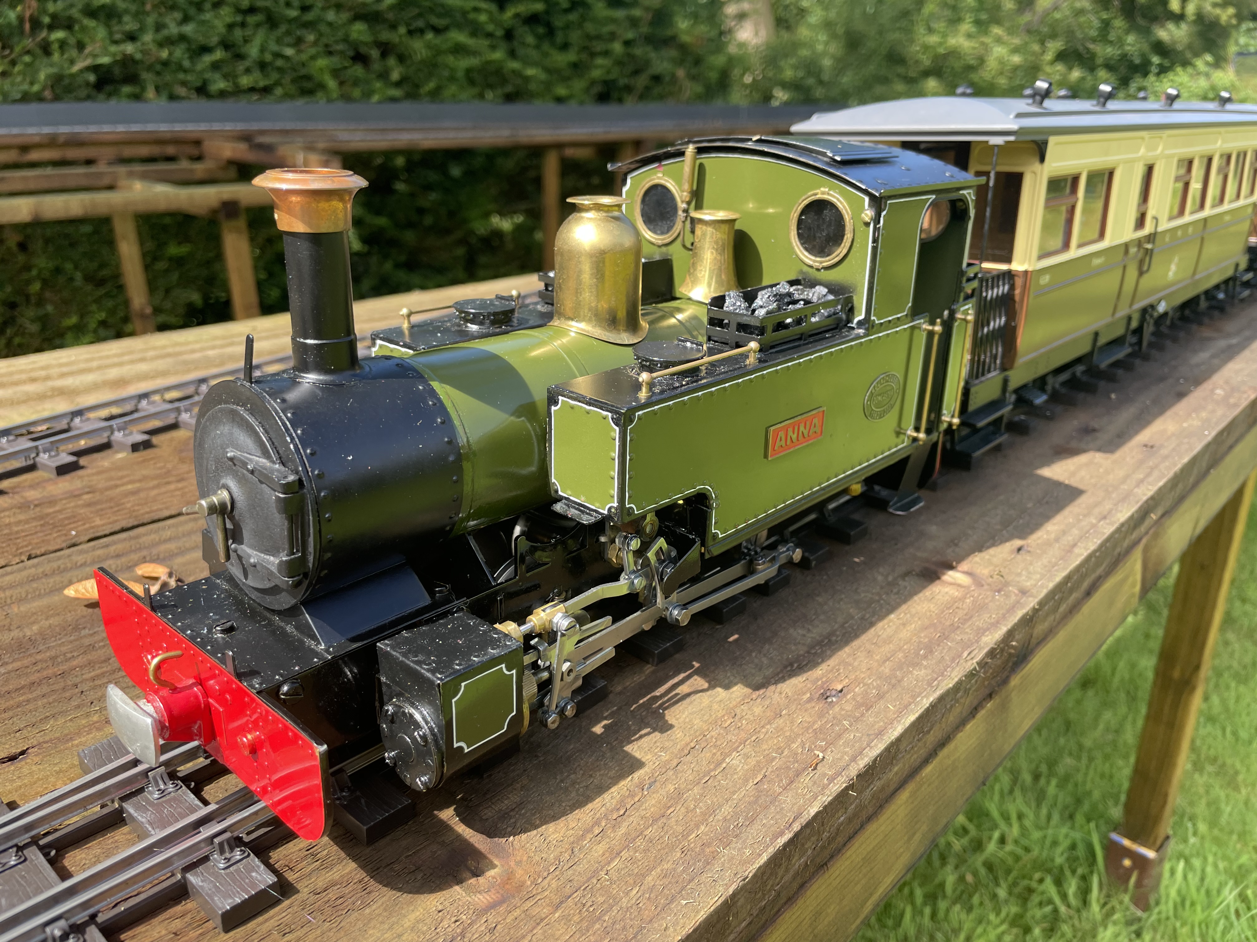

Post by gilfachphil » Sun Jul 21, 2024 12:50 pm
First steaming of Anna for a couple of weeks. She now has real coal in the tank top bunkers and has been touched up where some of the green paint on the boiler had chipped revealing her original red!

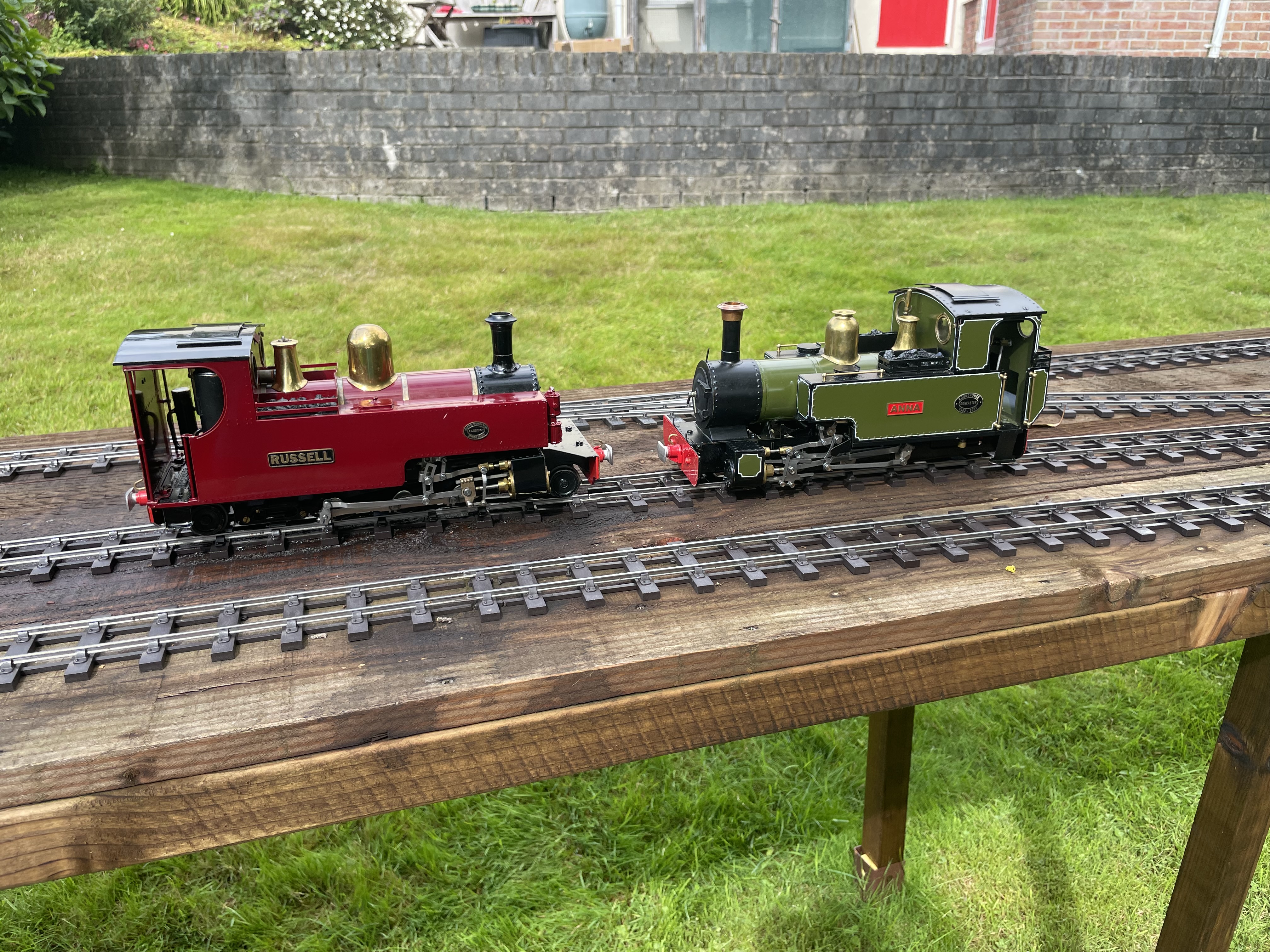

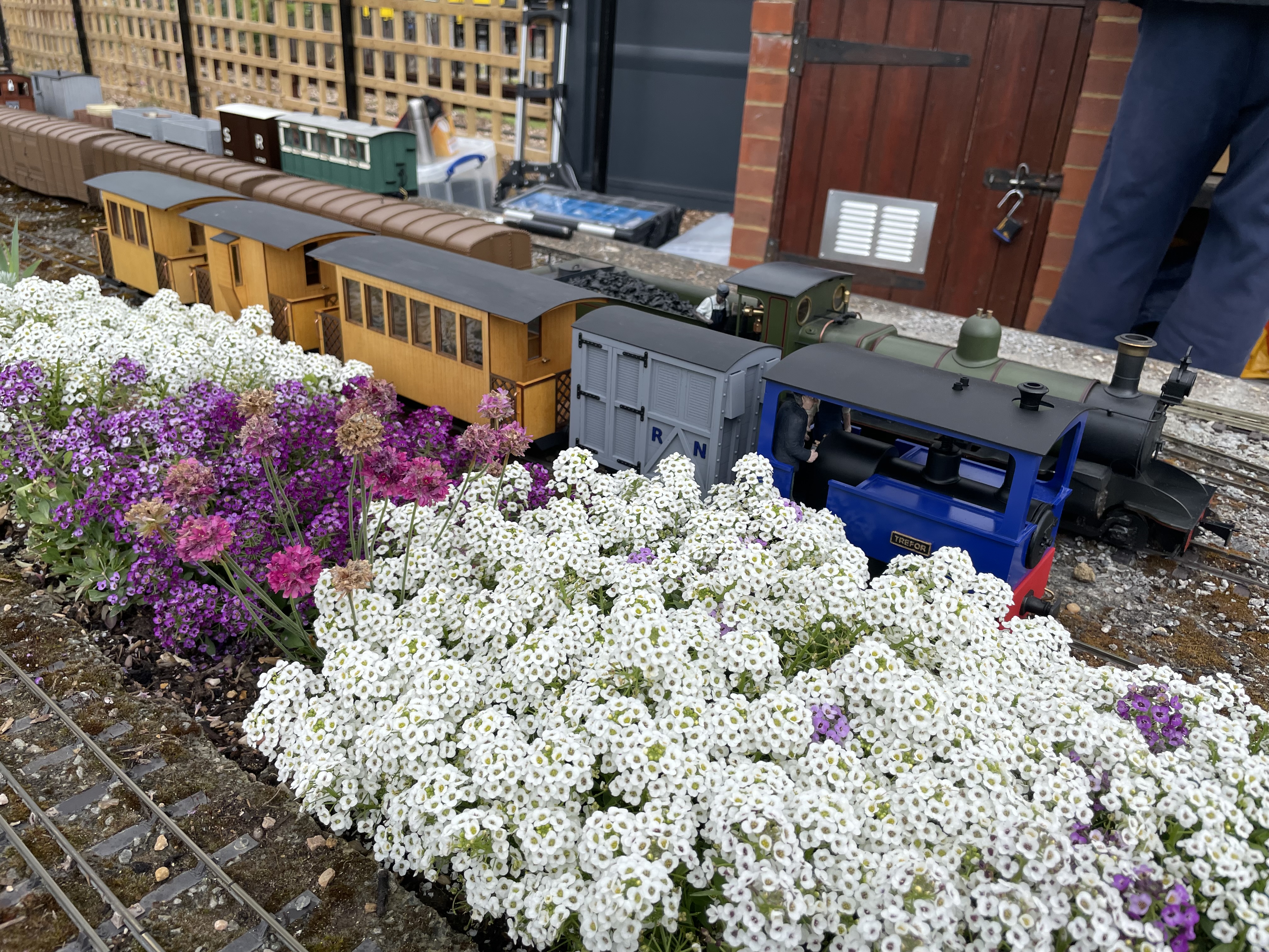

the entire live steam fleet lined up after duty!

Lovely locos - "Anna" looks splendid in that livery!
Odd that one of your loco's valve gear strikes the bridge hinges but the other doesn't - I thought that "Silver Laddies" were pretty much the same as the "Lady Anne", and that - running gear-wise - "Russell" is just a "Lady Anne" with pony trucks. But I guess they're all individual...

I was surprised when Silver Lady Anna had problems. Someone said that she has bigger cylinders than a Lady Anne?
At least now they both go happily across the bridge, which has much more solid hinge arrangements than previously.

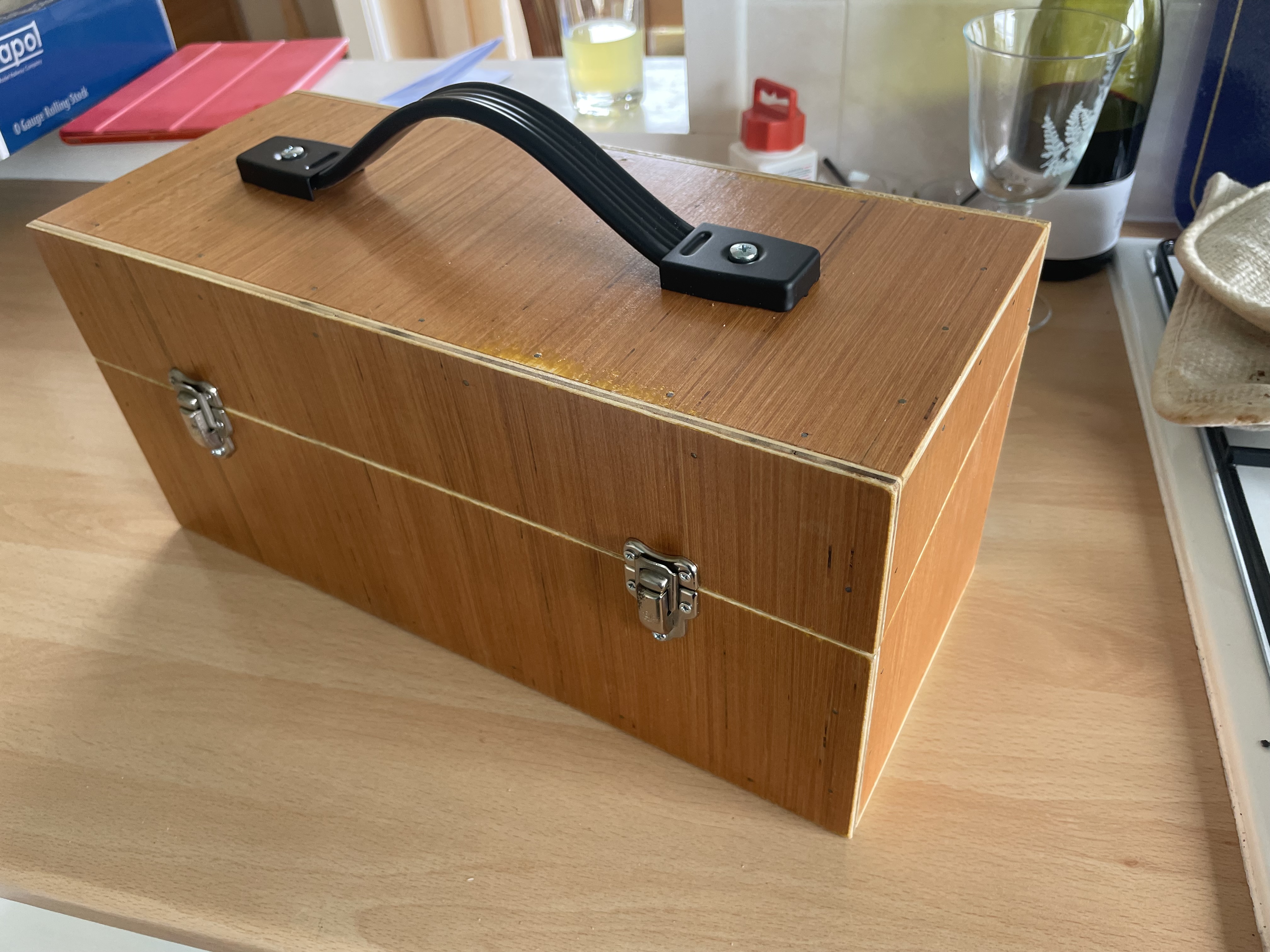

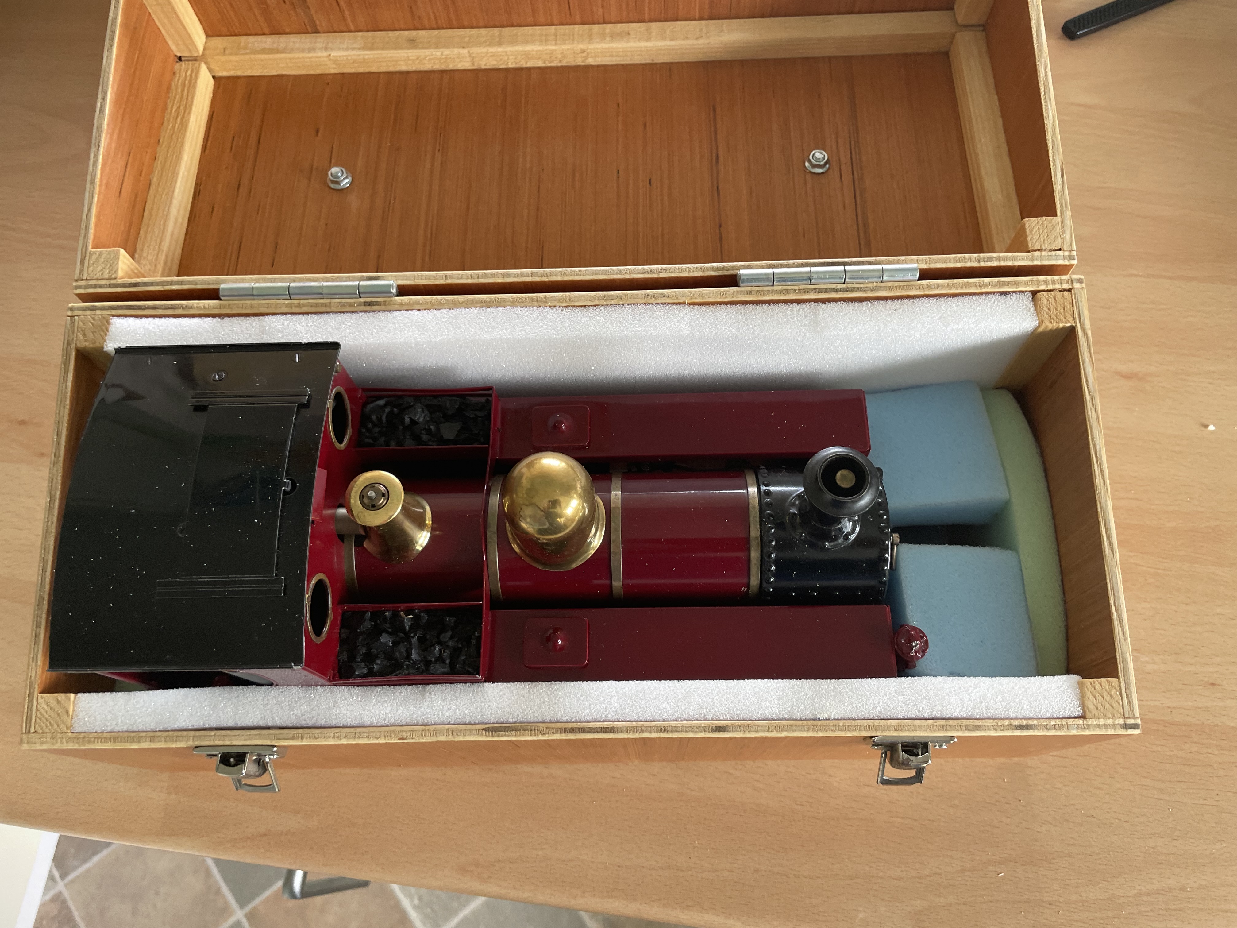

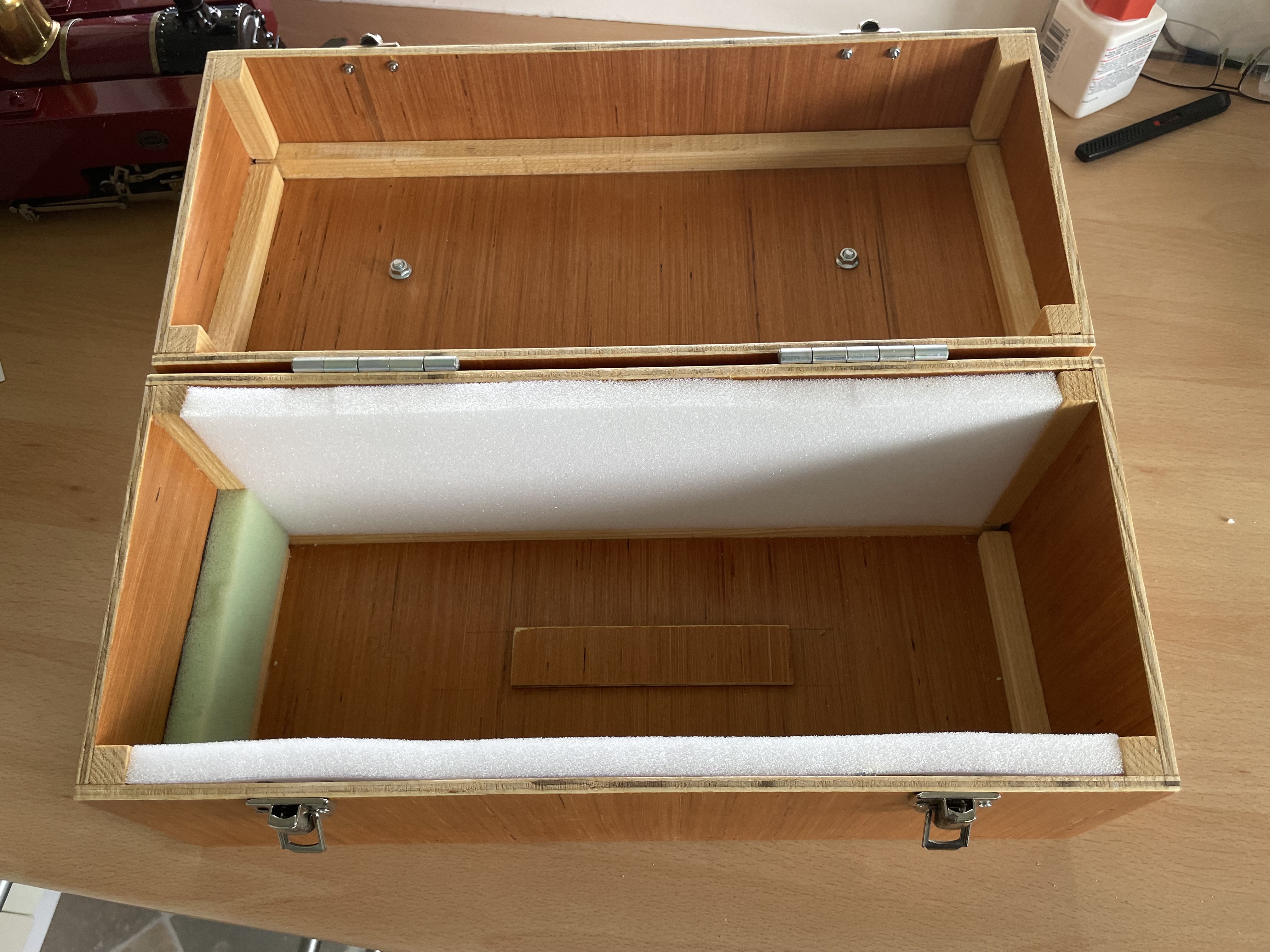

A cosy box for Russell. 5mm ply and 12mm square soft wood, pinned and glued together. Cheney catches I probably bought in Messingers in Guildford well over 30 years ago, handle and hinges from stock.

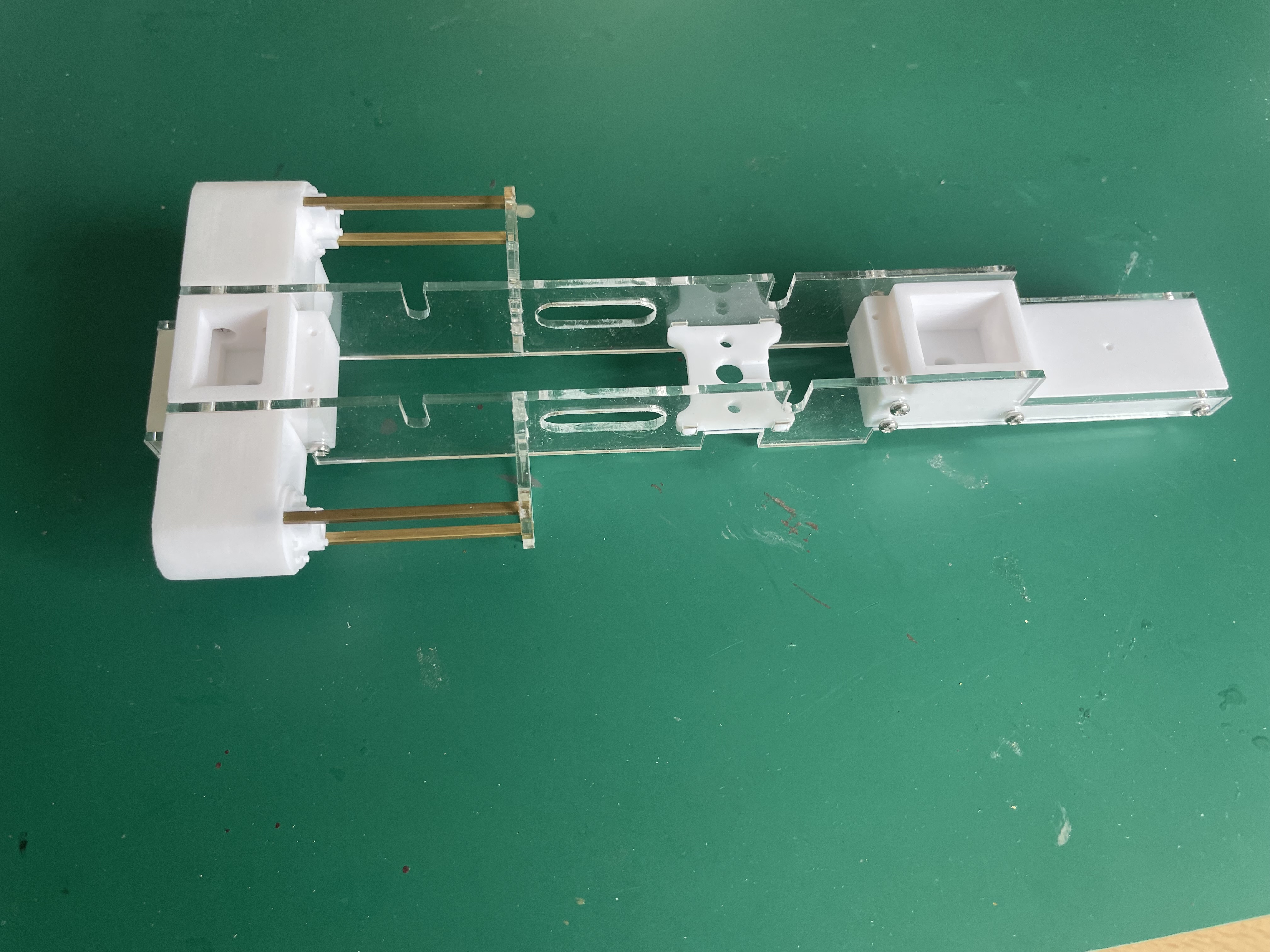

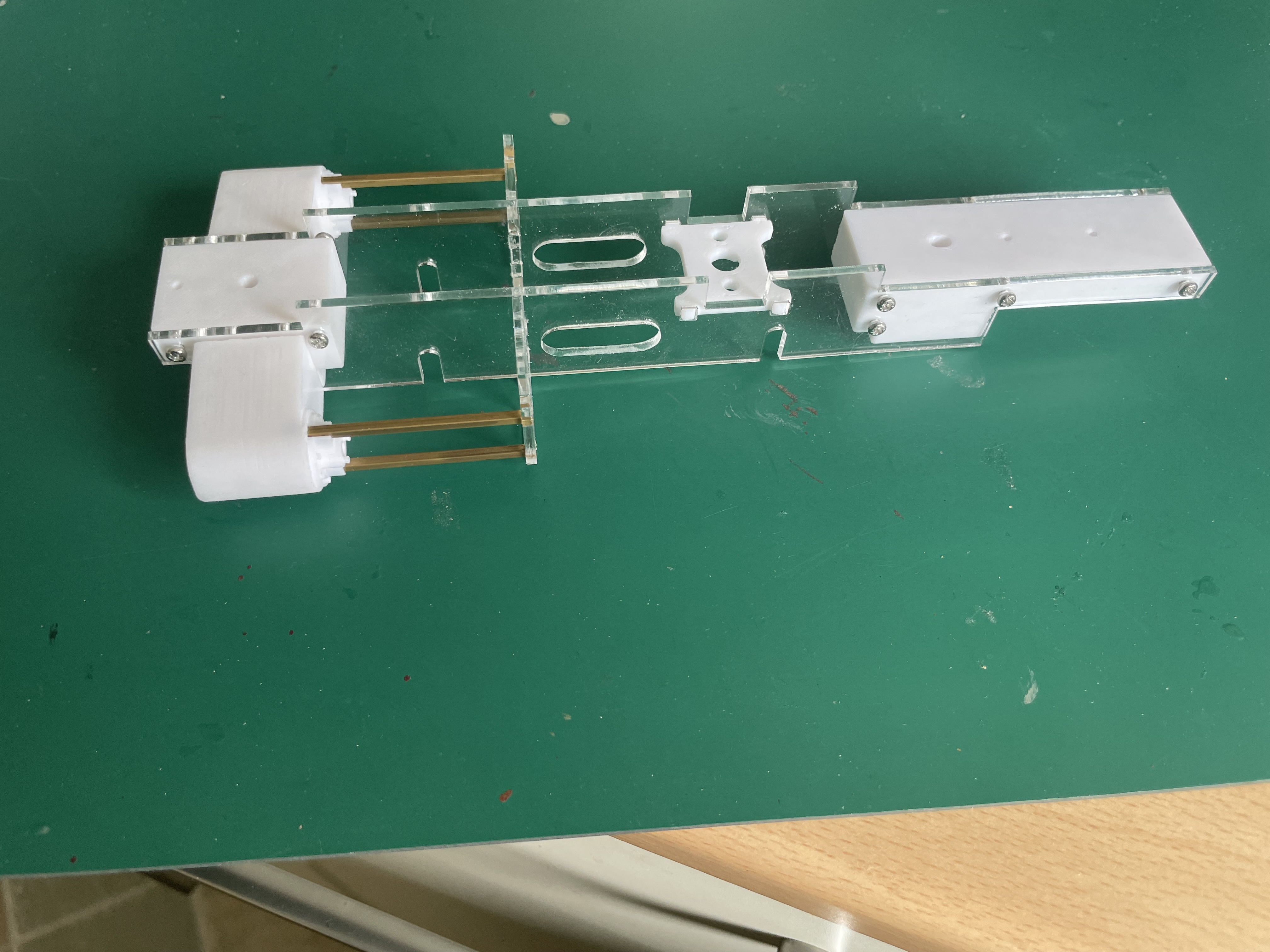

Back to kit building. I bought a Bakewell from Boot Lane at the Stoneleigh show and have started work on her:-
The chassis. and below, from below
I have done some rubbing down of the filament printed body parts and will get some filler primer on them to see how well I am getting on.

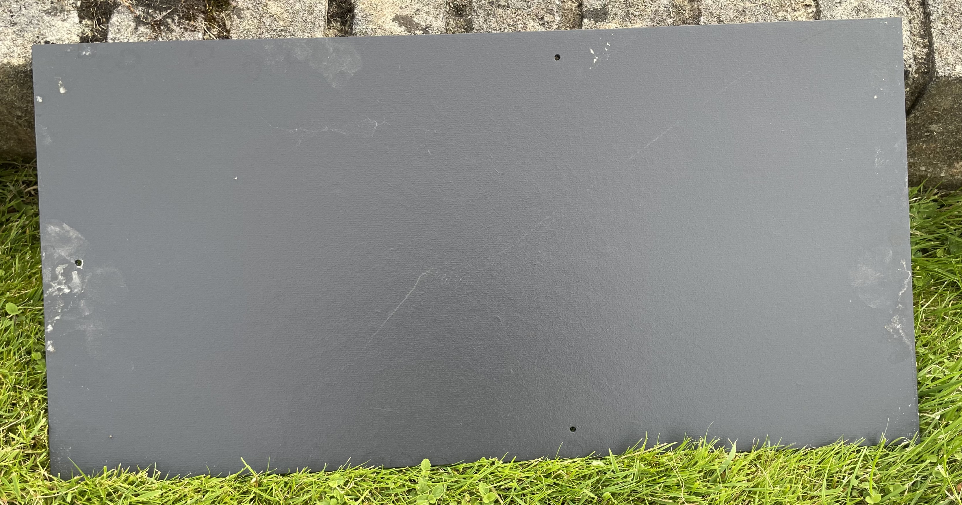

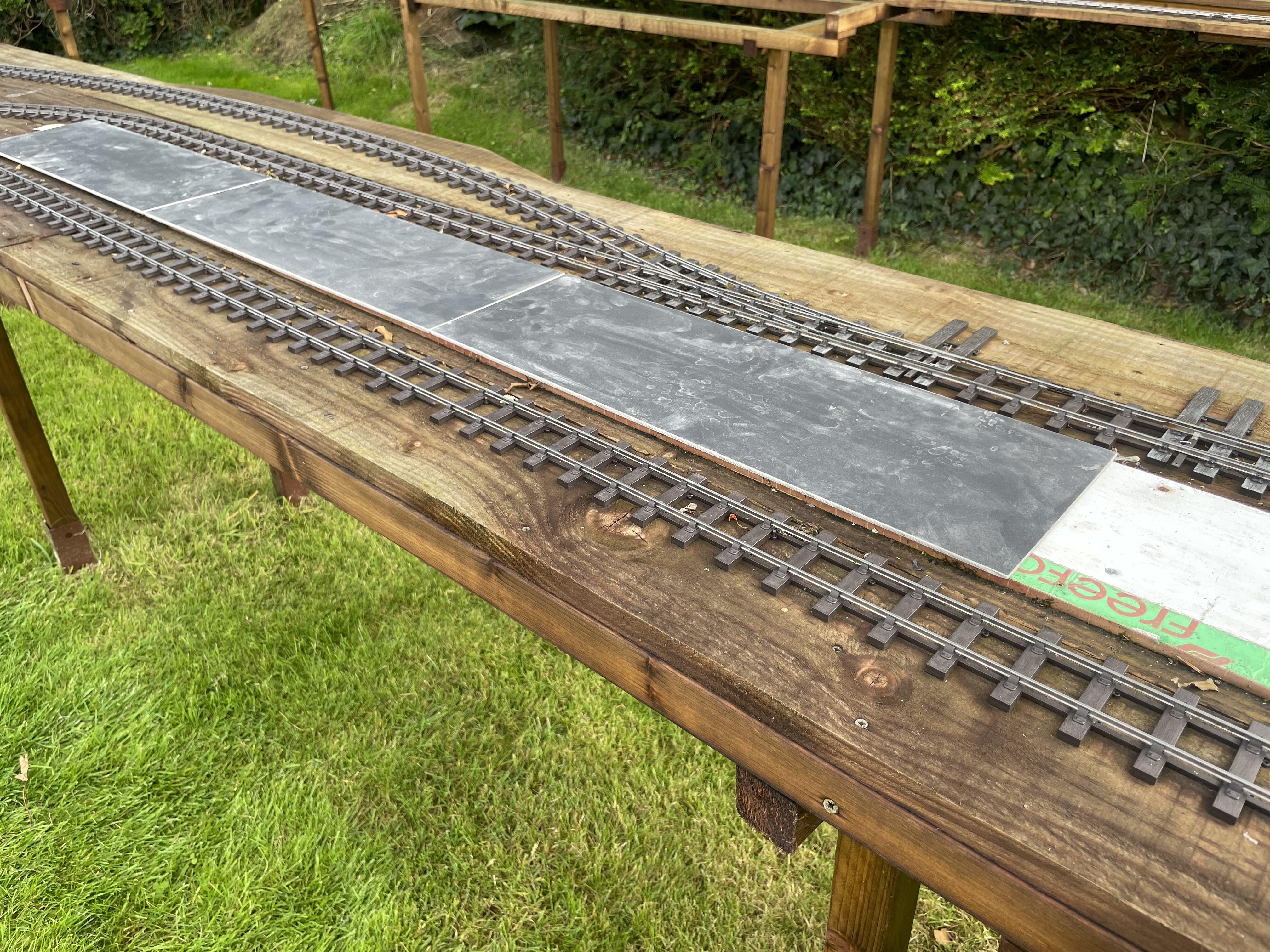

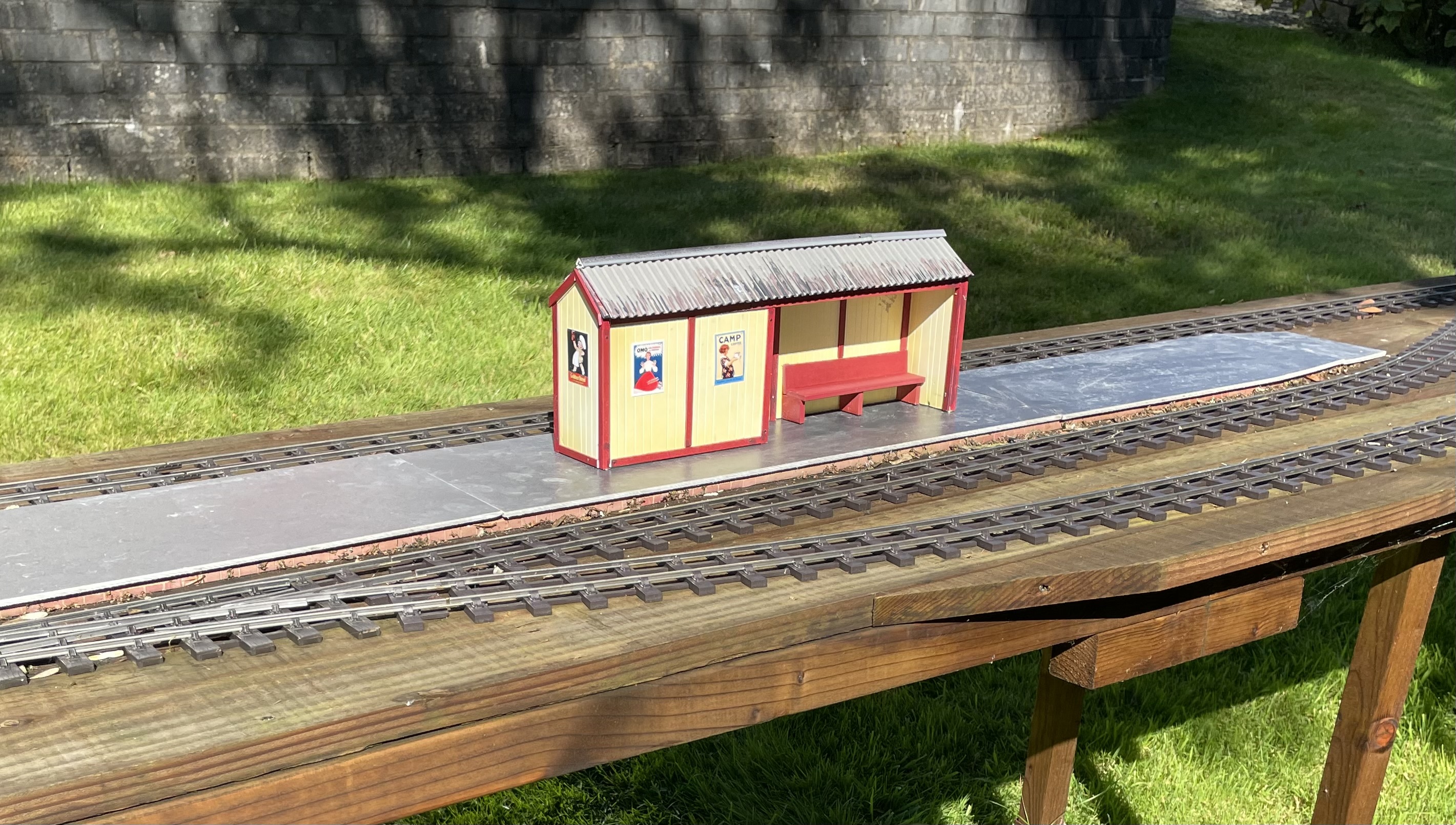

Not to be beaten (call me obsessed if you must) I have realised that the plastic platform surface would not allow me to place the station building, so kindly built for me by David John, nicely on a flat surface. Most of the platform could be lived with but no method I could see would allow it to be kept flat enough for the station building to sit level.
Platform episode 93 follows.
Thinking about a water proof temperature stable material that could be found in around 3 mm thickness I wondered about synthetic slate tiles!
This is smooth and flat, 600mm x 300mm x 4mm. I consulted a builder friend who said they were readily available and not too expensive. The material, being used for roofs is obviously waterproof, should be temperature stable and can be scored and snapped to cut it.
I tried the cutting method and found I could not do it. Then moved to a hacksaw which would cut it, quite slowly and the length is a problem. I have a hacksaw blade in a handle, which I thought I could try, with loads of patience. I marked a line down the length of tile to cut away the edge with the hole and started hacksawing, did about 60mm, thinking there must be an easier way! I have an old hard point saw that does not get used for cutting wood any more, would that cut it? It does!!!! Easily.

Post by Phil.P » Sat Aug 10, 2024 8:09 pm
Just be wary of the dust, if cutting slate..
You can do it wet, but this will grossly increase the wear on your saw.
Wash away the debris, and your hands, afterwards.
A mask would be prudent.

Post by gilfachphil » Mon Aug 12, 2024 9:50 am
Thanks Phil,
I did the cutting outdoors so the dust was wafted away by the breeze. I don't know what the tiles are made of, the surface has a sprayed on 'paint' finish, the reverse looks like resin and the interior is a light grey. I can probably apply exterior wall paint to the cut surfaces to tone them down if desired.

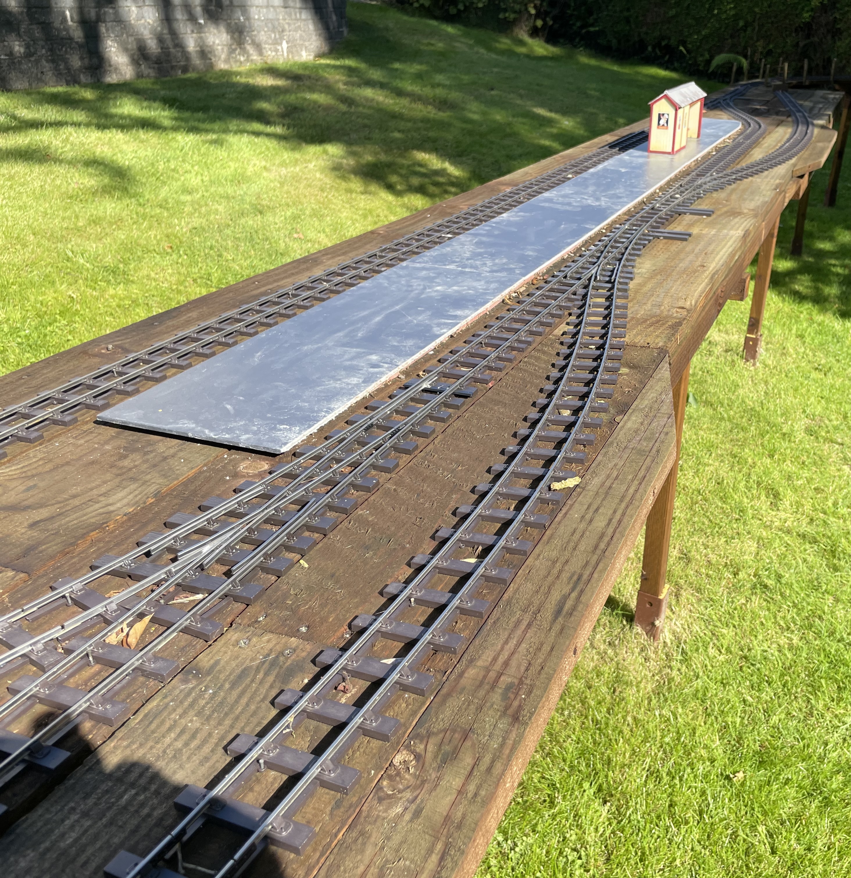

Post by gilfachphil » Mon Aug 12, 2024 5:53 pm
More progress with re-surfacing the platform this afternoon:-
The station building sitting well on the artificial slate
The entire length of the platform, near end ramp not cut to size
