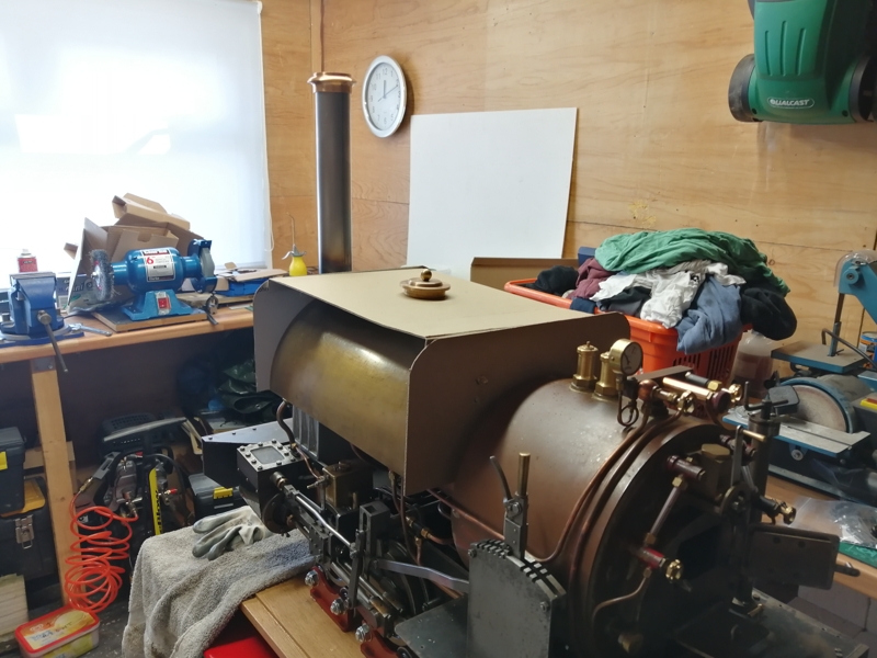

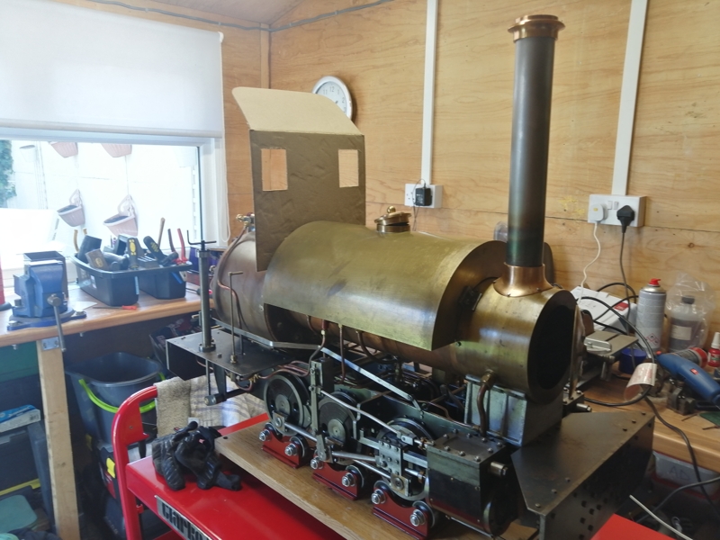

These were some open cab ideas I had (purely chosen as they would be easier to make) before I decided I wanted a Kerr Stuart Wren style closed cab which I think will suit the loco given the size of the new chimney:
Reshaping the raised section still didn't look right to me (this part was intended for the whistle to be mounted to it):
This design was based on the 5" gauge 'Titch' cab but again it just didn't look right to me:
To go with the intended Wren style cab I have also decided I want a square saddle tank (this will have the benefit of storing more water than the current saddle tank):

Looks nice - I think you were right to discount the titch style cab (it always looks odd to me).
The wren cab is quite a straightforward design, and is more sturdy than it looks.
There are a couple of variations in spectacle plate to consider. Most (like mine) have the quite minimal flat plate, but there has been at least one with a more complete cab that you might like. Hold on....
