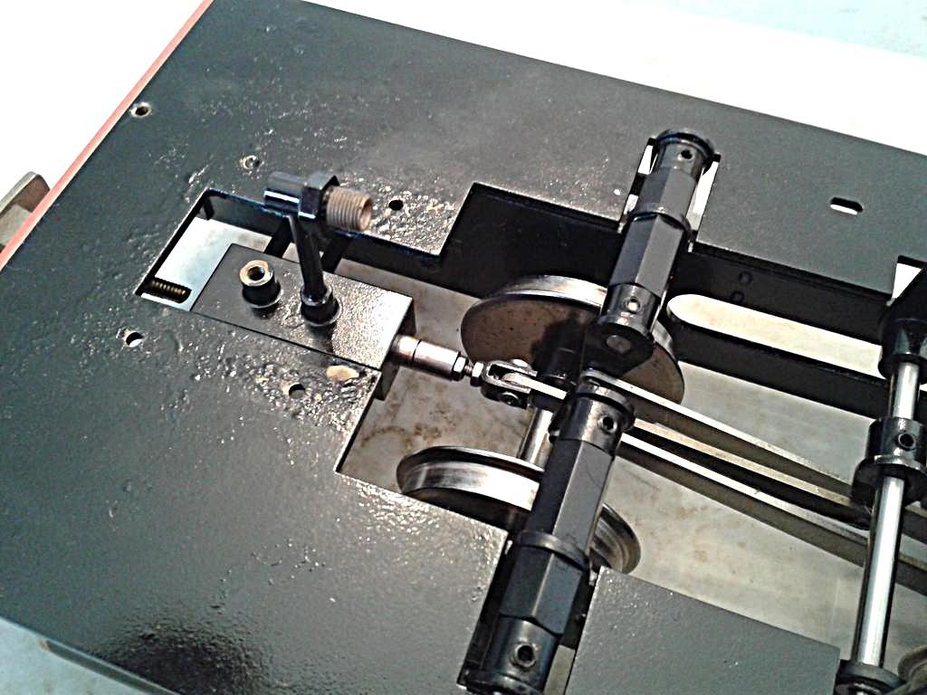

Post by tom_tom_go » Sat Jan 17, 2015 1:16 pm
This is for an 0-4-0 chassis.
From the Ruby kit manual I am reading that you adjust the reversing valve so that when the reversing lever is in the forward position the groove on the valve is just touching the back side of the valve assembly.
Out of the factory, mine does the opposite unless I am mistaken about what is forward/reverse:
To me, this is in reverse
And yet the reversing valve is touching the back side of the valve assembly:
Put the reversing lever in forward and then then valve is no where near the valve assembly:
Could someone have a look at their Edrig, Ragleth, etc please and tell me how it is set up?

Post by DLRdan » Sat Jan 17, 2015 2:18 pm
My Lawley is the same as your chassis and a quick google shows why. If you look at the picture the reversing lever on the Ruby is connected directly to the valve, whereas the Edrig has a rocker arm which reverses the action. As set you chassis should run just fine.
http://img.schienendampf.com/forumimage ... bel001.jpg
EDIT: Just thought, if you are following the eccentric setting for the Ruby then it will be 180 degrees out, so backwards will be forwards etc.
Post by tom_tom_go » Sat Jan 17, 2015 5:23 pm
Thanks for checking, makes sense now.
