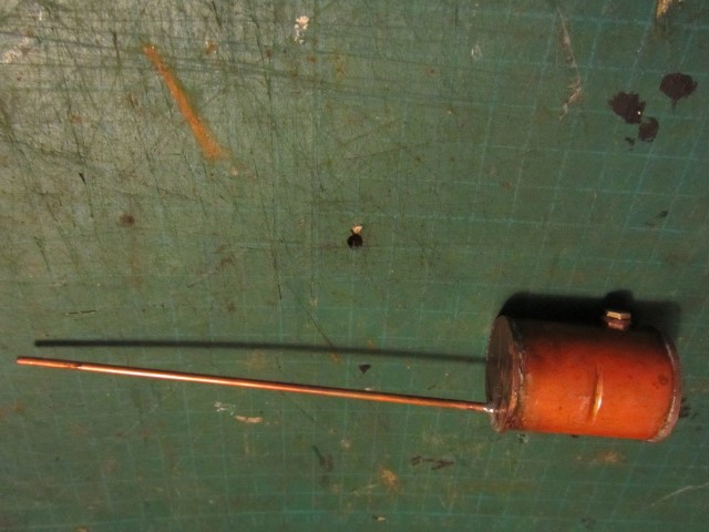

As I mentioned in my DVLR thread I have been quite busy working on "Project Raspberry". I've been keeping it quiet for a little while as I wasn't sure how successful it was going to be but I've had a few encouraging results so am ready to share. Plenty of tyro metal bashing involved here - I am a novice metal worker so there are lots of mistakes and ugly bits but I am a big believer in paint hiding a multitude of sins...
First of all we will need one of these... Any guesses?
(I am going to tidy this one up with a file tomorrow hence the ugly joins and flanges...)
Just made from a pluming joint, some brass plate from the scrap box which was filed to shape from the end. the copper pipe was just soldered in and the drain plug and drain bush was turned from some brass 1/4 inch hex, the whole lot it soft soldered together.
(to build)
DLRdan

Post by Dr. Bond of the DVLR » Sun Jul 26, 2015 8:30 pm
Interesting ideas but no.

The final part of the puzzle
Well done to invicta280 for correctly guessing. I am re-visiting my experiments with air brakes by fitting up River Deben for air brake opperation.
The tank is an air reservoir, the valve is the train brake valve (On, Off and lap - off connects the reservoir to the train brakes, on lets the air out of the train brakes), the hoses are for the air brakes and the westinghouse pump works (although not terribly reliably at the moment), I have yet to test the pump on steam yet but it runs well on 30-15psi compressed air so things are looking hopeful!
(to build)
