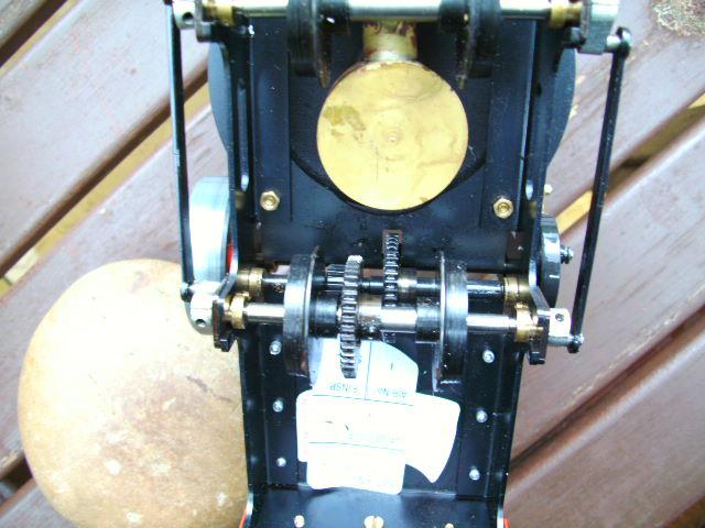

I have taken pictures of the cog's underneath plus close-ups of 'Jakarna....(Urdu for JAM!)...top wise. To tell you the truth I think the rest of the improvements must be cosmetic. Maybe the next improvement might be 'Direction Control'?? If so I will buy it to add on. I am doing this in the kitchen on our lap top so cannot down load the pictures in the camera! Just noticed that the counter on my web site has gone past the 70,000 mark and rising fast....people out there must like reading my pithy remarks about 7/8" scale very expensive kits!....more to follow.

Here are some... (hopefully) pictures that I took for my web page where 'Jakarna' will have a 'spread! Pictures show the underside particularly the cogs area and boiler,

Mamod seem to have tweaked the design once again and have reverted to steel cogs instead of brass. I wonder why.
As for flame creep, its not a problem I ever experienced once I realised you only open the gas valve a tiny amount. Any more and you get a flame that's too large to be channelled up the centre of the boiler and instead it spreads out sideways.
The sight glass and blow-down valve still stick out an awful lot. When I first bought my Brunel I had to widen a bridge.
The cylinder seems to be higher than on my upgraded Brunel. Again I wonder why as it looks like they've altered the side frames again. Peter at Mamod told me a few weeks back they'd lowered the cylinder height by a few millimeters so the steam pipe to it would be horizontal but now it seems they've reverted back.

That is the first time I have seen a Brunel look at home on someone's railway, any idea what the new gear ratio Is ?
mikewakefielduk@btinterne
Post by mikewakefielduk@btinterne » Wed Jun 11, 2014 4:03 pm
Approx 4.5:1 (I lost count on one of the cogs)

Does anybody know why Mamod lowered the engine block on the latest Mamod Brunel??? I cannot understand what this will achieve....

Bill/Rubery wrote: I cannot understand what this will achieve....
To lower the Centre of Gravity. When I ran my Brunel I had to keep the engine block on the inside of the curves so it was less likely to tip over at speed.

Post by Bill/Rubery » Mon Jun 16, 2014 8:32 am

As Mike posted above your Brunel Mark II has, for whatever reason, the cylinder mounted higher than the Mark II chassis that Mike was provided with to upgrade his Mark I.
Mamod posted photos of their Mark II with the brass gears and lowered cylinder here - https://www.facebook.com/photo.php?fbid ... =1&theater Click Next top right above the photo as there are a total of 6 photos posted there.

With the change to the gearing the Brunel will be much slower and so less likely to tip over on curves. Changing the buffer beams to white metal will lower the centre of gravity but won't help the side-to-side weight distribution. For that you need to place counter weights under the frames on the opposite side to the cylinder. I used steel blocks but lead would be better.
