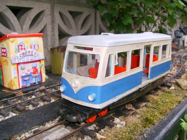

Won a faller railcar on ebay £25.25.. looks to be missing the horns and a few internar handrails and add says no driver or drivers seat(all no problem as it will be having my own driver.. and will eventually be repainted(well the bit above the stripe line will be painted) and the intercity bit removed.
possibly also be another to join it so i have a 2 car railbus..
This will also be converted to radio control using my normal RC units.

Good little units these.   I have 2, one of which I converted to RC using a unit from a cheap car. Just forward/reverse, no speed control but my 3yo grandson thinks it’s great.  I managed to shoehorn  the RC gear (which included increase of batteries to 4.5v) under the running board. Must post a pic.
What are your "usual r/c units” and how will you deal with the fact that it has 3v power on board, Most RC seems to need more.
Your wheel arrangement looks strange. different spacing on the power bogie. Mind you the power bogie is largly the same pieces as the chassis from their 0-6-0 locos!

This 1 arrived today(bearing in mind i work nights i still got up to unwrap the parcel(like a big kid))
popped some batteries in it and away it went round a circle of track..
I plan to cut away the battery box and fit a 4X1.5 AA battery box which gives me the 6v for 2.4rc... I hope to fit the rc and micro speed controller underneath or maybe on the floor inside and charging socket somewhere.. I have 2 other faller locos and they run ok on 6v but I do restric the max power to the receivor by lowering the max throttle from TX unit... I am also pretty sure the faller motors are 3-6volt and on another note if you ever get a track powered loco 6v will make them run very slow and will need remotoring(I got mine from ebay and its a case of removing the worm gear on the old motor and refit to the new but I put a little glue to hold the motor in place..
on the battery ones I reakoned if the motor does pack up then its not difficult to put a new motor in place.

I think you'll be able to respace the wheels to something a little more equidistant-looking by re-using existing holes. I think these railcars probably came with a Bo-Co arrangement - whover owned mine before me had removed a different wheelset to whoever owned yours!
I'm very fond of my little railcar - I've retained the underside switch so it can automatically shuttle back and forth...

After I checked it worked the wheel which is unpowered on driving bogie is just clipped in place and I moved it closer to the powered one so it looks better.. When I Rc mine I will cut off the underswitch along with the others as they wont be needed..
Then test run for a few weeks to make sure all is ok then a repaint..

the railbus now has 2.4ghz radio control and the unpowered bogie has now been set further under the body to match the powered bogie so it looks a bit more even..
Planned also for the coming month is interior lights and running headlights and a repaint above the swage line and roof(which is removable and doors open as well so easy to put a few people inside
