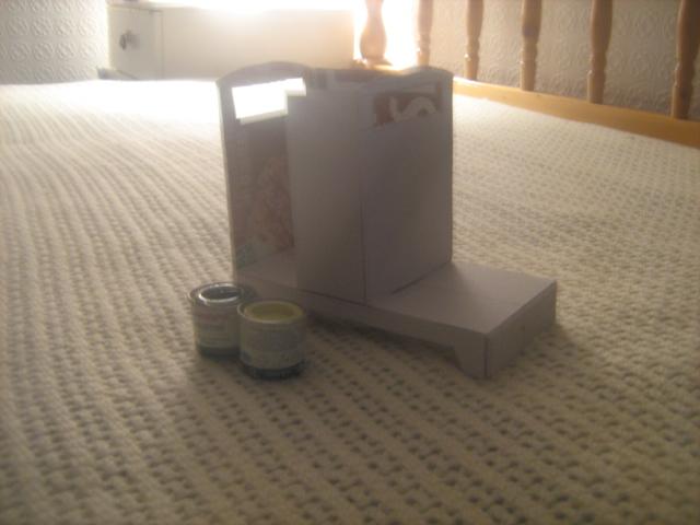

Post by Hancockshire » Wed Oct 14, 2009 7:16 pm
Here's is the card Mock up. It looks exactly like what a simplex should but I'm not too sure about the height
Dave
Post by Dave » Wed Oct 14, 2009 7:32 pm
Hi
Looks good try taking 5mm at a time off the cab base until it looks ok
Dave

Hancockshire
Post by Hancockshire » Wed Oct 14, 2009 8:39 pm
Cheers Pete. I'll do what Dave said, chop off 5mm at the base. Thanks for the picture, now I could get those fine details but I don't know where to get a radiator grille. What did you do Pete on that simplex you made for the STT?
