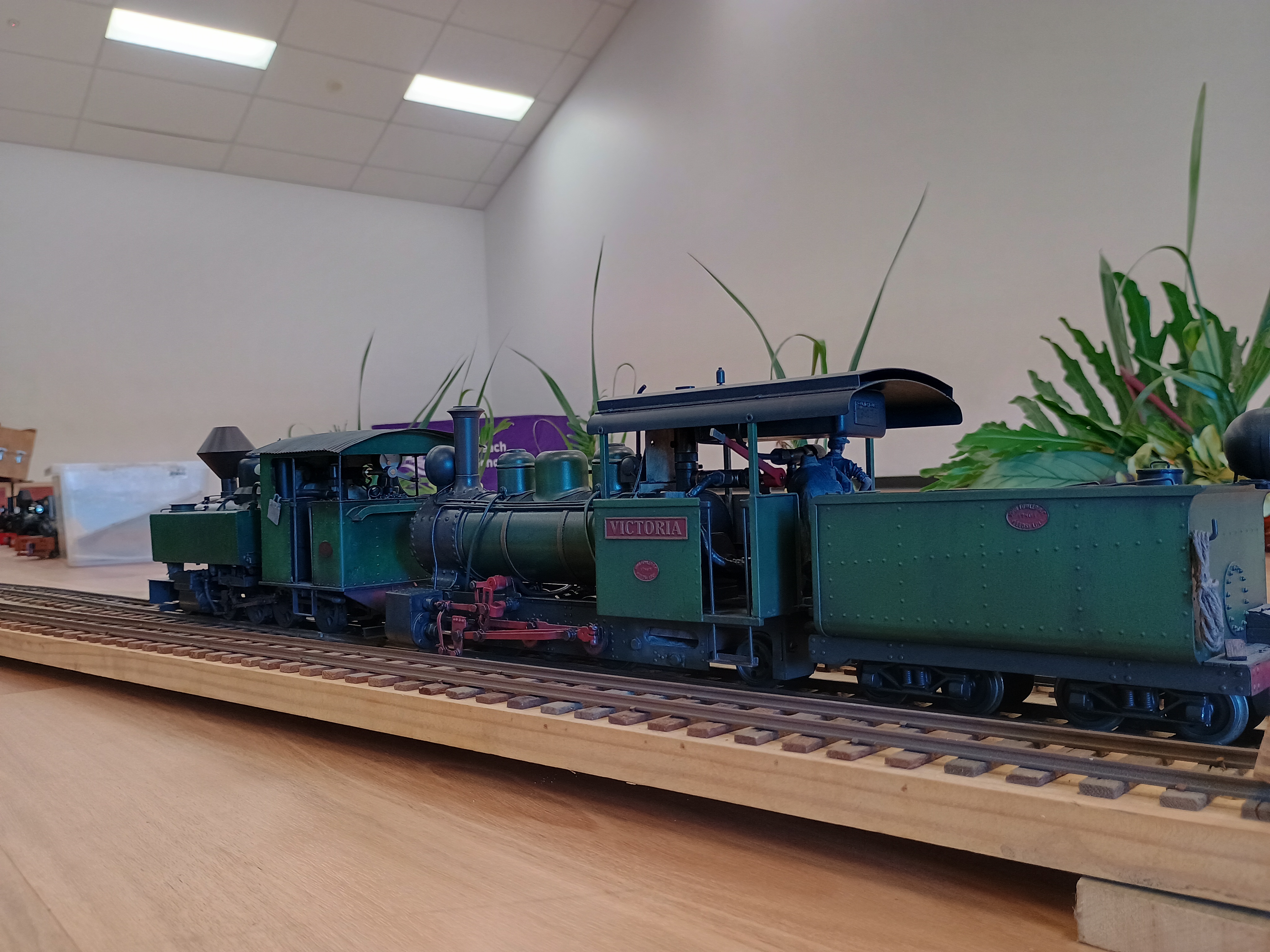

An aerosol clearcoat later, and the usual enamel "grime wash" was applied and wiped off over everything. Plenty more dry brushing, some more oils, enamel washes here and there, and just a little bit of powder, topped off by a light dusting of soot over top with el-cheapo (if you can call $9 a can cheap) flat black spray paint.
A removable coal load was made, with a magnet hidden in the coal for easy removal. A small tray was made up from veneer from the wood scrap tin, and fitted to the front footplate, along with some whitemetal tools. Another clearcoat later, the loco was ready for testing, the day before WinterSun.
01/08/26
After clearing a blocked gas jet on the day, the loco ran rather well. Though I still need to fit the TTD gas spindle and extend it and the regulator, so they can be reached from outside the cab. Chuffer still in the mail..
First firing turned the clearcoat glossy, as happened to the Fowler "Victoria". The solution then was a quick recoat, and I'll do just that..
The loco was very well received - I almost don't recognise it.
The former combat veteran looked right at home with it's Fowler shedmate.

A trip to the former sawmill runner photography bench at the Woodford Railway always makes for nice ex-works photos.
Well, this has been my fastest rebuild, by far. It's been nice not to worry about headlights and wiring.
