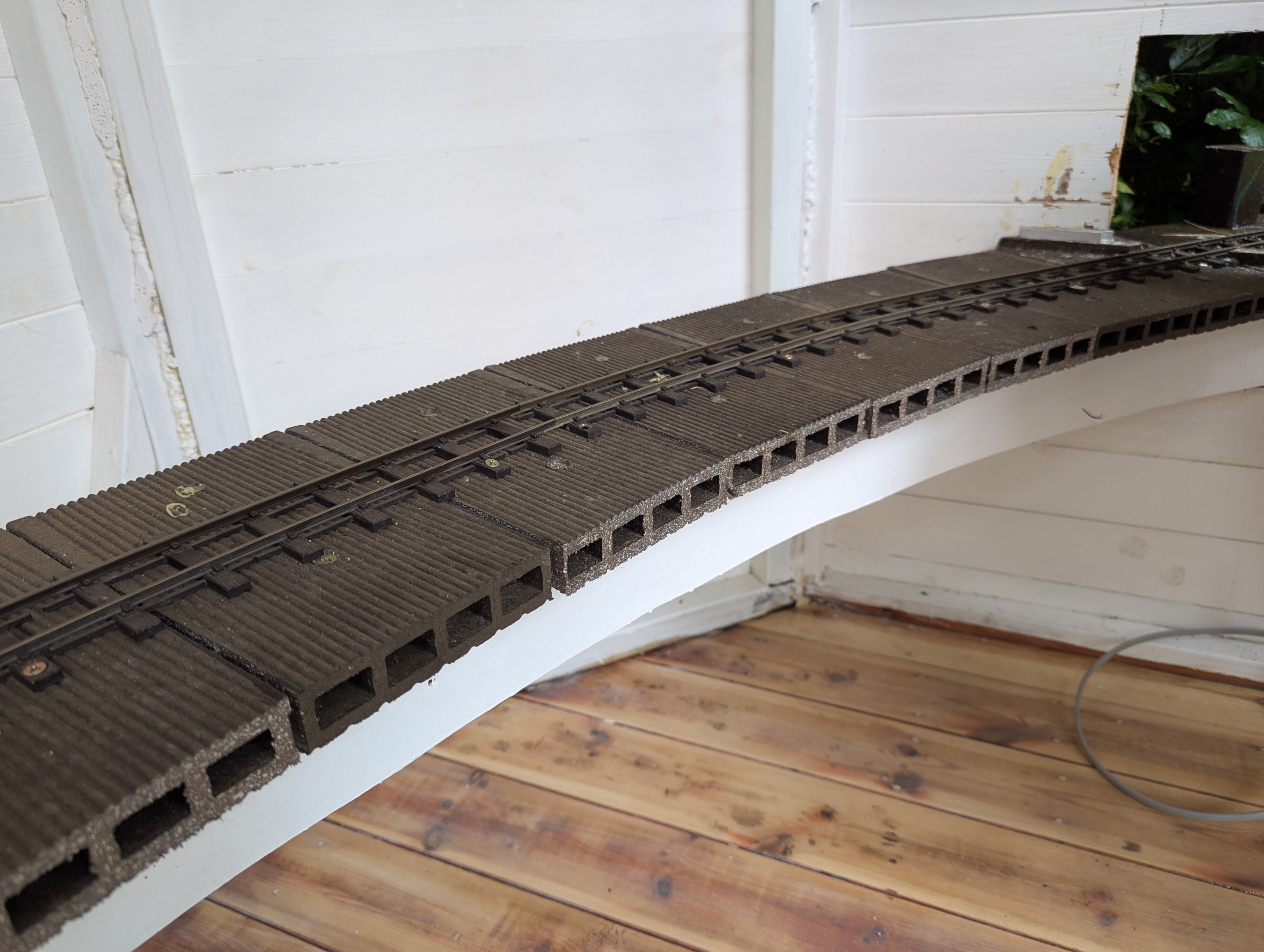

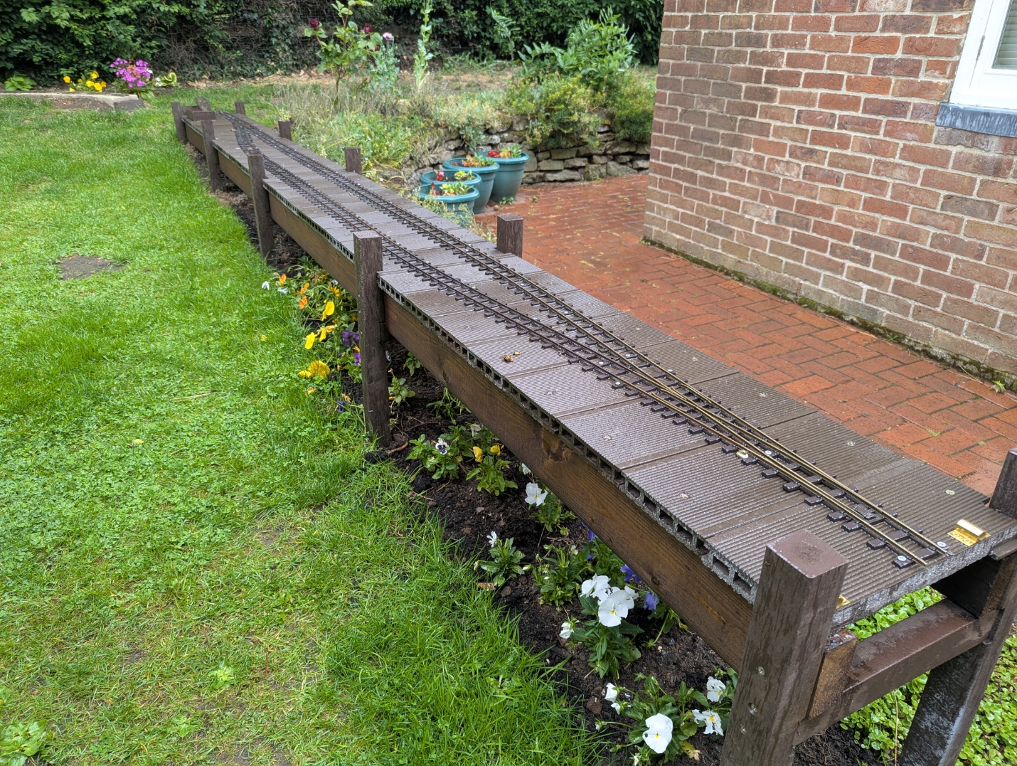

This is my solution. I re-used some plastic(?) decking boards taken up from a koi pond that had become too much. You can see that I have used the boards across the width rather than longitudinally. This is because their one weakness is a lack of structural strength - they need a lot of support underneath to prevent sagging. The section running through the station building (a.k.a. summerhouse) is constructed on a bent ply structure. Outdoors the boards run on well creosoted (modern equivalent) timbers held off the ground by 50mm by 50mm plastic posts - again from the old decking. You are unlikely to have some old plastic decking hanging around but this came from a builders merchants - Travis Perkins I think. I certainly did not pay Filcris prices!
Hope this helps.
