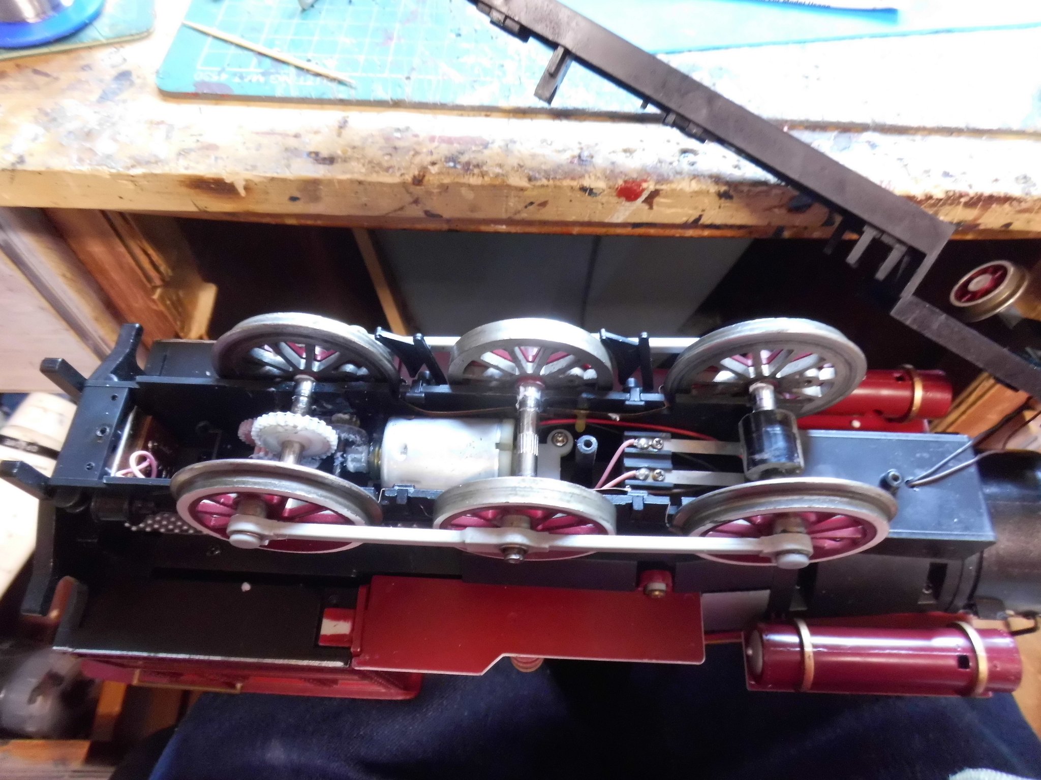

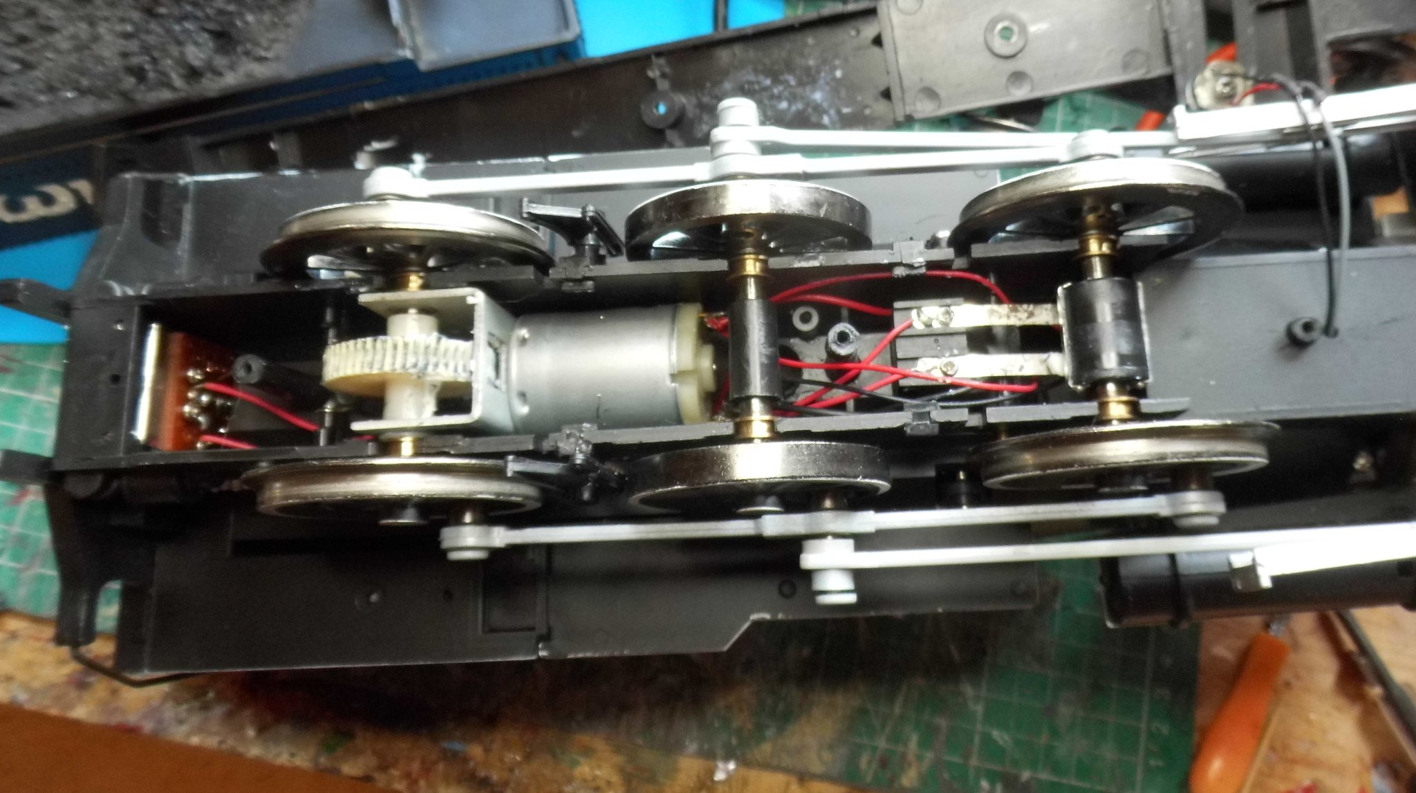

I was asked to convert a couple of Bachmann Big Hauler 4-6-0 locos to battery RC.
When I took the second one apart I was surprised at how different it's mechanism was to the first loco I had just finished converting.
Also, its fittings and the quality of its plastic were poorer quality. It turns out there were at least six "Generations" of the model - each with different mechanisms. They gradually improved the quality over time.

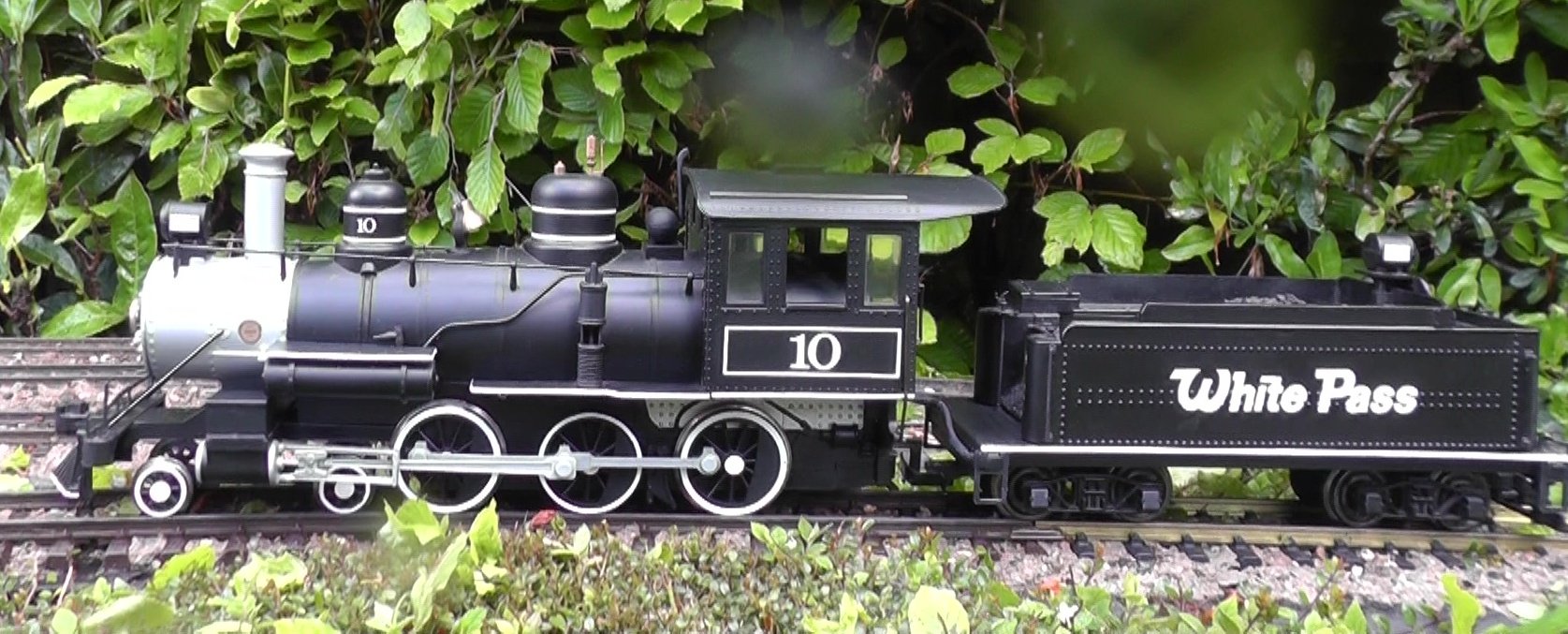

As fate would have it I have just been gifted a Bachmann Big Hauler set which contains the No 10 loco.

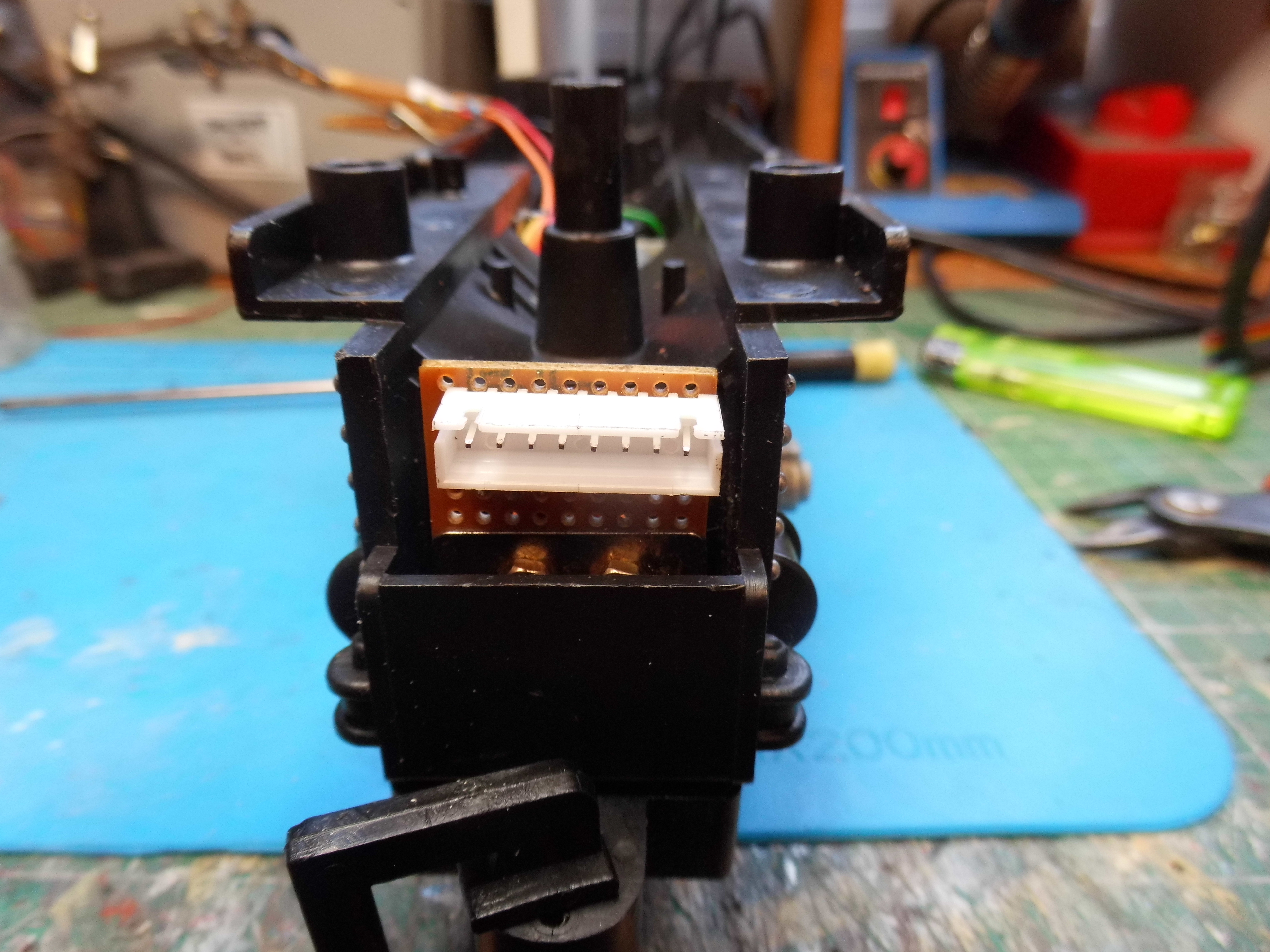

Hi Graeme
Mostly gutted it. Starting at the front, I replaced the filament bulb with a 3mm LED. I kept the smoke generator in case the customer wanted to use it, I added some lead to the pilot bogie as that seems to derail easily. I stripped out the wiring and removed the wheel contacts then replaced the switch and two pin socket at the back of the cab with a piece of Vero board on which was mounted an eight pin JST socket (a six pin will do - pos and neg for the smoke generator, LED feed, chuff cam output and the two leads to the motor).

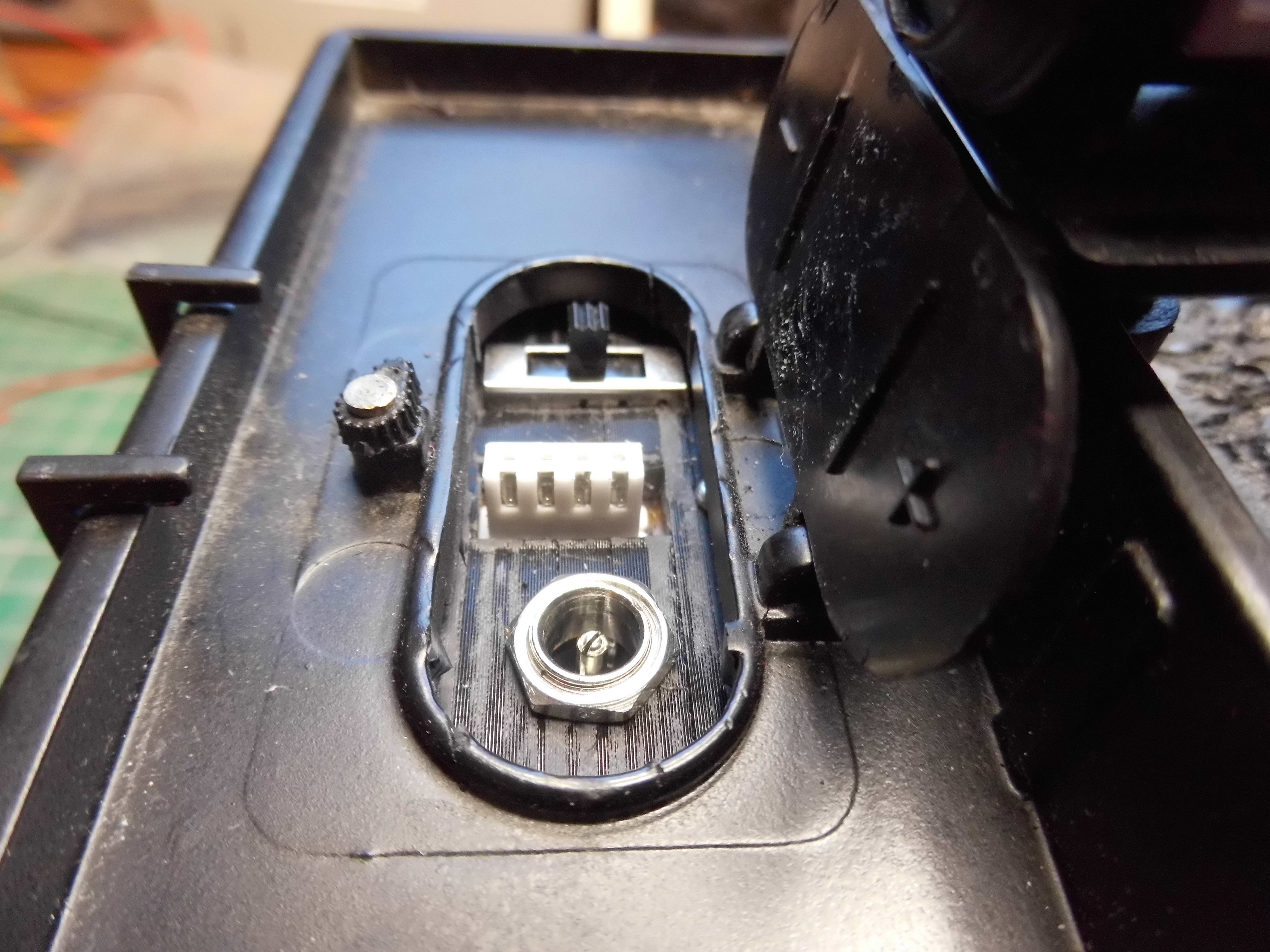

In the tender, I removed the chuff board and the mounts for the 9v PP3 battery. I retained the speaker and added a Micron soundcard and an MR603 receiver. I made a 3S battery pack from three 4.5Ah 21700 li-ion cells (with BMS). I reprogrammed the receiver to trigger all the sounds using the buttons and switches on a Micron Tx22X transmitter. I mounted an on-off-on switch and charge sockets on a 3D printed mount so they are accessible when the flap for the PP3 is opened.
