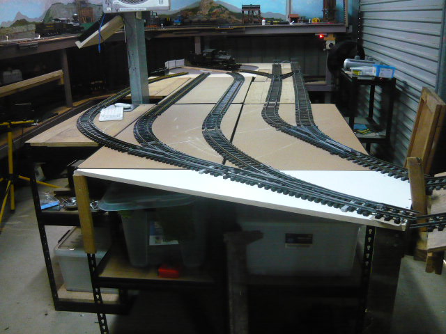

by GAP
I used racking to build part of my layout, it is sturdy but light weight.

GAP wrote: Tue May 12, 2026 10:24 pm I used racking to build part of my layout, it is sturdy but light weight.
I like that idea, and will look into it. Have you put any form of cover or protection on it?

by GAP
Wet Woking Neil wrote: Thu May 14, 2026 12:31 am
The steel is powder coated straight out of the box, it is workshop racking.
The timber will get a coat of paint and as it is under cover it will be OK.
If I was doing this on a verandah/porch I would paint the timber with exterior paint.
