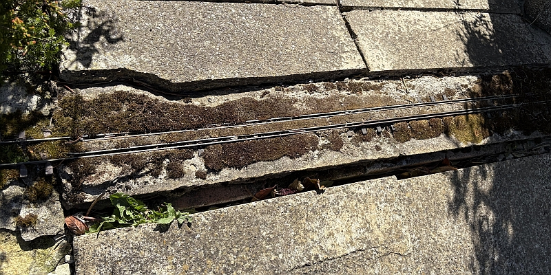

I have two Peco track level crossings buried in cement as you suggest, and one has been down for about 12 years and the other about 10 years. Over time they have taken loaded wheelbarrows, the mower, a freezer on a trolley and countless feet. They are looking a wee bit sad atm, but that is mainly due to our clay soil heaving and generally doing it's own thing moving the adjacent slabs, the track bases are still solid and aligned.
Construction was pretty straightforward. Standard Peco 32mm track screwed down to the concrete base then checkrail chairs glued on as necessary, then pack some card strips into the flangeways to keep the cement out then tamp down your concrete. I did press some ballast into the top surface, but most of that has disappeared over the years. When it is solid but still 'green' pull the packers out and carefully clear out anything that has got in anyway!

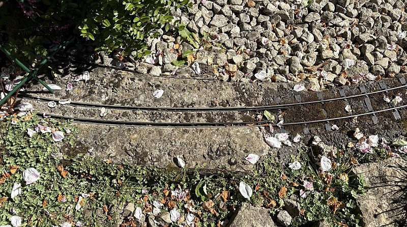

My first picture shows it on a curve. Its so long ago that i can't remember details unfortunately. I have a vague memory that they could have been Tenmille ones but if push comes to shove, you could slice ordinary chairs from a piece of plain track. You don't need many, the cement will hold it in place in practice. The other thing you could try is putting small nuts and bolts through the sleepers and soldering rail to the bolt heads, but you need to be quick to not melt the sleepers!

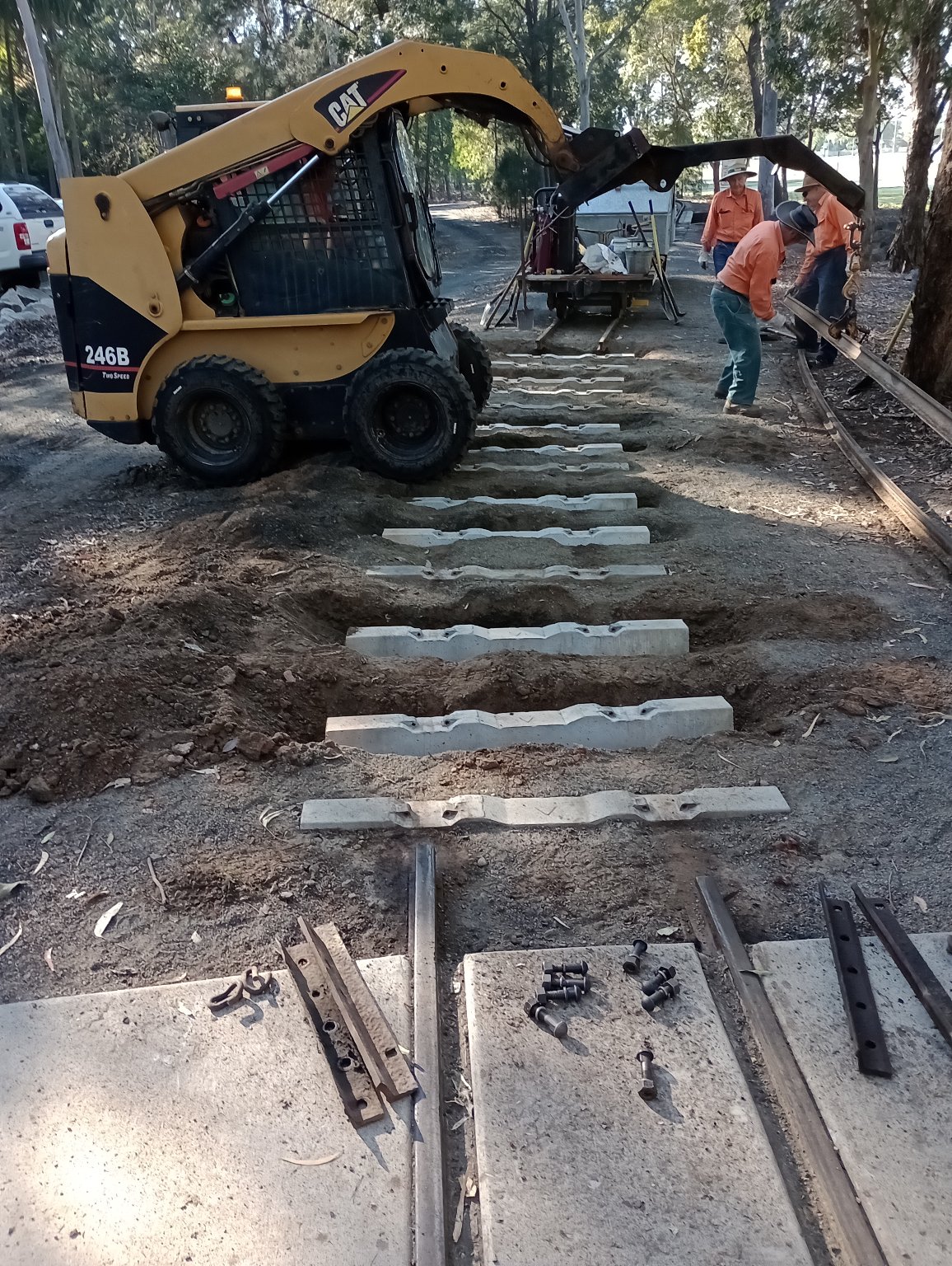

on our 1:1 scale track we do not use check rails for our road and path crossings rail spaced with steel sleepers and a piece of box steel laid beside the rial wider and a bit deeper than the flange and concrete or bitumen poured over reinforcing mesh. They have all sorts of garden maitnenance equipment including excavators, backhoes (JCB's) bobcats and tip trucks with no sign of falling apart after years of use.
The road crossings are on public roads with a fairly volume of traffic.
Personally I would not use the peco sleepers but pieces of plastic wood or even treated timber with slots cut into them mainly for strength and give a stronger base for loads they are there there only to hold the guage after all.
