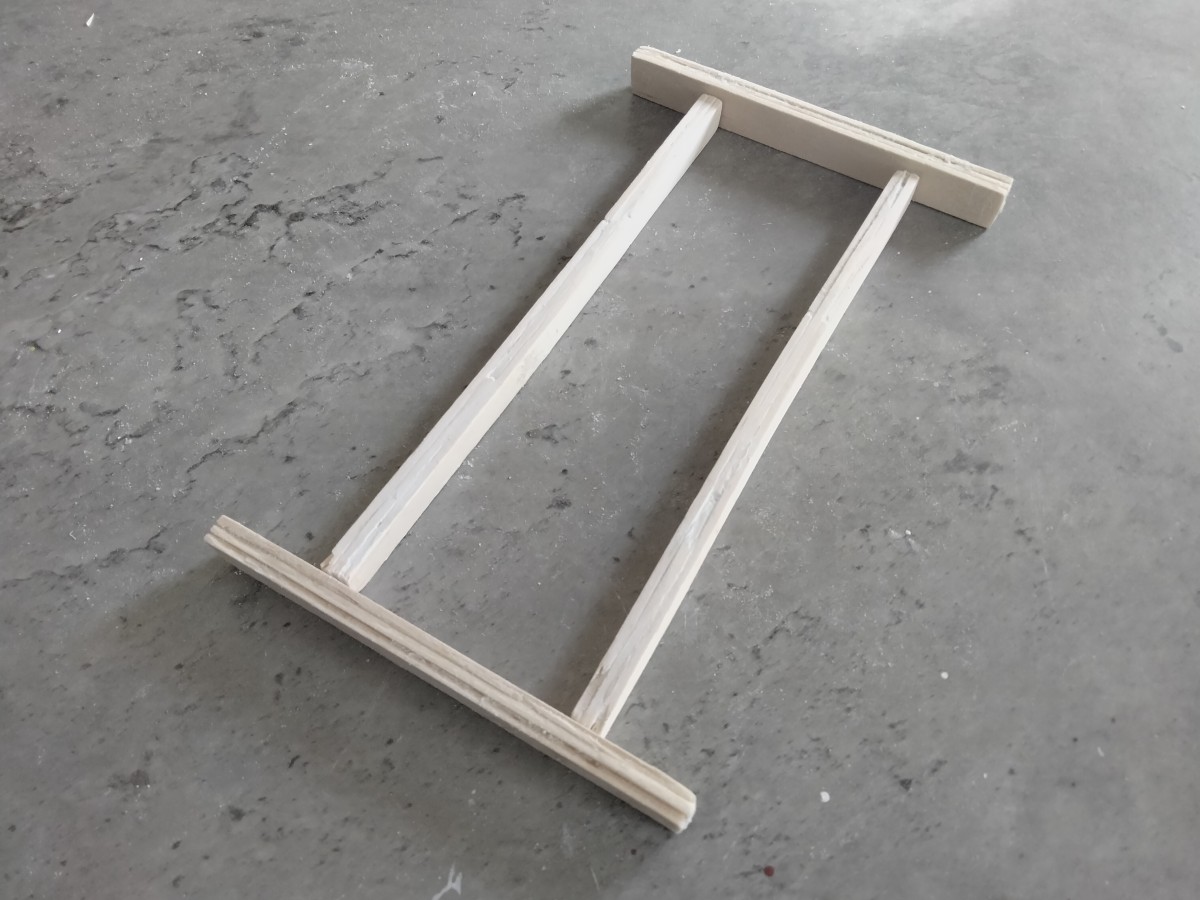

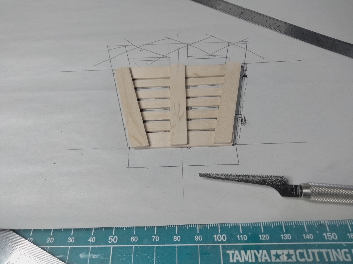

Started a scratchbuilding project loosely based on typical peatwagons, used in Finland but also I have seen similar designs used in many other countries including UK and Ireland. Underframe is done by laminating 2 mm thick sticks together in order to get a 6 mm thickness. Now started to build the wagon ends.

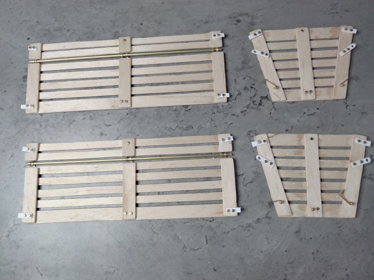

Re: Peatwagon - scratchbuild
Posted: Wed Apr 15, 2026 3:20 pm
by Allu

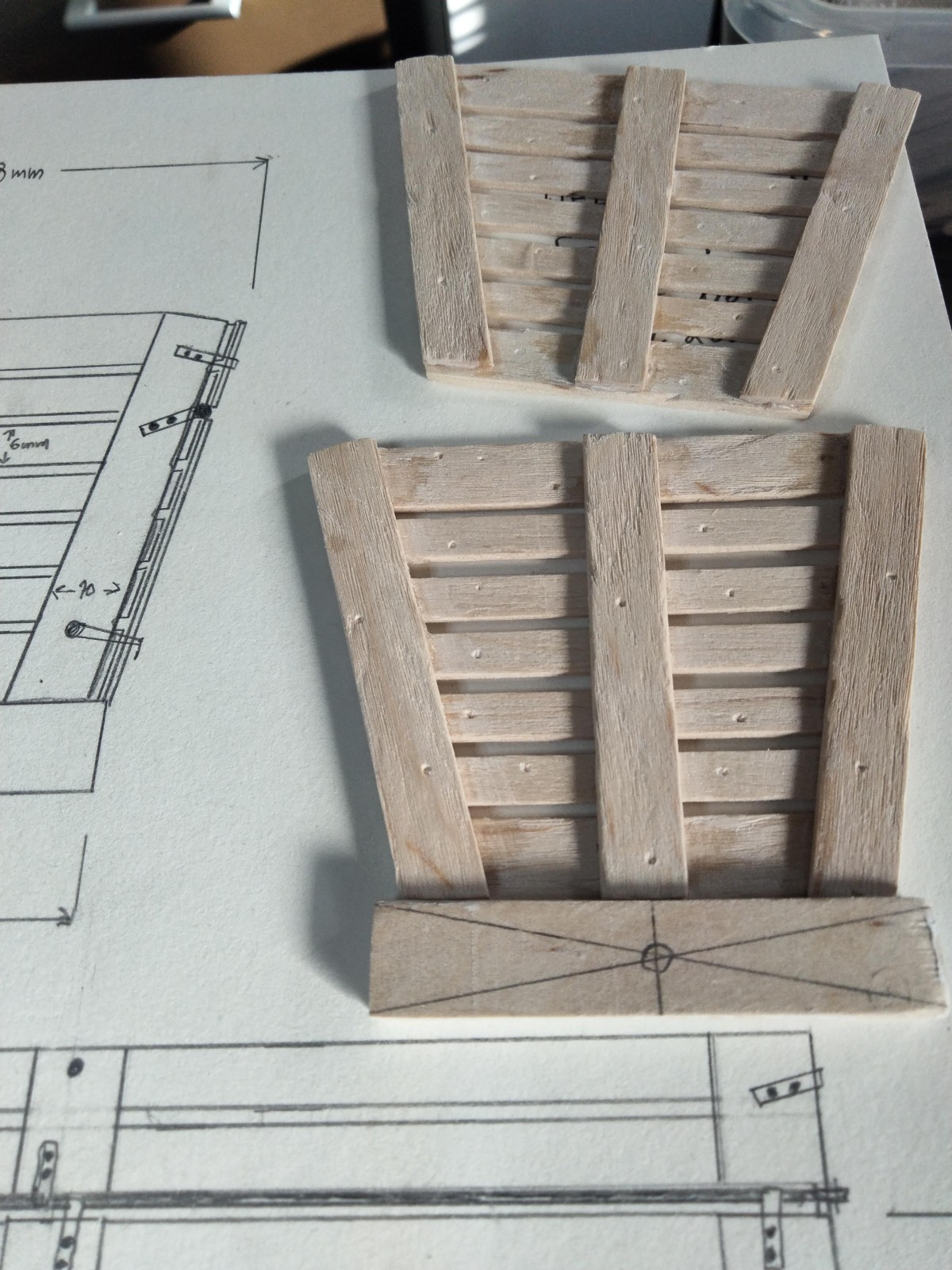

Wooden parts for the ends start to be ready. I distressd the wood and created more natural grain with a wire brush attached to a Dremel. Next probably the sides as I am still gathering material for the metal strappings and bolt heads.

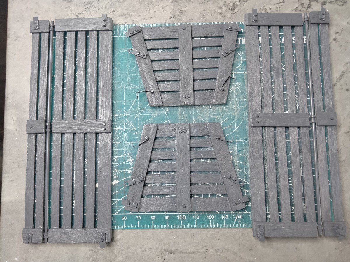

Posted: Mon Apr 20, 2026 3:20 pm
by Allu

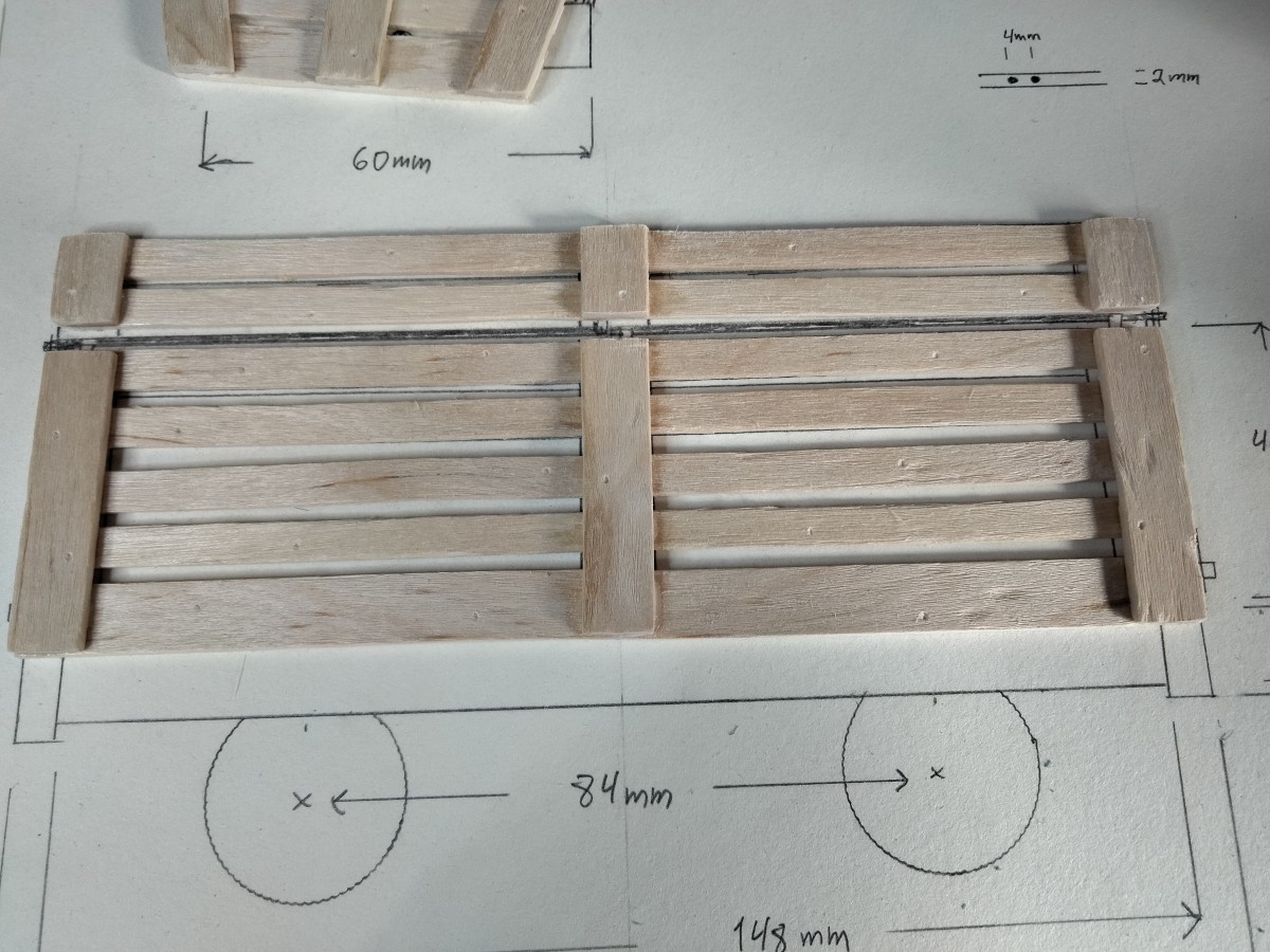

Sides start to be wood-ready...
Posted: Tue Apr 21, 2026 7:54 pm

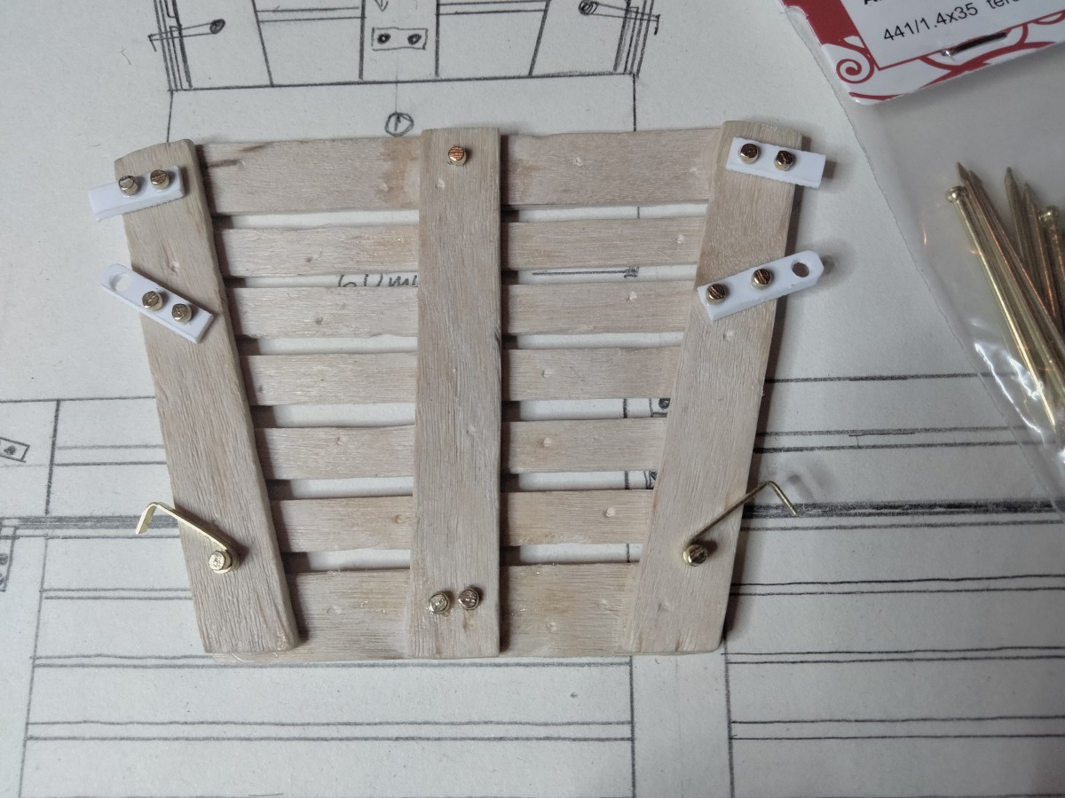

by Allu
Started to do boltheads, some strapping and latches.

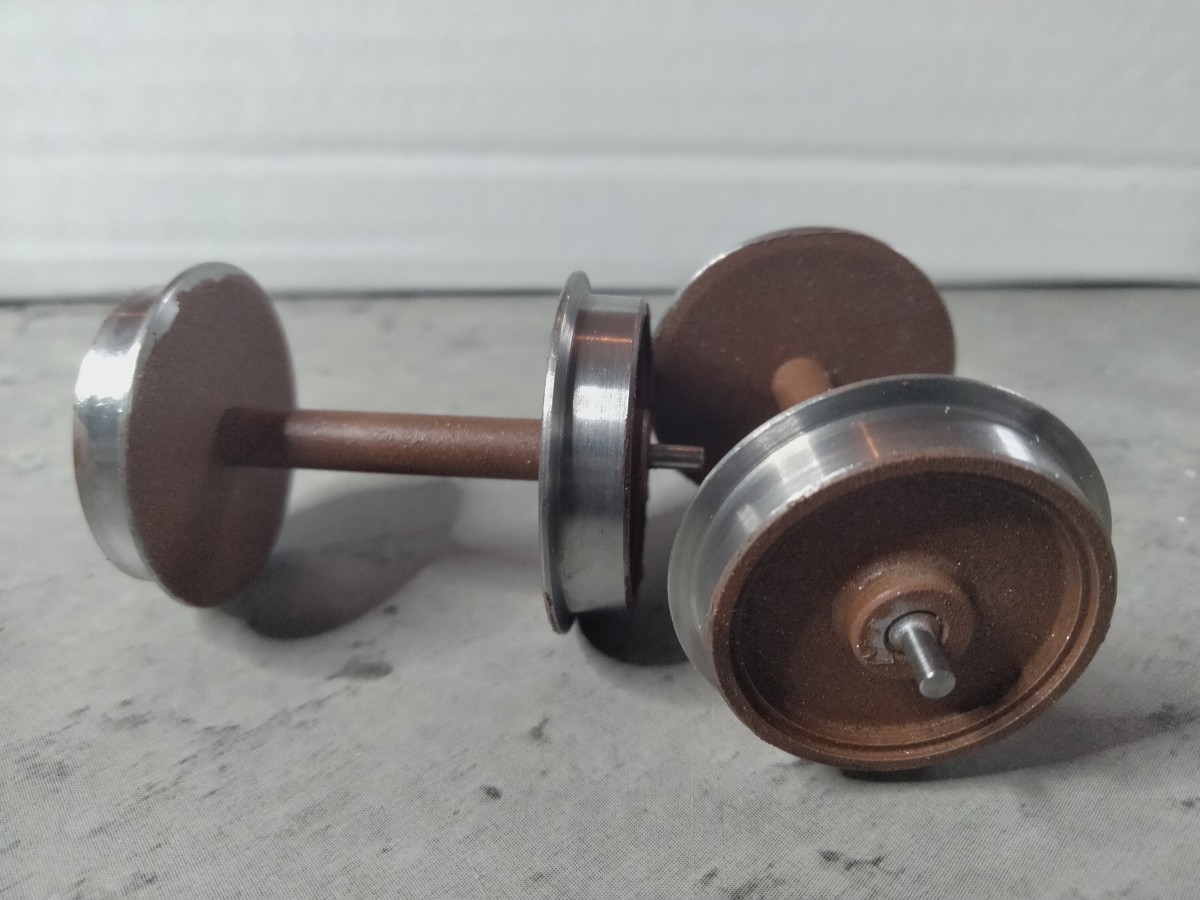

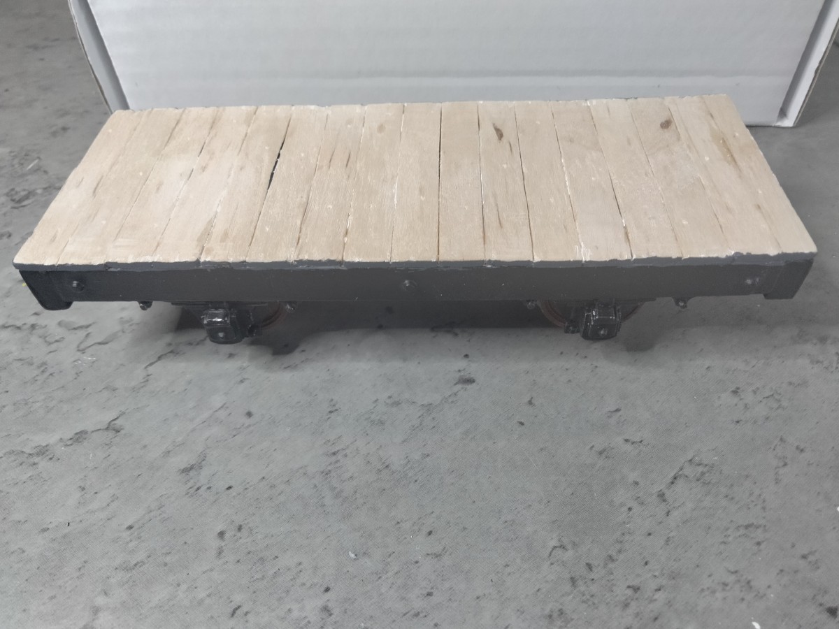

I sprayed the wheels with Rust Effect from Dupli-Color. It creates a nice real rust looking texture. I masked the treads and flanges before painting.
Undercarriage and wagon floor done.

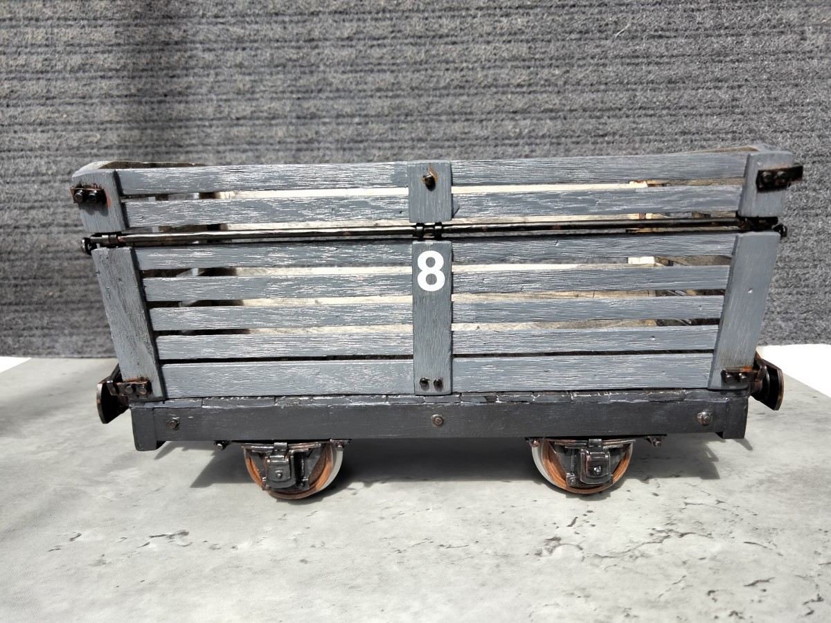

Posted: Fri May 15, 2026 12:57 pm
by Allu
Basepaint done

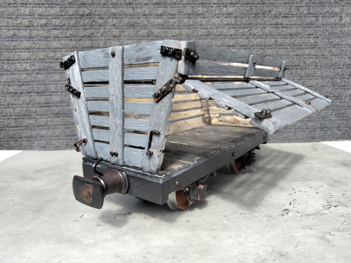

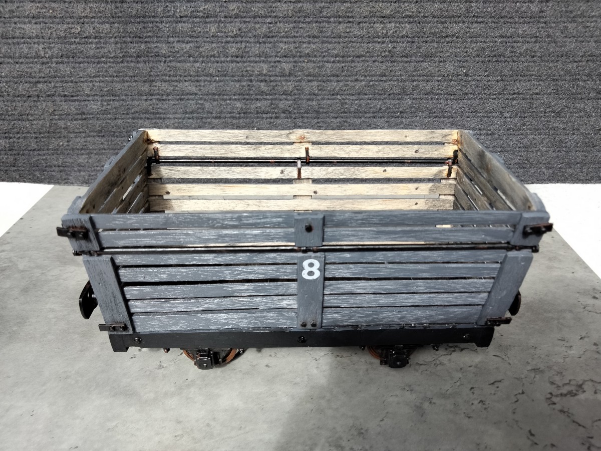

Posted: Tue May 19, 2026 1:35 pm
by Allu

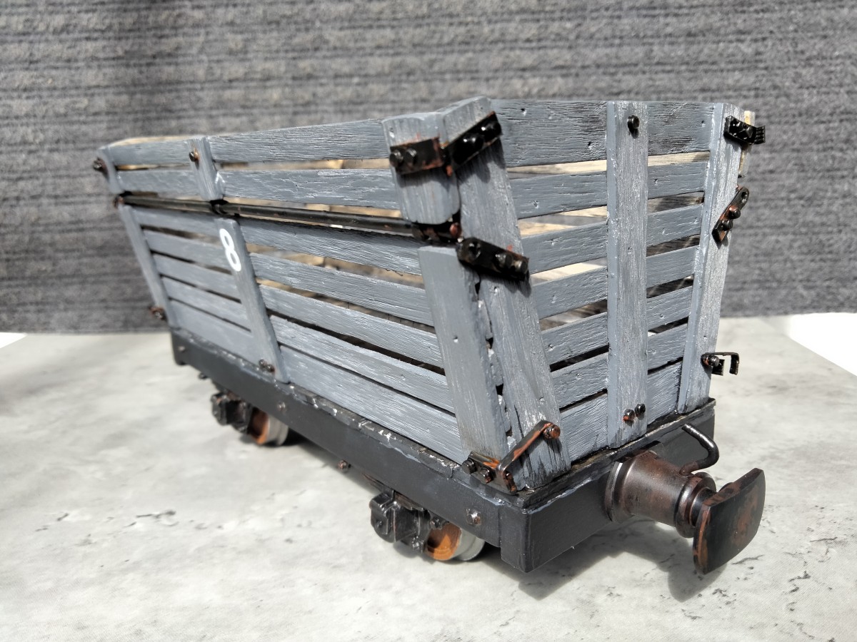

Posted: Tue May 19, 2026 1:36 pm
by Allu
Now finishes. Some weathering still to do
