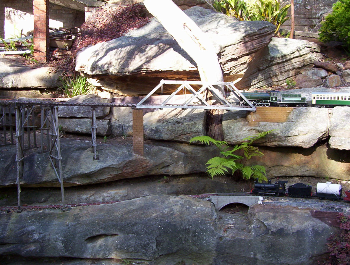

This timber truss bridge on the Sandstone & Termite has served for 25 years, and is still in great shape.

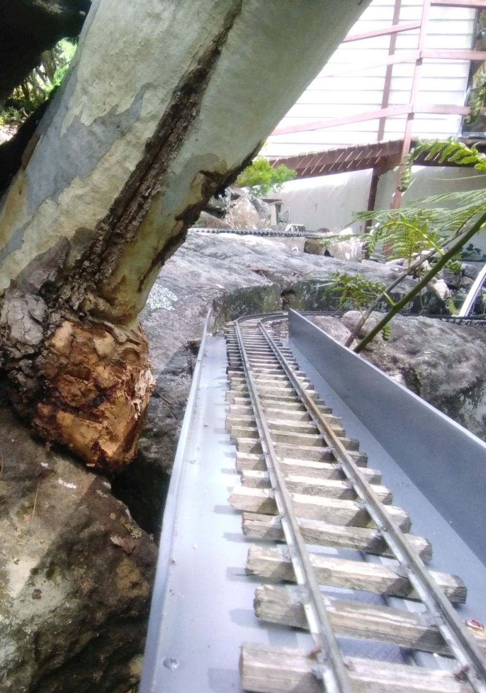

BUT, what was a small gum tree when I built it, has now grown so large that it is leaning on the bridge. It was fouling the top of the back truss, but the track level was still OK. Over the last few years I have cut into the tree bark to get clearance, but that’s no longer possible.

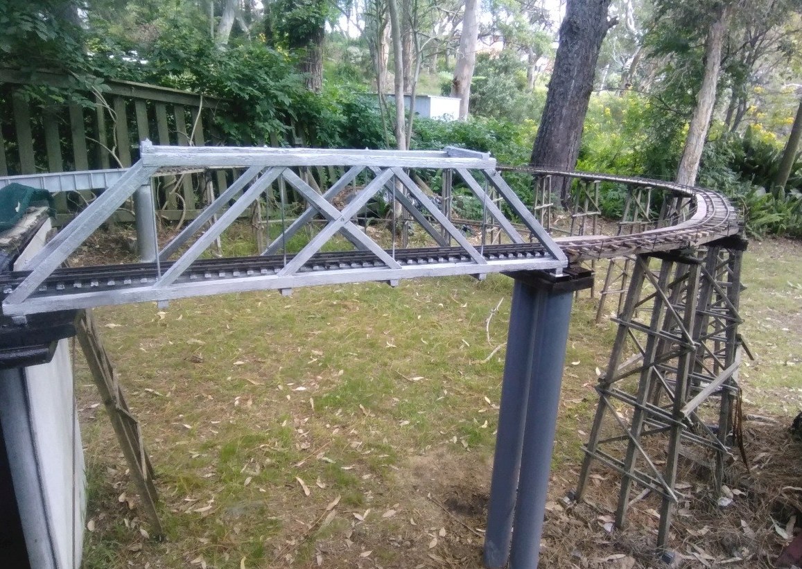

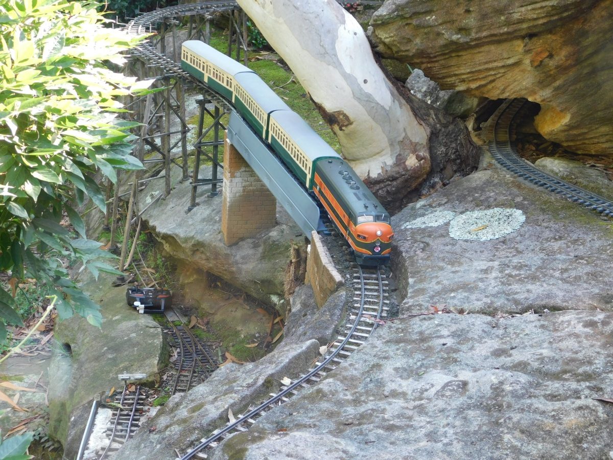

So I decided to replace it with a through steel girder type. It’s made from some aluminium (from an old screen door) and some 65x65mm x4mm thick PVC angle shape.
This is the finished bridge
new bridge (2).JPG (295.21 KiB) Viewed 1197 times
new bridge (3).JPG (227.32 KiB) Viewed 1197 times
….. and this is the new clearance to the tree. Let’s hope that will last a few years and see out my GR hobby time.
new girder under tree 16-2-26 (1).jpg (231.45 KiB) Viewed 1197 times

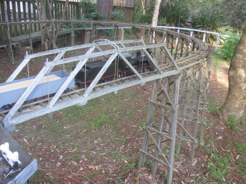

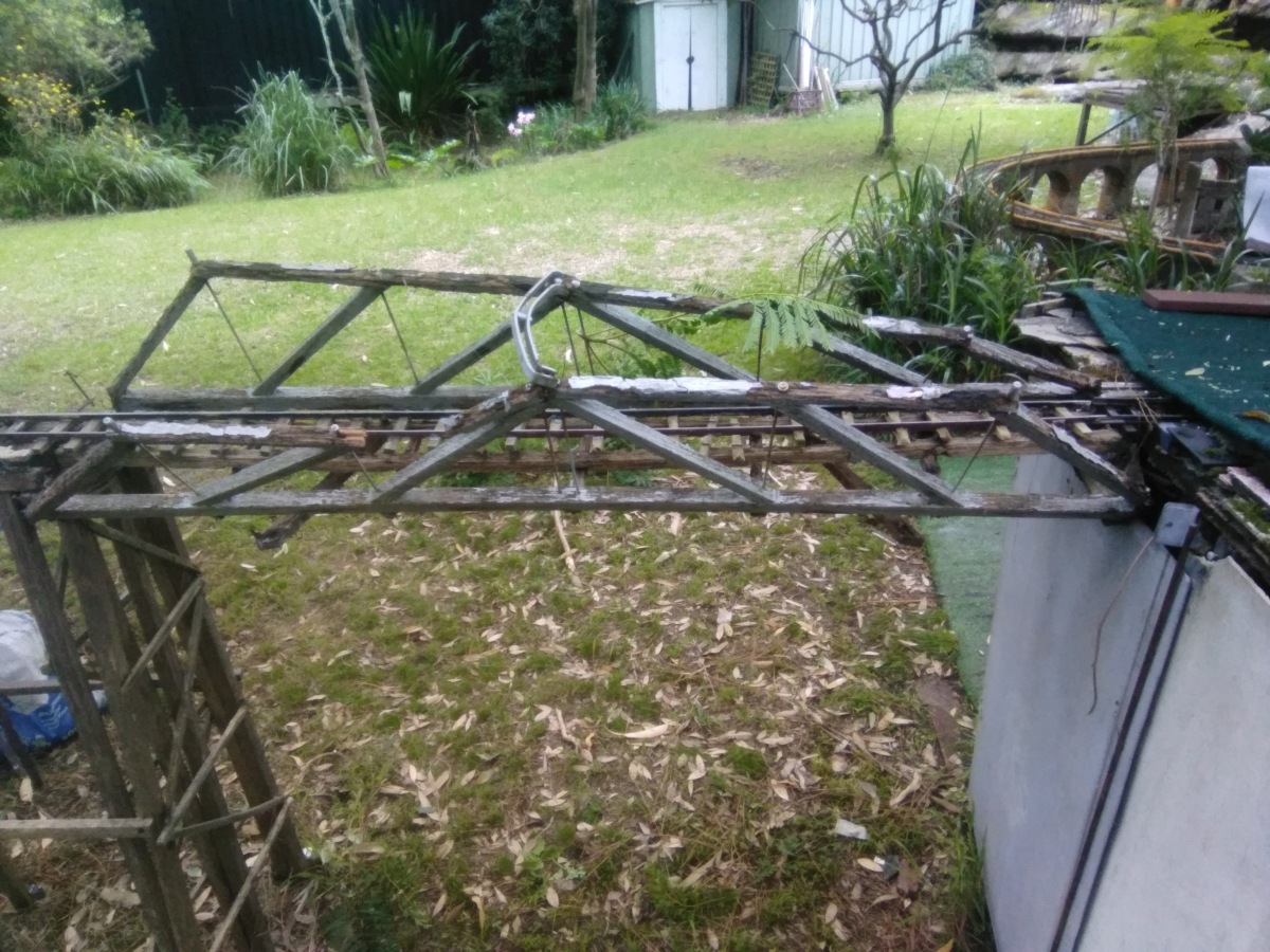

I had always considered re-using the truss bridge I removed from under the tree to the replace the very rotten truss at the end of Melaleuca baseboard
6 melatruss.JPG (210.54 KiB) Viewed 1195 times

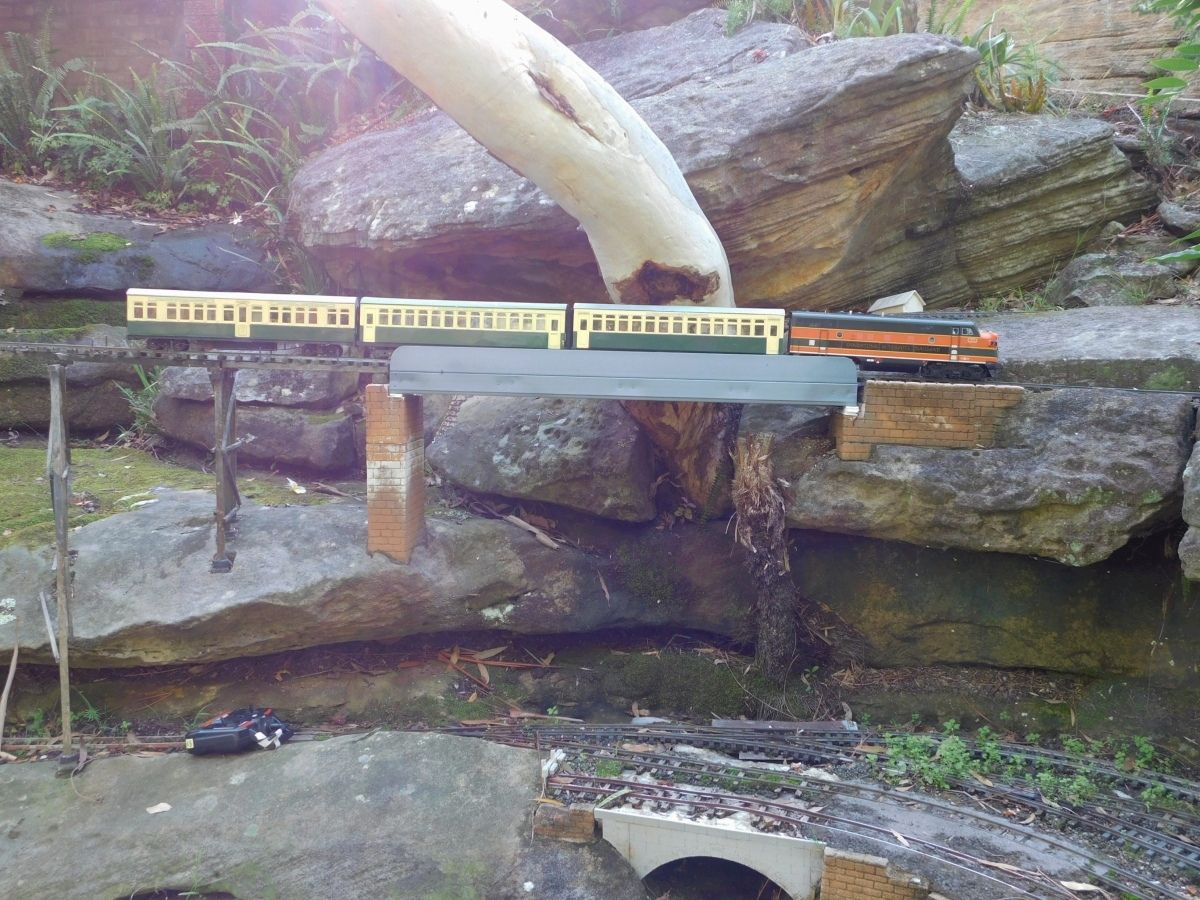

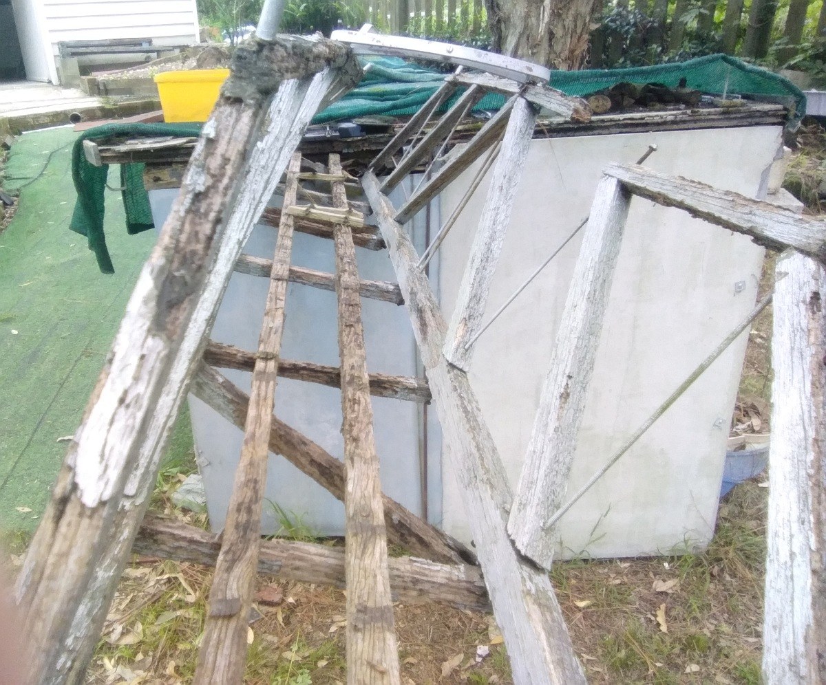

And within 3 weeks of the above replacement, the Melaleuca bridge was destroyed by a tree branch!
replace mela truss (5).jpg (372.42 KiB) Viewed 1195 times
replace mela truss (6).jpg (361.89 KiB) Viewed 1195 times

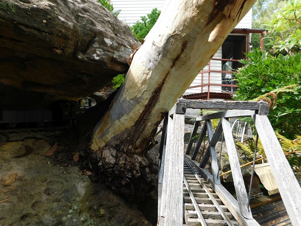

The old tree bridge was about 100mm short so I cantilevered a bit out from the baseboard. The other end of the bridge was supported by a double trestle bent arrangement that was damaged and rotten too, so I decided on a ‘ modern’ concrete pier type (because I am lazy). So two 75mm plastic pipes were concrete into the ground at the correct distance. The old bridge was repainted and is now in place. The track was also damaged so a 1.8m length of that was also replaced
