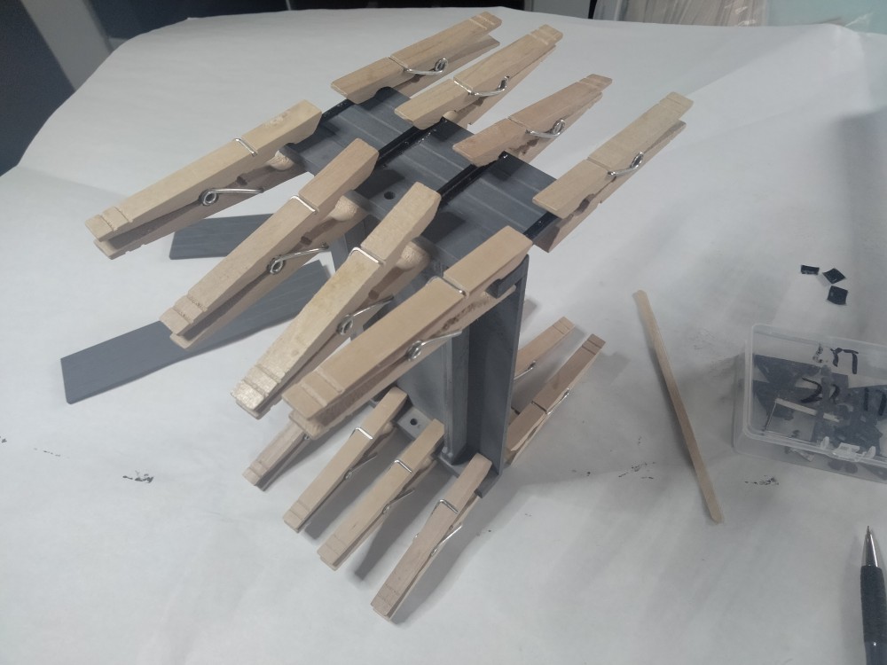

Here gluing the end stanchions.

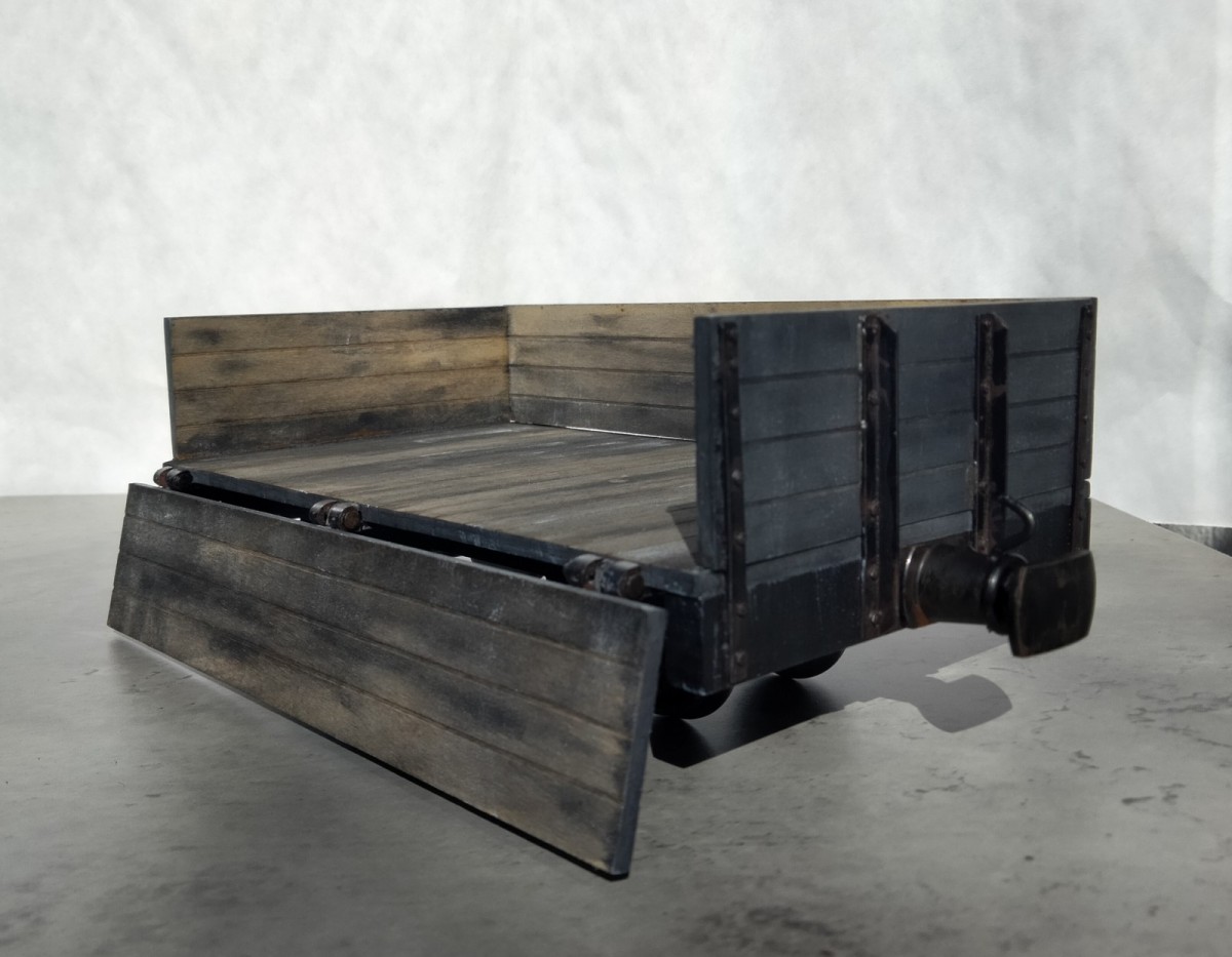

Now finished! I managed to get most of the decal silvering out also. All in all a nice kit. This was my first attempt with 16mm rolling stock as I have previously modelled only with much smaller scales (Z, N, TT, HO).

That is a wonderful weathering finish and great overall effect. If you hadn't previously mentioned the decal silvering it probably would have gone unnoticed.
Next time would it be possible to trim off the excess before applying?

I like the weathering too, is there a way to lock the drop down sides?

Yes, there is material (brass rod + nut) in the package to do wagon catches but they really are not prototypical so I am looking to either get some from IP or do my own. On the other hand they seem to stay upright quite well on their own, at least for the time being :D
