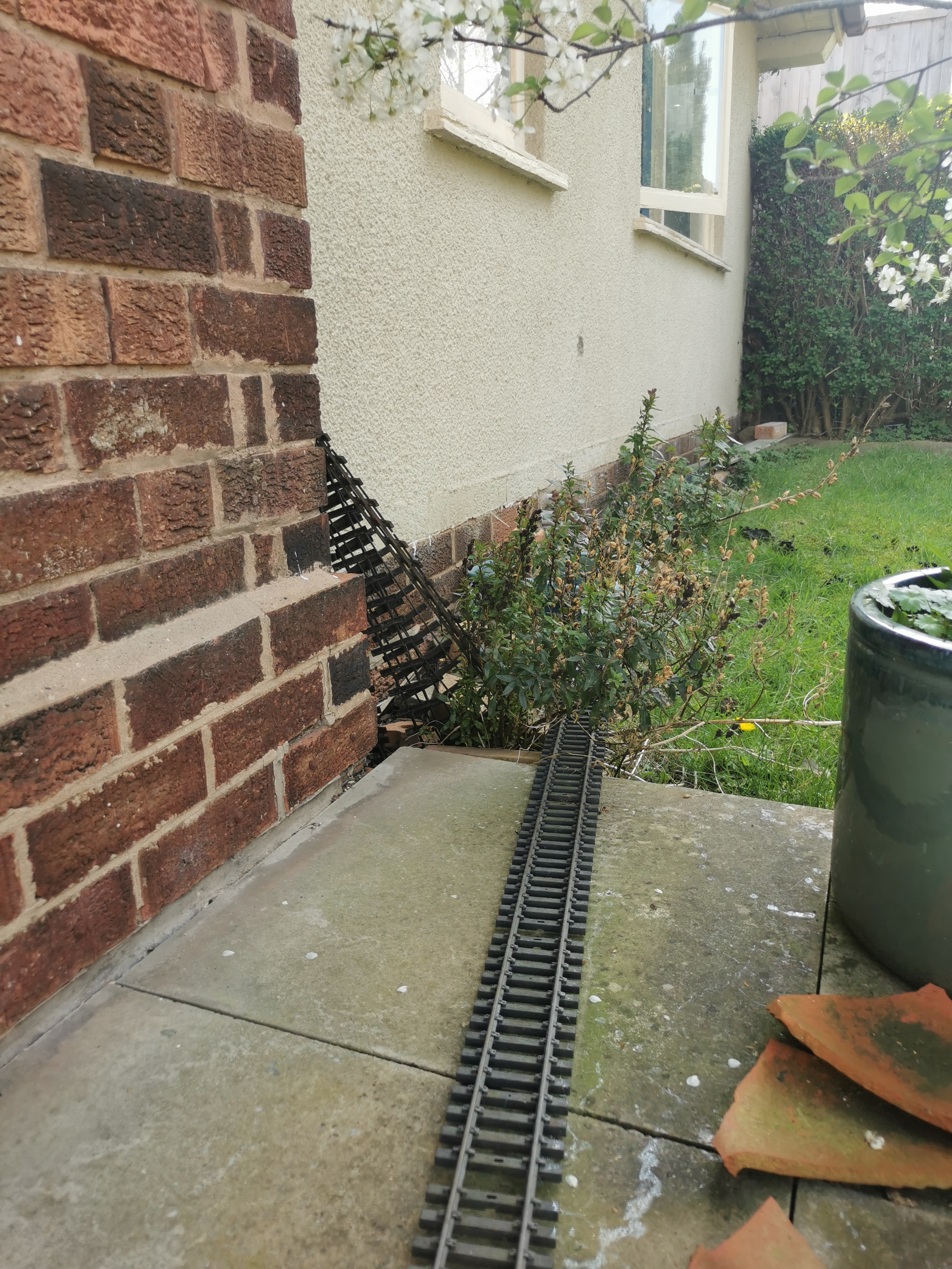

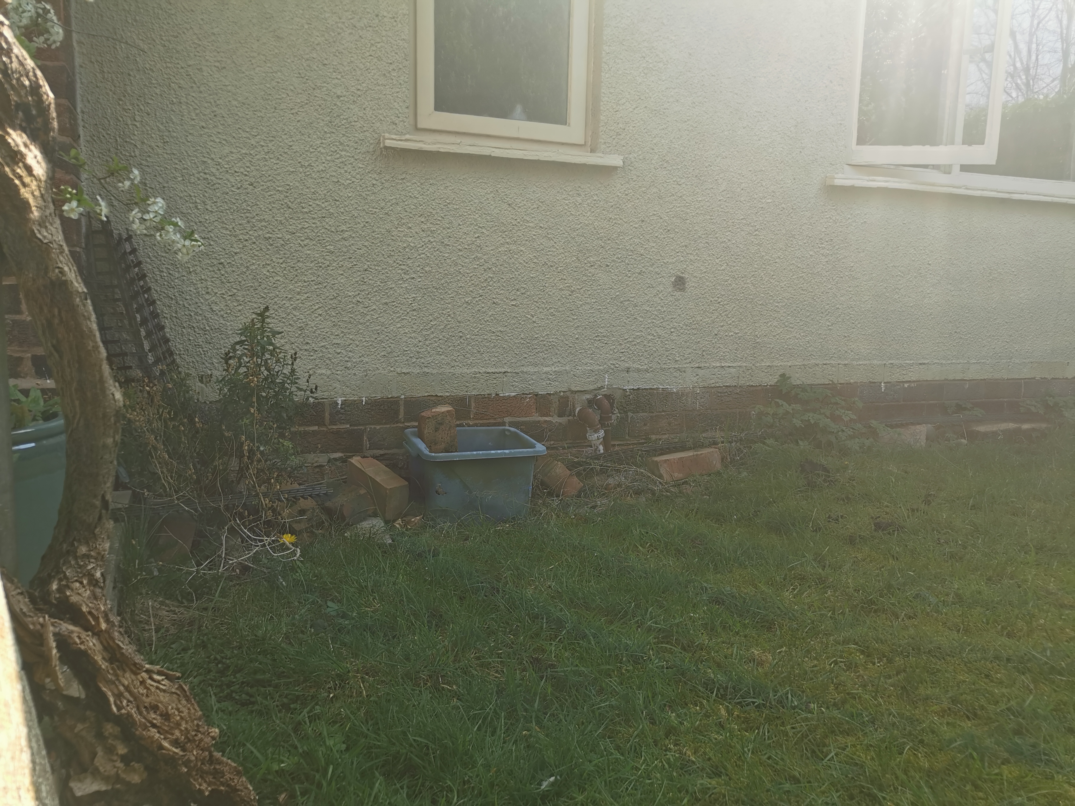

Some better weather, so a couple of photos, and more musing:
Side of bungalow
Side of bungalow
The choice is to either come off the patio (next post/photo) at roughly the level the existing track is, or at the height of the top of the first brick under the rendering. - This would probably make the end of the line being adjacent to the edge of the present patio.

Re: General scenic arrangements
Posted: Wed Apr 08, 2026 3:23 pm
FWIW, in my case that would be the worst of all worlds, too high to kneel and too low to bend! Of course, it really depends on your personal flexibility, but 10 years ago when I was your age, it didn't pose me any problems and I wasn't expecting that it would. How wrong can I be?? :roll:

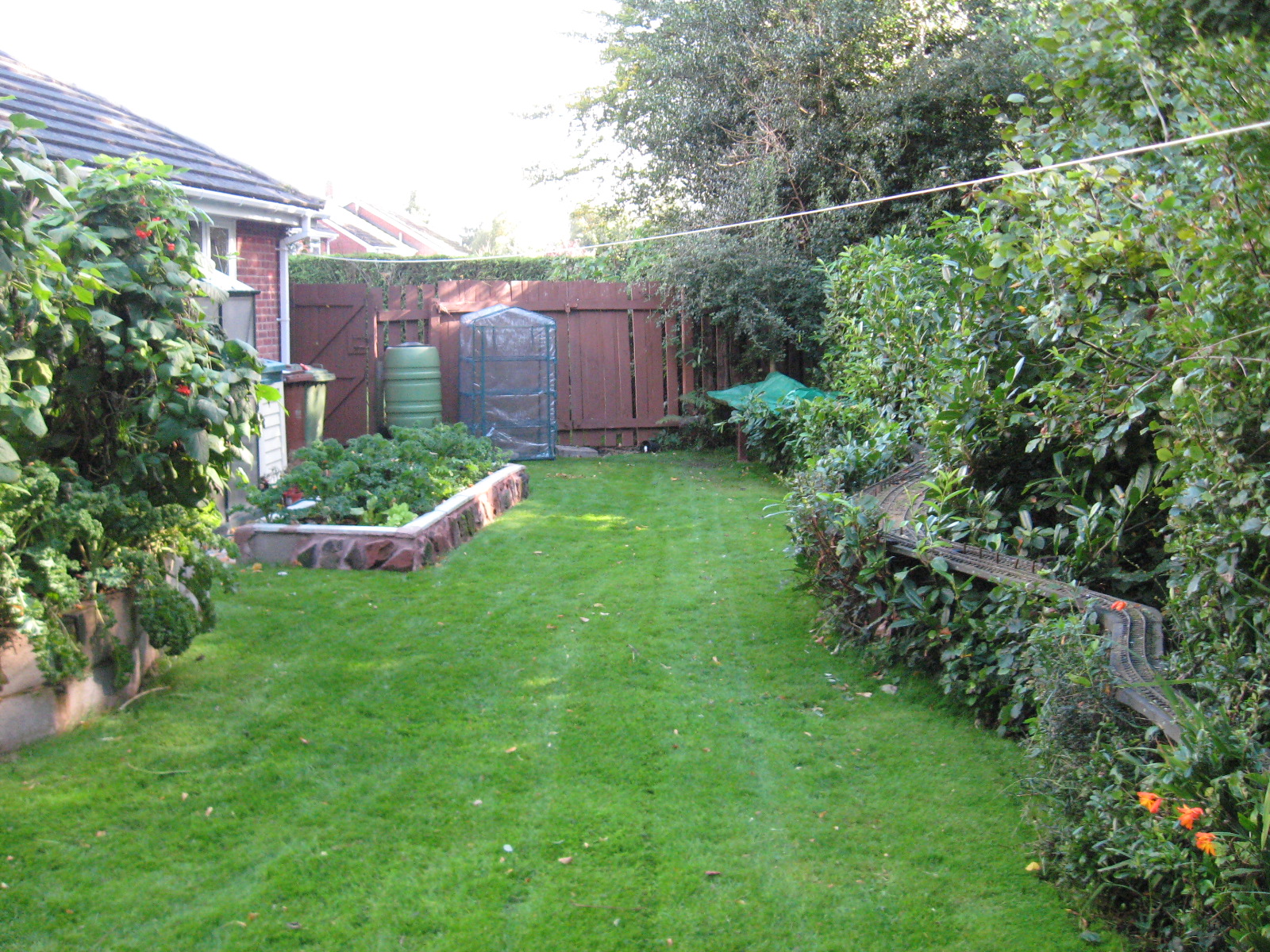

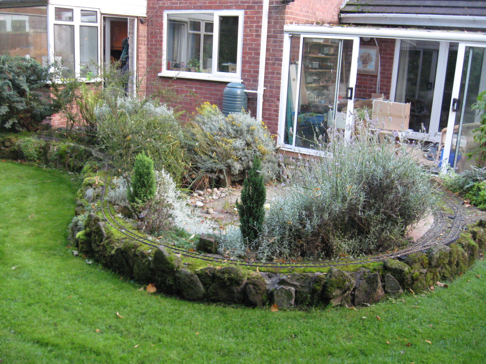

Posted: Fri Apr 10, 2026 2:24 pm
You've seen my railway, Phil, so you know how it's laid out, varying from around 18" to 6" above ground level
