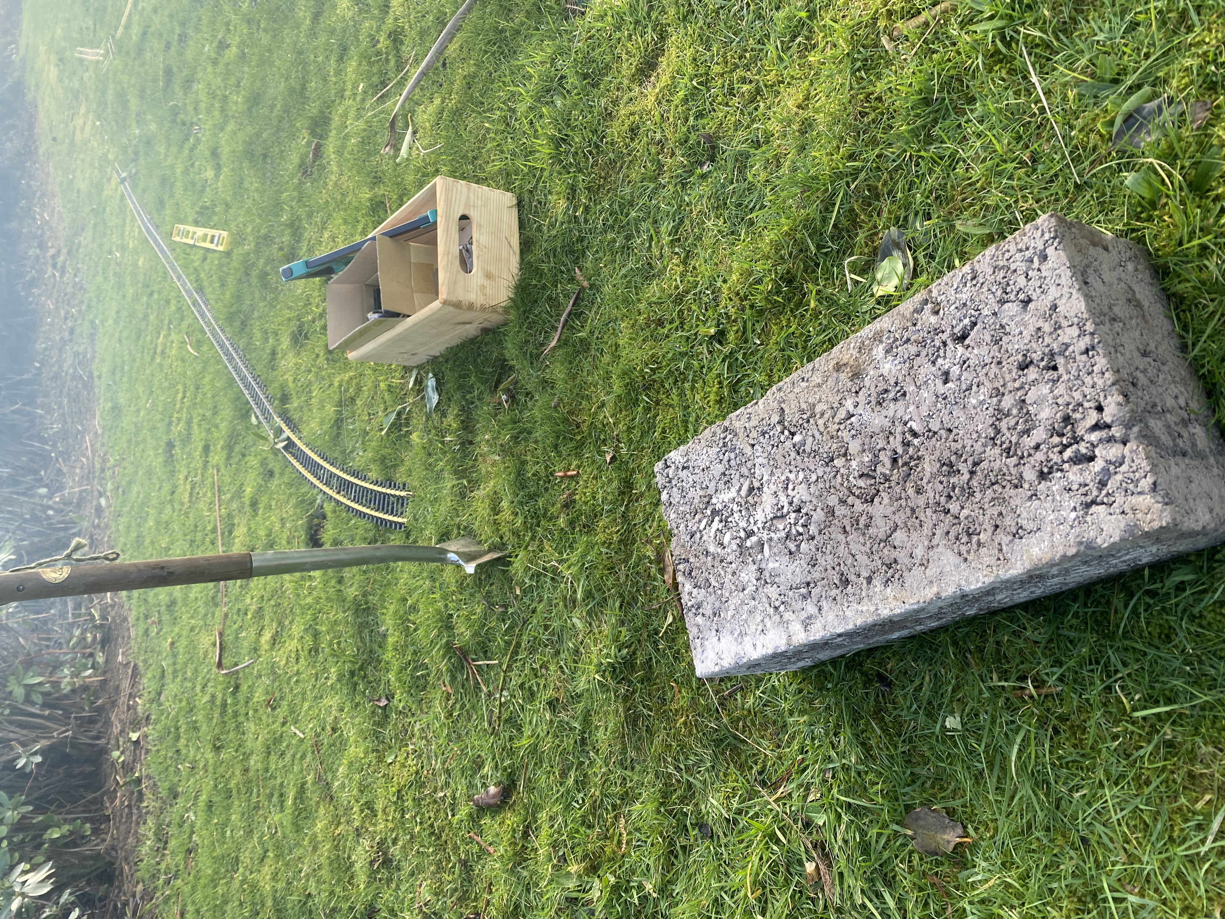

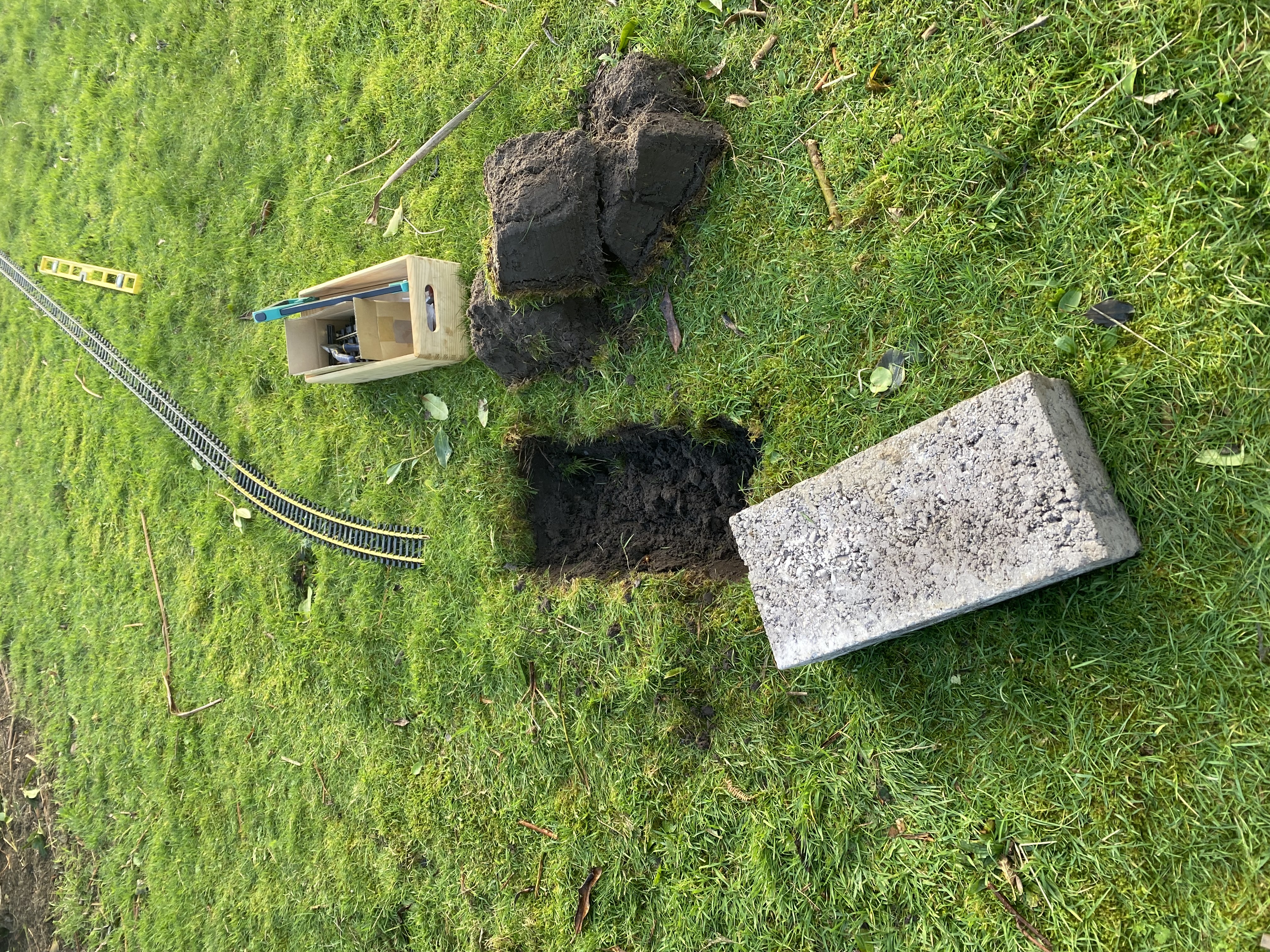

I'm rebuilding the FeckHallBahn in our new home's garden on the Isle of Gigha.
I want to raise it slightly on something that will look natural and grow moss; ideally I'd float the track on ballast with minimal pinning. I just KNOW there's some kind of very light block that can be cut with a handsaw but I can't for the life of me remember what it's called. All the blocks I can find online are quite dense and heavy. There's also the fact that getting stuff onto the island isn't all that easy.
I'm determined not to use plastic of any kind if at all possible.
Help appreciated

Hi Nigel,
Good to see you planning trains again!
I think what you are talking about are Celcon / Thermalite Aerated Blocks 100mm 3.6N - do a search for suppliers to your far flung part of the world! Those are the 'big brand' versions but I know for a fact that Wickes do an own label version so probably there are others as well.
I must admit that I'd never heard of Gigha until now, it looks to be quite an adventure you've set yourself on, in a beautiful setting..

Thanking you - I thought it might be those. Can get them ordered in to Jewsons on the mainland. Thanks

They have the heavier ones as pictured, I need to order the lightweight ones.
The heavy ones are ok but we can only get them onto the island 10 at a time and I reckon I need 100. So that would be £300 just in ferry fares!!

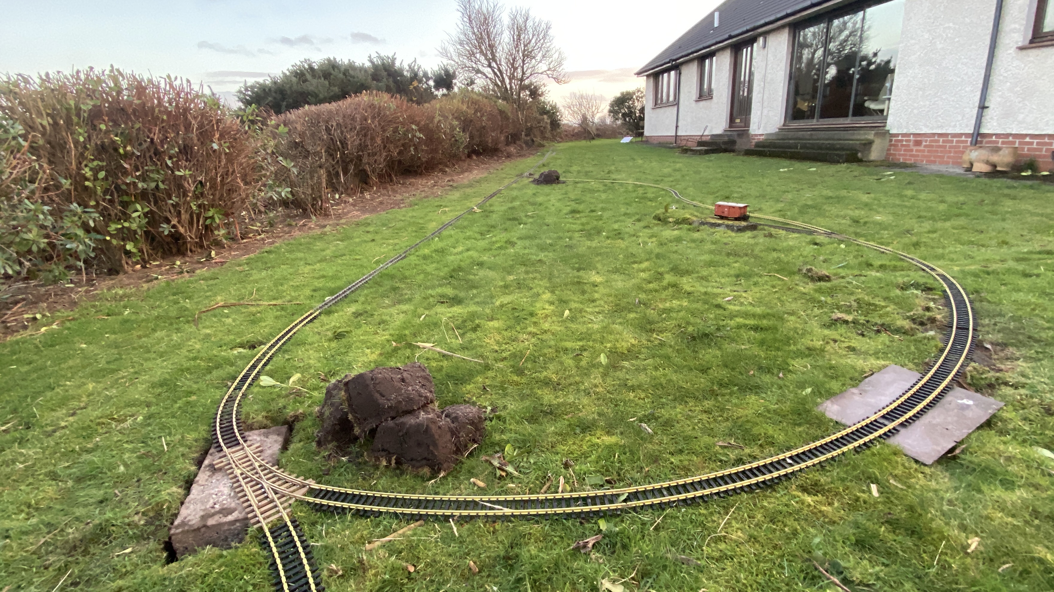

Hi Rik
First train has run. I'm going to need to rethink my construction plan though - nobody stocks the ultra lightweight thermalite blocks around here! They aren't robust or heavy enough for building work in the area... Might have to be actual earthworks

Following Grant's recommendations a few years ago I used these blocks when I built my stream bridge. Hebal isn't a brand available here afaik but the Celcon/ Thermalite are the same thing and as i said Wickes and, I think, Jewsons have an generic version..
I'm sure you've already done it but I had a quick look at Jewsons down here and they do seem to stock them, so then I looked at your local one in Cambeltown and it said "out of stock". That presumably suggests they can supply them but as you said, you'd have to order them and no idea what the min order might be.

Cheers Philip
Campbeltown can get them but I'd have to order and transport a whole pallet full. Nearest in stock is Stirling.
However. I have found several buried in undergrowth and stacked up alongside the barn so, in combination with a bit of scavenging, leftovers from a building project in the village and some square section guttering I think I'm sorted. I will be using some wood but it's a) free, b) here and c) construction grade treated. It's definitely going to have a narrow gauge shoestring vibe. Not going to compromise where there are points though!

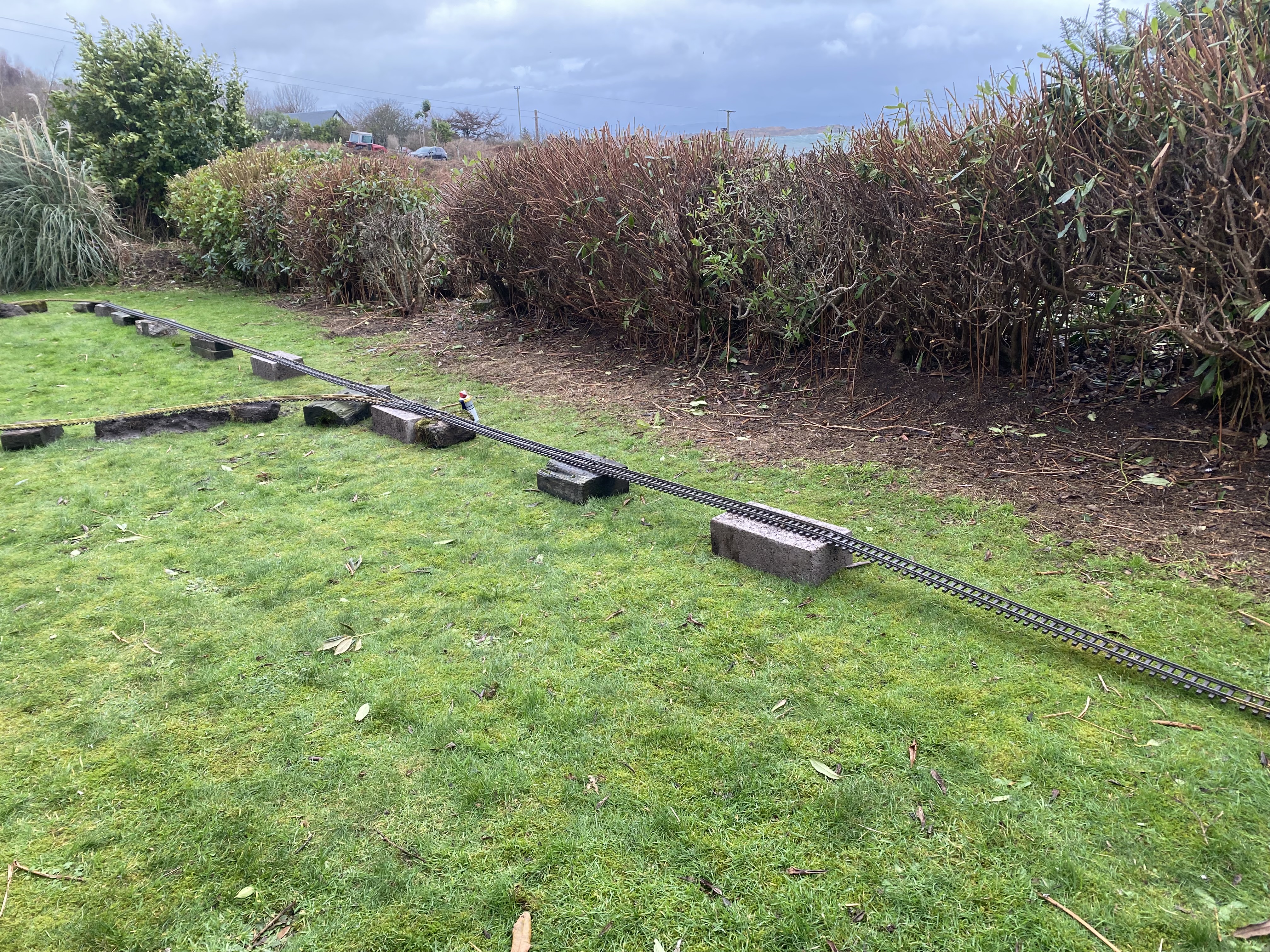

The railway is going to be elevated with various materials including some chunks of full size sleepers I've found with the track itself floating on ballast constrained by square section guttering. Some of this will be exposed and uptarted to look like viaducts/bridges and some will be hidden by piled up turf from a couple of places where I need to do some digging out angway flower/veg beds and the area in front of my barn which has gone to grass in the years since it had cattle going in and out. I know wood isn't great but it's available and - most importantly - free!!
The fictional business of the line will be sand quarrying - not far from the truth as it's on a raised beach -, dairy traffic and building material imports. And whisky of course! We're about 5 miles from Islay...
The community is fabulous. I'm trying to find the right words which probably says it all.

I've heard of lightweight track construction, but that is taking things a bit far!!

A true garden railway builders attitude, good luck.
When you mentioned a raised beach, I thought oh! same situation as myself (on sandy soil, which has advantages and disadvantages) but your soil doesn't look sandy.

It's actually fairly sandy; centuries of cattle farming though. Mud brushes off without a trace which is completely unlike the Worcestershire clay I'm used to.

Just started seen this, and like others I've been to look at Gigha on the map! Wow! Fantastic.
On the aerated blocks - I have no experience myself, but I understand that they are susceptible to frost damage. You're on an island, so frost maybe not a problem (I'm on a peninsula close to sea level and we get very little)... but you're also a long way north (I'm not!)
I do have experience of 'floating' on ballast (well, Rowlands mix). That experiment is over for me, I'm surrounded wild flowers, hedges and all sorts of things that produce many seeds. We get high winds and lots of rain (and weather in general) and I suspect it may be the same for you. The problem with track you cannot brush clean is that these seeds take root and unless you spend a lot of time picking out the weedlings, pulling them out can take up whole track panels! However I'm largely at ground level, so this may be less of an issue on your raised track.
Really enjoying seeing the outlines of what is to come, very exciting.

To suppress weeds in pavers here I use 50% pool chlorine and 50% water and splashed it on so it runs down between them. 12 months on and they have not returned pavers look fresh as well no algae. Bit eco vandal but there is also the vinegar/salt method as well but I'm not a fan of salt in the garden as it tends to spread in the rain.

Thanks. I'll probably use citric acid if I use anything chemical for suppression; it's approved by the RHS. Not really planning on using anything though, I'll weed it where necessary. Plenty of salt in the air already!!
