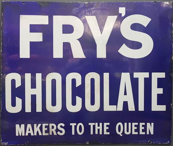

Screen Shot 2021-12-07 at 11.01.28.png (431.21 KiB) Viewed 45242 times

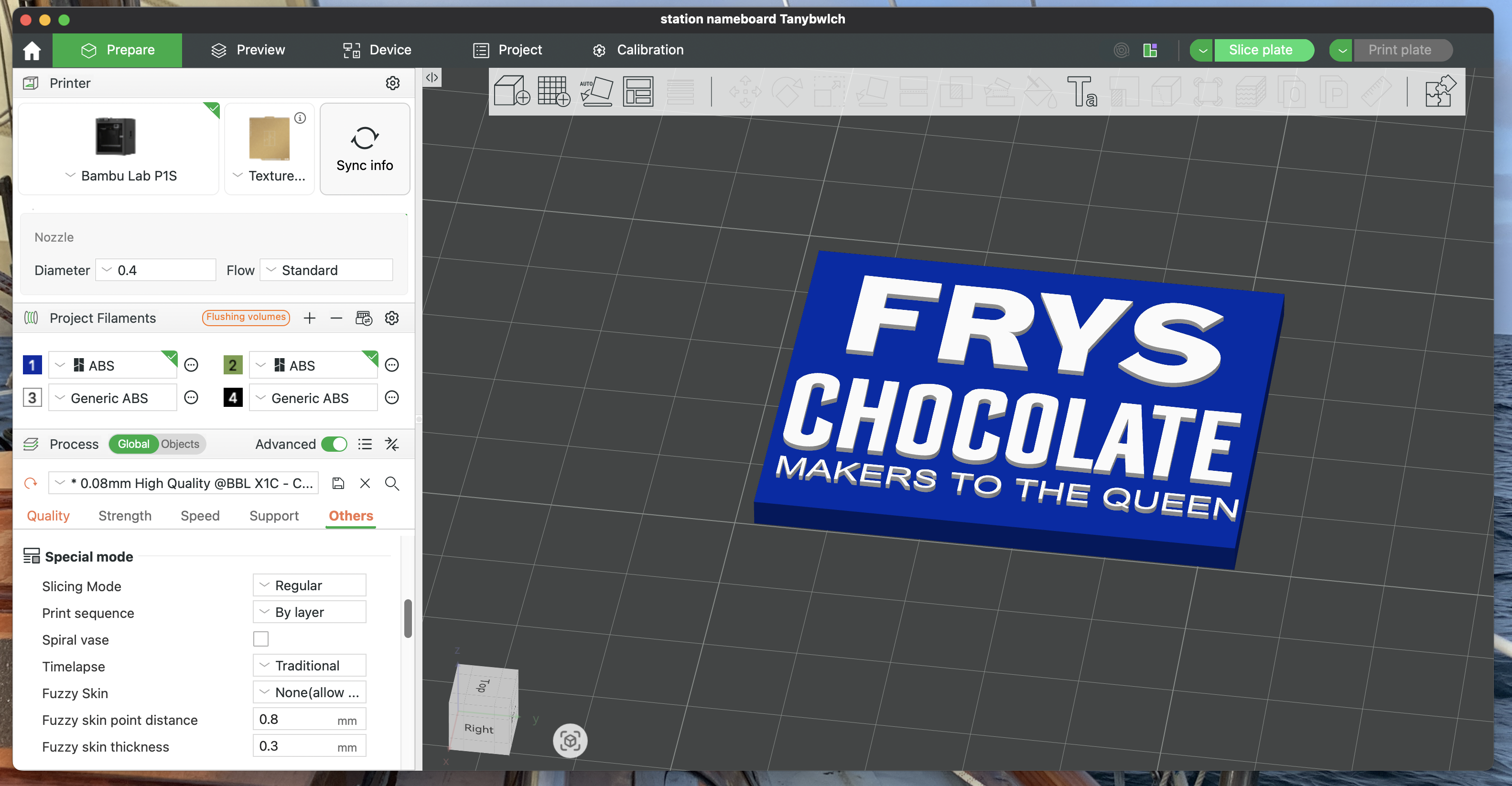

This is a photo of a real sign. Adding this as a "canvas" in Fusion 360, I have traced out the lettering for the first 2 lines, replicating the font and spacing. The last line was text added as a line of text in the software. All the letters are "embossed" standing 0.2mm proud of the surface. Having imported the stl. file into the Bambu software I "painted" the raised sections in the different colours:
Screenshot 2025-11-27 at 09.37.29.png (1.32 MiB) Viewed 45242 times

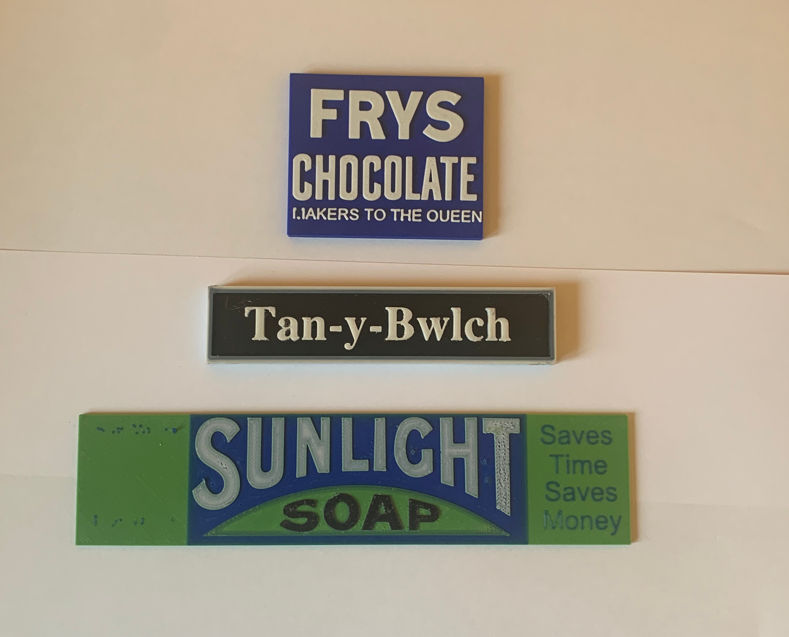

Here are the samples I have created:
The Fry's sign worked - except for the first letter of the bottom line. Bear in mind that sign is about twice scale size - any smaller and the bottom line doesn't print.
The station name boards are clearly a success - but I think the real signs are black lettering on a white background. I need to find out what the colour of the surround should be - it might not have been black.
The Sunlight soap advert worked - apart from the small lettering in the left hand panel, and of course I need to fine tune the settings to improve the quality.
I suspect that these signs (printed in ABS) should last well, particularly as the sides of the buildings I will fit them onto all face north - away from the sun.
While I can't see any point in trying to print wagons and buildings this way (the colours that filament is available in are not suitable) I think that I will find some specialist uses for it!

Trevor Thompson wrote: Fri Nov 28, 2025 10:11 amThe Fry's sign worked - except for the first letter of the bottom line. Bear in mind that sign is about twice scale size - any smaller and the bottom line doesn't print.
Have you enabled the 'Detect thin wall' option on the strength tab ? That can often get details like this to print OK, I truts you're using a 0.2mm nozzle too.
Ah - that is helpful. The answer to both is NO.
I was wondering about a 2mm nozzle! Next purchase on the list!

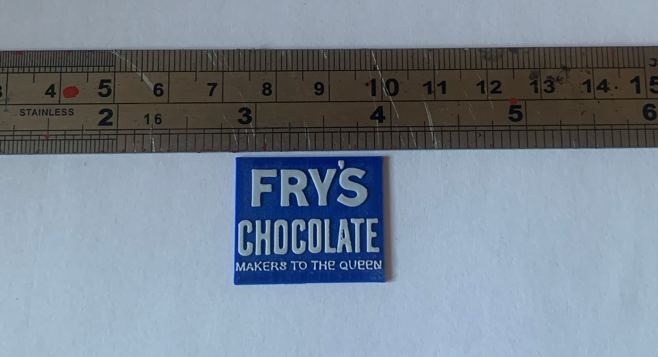

That makes a difference!
Actual scale size:
It makes it worth having a go at the more complex adverts.

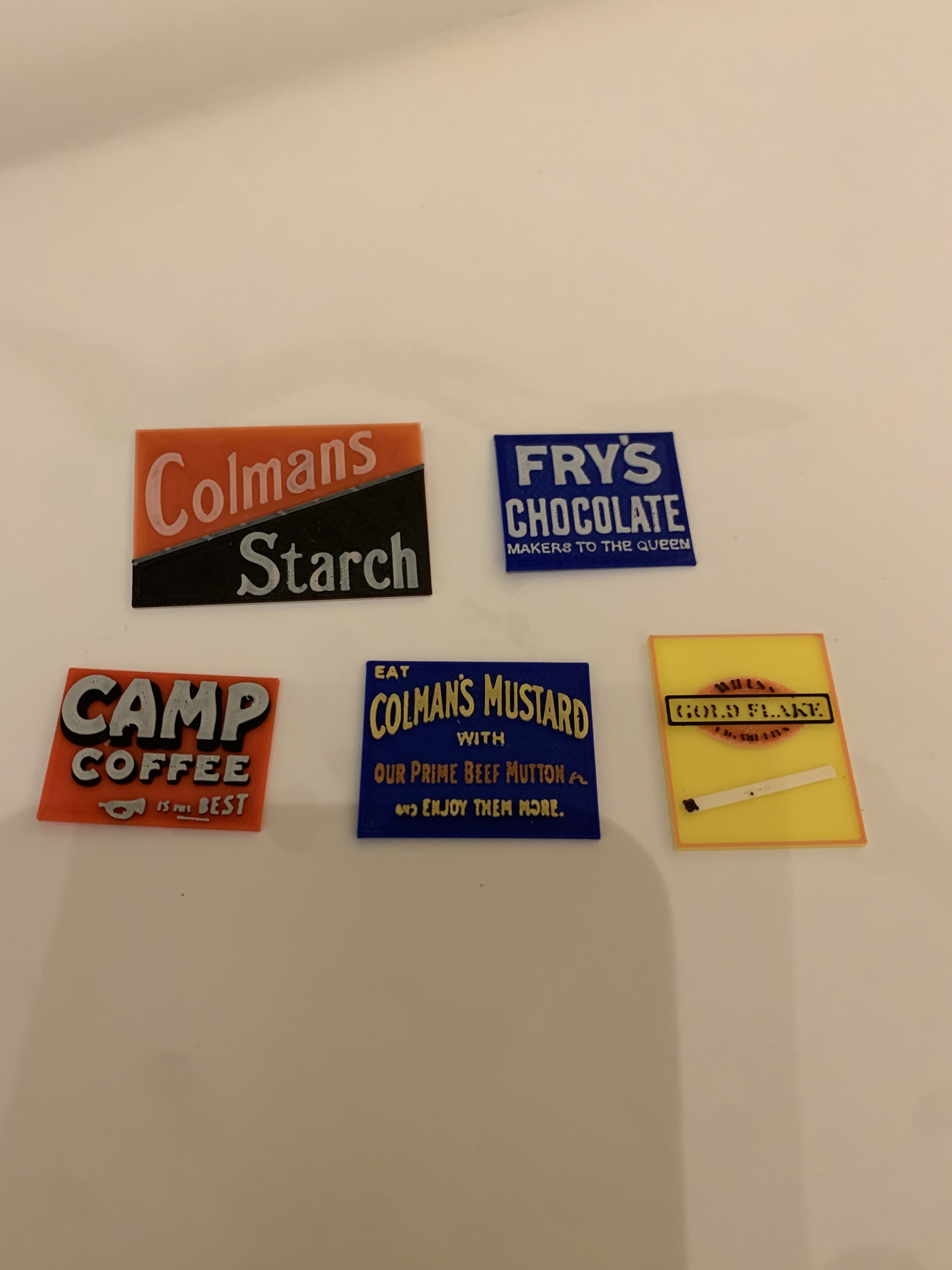

A final post on this topic. I have printed 6 of the enamel adverts now, and while I wouldn't say they are "photographic" quality they are readable.
Typically they are 27mm along their shortest dimension - so they are certainly small enough for 16mm scale.
My research suggests that this type of sign - with their simple layout and limited range of colours - are the earlier ones. That suits my railway and the technique I have used to create them.
They are destined to be fixed to the buildings which live outside permanently - so we will see how long they survive!
