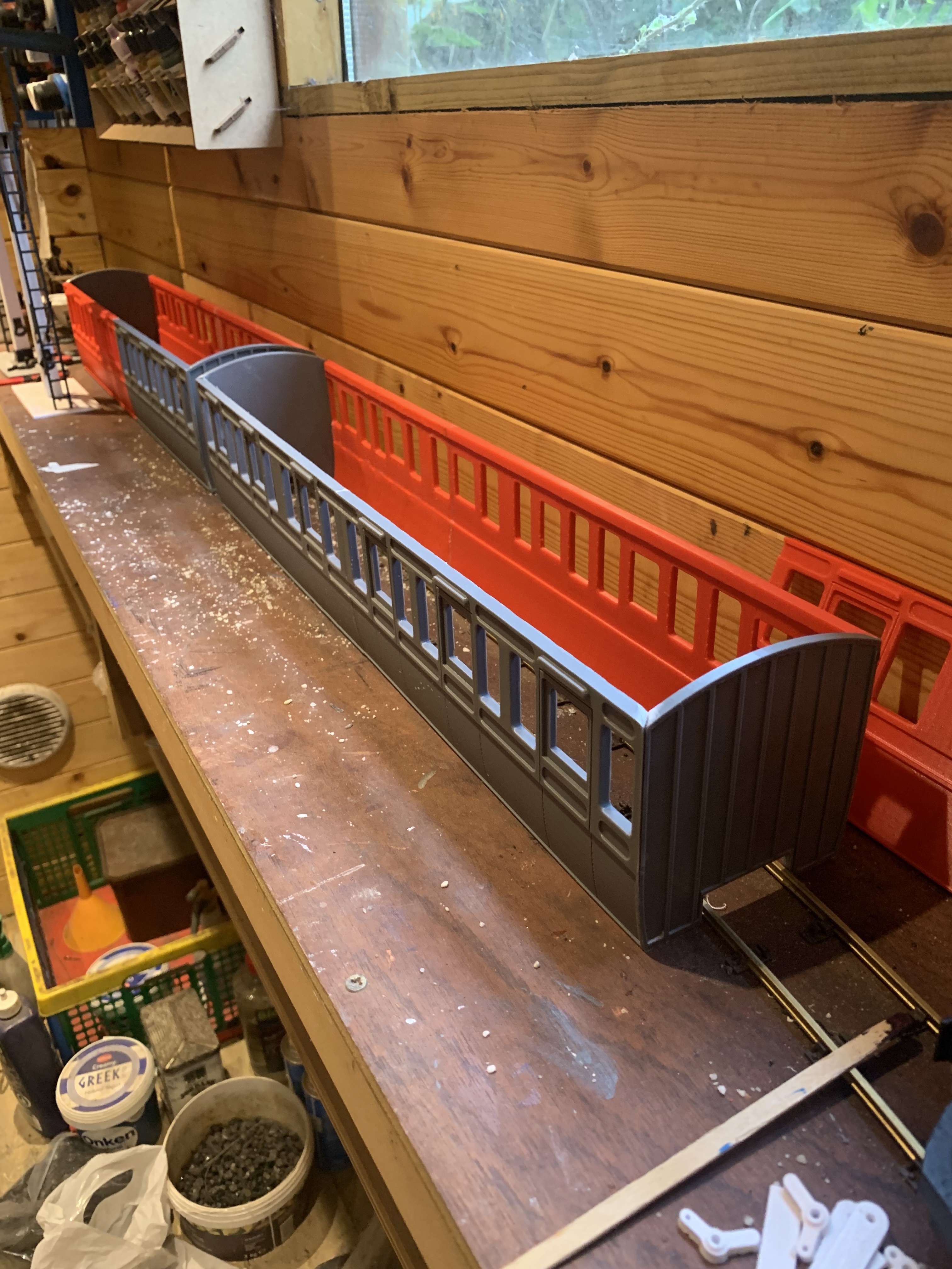

As part of my efforts to learn Fusion 360 I have been looking at working with curved surfaces.
I have already designed this coach in Sketchup, apart from some issues with the curved sides. I decided to start again and have worked from the drawings in the 7mm Narrow Gauge Associations book of drawings for the Ffestiniog railway. Here is the almost complete design:

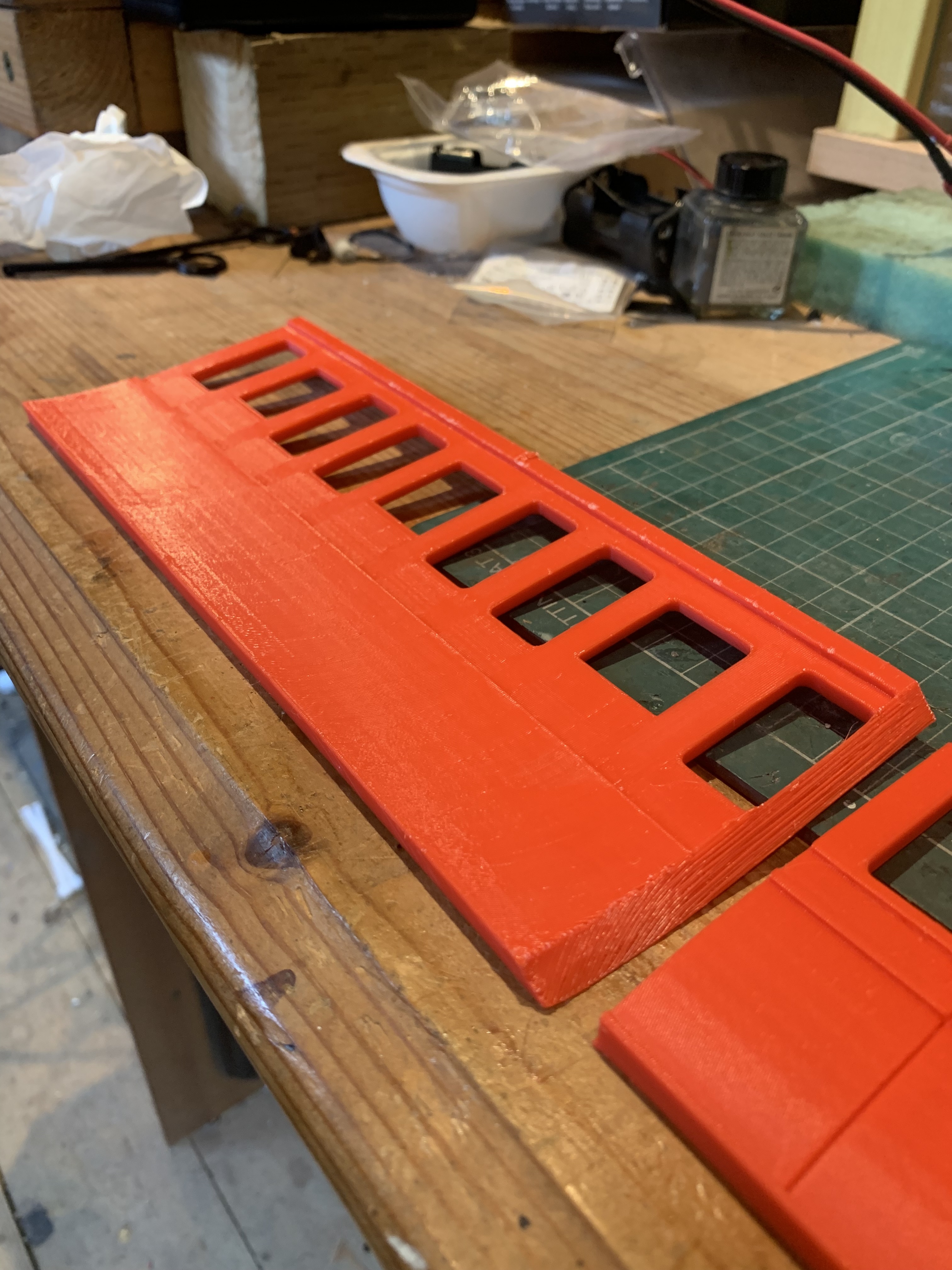

The First 2 sides are printed:

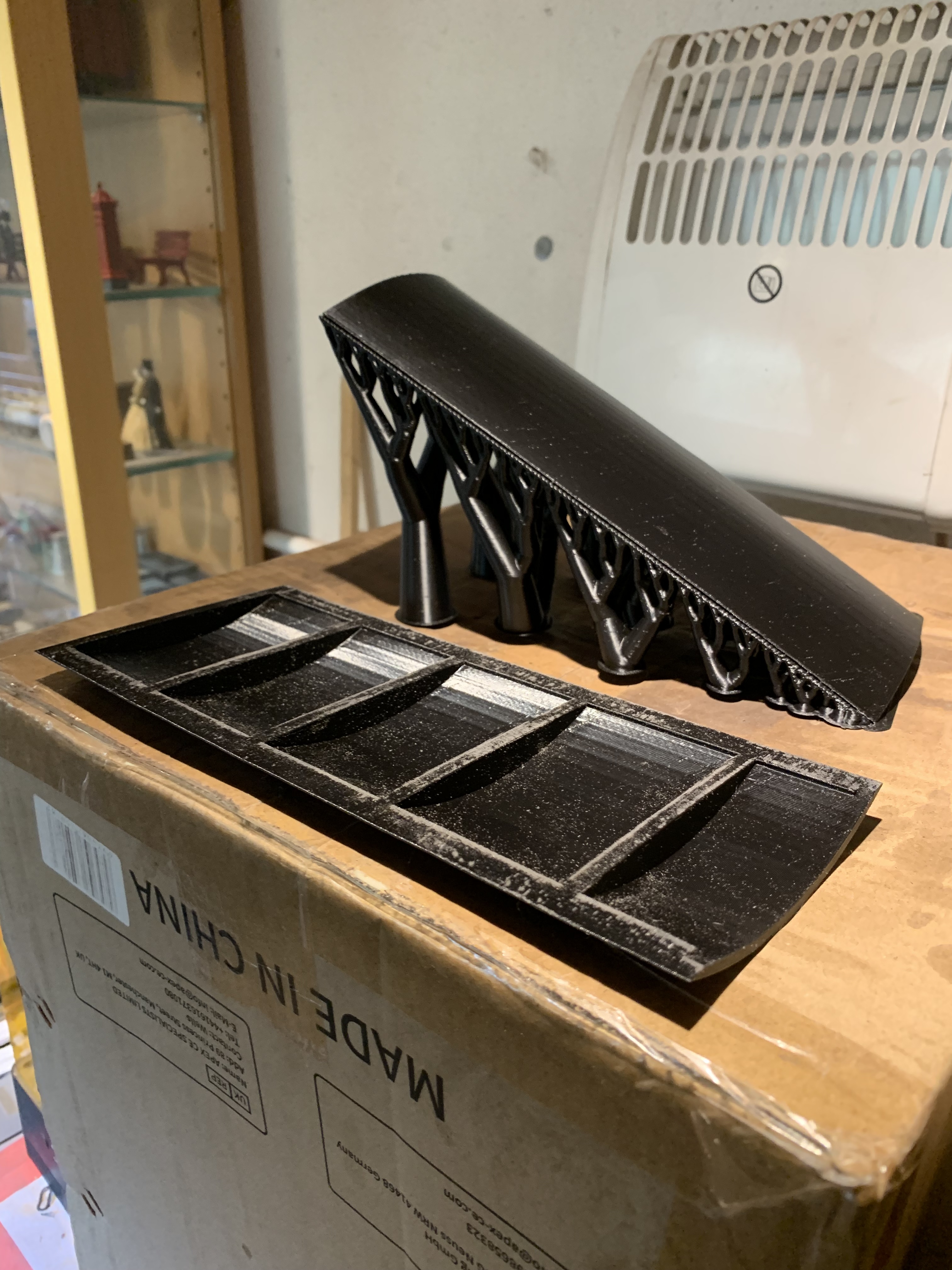

My printer bed is 220 x 220 x 220, so these sides can be printed in two parts. The front component is one half and the other half behind it has its supports still attached.
I know that it could be printed flat on the bed ( apart from it having a curved profile ) but that leads to distortion when using ABS. That explains why it was printed at an angle. Experience has shown me that the upper edges of all of the windows need support - that explains why there was so much support.
This image shows the reverse side of one half - to give you an idea of the surface finish on the reverse. The front surfaces have a good finish - not perfect but a few coats of paint will smooth out the surface without requiring filler or sanding.
I have used chamfers on the edges of my later buildings - but this is the first time I have done so with curved surfaces. You can see that the outer ends of the sides are chamfered, as are the ends which attach to them. The inside face has a 1mm recess in it to take the glazing.

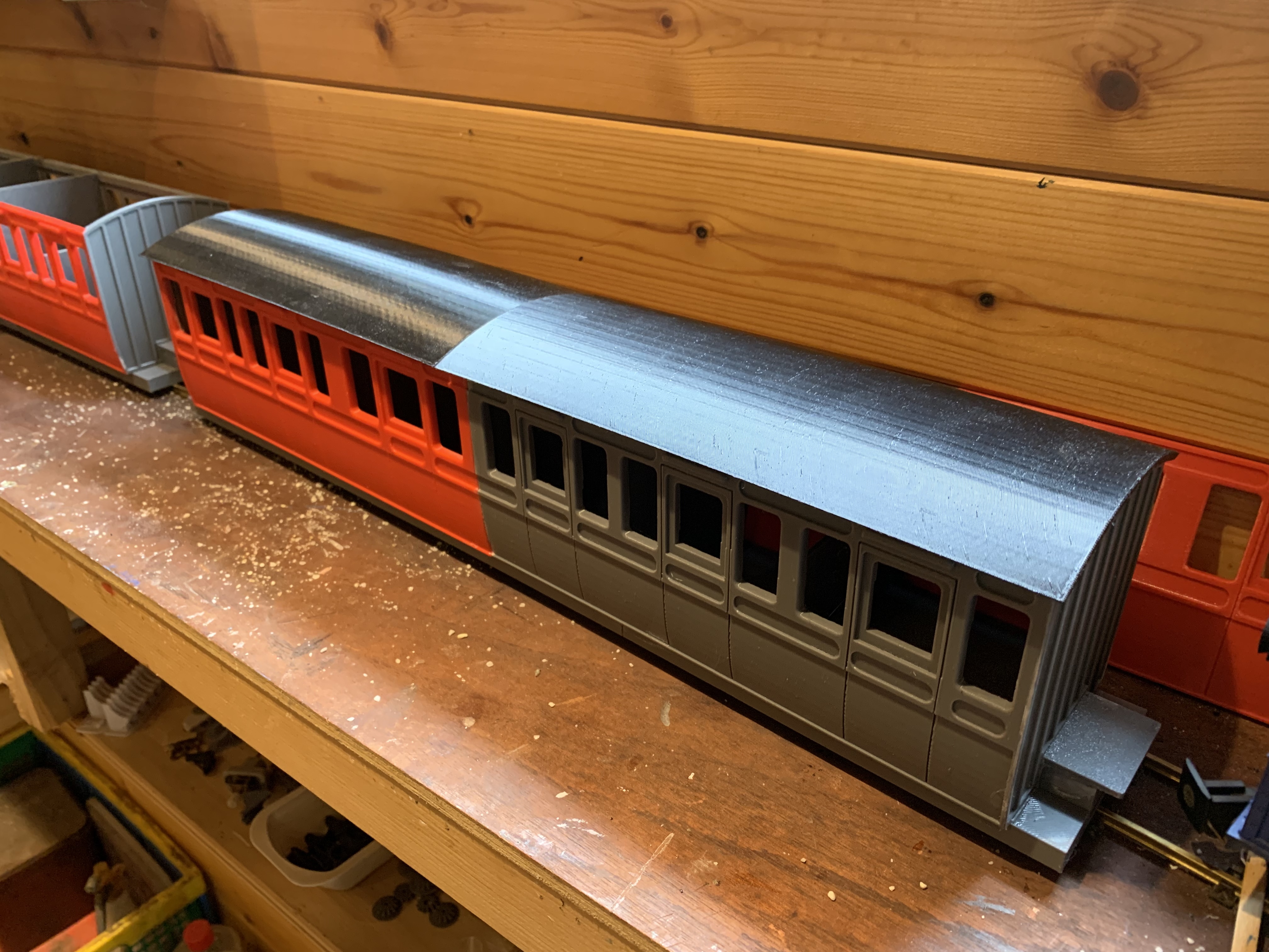

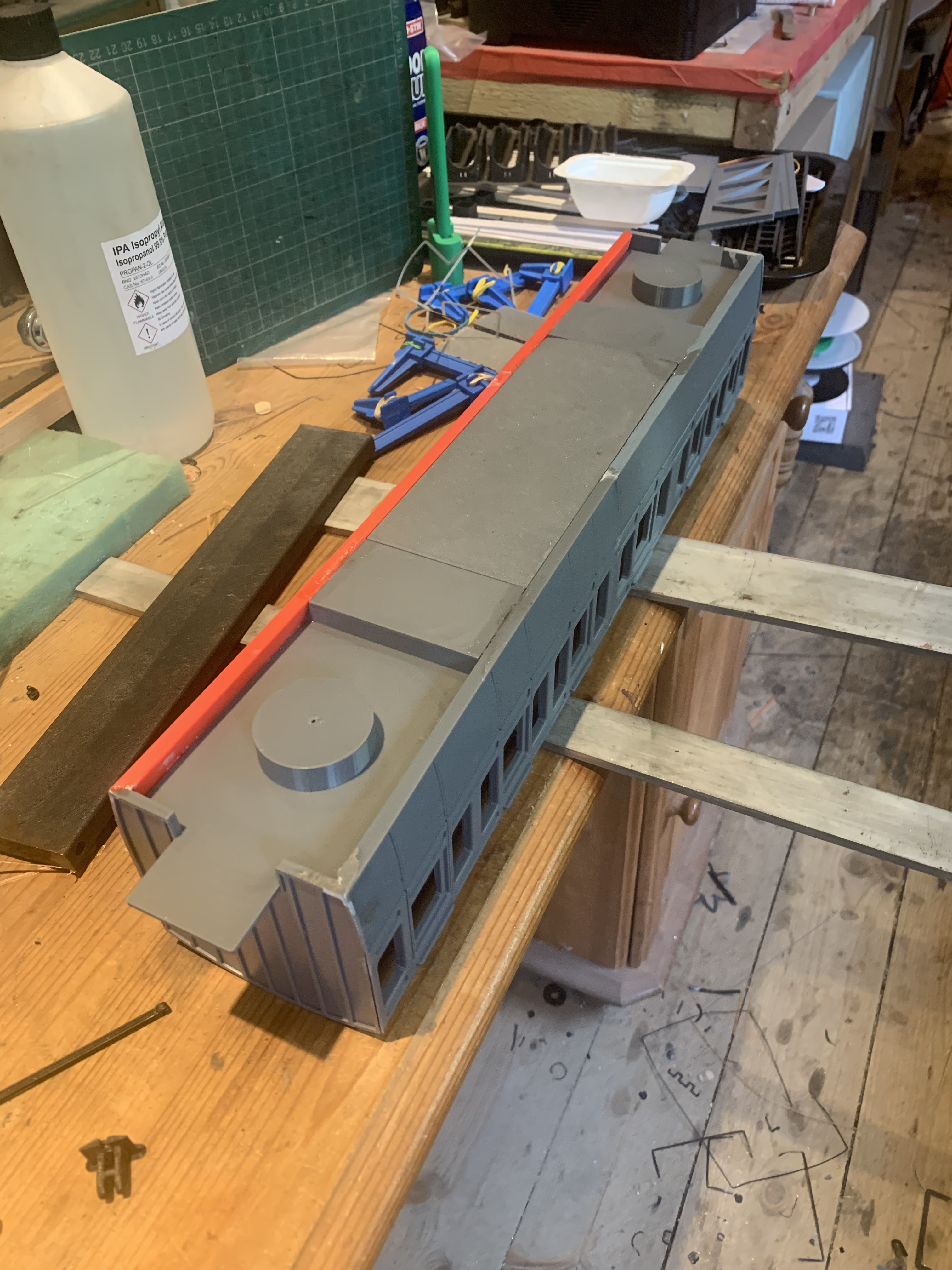

I am still thinking about painting - but the roof for the first coach is printed:
and
I think I might use magnets to hold them in place
Back to thinking about painting
and

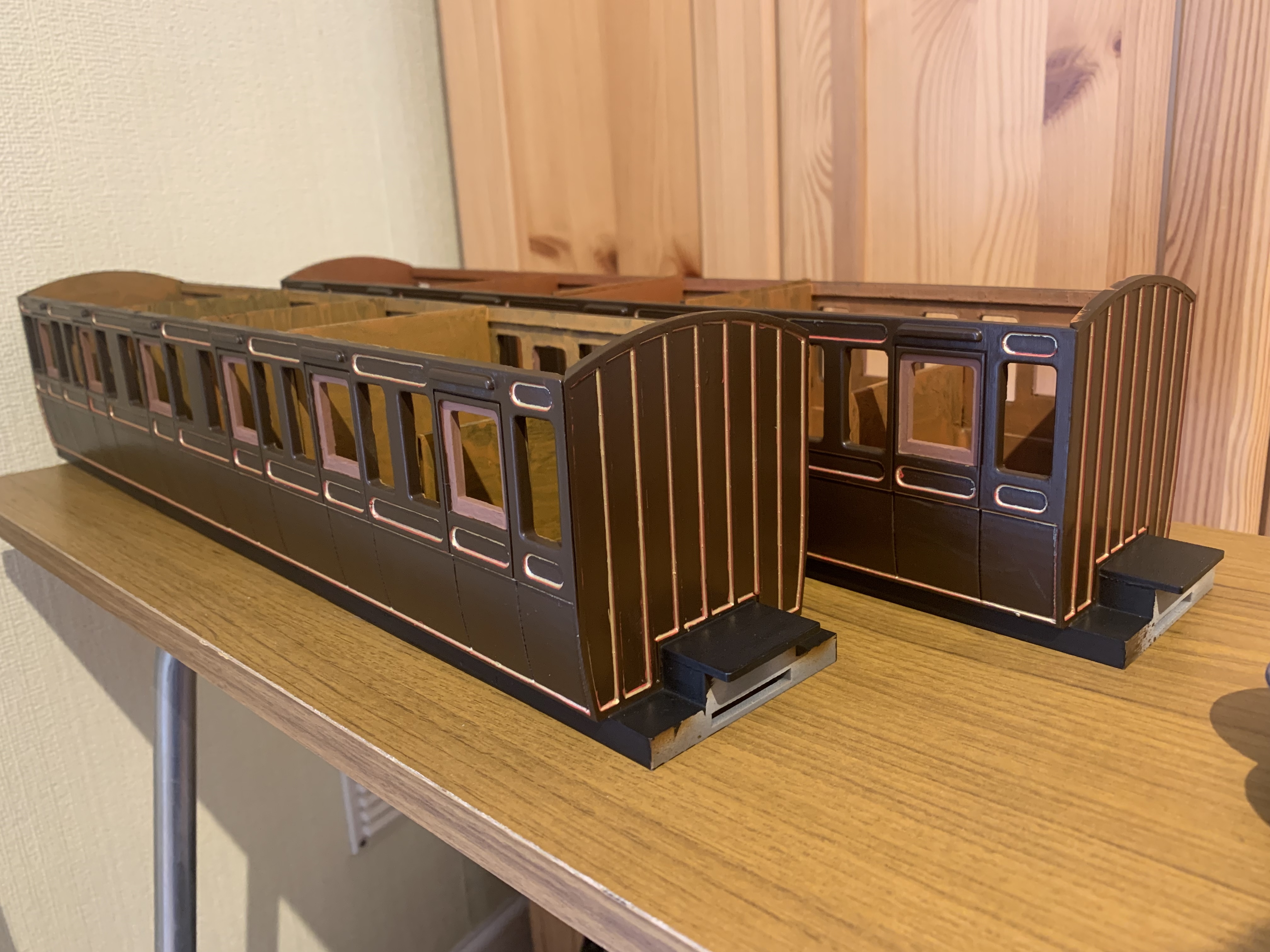

I have the coaches painted, and lined (well almost lined):
I started off airbrushing with acrylic paint, but it didn't fill in any of the tiny blemishes. So I went back to enamel paint. This gave me the smooth surface finish I was looking for. The lining is not complete. A 1mm line of acrylic vermilion has been applied, followed by a 0.75 gold line. I have to finish off a few bits where the paint didn't run properly, and then touch up the places where I slipped.
I have the seats ready to fit, after glazing them, and then people to create to fill the seats.
Having the Automatic material system on the printer, and having learnt about 0.2mm nozzles, I have found that I can produce figures which are not much different to those from the resin printer. So I am investigating MPFB (the latest version of Make human) as an extension of Blender. It seemed worth trying this - if only because I have used it successfully in the past - so I hope to be able to populate the coaches easily and swiftly.

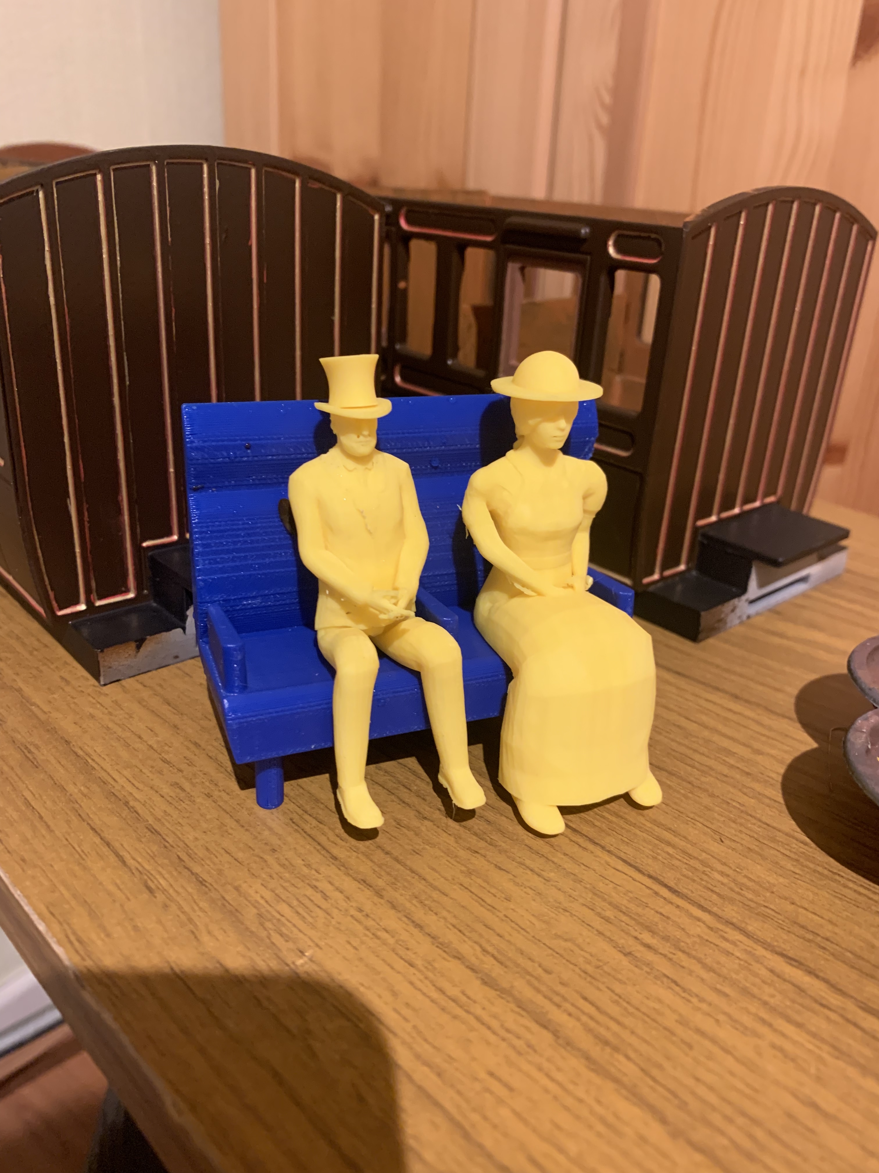

I have repaired the .stl files using Fusion 360. I cut away the back of their legs so that they fit onto the seats properly, and drawn and fitted hats. I am quite impressed with how I can alter and repair .stl files in this CAD software. Much easier to use than Blender.
The female is fine but the male is 10% too small. You can see the remains of the supports in various places. These are not final prints - just tests to see what I can do with a 0.2mm nozzle on the P1S filament printer. One advantage of having the Automatic Material System is that I can use a special companion filament, alongside the actual print filament, for the interface between the supports and the figure, which improves the print quality under the supports, and makes the supports come away freely, leaving no residue. I am waiting for a reel of it to arrive. I will then print sufficient figures to populate the coaches.

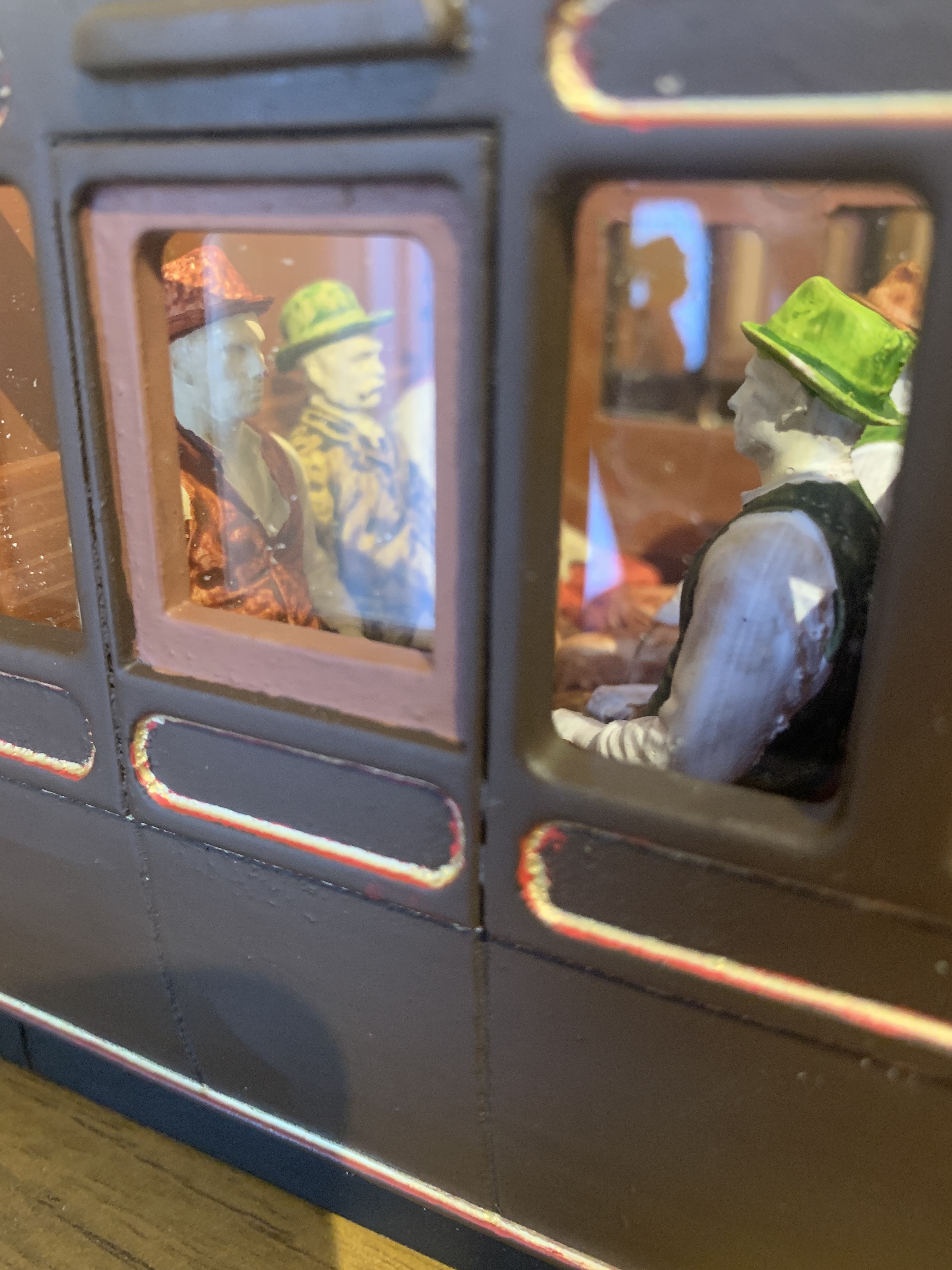

I have started again with the figures to go into these coaches.
Having followed both the "3D Print People" thread and Durley's "Figure Painting" thread I realised that I could improve what I was doing significantly!
So I have found early photos of people from West and Mid Wales on the National Library website and used some of these to create the figures using "Meshy.ai". I have also used "Google Gemini" to remove backgrounds, and various other unwonted features such as desks, chairs and the like. I have found that Gemini can often be used to make a figure sit down, as described in the "3D Print People" thread. I have also found that "Meshy" itself can remove the background. I have also worked out that I can upload a photo of a standing figure, and define the "pose" (a sitting figure with hands on lap) that I want "Meshy" to create a model of.

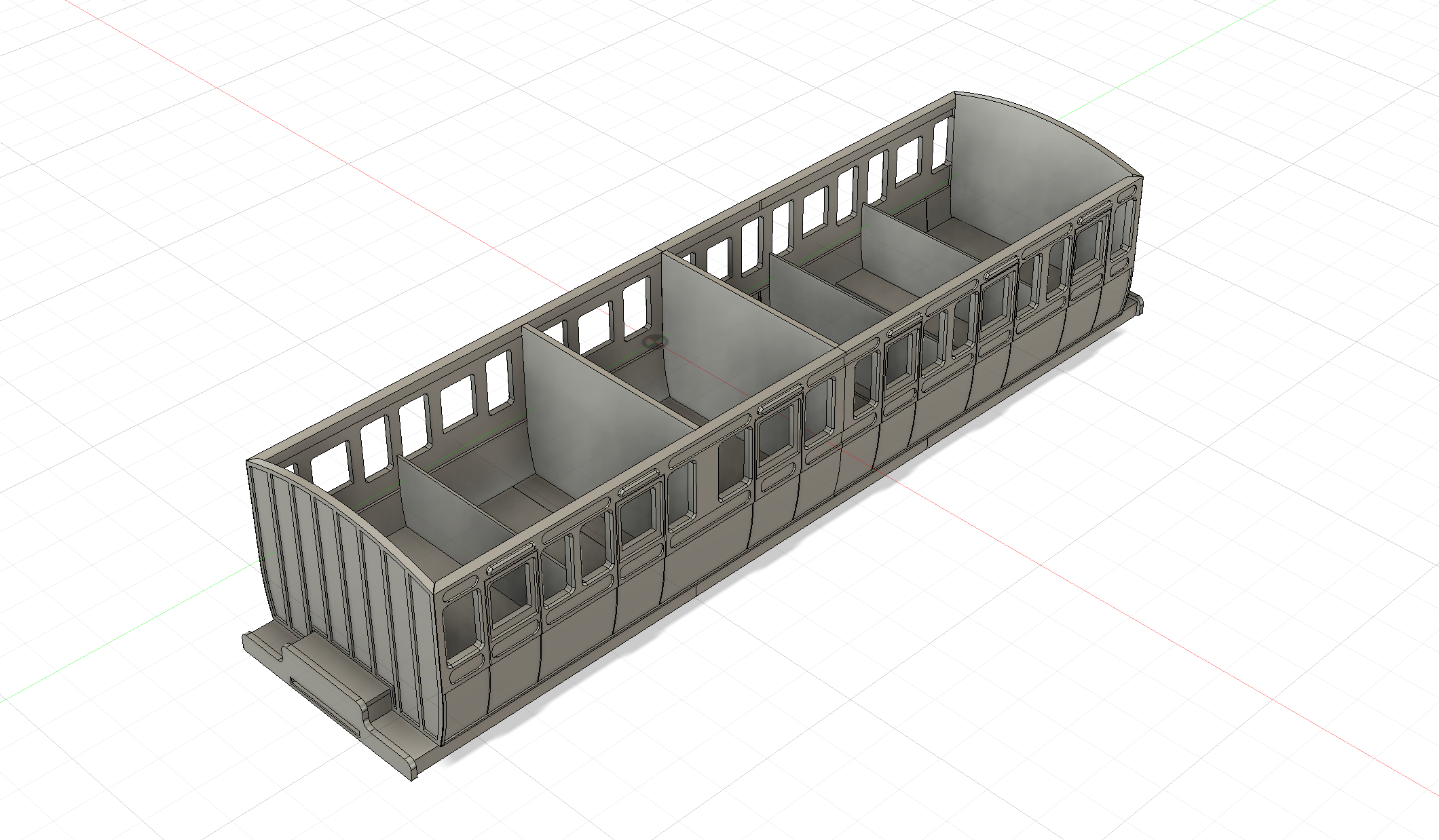

Having a number of ".stl" files for seated figures I added the figures into a mockup of the third class compartment which I drew in "Autocad Fusion". Fusion is pretty good for modifying the meshes of triangles contained in the ".stl" file. I have reduces the number of triangles in each file by 38% with no loss of definition as far as I can see. That speeded up the data processing considerably. I fitted the figures into the compartment by scaling and moving them around until they fitted the space available.
I want figures sat close together and that means that the figures overlap:
Here you can see three women in place. Finally I converted each figure into a solid object, and used the outline of the compartment to cut off any bits of the figures which was outside of the "envelope" of the compartment.
Finally hiding the compartment, to leave only the three figure showing I exported the new ".stl" file.
Printing two sets of three figures takes 18 hours on my printer, using a 0.2mm nozzle and the finest setting. Here are the group of 6 men who will go into another third class compartment:
And at last a group of 5 third class passengers in a third class compartment:
My first attempts at painting them following Dursley's description is far from perfect. But it is a start.
