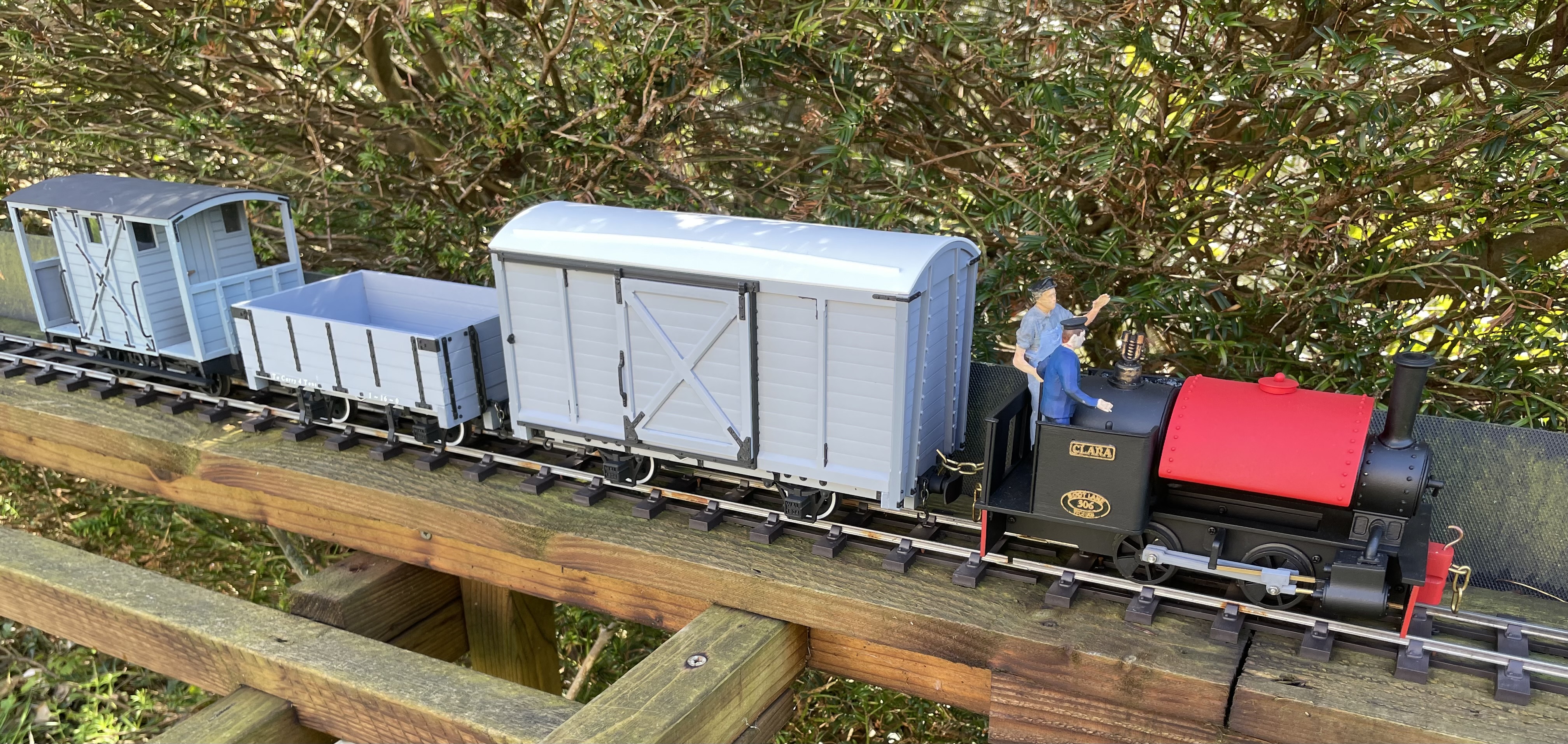

Apart from adding the rain covers above the doorways and transfers to the box van here are the two vehicles behind Clara and with a 16Mills brake van this afternoon:-
I'm glad I made the open first, it made doing the box van easier.
I would highly recommend these kits,

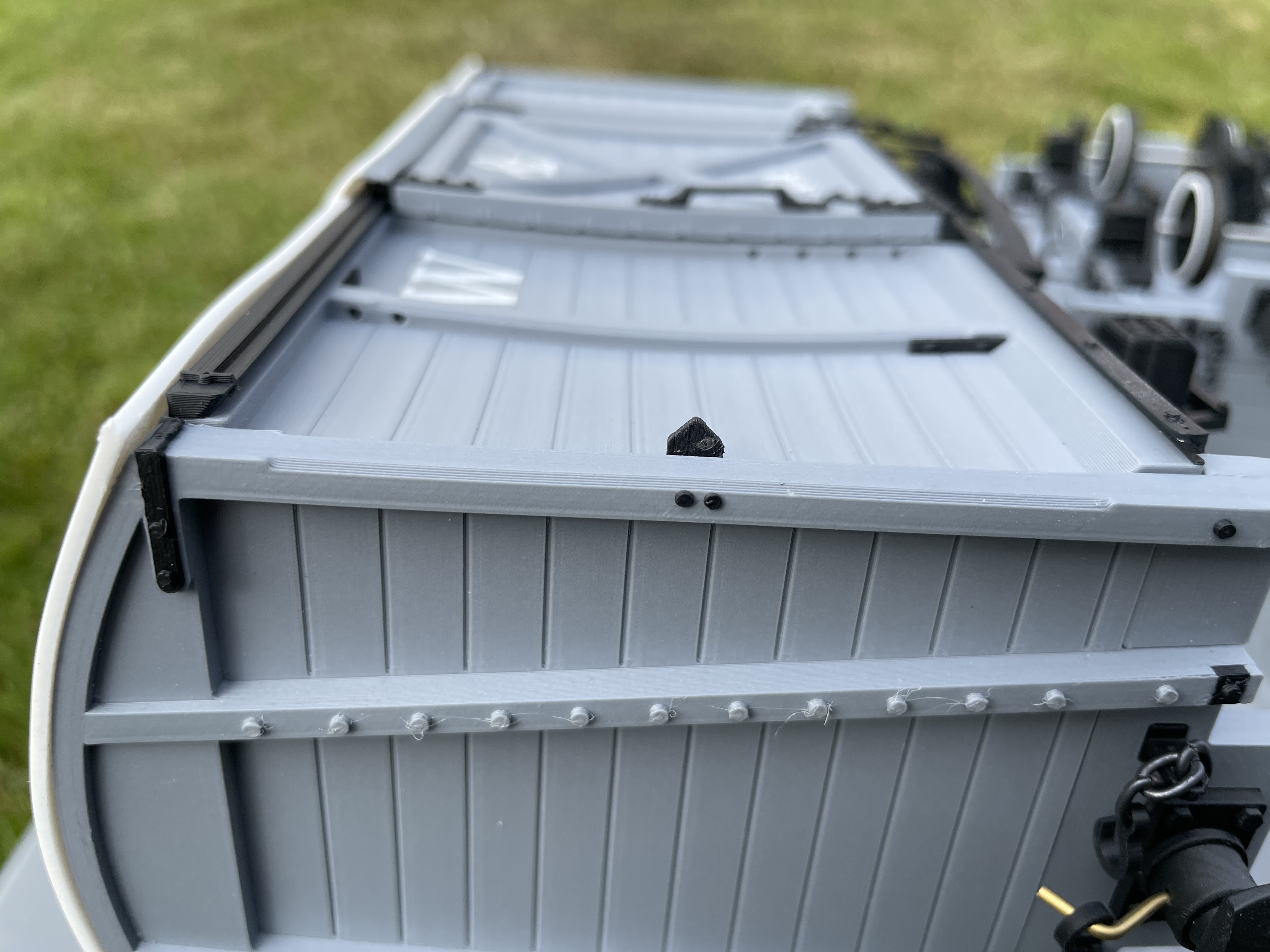

Ran the two wagons outside this afternoon. One of the van doors was open so I tried to close it only to realise that the side of the van had bowed inwards :-
I did spray the van with a clear sealer as per the instructions, though a different one from that suggested but from the same manufacturer, which was advised for outdoor use.
- Lonsdaler
- Posts: 1511
- Location: North Yorkshire
Re: Woodleigh Engineering
I think that's just temperature related Phil. Hopefully you can get it back into shape. And I'm now going to make sure mine are okay in my rolling stock store!
gilfachphil
- Posts: 447
Thanks Phil,
I expect you are right, the inward bowing is greater on one side than the other, presumably one that got more direct sun and so hotter.
Because of the way I glued the kit together, using copious amounts of solvent weld internally on the corner seams and attaching the roof I think disassembly is out of the question. I will leave it as is for now and hope to show it to Joe at a future exhibition, perhaps LLanfair which I think he may be attending. The wagons probably don't look too bad from a normal viewing distnace but the doors no longer slide.
The open wagon has also deformed a bit but not as much.
A question arises as to whether the material he uses to print the kits is really suitable for outdoor use? It is a great shame since the quality of the prints is outstanding.

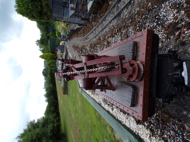

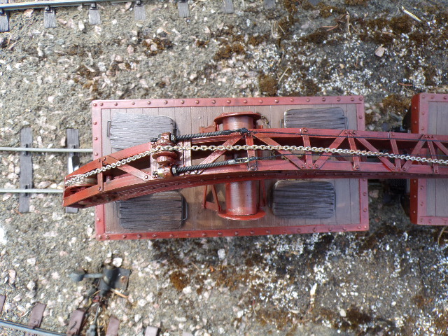

Let me just remind you of what happened to my L&B, 3D printed crane after taking it to a garden railway meeting in hot weather...
Fortunately, the crane part was replaced FOC, but although I asked at the time, I was not told what material was used.

You can soften the plastic with a hot air gun or hair dryer and then manipulate it. However, it's really tricky to get back into shape and you run the risk of making it worse. The best success I've had is to rest the offending part on the heated bed of a 3D printer, but it sounds like that's not possible.
Which solvent did you use?
- Posts: 6040
Depending on which material is involved, it may be moisture dependant as well as temperature dependant. PLA filament and water washable resin ( and possibly others?) are both hygroscopic and can both absorb and release moisture depending on the atmospheric moisture content and the temperature. So bowing can be due to either or both effects.

I sent Joe of Woodleigh an email yesterday including pictures of the problems with the van. He has replied promptly and said he will send me replacement kits free of charge. He states the material they are printed in is PLA, an industry standard for 3D printing, but best not exposed to strong sunlight.
Excellent customer service,
