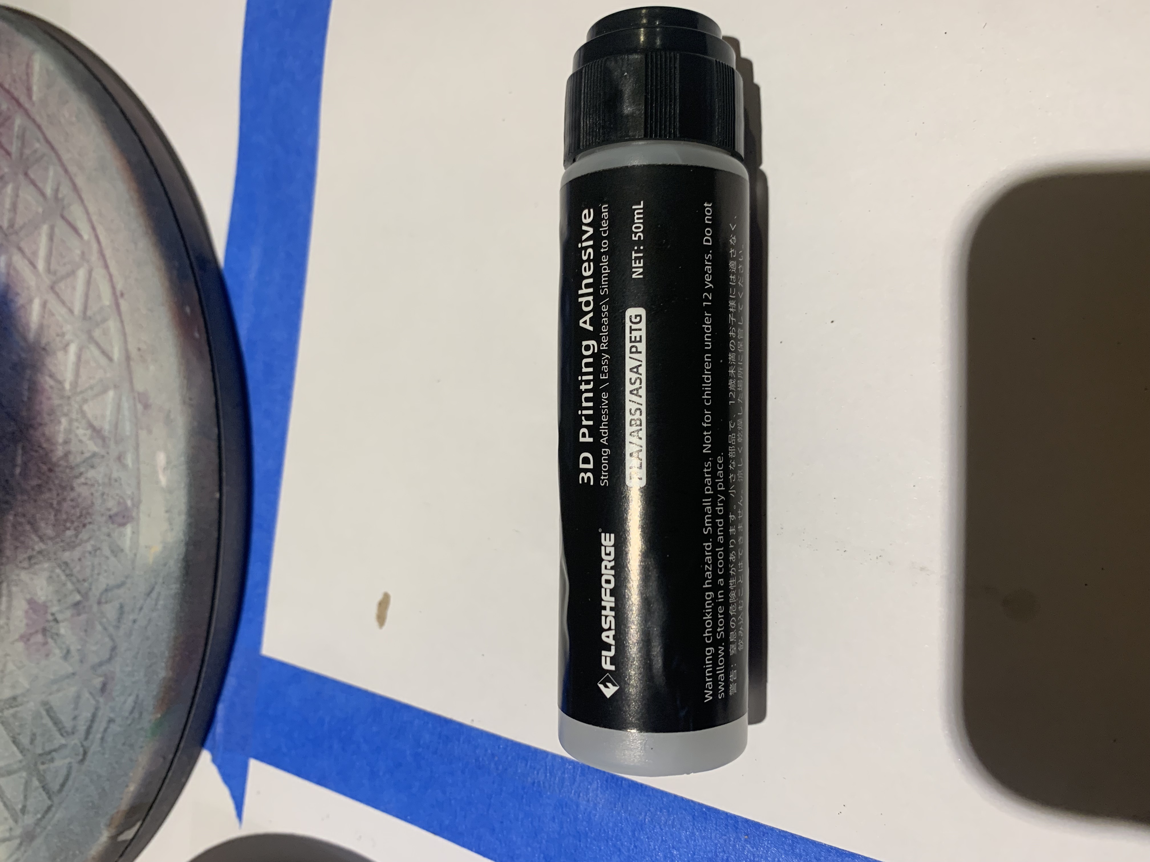

What is the glue you put on the printer bed?

philipy wrote: Fri Nov 15, 2024 12:45 pm That all looks pretty good Trevor, although it looks as though you'll have a lot of elephants feet to clean off the ladders?
The elephants feet look much worse in the photo than they really are. They are only 1 layer of filament deep, and were swiftly removed with a needle file. The glue us something which came with the printer, here is a photo of it:
I don't really know what it is. It certainly isn't like "prit stick". The best I can do is to describe my impression after applying it from the slightly "squeezy" bottle with a felt pad (when you remove the lid). The light colourless liquid glue passes through the pad when you apply it. When applying it I can see that there is a liquid on the bed, by the change in colour, but otherwise I wouldn't know I had applied anything. It dries quickly and leaves no stickiness.
I have applied it once since starting to use the printer - but have no idea how often I will have to reapply it yet.

The glue sounds a bit like "3D Lac Plus" which is also a clear liquid and can't be seen once dry, it comes in a pump spray bottle. I've been using it since Steve put me on to it several years ago and I think in that time I've re-applied it twice.

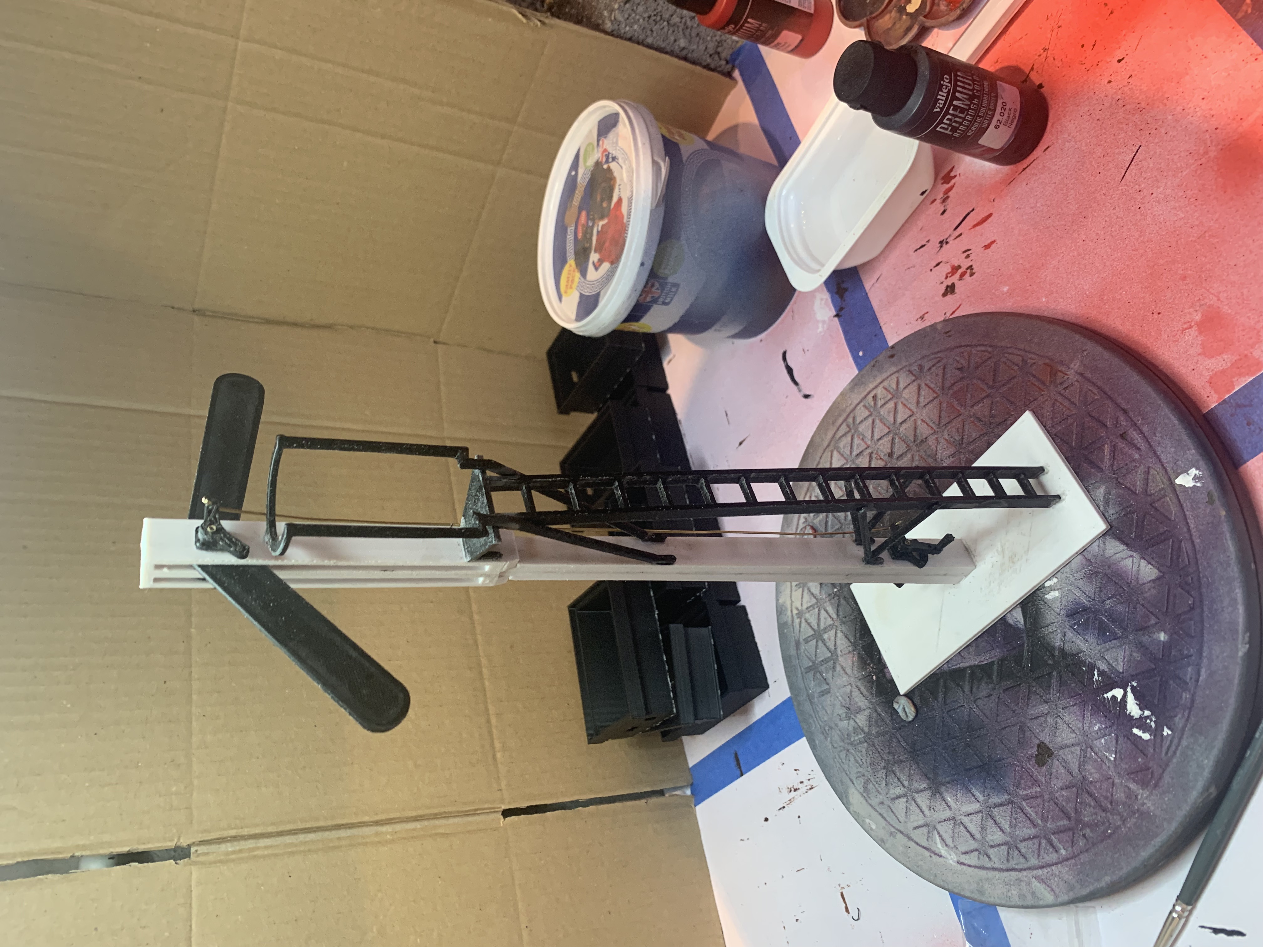

I have moved on to producing the semaphore signal. The final design:
Screenshot 2024-12-08 at 20.23.41.png (102.02 KiB) Viewed 89953 times
and the prototype so far:
The 10 disc signals are lined up behind it as well. These signals are 3 aspect (all right, caution, danger). One semaphore for each direction. The lights were white, green and red, denoting the meanings above (and in the same order). I initially planed to make these as just something to grace the line side, but I want to be able to control them remotely in due course. Thinking ahead I should work out how to implement those three colours. I have found tri-colour LEDs, Red green and a third colour by turning on both red and green. I wonder what colour that would be! So I think a test purchase is in order. I can see how that might work - with 2 tri-colour LEDs in the lamp one lighting in each direction and following the semaphore indication. Just more complex programming.
