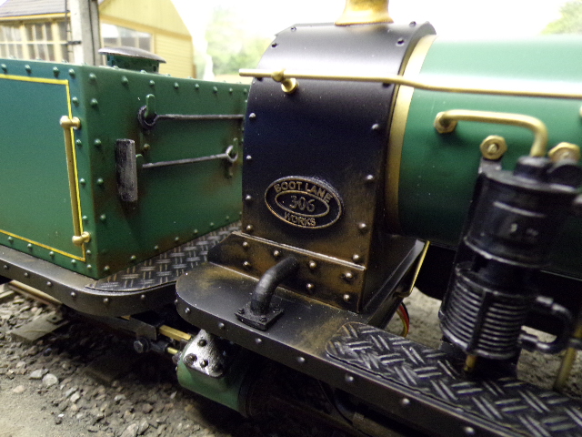

Posted: Mon Jul 08, 2024 9:57 am
I agree with all of the above. I also use Hycote paints as they are acrylic based and available in several useful colours (at the right price!)
Halfords acrylic range is compatible, also the matt and satin lacquers work together with either.
The Citadel acrylics are excellent quality and leave no brush strokes. They also work with the lacquers.
Here is an example of how they work together....
A little weathering takes the harsh, flat colouring to a different level.
