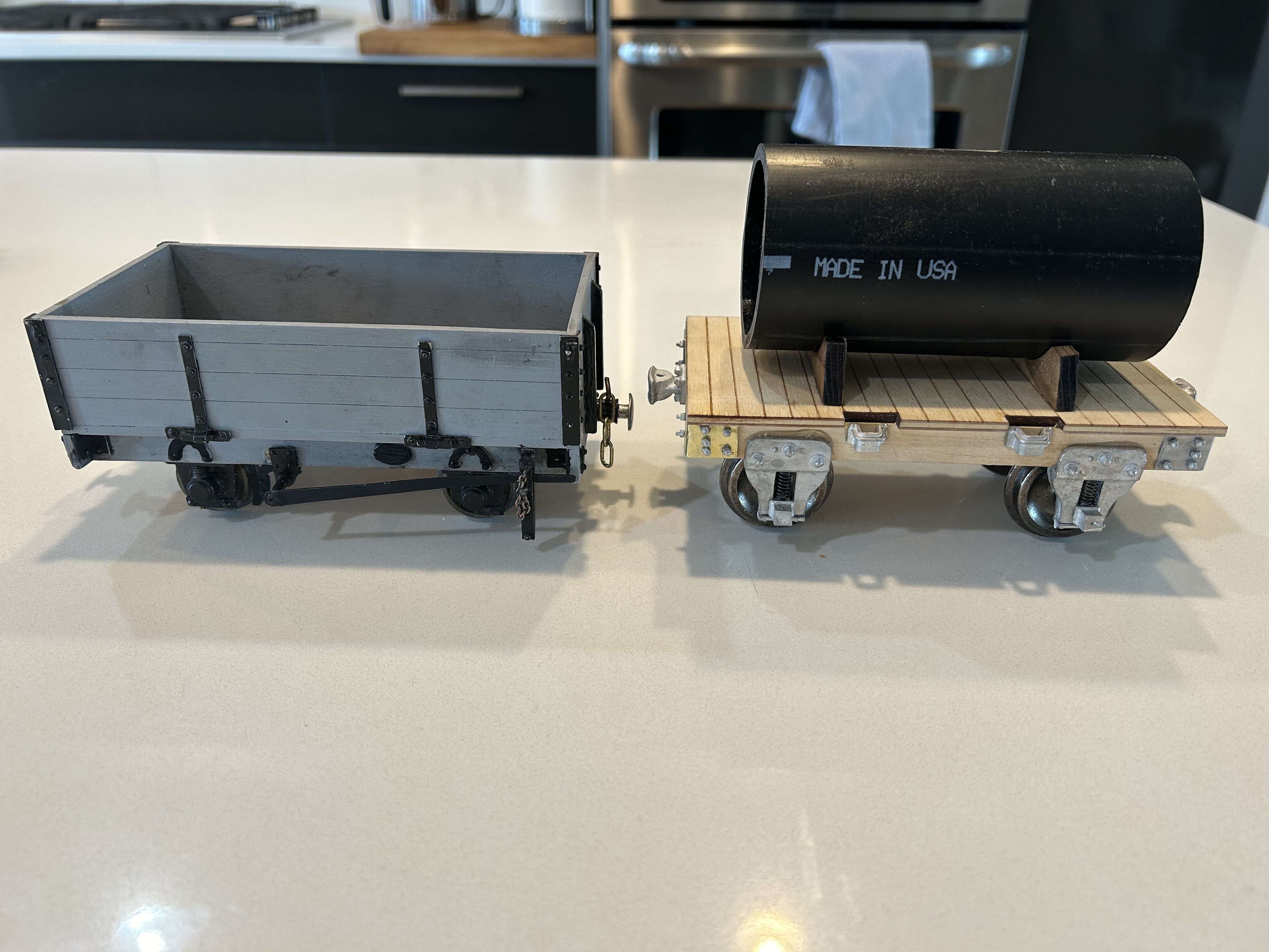

This is the 10-foot “water car” from OZARK MINIATURES in America. What a stunning kit it is.
It is 1:20 scale nominally, however being generic it is now 1:19 because I say so. The quality of this kit is superb, probably a bit better than a Brandbright coach in terms of features and additional parts. It is a bit pricey, but in comparison to a Brandbright panelled coach the water truck kit is 6 American dollars more expensive. But LOOK AT what you get! (I’m comparing it to a BB panelled coach because that’s the only other kit I’ve seen that approaches the value of this one.
The axles are fully sprung in functioning journal boxes. All the litttle ratchet straps and chains, frame irons and a functioning top hatch are included, plus a little ladder and an American style brake wheel. The ends of the water barrel come ALREADY PLANKED, and all the timber is already cut to size. There are no frets to pull plywood bits off. In fact there is very little plywood at all. The deck is plywood, etched with planking detail, and the end caps are ply but as I say already planked with real timber veneer. The rest is timber. Already cut to size and all. This kit is excellent value. To achieve the level of detail it offers, an IP engineering wagon would require a lot of extra parts, like the frame irons and brake apparatus, which would put the cost of the build past what this kit cost.
Also even though it’s an American model, it seems basically generic and so will probably fit in just fine with my British equipment, which is mostly all generic as well.

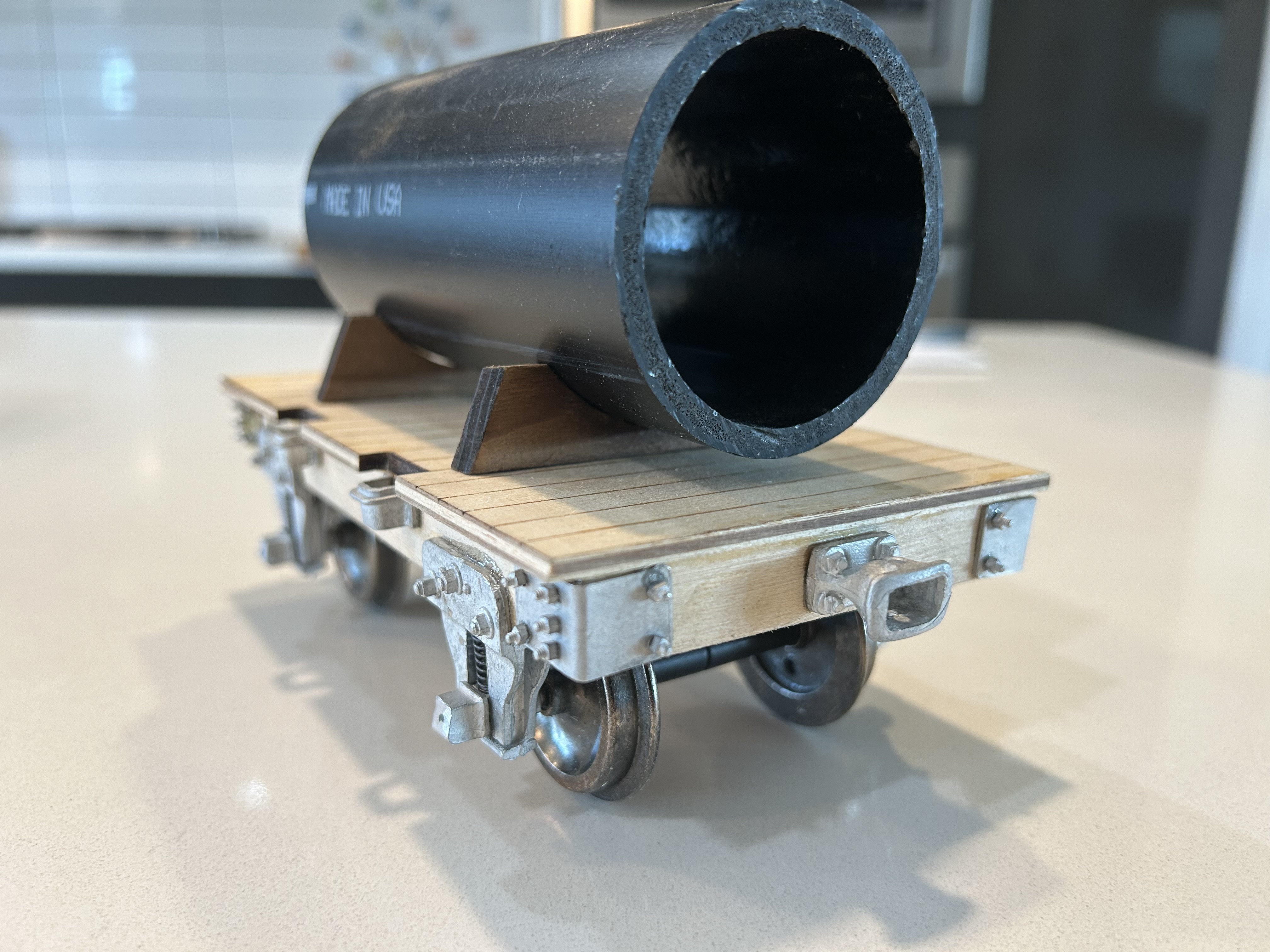

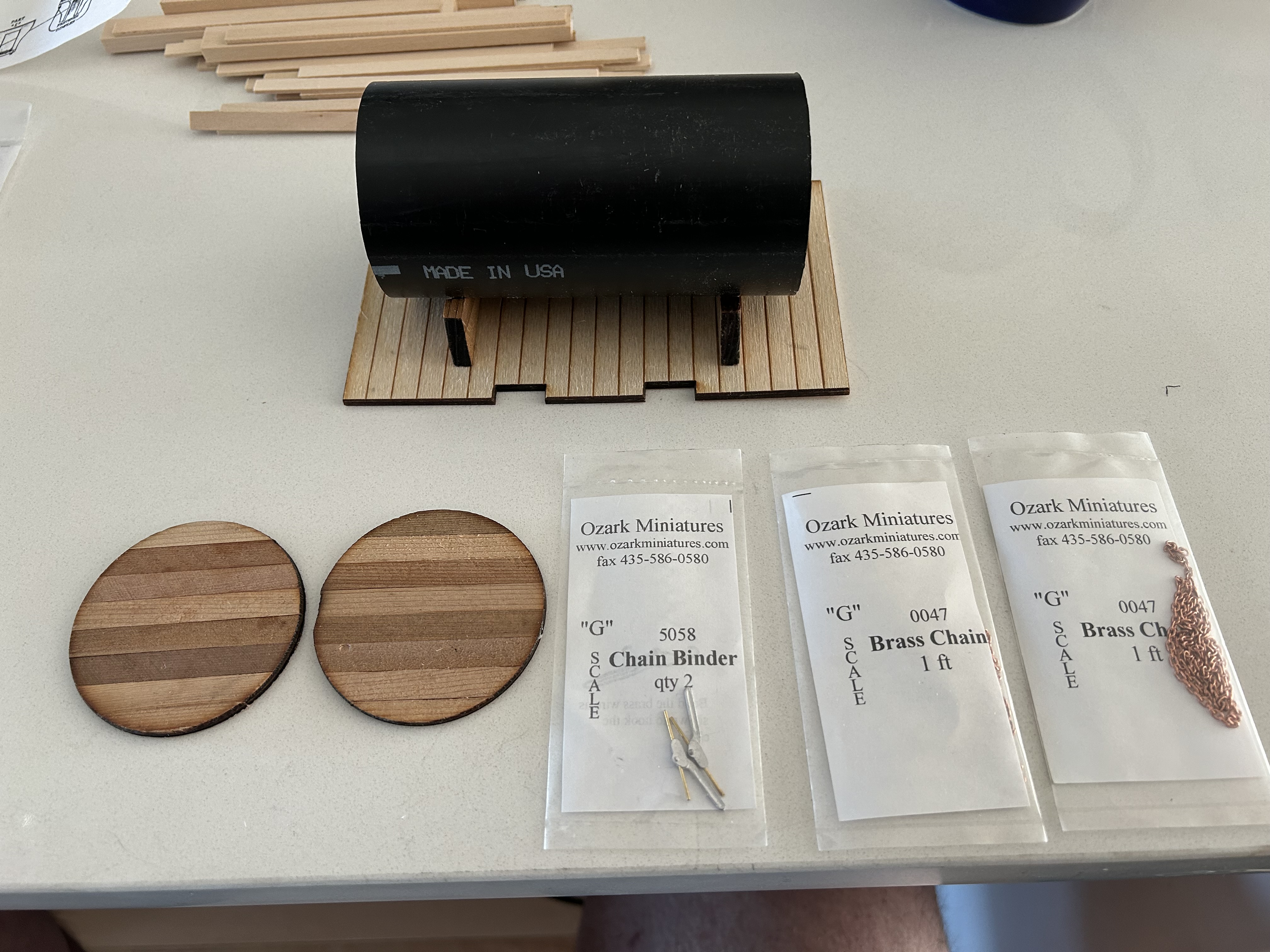

Here are some pictures of the kit as unboxed. Observe the wealth of extras. The wheels are pre-blackened.
The only drawback to the wagon is, it doesn’t come in 32mm gauge. It does look easy enough to modify although you’d need new wheels. They look to be similar to the ones Brandbright sells although that will add to the cost.
I will add more photos as I build this. So far I am extremely impressed. I hate to say it, but you seldom if ever see this many features on a UK model, at least not without spending a lot more money.

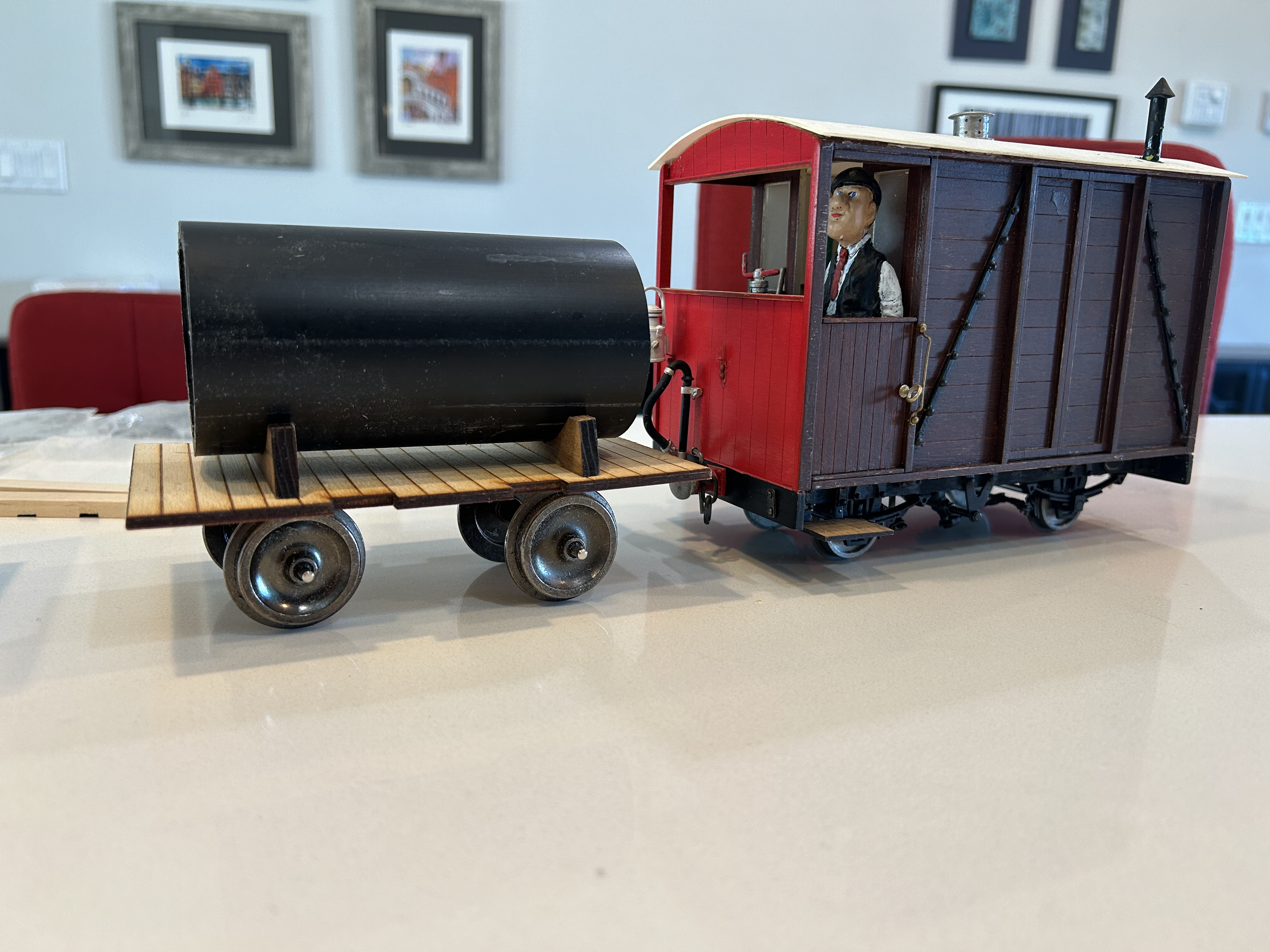

Also here is how the parts look in comparison to my 16mm scale IP van.

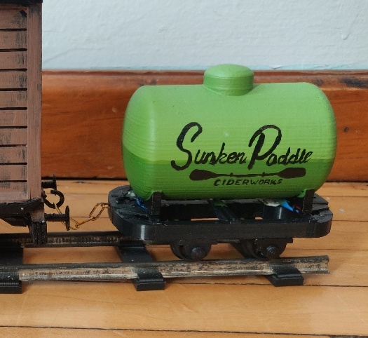

Found a picture of mine: The colors are matched from the labels on their bottles. I had a bit of trouble with the freehand lettering so I made another version with raised letters, have printed it but haven't painted it yet.

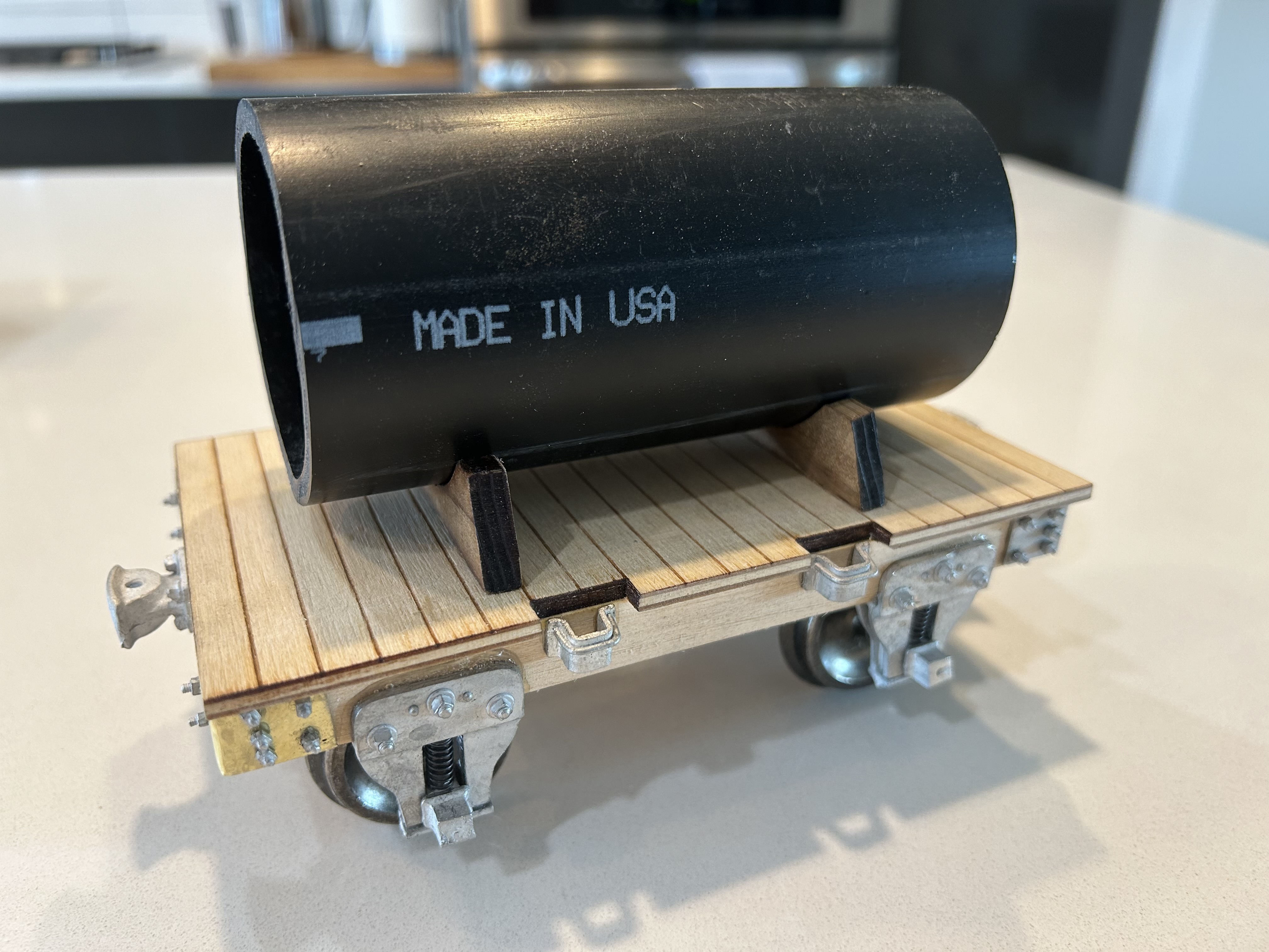

Here is progress on the tanker. Frustratingly the kit was missing one of the chassis corner brackets so I’ve made one from a scrap of brass. Otherwise everything is high quality. The frame is relatively heavy timber and the castings are crisp and fit together well. Under magnification the bits of bolt sticking out the ends of the separately fitted nuts on the frame irons even have threads!
One thing that I will have to address is the vehicle’s height. The axles are sprung, but of course the wagon doesn’t weigh much so it rides very high. The centre buffers just barely touch the IP ones, and they float right over the ones on my Roundhouse locomotive. When I squash the wagon down onto its springs, it sits at an appropriate height. I appreciate the interesting detail but I will have to put little timber blocks under the journals to compress the springs and allow the completed truck to be compatible with my British rolling stock. Still, I am impressed by this clever kit.

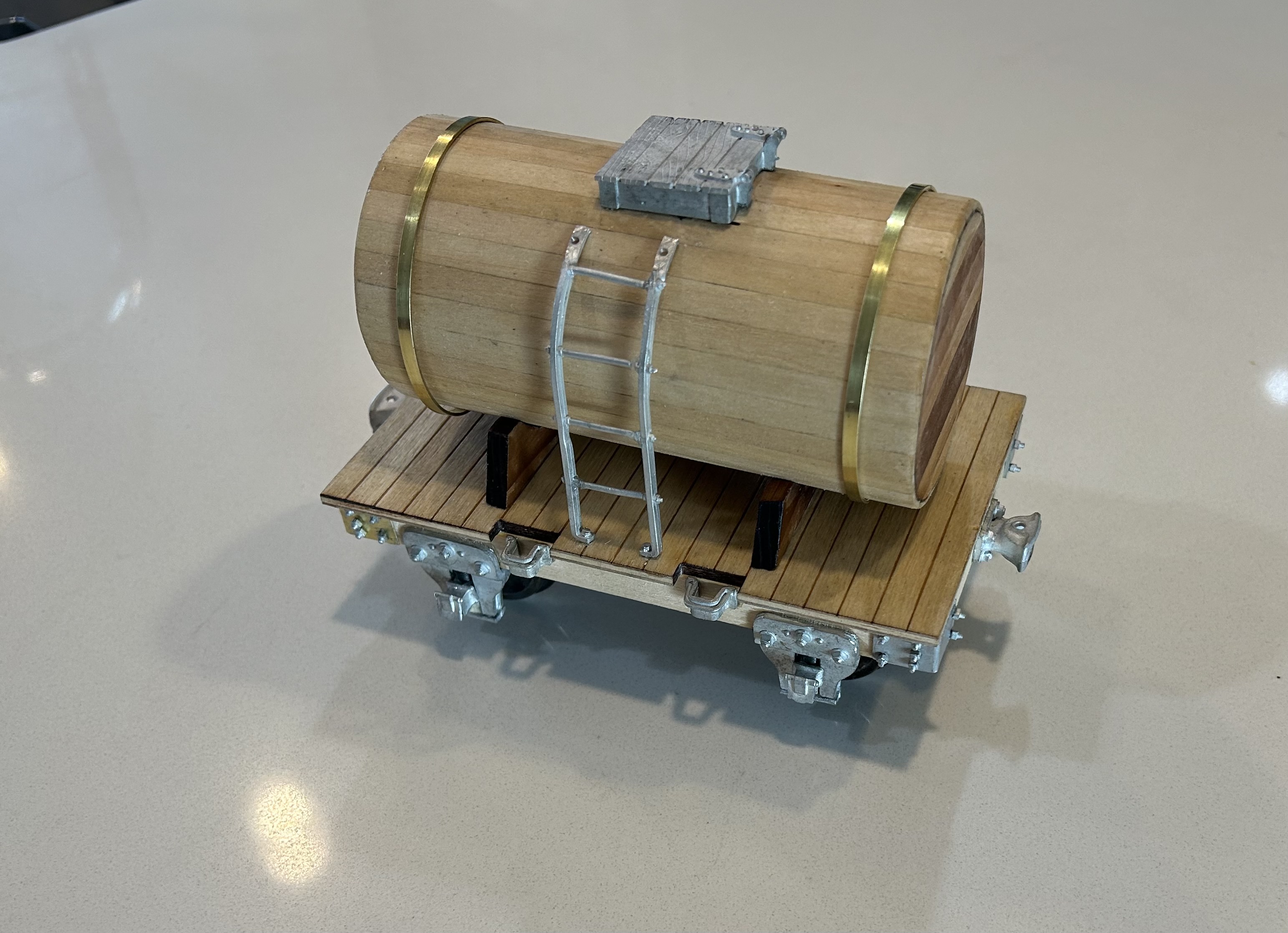

Some more progress on the tanker. The kit did not come with enough staves for the barrel, but luckily I had some similar wood from a model ship I’m building.
I wish I hadn’t cut them off so close to the end caps: a real barrel would have some overlap but I didn’t think of it until I was nearly done trimming them off. Still loads of metal bits to stick on, but it’s looking OK so far. Still haven’t worked out what colour scheme it will have.
