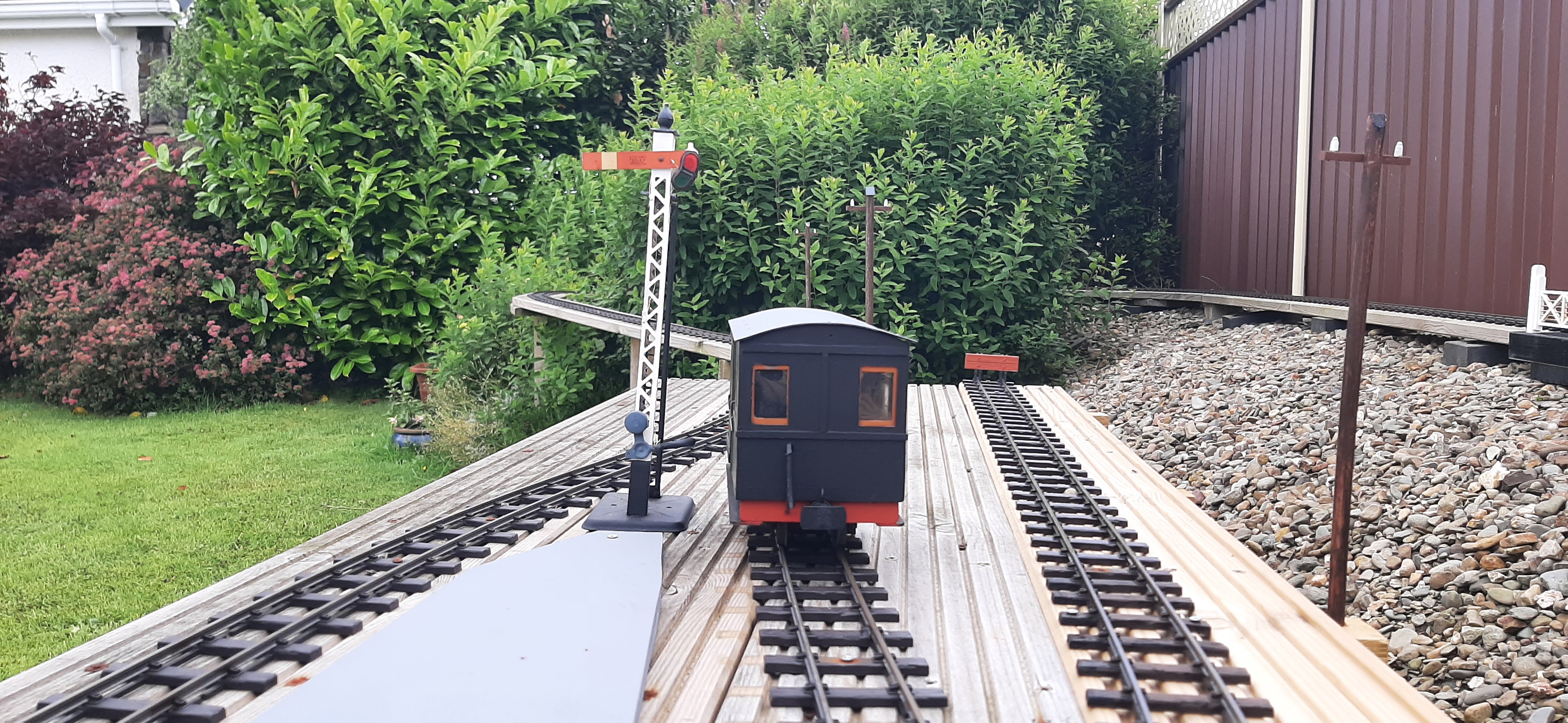

This is a topic devoted to my garden railway, the Sheehaun Light Railway. It is 45mm gauge and nominally to 1/20.3 scale, but some proprietary 1:24 or larger equipment is used. It’s Irish-based, with the backstory being, well… posted on the Irish Railway Modeller forum. Go and look at it. If you do, you’ll see it’s gargantuan! (The backstory, not the railway haha). Any questions welcome. Thanks, LNERW1

Thanks for the support. I may shift the main SLR thread to be this one, as I don’t want to have to keep up posting on two different threads. Just a couple more things about the railway- uses LGB track, meaning set geometry which can be interesting, and in total the railway cost €20. This was the cost of the only thing bought new, with all other stock, track, buildings, figures etc. being inherited from my late great-uncle, who ran a model- based park in County Wicklow. As far as I know it shut down in the early 2000s but he had a garden railway afterwards, and when he passed his wife sold on the most valuable stock, and passed the rest to me. A lot of it is scratchbuilt around an RTR LGB chassis block. Some of the track also appears to have been modified, with a central sleeper and a short length of rail being removed, presumably to line up with something or fit in an awkward gap. More info to come,

I have a question I thought I would pose to this forum rather than any other, as I an sure some member here can be of assistance. I am planning on implementing a full signalling system on the SLR, consisting of wire-in-tube "signal rodding" running from several boxes and ground frames to points and signals. My main question is where to source signals, as all I have found so far ar Tenmille components, which are out of scale and in brass, which I'm not comfortable working with, or 3D print files uploaded to RMWeb, which I think would be too brittle to use. Does anybody have a good source of laser-cut or plastic 1:19, 1:20.3 , 1:22 or 1:24 signals? Even metal components might be alright if they are in scale and easy to use. Thanks!
