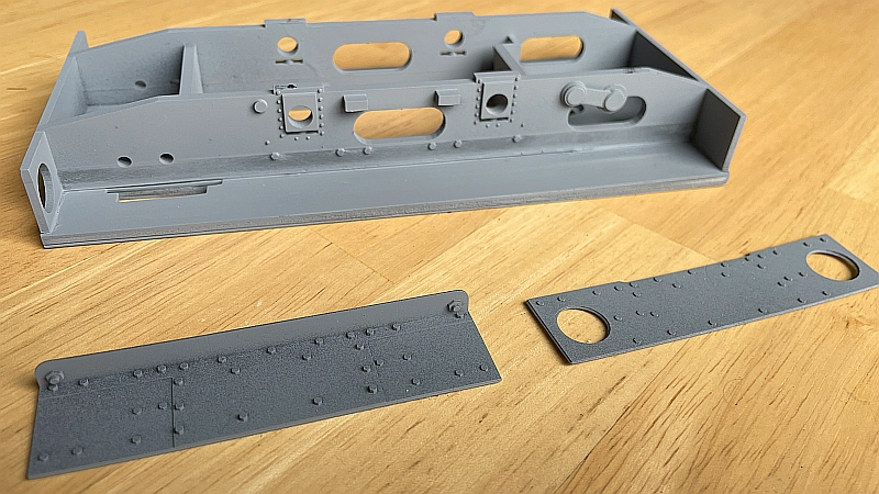

Steve's "Alice" type Hunslet inspired me to have a go at one. As he himself said, his is just basic and lacking a lot of detail and he was quite happy for me to do whatever I wanted to his basic stl's. ( thanks Steve).
So anyway, the stl's imported into Sketchup with no problems at all and I've spent the last couple of weeks adding rivets etc, and redrawing a few bits to get them the way I wanted. Once you start down this particular rabbit hole it is amaaaaazing just how many rivets and bolts and lumps and bits, there are!
Rather than an "Alice" I'm doing a "Britomart" type and since it won't be an exact model of an exact protoptype, Rule 1 applies! The final batch of Quarry Hunslets went to the Nantlle Vale quarries, two to Pen-yr-Orsedd Quarry and one to Dorothea Quarry I believe.
Strangely enough I can't find any references to the 4th one of the batch. :roll: However I do know it's name was " R G Laird". By a strange coincidence, a Scottish distant cousin of mine ( 1st cousin 4xRemoved ) called Robert Grimmond Laird, was shown as "Mechanical Engineer"on the 1901 census and he was living at Tan-yr-Allt Hall which is sandwiched between New Vronheulog Quarry and Tan-yr-Allt Quarry and various other workings in the Vale, and only about 1 or 2 miles from Dorothea and Pen-yr-Orsedd Quarry. Both of the nearest two are shown on the map as having sizeable rail networks, so I assume that he arranged for the purchase of a Hunslet and the quarry owners were so impressed with it that they named it after him. ;)
So anyway, back to the model. I'm printing most of it in resin and the chassis and footplate are now off the printer, together with 2 buffer beam overlays. I'm doing it like this to take advantage of printing things flat on the plate to improve the surfaces with little or no supports to worry about. The wheels are also done, but in filament. I'm trying a new type of filament for them and I'll say more about that later.
Now with the footplate glued to the underframe and the buffer overlays alongside, this is where I am today, in primer.
I'm going to try painting the various components and sub-assembly's before putting it all together in the hope of avoiding all sorts of masking issues further down the line.

Amazingly crisp prints really showing off all the extra detail!
Just to be clear - frames printed separately from the footplate? (And flat to the bed too, so oriented at 90 degrees to how we are seeing them?)
Re: Quarry Hunslet
Posted: Mon Apr 29, 2024 2:25 pm
SimonWood wrote: Mon Apr 29, 2024 2:09 pm
The footplate was printed by itself, upside down from how it appears in this photo - a simple 2mm thick slab with a small groove on the long edges and various openings for motor etc in the slab. The U/f was printed as shown but without the footplate underneath ( obviously). Then simply superglued together, and no problems with the two perfectly flat faces mating.
Two reasons for doing it like that:
(1) There is a shallow depression on the top of the footplate in front of the smokebox, which wouldn't print if it was on the bottom ( plate) face.
(2) In the past I've had issues with doing large prints which have sidewalls, flat on the bed. The resin swirl and suction tend to cause adhesion/distortion problems.

Not quite sure how it happened but when I printed the footplate I seem to have used an earlier drawing rather than the final one. It was only after I printed it and glued it to the frames, painted and posted about it, that I realised the error. :oops:
There should be a row of rivets across the front of the footplate and two pairs either side of the smoke box. I did draw them but then must have grabbed an earlier drawing. I didn't really want to go back to the beginning and redo everything but 1mm diam rivets are fiddly to say the least. In the end I managed to print them at the correct final spacing, upside down and attached to a flat strip by a thin support.
A touch of superglue on each and held in tweezers and they were fixed in the correct position ( almost, they are slightly offset to the left!). Left a couple of hours to be sure then snipped off. It seems to have worked Ok and once all painted should be fine, I hope. This close up is rather cruel - bare in mind that the rivets are only 1mm!

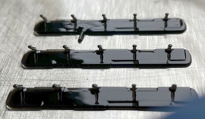

Things have been trundling along and I'm making some changes and reprinting the chassis/footplate. Not that there is anything wrong with Steve's original drawings but different people do the same things in different ways. :roll: I'll come back to that when I know if my way works. :lol:
In the meantime, the cab, firebox, brake standard and reverser are now printed.
In order to save time and make use of the space, I printed all these items at the same time. The cab alone took took fractionally over 12 hours so the other items were 'free' in printing time terms.
This picture shows them still on the flexible magnetic build plate.

The "free" print time is one big selling point of a resin printer. (That and of course the detail!)
When I try printing a bunch of things at once in FDM, all I get is more points of failure.

I very rarely try printing more than one thing at a time in FDM. It's no quicker than doing them individually and as you say, more chances for things to go wrong. The only real exception, for me, is a set of wheels. Printed flat on the bed the m/c can't really get it wrong, just going round in circles!
