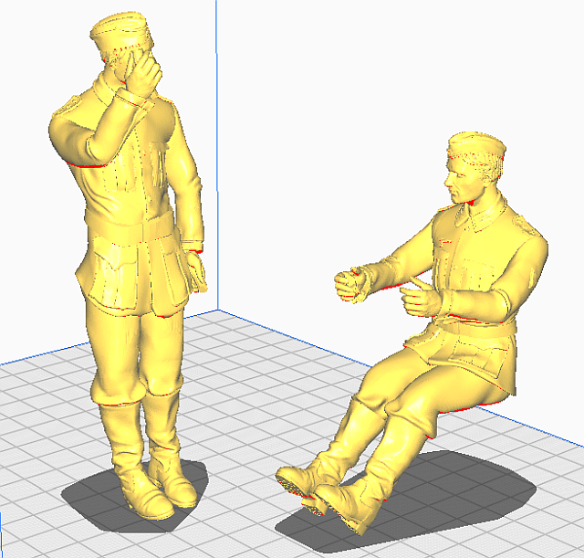

I recently discovered how to import stl's from the net ( or wherever) and alter them to be poseable in Blender. Since there was a some interest in how to do it, I've put together these notes, which will hopefully explain everything. If something doesn't work properly, please let me know.
This screenshot shows the original figure on the right and a 'posed' standing version on the left.

Actually I've just noticed a small omission which may be obvious anyway, but just in case it isn't, please note that the first bone that you create is the collar bone and it needs to be extruded from its origin at the back of the neck, to the top of the shoulder. After that, the instruction to extrude the second bone down to the elbow is correct.
There were also a few typo's so I've updated my pdf to V2 and you might want to download again if you've got the first one.
FWIW, I've just printed my first figure and it has printed exactly as I had posed it, which is something of a relief.

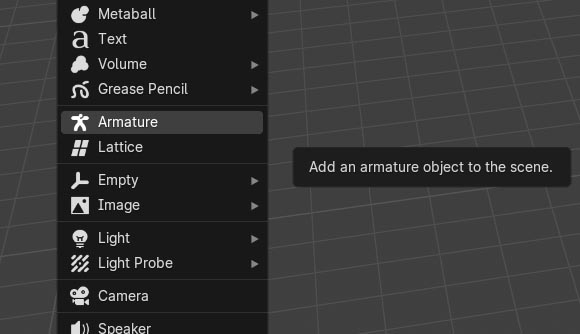

One issue is your paragraph;
"Now we have to add an “Armature”, with a single bone. So Click the “ADD” button ( to the left of
the OBJECT button we just used), and then scroll down to “Armature” and select “Single bone”."
This implies a sub menu with 'single bone', but the armature option doesn't have any sub menus. Just adding an amature does seems to work. This seems the same on both veresions 2.9 and 4.
I did manage to work through and change a figure (it also works with .obj files too), so finally something constructive out of Blender here.

As I said, I don't see that sub menu (both in 2.9.2 & 4.0.2) on the default installation.
- drewzero1
- Posts: 850
- Location: WI, US
Re: How make stl files poseable with Blender
At first I didn't have it either, but I did some searching and it seems the submenu is added by enabling an add-on called 'Rigging:Rigify'. See here: https://blender.stackexchange.com/quest ... ns-missingPaul_in_Ricky wrote: Fri Mar 15, 2024 10:12 pm As I said, I don't see that sub menu (both in 2.9.2 & 4.0.2) on the default installation.
Tl,dr: Edit > Preferences > Add-ons, search for 'rigify' and check the box.
I ended up just clicking 'Armature' and it seems to have started adding a bone that way, though it was so small I didn't see it right away. (Luckily the guide mentioned that possibility, saving me some confused flailing
I'll have to do more playing around with it when I have more time to make a full skeleton and a model that needs it... I tried with just one arm and it made my figure flop around hilariously at the waist! The complexity of Blender tends to put me off, and I've had several failed attempts to do anything in it, though I did use it to illustrate the instructions for Thornas somehow.
- Posts: 5974
drewzero1 wrote: Sat Mar 16, 2024 1:44 am
I'll do a v3 update.
Edited to say it's now updated - see link in original post this thread.
