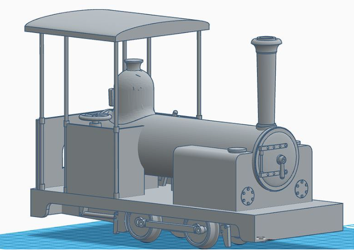

Thought I would do a cabbed Hunslet type loco, but for 32mm this time, unlike Stephen which was 45mm. Not built it or even printed it all yet, but it's getting there.

Ooh, that's looking a bit tasty. :D
You planning on resin or filament or a mixure of both?

philipy wrote: Sat Feb 24, 2024 12:40 pm Ooh, that's looking a bit tasty. :D
At the moment filament, but I think one or two bits will end up being resin, namely the water filler cap as it does not print well in filament. The rest is doing quite well. I had a motor in a chassis with just the back 2 wheels in and it runs well enough. Bit of a tight fit between the wheels, chassis and motor mount. To be fair, I might end up making the wheels on the lathe as they will be truer and there just isn't any room for even a minor wobble. For me the wheels are a day in the shed on the lathe, a bit on the cool side for that right now :oops:

Very tasty! Almost worth changing to 32mm gauge .....

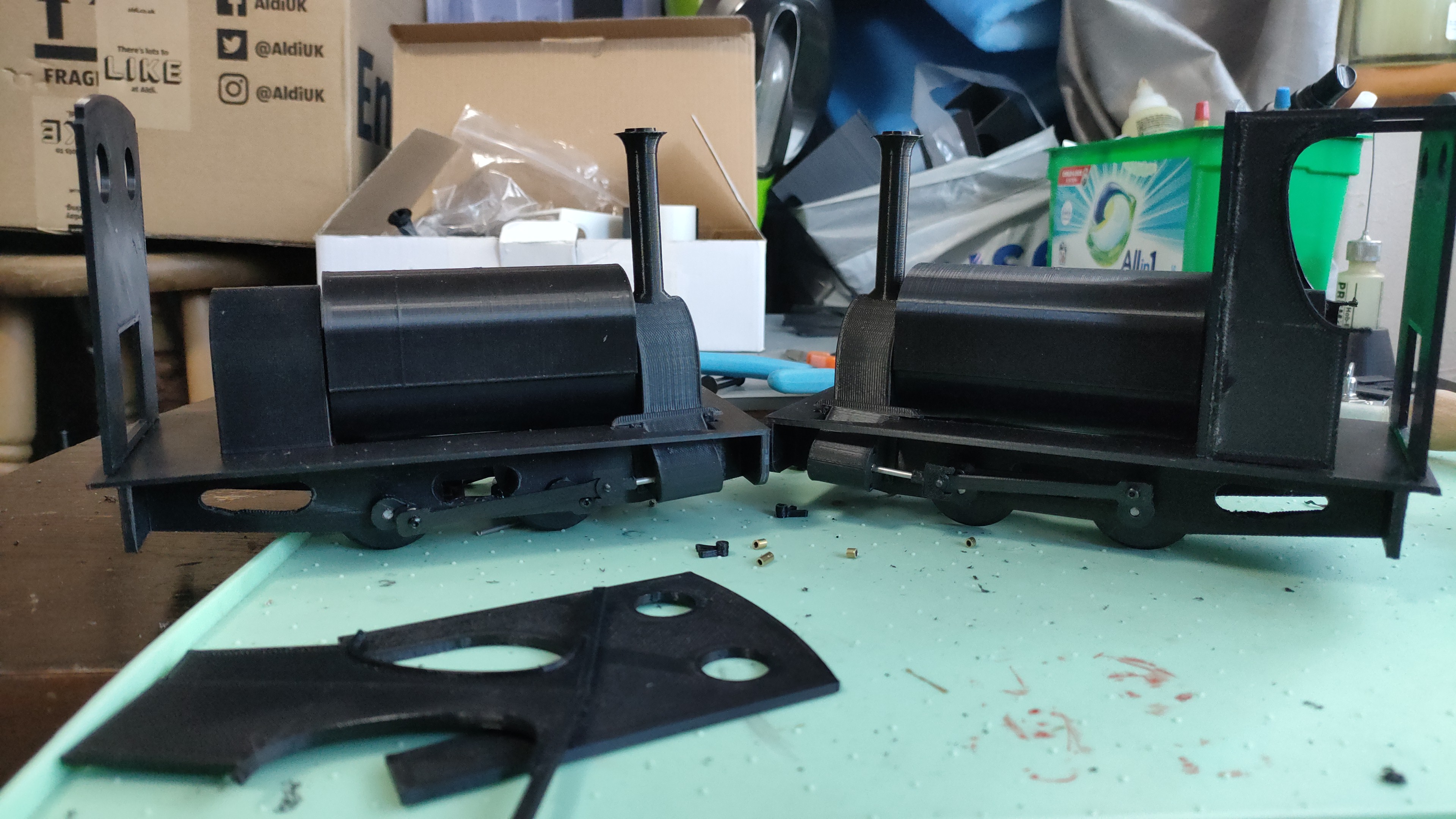

Well not much to report, but I have started the initial build of this, it's going together reasonably well so far. I have done two chassis as a friend wanted one as well. Obviously loads left to do, but making progress.

Looking very good so far.
Are you going to wallpaper them?
Re: Cabbed Hunslet
Posted: Sun Mar 10, 2024 4:44 pm
Steve, you're either an untidy worker or proud to show off your wonderful collection of screws and bearings. A most impressive assortment!

Peter Butler wrote: Sun Mar 10, 2024 4:44 pm Steve, you're either an untidy worker or proud to show off your wonderful collection of screws and bearings. A most impressive assortment!
Unfortunately I am a seriously untidy worker, I like everything to hand. The really surprising thing is, I actually tidied it up a lot before taking the pictures, lol :lol: The screw boxes you see, I have LOADS of, in fact a wall full of them and I could do with more :oops:

philipy wrote: Sun Mar 10, 2024 4:30 pm Looking very good so far.
Not sure about the finish yet. I think some will end up papered and some won't, depending how hard it is to get a good surface with sanding alone. I will probably do one in black, if I build another, not sure of the colour.
