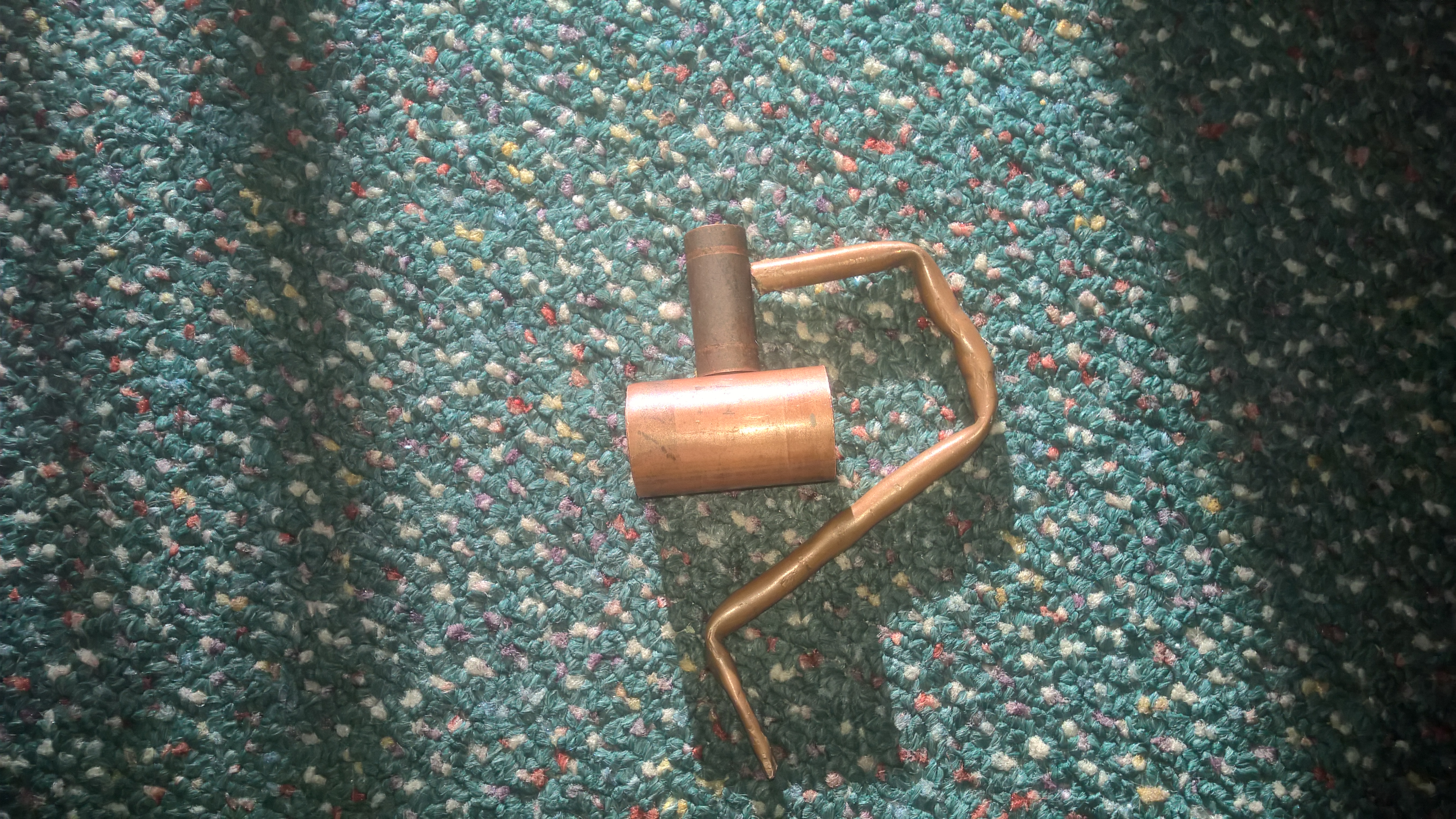

It would be nice if I had some large diameter copper tubing for a boiler, but this is all I have. I think it might be enough for a small speeder/inspection car that wouldn't be required to pull a load, besides maybe a small trailer.
The larger tube is 7/8" diameter, 1.5" long and holds about 9 ml 3/4 full. The smaller tube, which would be the steam dome, is 0.5" diameter and 1.25" long.
I do have a heck of a lot of the smaller stuff though!

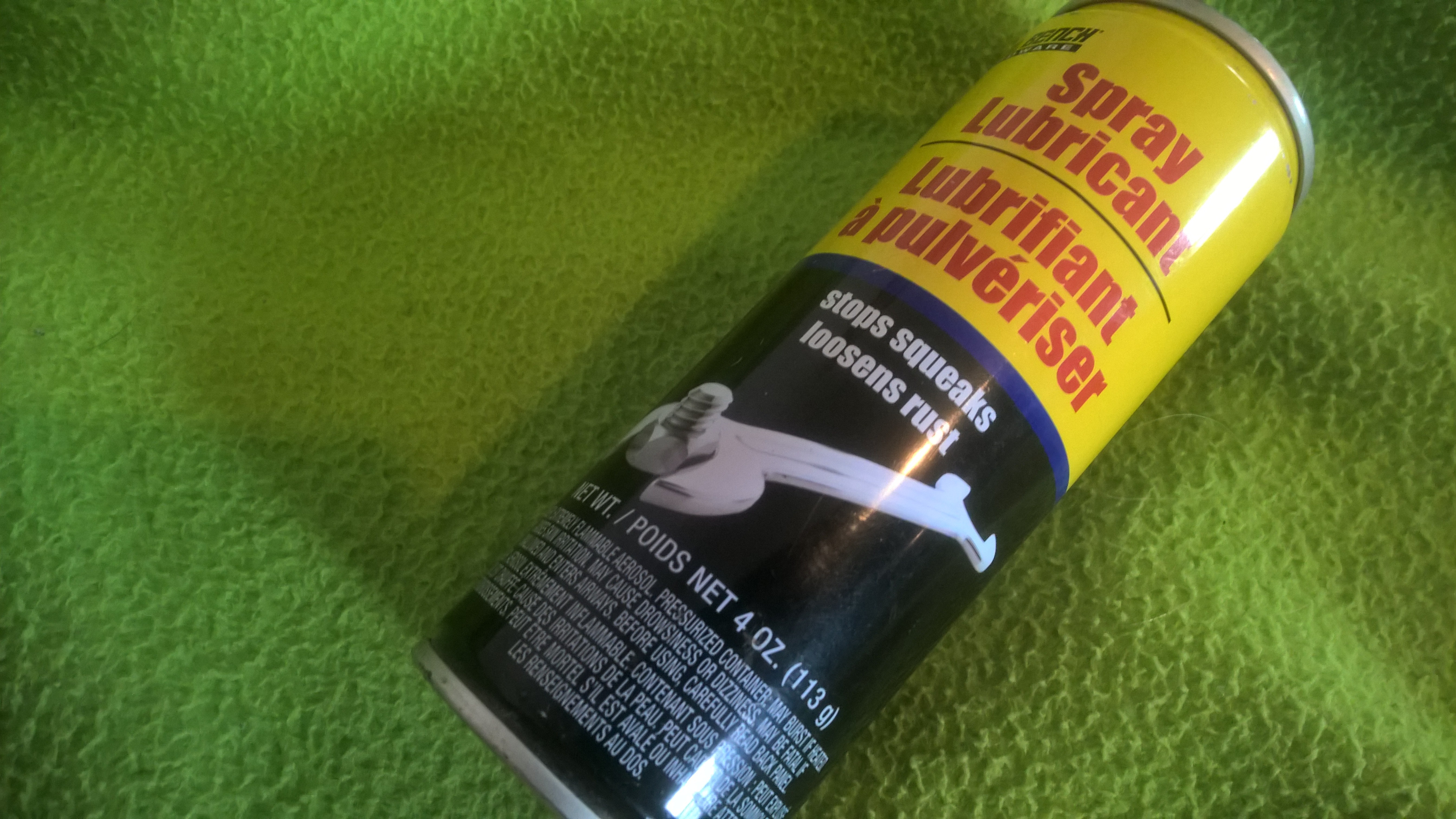

Is this a terrible idea? (Probably.) It's a pressure vessel, but it does say "may burst if heated"... Does anybody know what kind of pressure these can take?

I just looked it up and apparently the pressures vary from 2-8 bar, I assume that means most cans can take 10 bar or more.

dudeface wrote: Sun Dec 03, 2023 7:43 pm I just looked it up and apparently the pressures vary from 2-8 bar, I assume that means most cans can take 10 bar or more.
These are super thin metal and will distort under heat, by distort, I mean it could blow up in your face, something with a thicker wall is strongly advised. :shock:

Most ( all?) aerosol cans carry the warning "Do not incinerate even when empty". I know you are not intending to incinerate it but applying a naked flame to part of it would effectively achieve the same result!

Fit a safety valve..
Would be my advice, and don't re-purpose an aerosol can.
If it pops, it is the hot contents, you need to worry about..
And I doubt anyone would certify it, or any association insurance cover you for public liability?

philipy wrote: Mon Dec 04, 2023 9:51 am Most ( all?) aerosol cans carry the warning "Do not incinerate even when empty". I know you are not intending to incinerate it but applying a naked flame to part of it would effectively achieve the same result!
It would be filled with water so it would be kinda hard to ignite the residue, but don't worry, I'm not going to do it.
