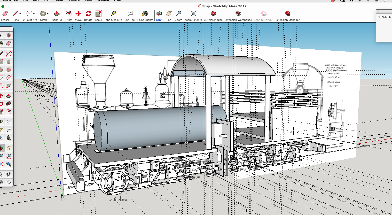

I have also thought about making a Shay.
In fact it was something I thought about making next - to follow on from the three D printed 4420. I was thinking that it would be a appropriate for a 3 D printed live steam model. I have drawn it up in Sketchup - and it is near enough ready to print. It is based on the plan from Colin Binnie's archive. If you are interested you can have the files to play with:
As far as flexible joints are concerned it wouldn't be difficult to make the Harley splicer type couplings, and they might even work if resin printed. I was going to try that. Don't forget that each shaft also needs to change its length, I was planning on rod with a wire passed through it and a tube with a slot to slide over that rod. again I think the tube with slot could be printed. Well that is what I thought to try first.

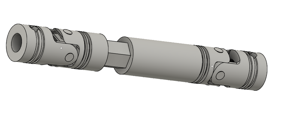

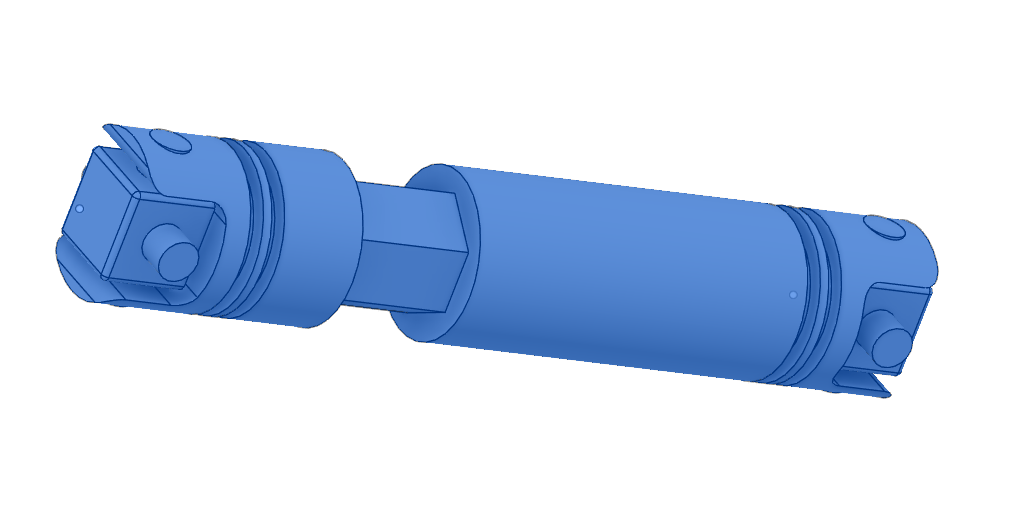

Wow Trevor, that's amazing! I wish I knew how to use Sketchup, then the drawings would be extremely useful to but, but alas, I am a Tinkercad special
I have found this on the net, I think I might be able to construct something similar in Tinkercad and use it as the hex part would be made to slide in and out of one another. Any thoughts on if this would work? Please
The second picture is the same part but without the ends on.

To answer can I seperate the components into separate stl files? Yes. I create the drawings as a single file for the whole model, and create each component separately within that file. Each part is saved in the software as a "Component". That stops them being altered when you alter something else. You can also go back and alter each component - and only see the component you are changing while you edit it. Then all the components can be seen as a whole - just like an assembly drawing. That helps to make sure they fit together properly.
I will prepare the stl files and put them in the files section. Just be aware that it isn't quite ready to print - but I will get it ready to share. It might take a couple of days!

I think that sort of coupling could be made to work. I would prefer a square shaft in that I think the 90 degree angles would be less likely to bind under load than 60 degree angles on hex bar.-steves- wrote: Mon Nov 13, 2023 10:29 am Wow Trevor, that's amazing! I wish I knew how to use Sketchup, then the drawings would be extremely useful to but, but alas, I am a Tinkercad special
I would make the pins in the flexible part from metal. Otherwise just try it! Nothing ventured nothing learnt.
