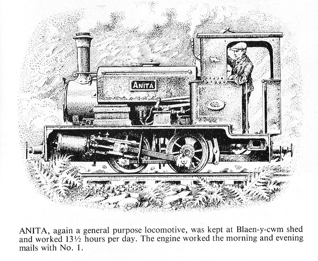

Over the weekend, I made a trip to the Etruria Bone and Flint MIll in Stoke to see their beam engine in action. Whilst there, I picked up a couple of books - one entitled "Stone and Steam in the Black Mountains" by David Tipper. It outlines the building of Grwyne Fawr Dam and Reservoir which included the construction of a three foot narrow gauge railway to serve the construction site. Interestingly, the railway was built along an existing roadway (a bit like the Darjeeling Himalayan Rly) and so had quite tortuous gradients (inc 1:9).
The writer doesn't include much info about the locos and stock but there is a very fine drawing of one of the line's original locos - Anita - which I'd love to model
Any ideas? It does look a bit Hunsletty, but I might be wrong.

I think it looks like a Manning Wardle F Class, although the dropped footplate under the cab is a bit odd. However the F class were standard gauge, so if this one was narrow gauge, maybe it was modified at the build stage, MW did do special orders on occassion and they did a range of classes that looked very similar - the H Class for example..

philipy wrote: Mon Jul 31, 2023 8:15 pm I think it looks like a Manning Wardle F Class, although the dropped footplate under the cab is a bit odd.
I thought it looked like a Manning Wardle as well, great minds think alike......
I found it listed in Fred Harman's book 'The Locomotives Built by Manning Wardle and Company, Volume 1, Narrow Gauge'. Builders no. 1630 was classed as a 'Special' and there's a builders photo in the book, but no G/A. The drawing Rik found isn't particularly accurate, as the proportions are screwed up, especially below the footplate.
Delivered in 1904 to the Elliot Metal Co., who had a copper smelter in Burry Port. Sold after 1912 to the Abertillery & District Water Board. I would assume that the smelter had some clearance issues which is common with such places and the dropped footplate was used to reduce the overall height of the loco.

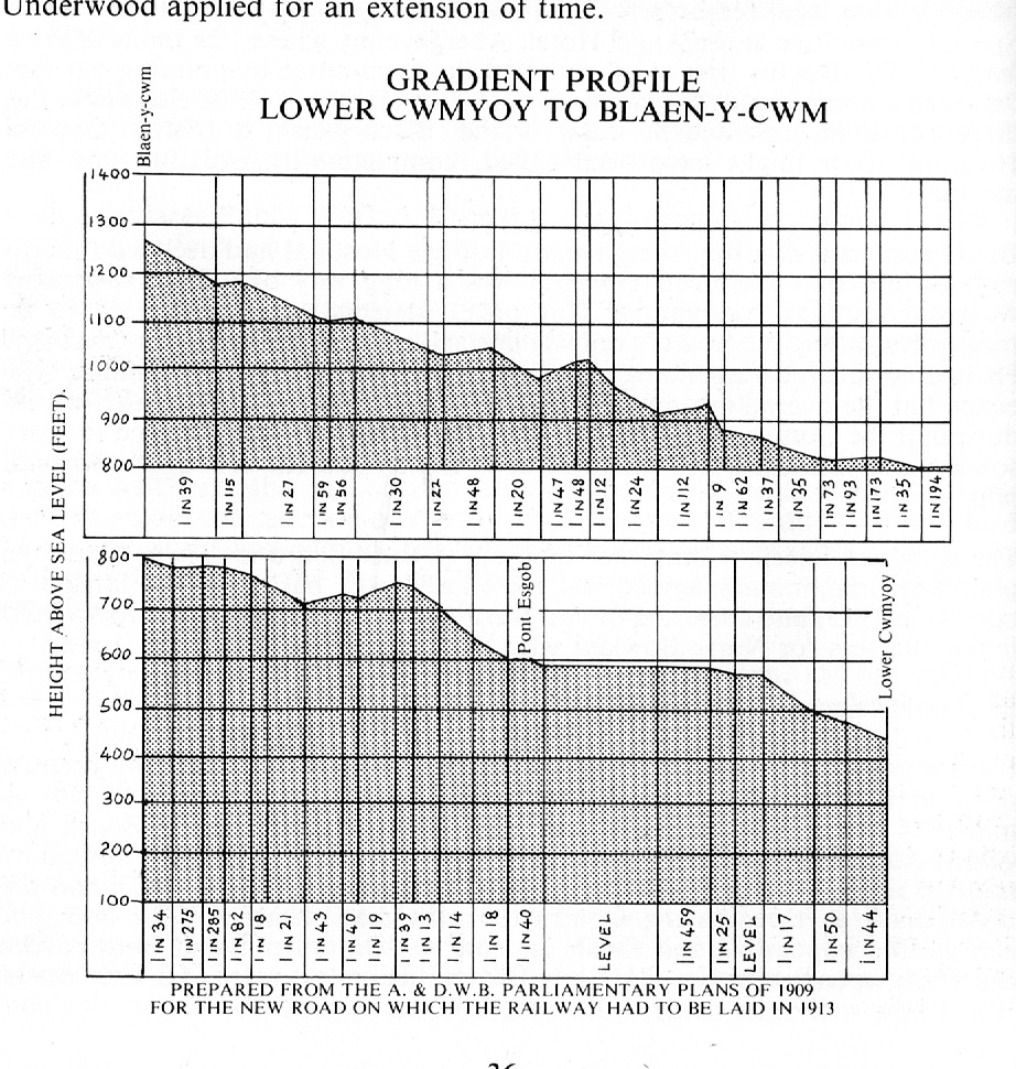

Judging by the gradient profile for the line, the drivers will have had their work cut out.
gradient profile.jpg (393.2 KiB) Viewed 62144 times
Apparently, there was a sharp curve at the foot of the one in nine gradient, just to make life interesting.

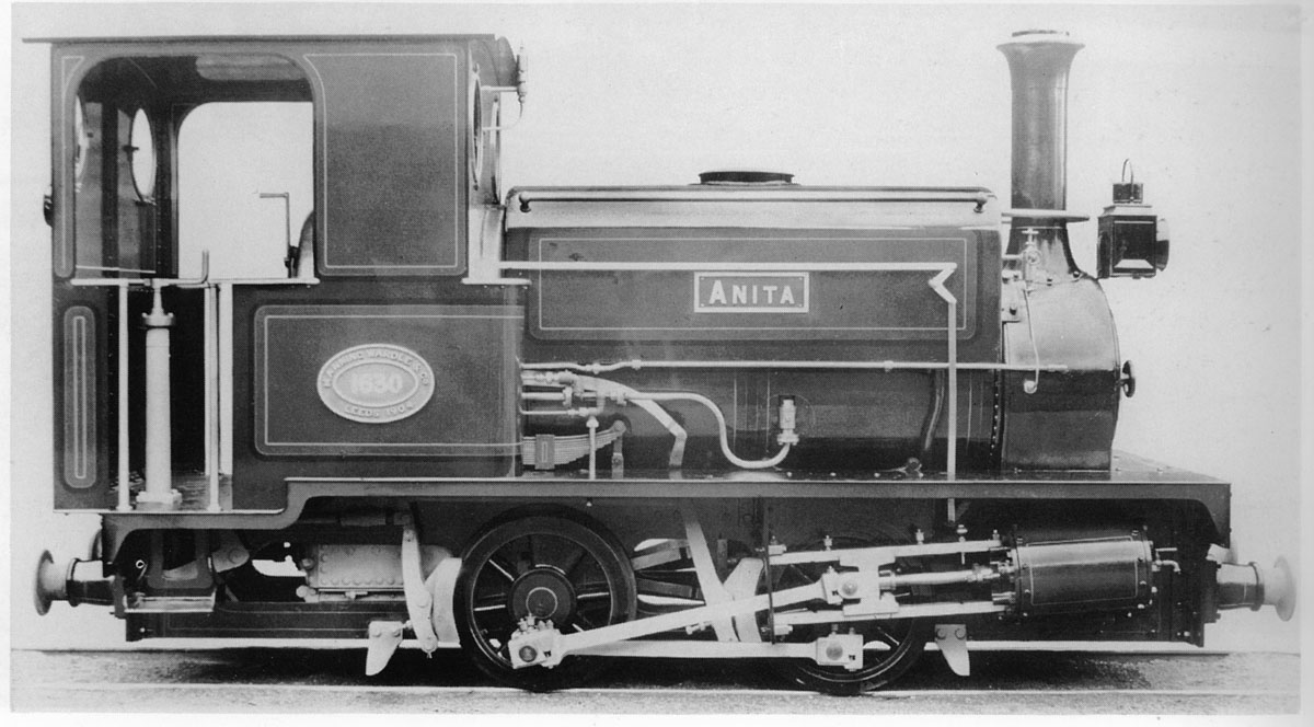

I wonder if this is a close match to Anita
https://transportsofdelight.smugmug.com ... i-BPbmmKB/
PS - Actually, the builders plate says its build number is 1630 and the caption says it was delivered to Elliots Metals ..... :thumbup:

Post by philipy » Tue Aug 01, 2023 8:31 am
ge_rik wrote: Tue Aug 01, 2023 7:57 am I wonder if this is a close match to Anita
Actually, the caption also says that it was delivered to Elliots as ANITA :thumbright: So that is definitely your baby!
All you need now is to track down the works drawings. :lol:

In the absence of any drawings, I'll have to go off this photo.

Using the builders photo, the wheelbase scales out at just over 4', probably 4' 1.5". Height calculates out at 8' 9" and length over headstocks at 14' 8". The wheels aren't the typical Manning Wardle design, but I suspect that what made it a 'special' was the wheel and cylinder size and maybe the reduced height.
The photo is the builders photo. in MW's standard lining, rather than photographic grey.

That Manning Wardle lining's quite something!
I've just noticed a couple of nice details, namely the back of the cab overhanging the rear bufferbeam, and the bufferbeams themselves, which appear to have curved (concave) cutaways instead of straight corners...

Andrew wrote: Wed Aug 02, 2023 8:23 am That Manning Wardle lining's quite something!
Looks like the Steelworks and Abertillery Water Board had retained the lining (if that drawing is to be believed) but it had disappeared by the time the contractors had got hold if it.

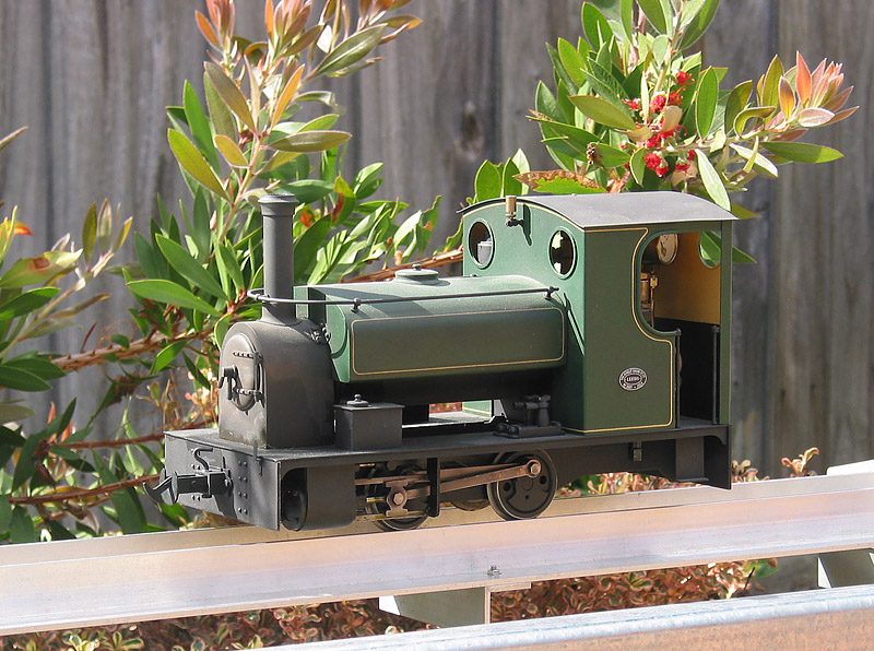

Unlike some builders, if their catalogue is anything to go by, Hunslet don't seem to have made a habit of lowering the cab floor. My Hunslet is about the same size as Anita and is based on one used on reservoir building contracts.
