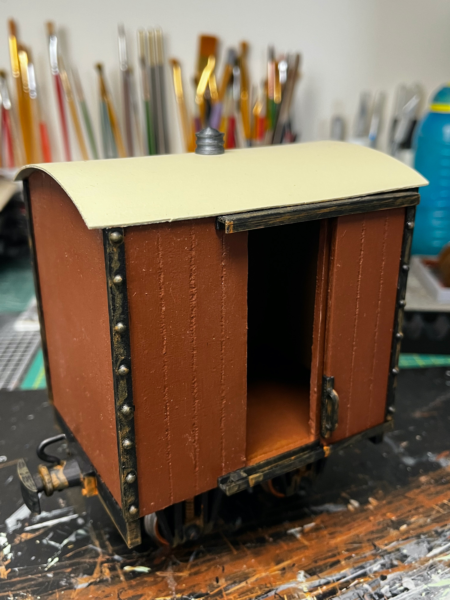

There was something I complete missed of course, how the heck do the railway workers get anything into the van. Now I could have just put some straps on and put a handle at it would have passed looking like it had someway of loading things, but me being me thought that wouldn't do. So out came the 3mm drill bit and drilled a series of lines along were I thought was the middle. I did measure it.... Then out came the little saw and cut through the remaining wood and smoothed off with sandpaper. It turned out ok I think.
The ironmongery was then 3d printed along with the door handle plus the roof vent Also little gem art were then glued on and a little bit of weathering and the van is finished.

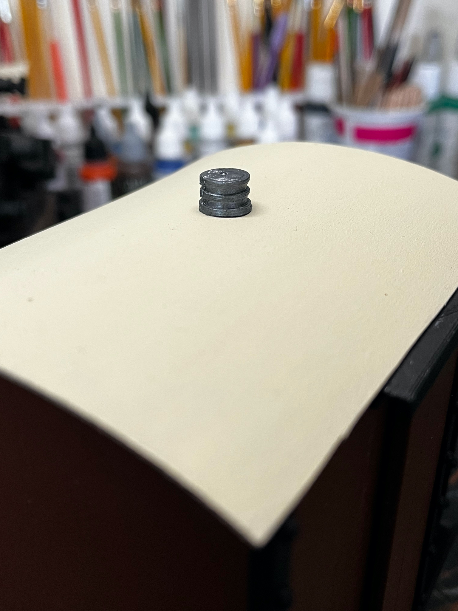

It is a little bit light, tried it going over the bridge and around the very tight curve on the right of the line and it kind of stubbled.... a lot.....So some lead will be added underneath and then hopefully it will be ok.
