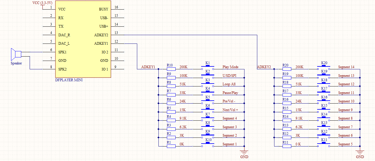

Better value is the DF Mini Player - £3.50 off Amazon (or less than £2 from China on eBay)
https://www.amazon.co.uk/AZDelivery-PCM ... 9hdGY&th=1
DF Mini.jpg (58 KiB) Viewed 108871 times
Although it is often advertised as compatible with Arduino etc., it can play MP3 and WAV files with just the addition of a couple of buttons. If you add a few resistors to the buttons you can also get it to play particular tracks. See
https://wiki.dfrobot.com/DFPlayer_Mini_SKU_DFR0299
DF mini buttons.png (35.94 KiB) Viewed 108871 times
DF mini resistors.png (56.53 KiB) Viewed 108871 times
It has an output of up to 3W with a 4 ohm speaker. I used it in one of my experimental Bluetooth / Arduino builds and this is what it sounded like without any additional amplification. I think it's plenty loud enough for a garden railway loco.
I've not played around with it for simple rx triggers, push button or reed switch operation but it should be quite easy to use.
