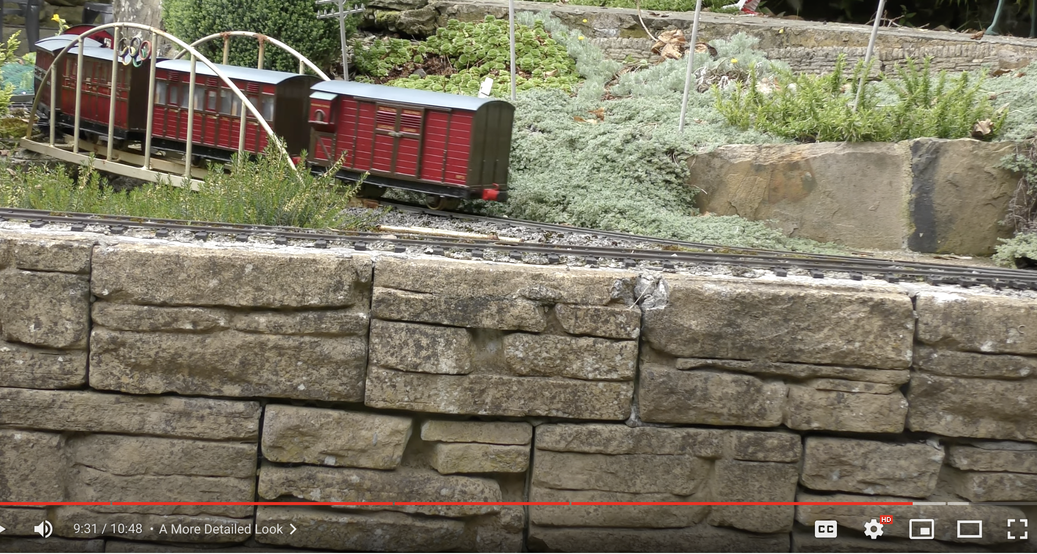

I see this one is straight on top of the wall - presumably with some sort of track bed though?
https://www.youtube.com/watch?v=TLC89SrSBwM (9 mins)
