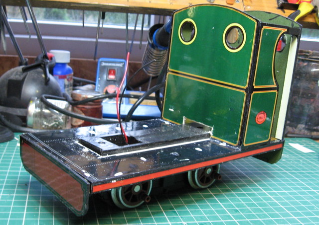

Re: Cardboard Hunslet
The first objective was to find a more powerful chassis. So, I turned to a favourite of mine, the LGB ToyTrain 'Otto' motor block.
This, as you can probably see, has been lounging in my bits-box for a long time. It needed new wheelsets as the worm wheels were worn out. The wheels have been recycled (geddit
) from another clapped out motor block.
It was cut down and the running plate butchered to make it fit.

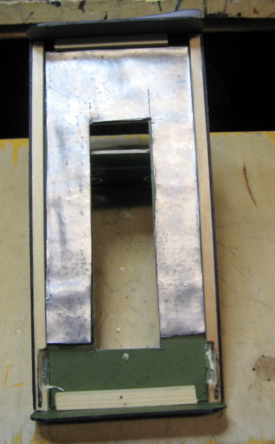

At this stage, I knew I'd have to add some lead ballast and so cut out an appropriate chunk of lead flashing to fit beneath the running plate.
More will be needed and so, once I've fitted all the gubbins inside the body, I'll cram as much as possible elsewhere.

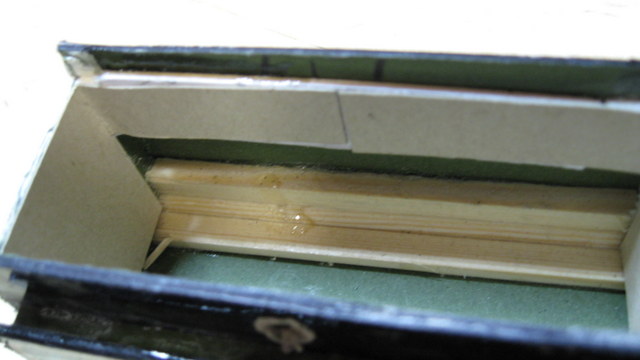

The body was stiffened by adding more card bracing and some extra thin tabs. It's now feels a lot less flimsy.

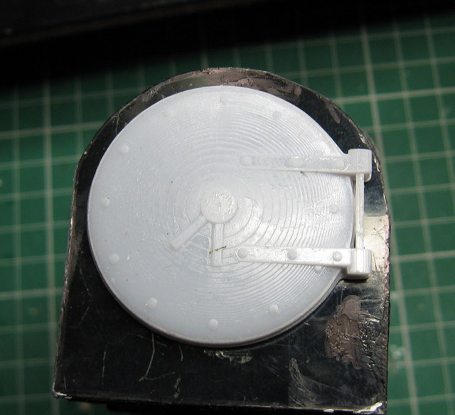

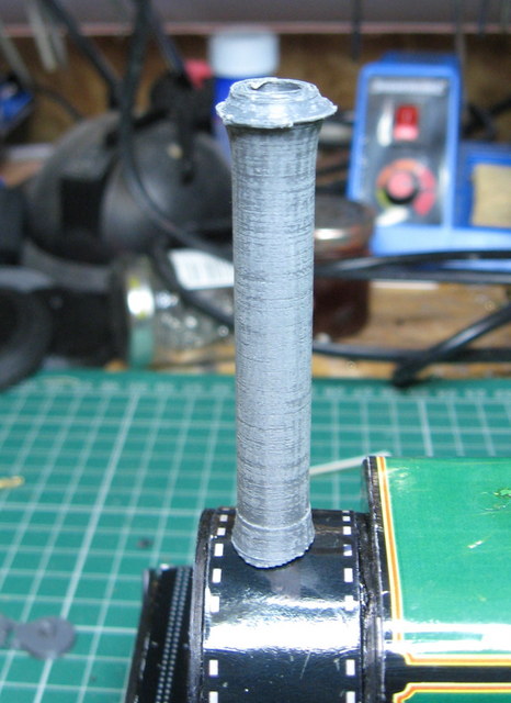

I'm now in the process of 3D printing some fittings. A new chimney...

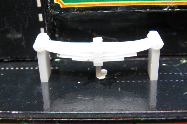

.. some new springs......
.... a tank filler .....
..... and a smokebox door.
Not happy with the smokebox door. If I print it on the FDM printer, I get more detailing but the dome on the door is too stepped. When I print it on the resin printer, the stepping is less obvious but the detailing is somehow flattened as well. I'm redrawing it to exaggerate the detailing.

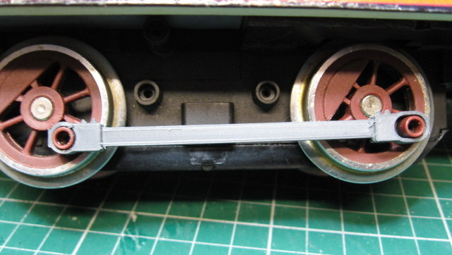

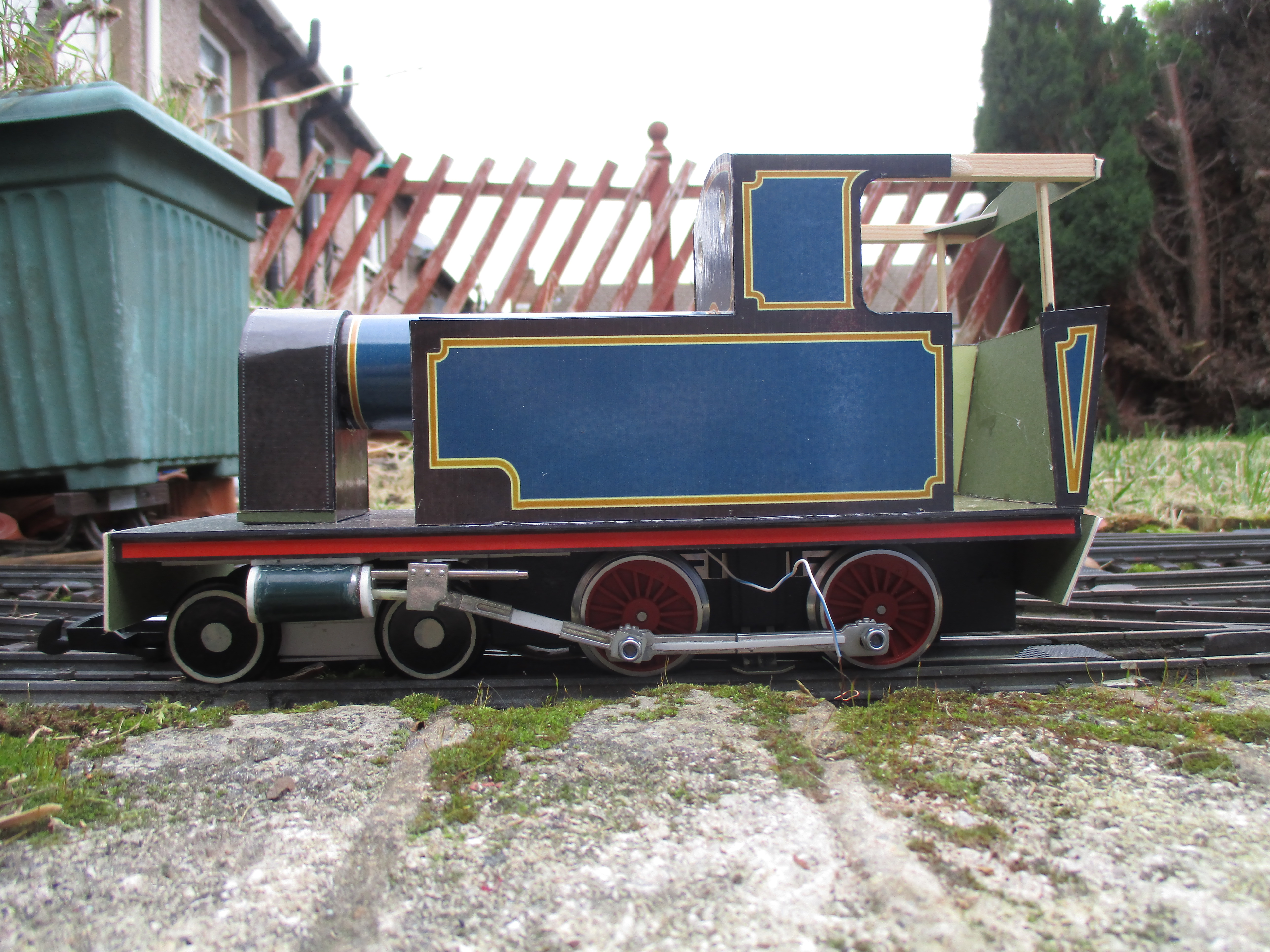

I'm also working on the motion for the motor block - which was missing.
New coupling rods....
..... and cylinders. I'm going to make the slide rods, crosshead and piston rod from metal. I'm not sure how robust they would be 3D printed.

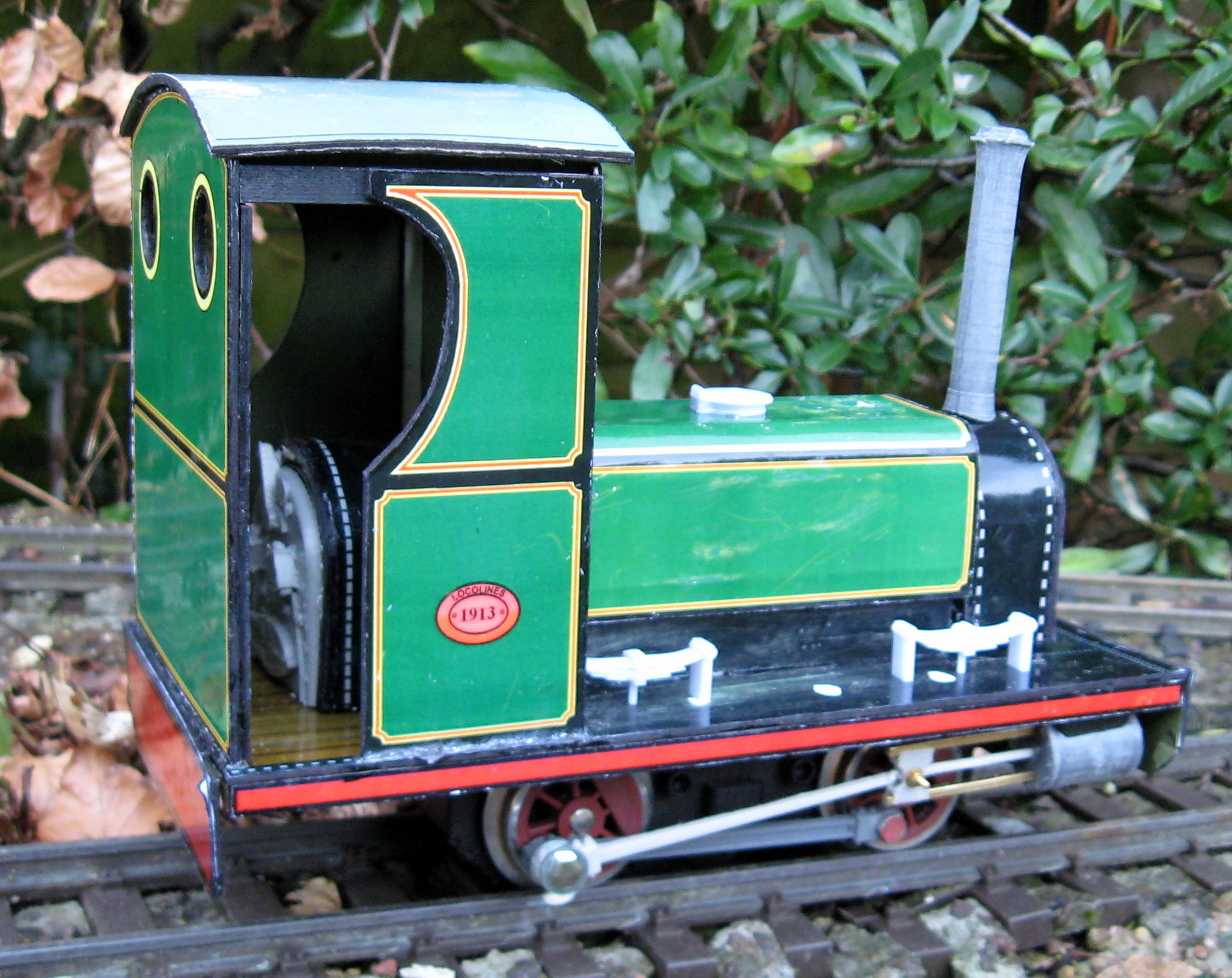

Been spending a bit of time working on the motion. Not quite finished it yet, but at least I know it works.
Not glued the fittings in place as yet. Waiting until I've got them all done.

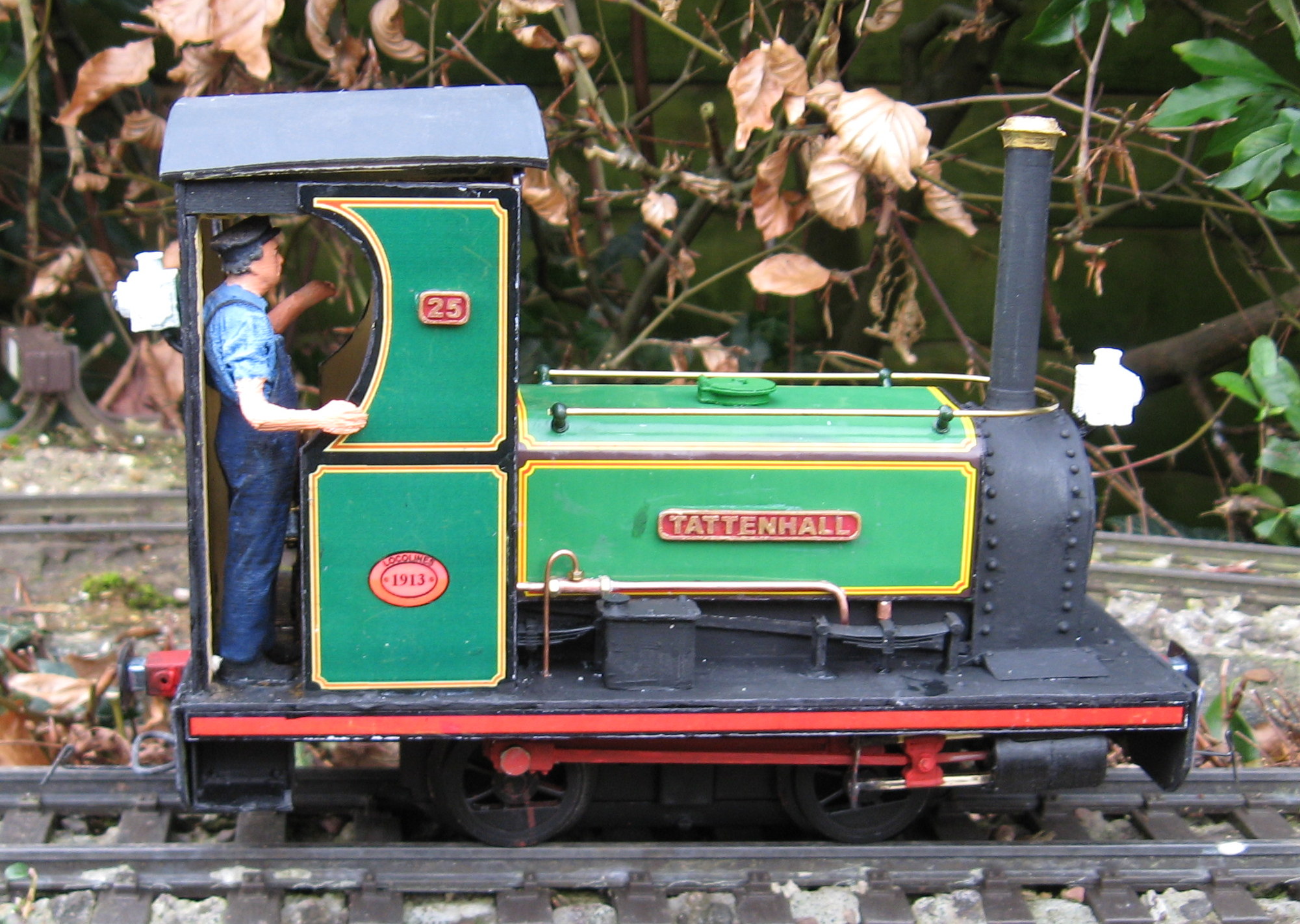

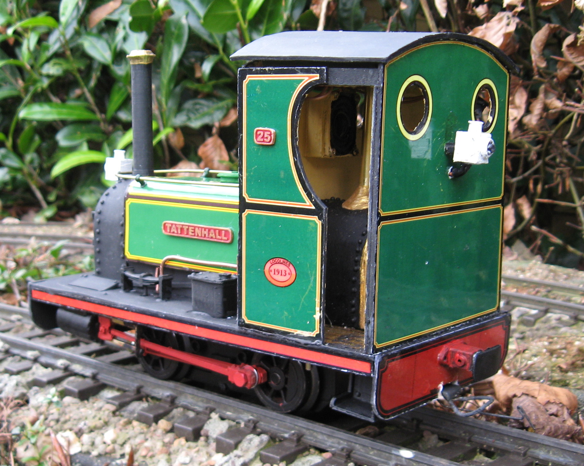

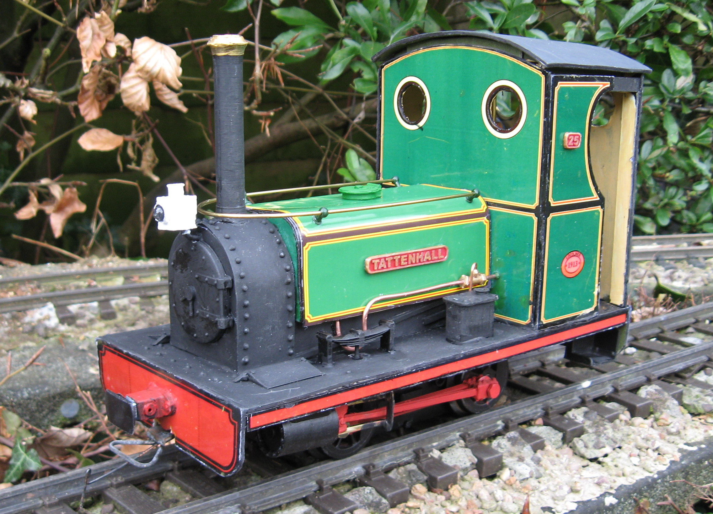

Now almost finished. A fair bit of additional detailing and fitted out with Micron RC and a MLS soundcard.
The roof hasn't been glued down yet - I need to tweak the sound settings a bit more (the chuffs need to be better synched) - the soundcard is under the cab roof (an early one with preset pots for the settings). The video reveals there's too much empty space under the running plate and she needs a whistly on the roof - but almost there.

On the plus side, card is easily worked and glued but, because the mounting board used in the kit is white, the white edges show through as soon as the loco it handled. It would be better if the mounting board was black. Also, any detailing glued to the card is easily dislodged because the mounting board readily delaminates. I'm wondering if soaking the card in shellac might improve this.
An advantage of card is that the livery can be printed on beforehand and so fairly complex lining can be added. However, the surface is easily scratched and, with the sort of rough handling my locos experience, I can see it becoming quite tatty very quickly. Maybe several coats of varnish will help to protect it???
