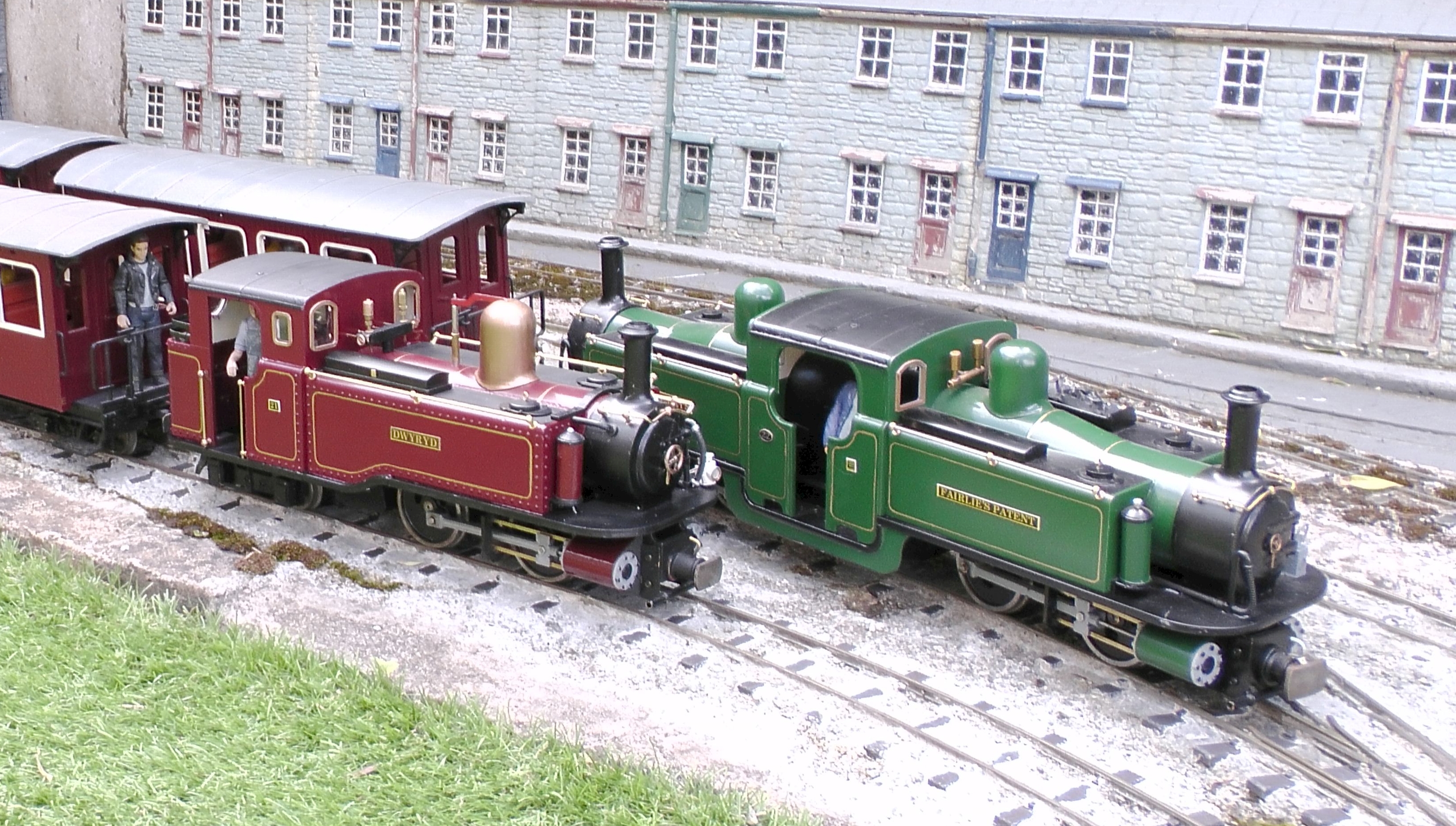

- MRail
- Posts: 118
- Location: Merseyside, UK
Re: PDF single Fairlie
Yes, we do get there eventually!
[attachment=0]MR200802-001.jpg[/attachment]
- Attachments
- MR200802-001.jpg (3.64 MiB) Viewed 18833 times
Rob G
Madog & Mersey Railway (SM32)

- Posts: 7952
Excellent finish on both locos
Great photos of those lovely locos Rob.
