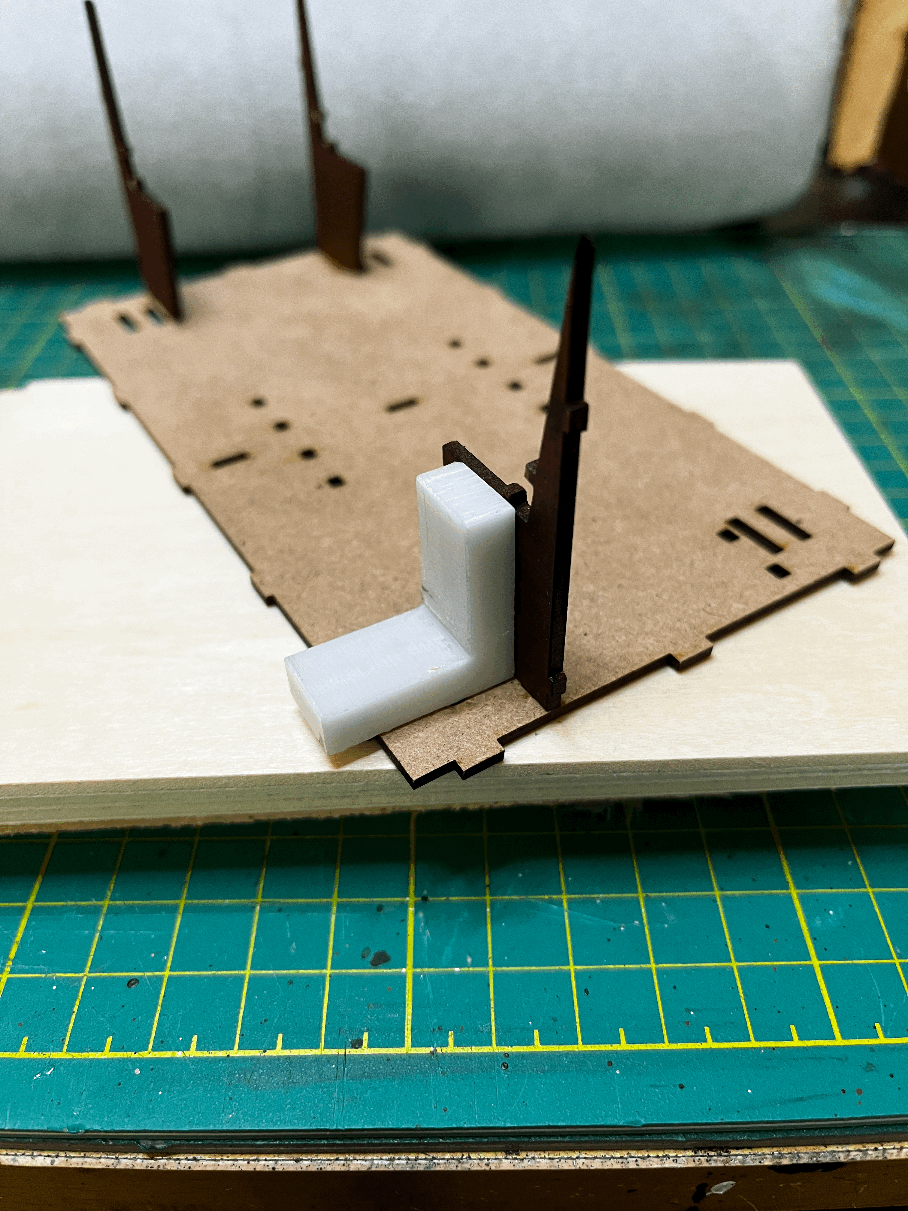

The centre bulkhead of the kit, with the underneath seat's supports fitted.
Has you can see, I have painted them first.
It is important to get the supports at 90deg's, so I used these modellers 90deg thingey-bobs, I have forgotten what they are called :scratch: memory lapsed. :lol:

Let me know if you remember what the right angle thingies are called, they look useful! Might go on my Christmas list...

Andrew wrote: Tue Nov 22, 2022 3:56 pm
They look like 3d printed versions of an engineers square?
Re: Jerry Irwin Kit build for FWLR
Post by Andrew » Tue Nov 22, 2022 7:48 pm
philipy wrote: Tue Nov 22, 2022 4:23 pm
But small enough to fit in a carriage, rather neat, I thought...
I think I've seen some with powerful magnets too, presumably to clamp things squarely while glue dries? I need all the help I can get making things square/straight/parallel...

Post by philipy » Tue Nov 22, 2022 7:58 pm
Andrew wrote: Tue Nov 22, 2022 7:48 pm
It would be easy enough to print recesses to glue a neodym magnet in.

Andrew wrote: Tue Nov 22, 2022 3:56 pm Yes, Happy Birthday Rod!
They are actually ceramic Andrew. I remembered late last night. They are really great because they don’t get stuck if any super glue get on them, I tend not to put too much glue on kits now, mainly because I was always getting my fingers stuck :lol: :lol:
I have 3D printed some myself, but they are no were near has good as the ceramic ones. So I generally only use them if I am PVA’ing something.
I bought them from a show we went to many years ago.

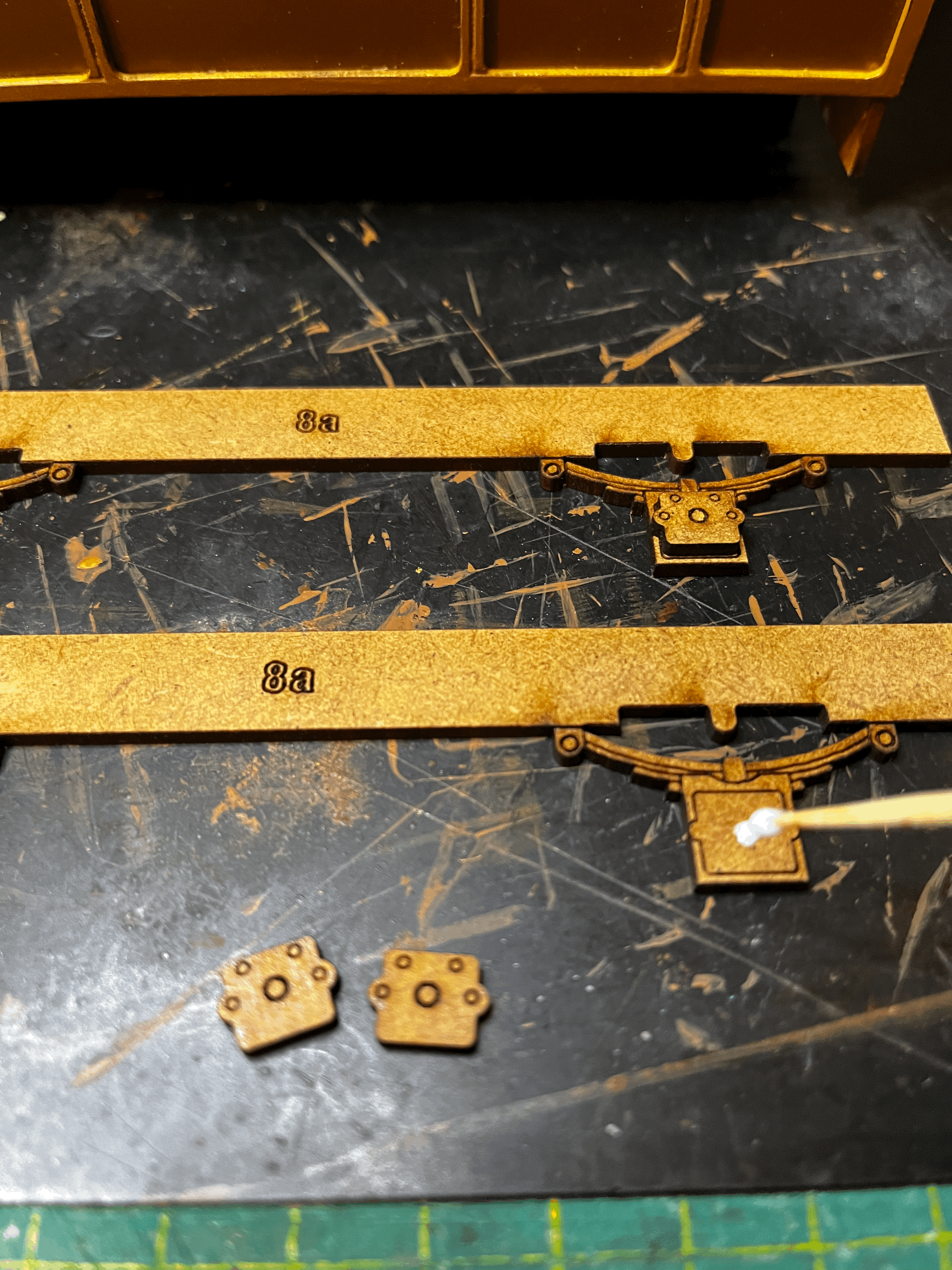

More building of the kit took place after our shopping expedition. Not as much as I would have liked though mainly because I had run out of both ova and superglue. :oops: How does one run out of both types of glue :dontknow: The strikes that have not been helpful either with delays in what people are buying, hoping for their items to be delivered in time for whatever reason they bought the products for.

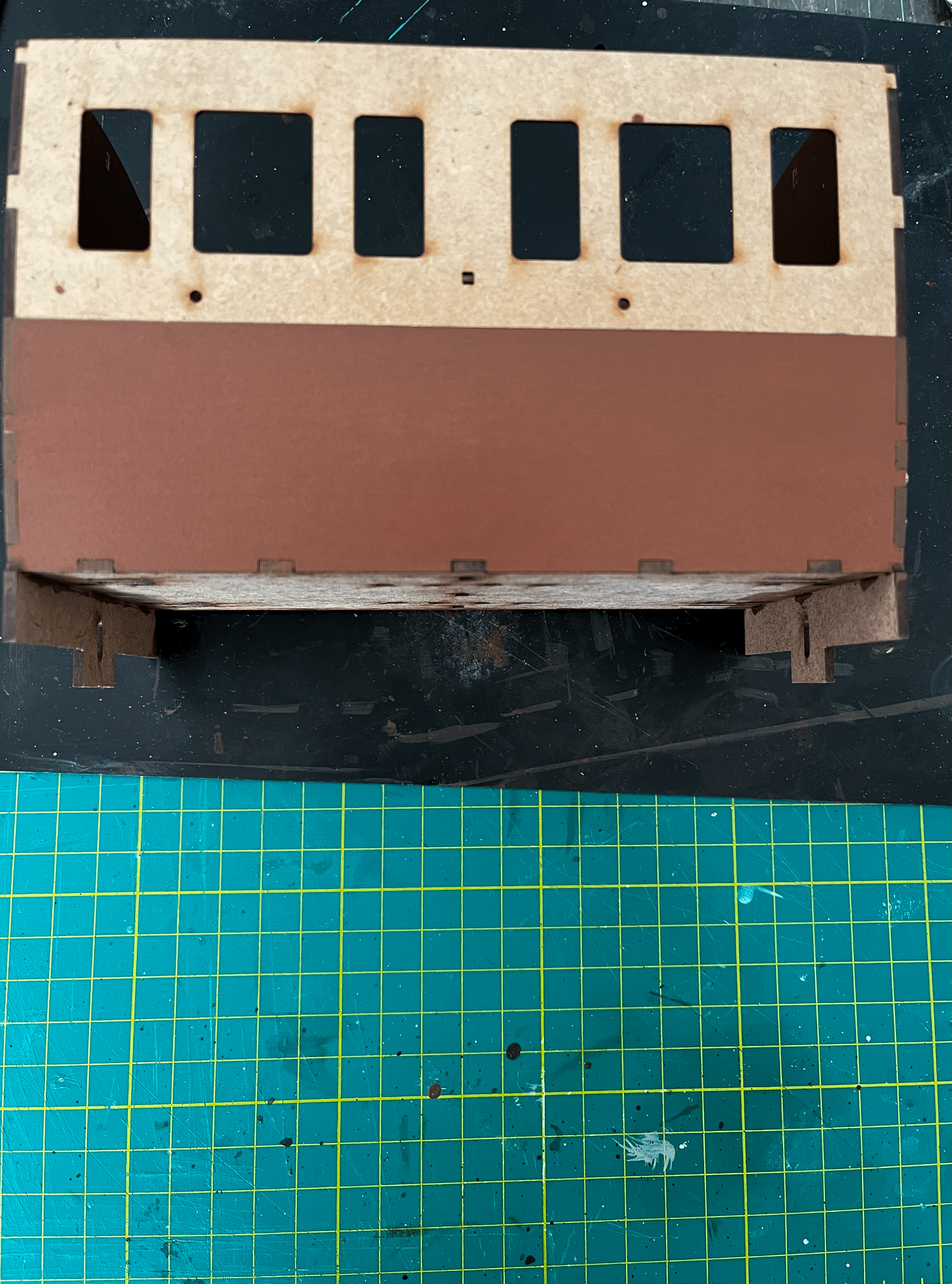

Anyway I managed to get the FWLR colours painted on the body and the overlays, which after some mixing of the brown and I mean mixing, I had forgotten what colours I used for the first time I used the colour combination for the line. It wasn't an off the shelf brown, don't ask way I didn't :dontknow: :lol: :lol: :lol:
I only took a photo of the brown sorry, :oops:
Next was the end overlays. I decided to paint these a slightly different shade of brown than the body of the coach as I wanted it to stand out a bit more and Anne liked it, so that was ok. :thumbright:
Then the side of the coach overlays. These are put on similar to the coach sides, with just the bottom lugs and the three centre ones for which you hold, for a about 10 seconds, then the top of the overlay. I did run some glue along the underside of the piece to help with the strength which will keep it in place. I did put some elastic bands around to also help and kept them there for an hour for the glue to harden off.

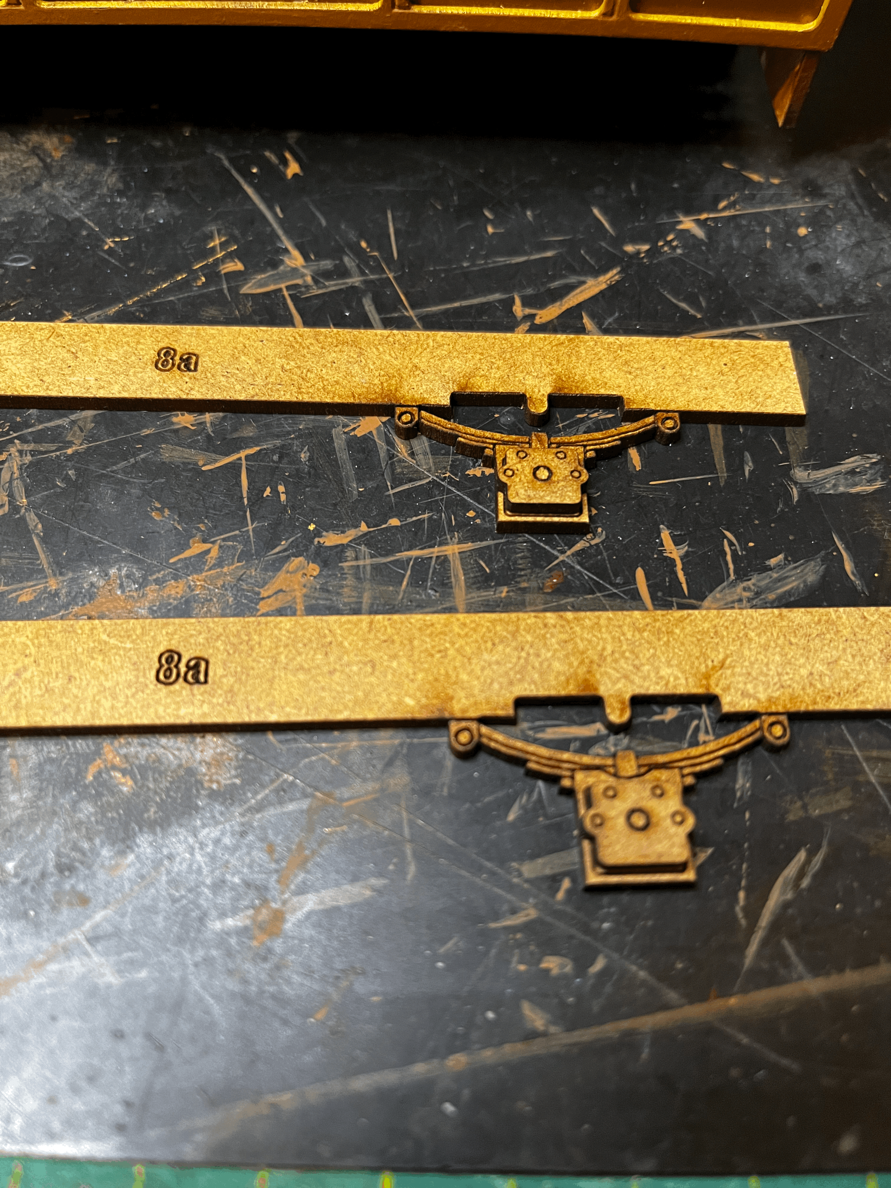

I did paint the inners of the side overlays with gold paint. It helps to highlight them a bit more. But I have to say that was such a long process. I have used those gel pens before and I did like them, but seeing has I had some of the gold paint I went with that. Don't be put off with this though, Jerry's kits are really well made and they do fit really well, without all the hassle of cutting them off bits of board.

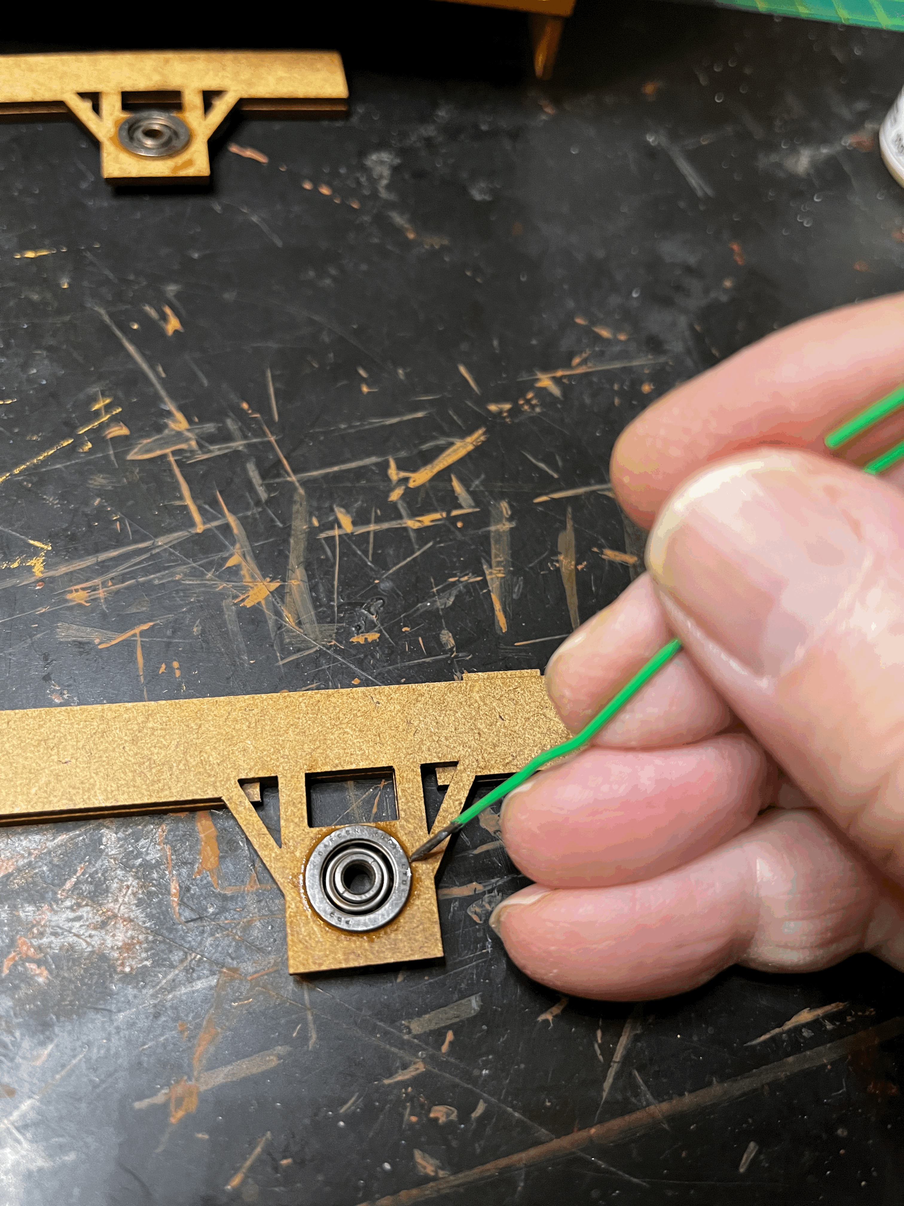

The first thing to put together is the part with the bearings, it doesn't really matter when you do this, but it does leave the glue to soak in and set hard for when you come to fit all the 9 pieces of undercarriage x 2.
I did put all the pieces of the undercarriage in order ie: 1 to 9 on my bench, that's what Jerry ask's you to do and it makes sense, because you can easily get them mixed up. I took the part number 8a for both sides and the four axle boxes and glued the boxes to the side of 8a. Just a spot of PVA glue is needed.
Then get parts numbered 4 and 5, with the 4 bearings. Put the bearings behind number 4 with the writing has Jerry ask's you to do, then put part number 5 to part No 4, you will hear them click together, then put some superglue around the bearings, be very careful here, you can easily put the glue inside the bearing :!: I also put a drop go oil inside the bearings, it makes a little bit easier and you don't end up with oil on the part, which if you are going to paint will look rubbish. I know it's underneath....

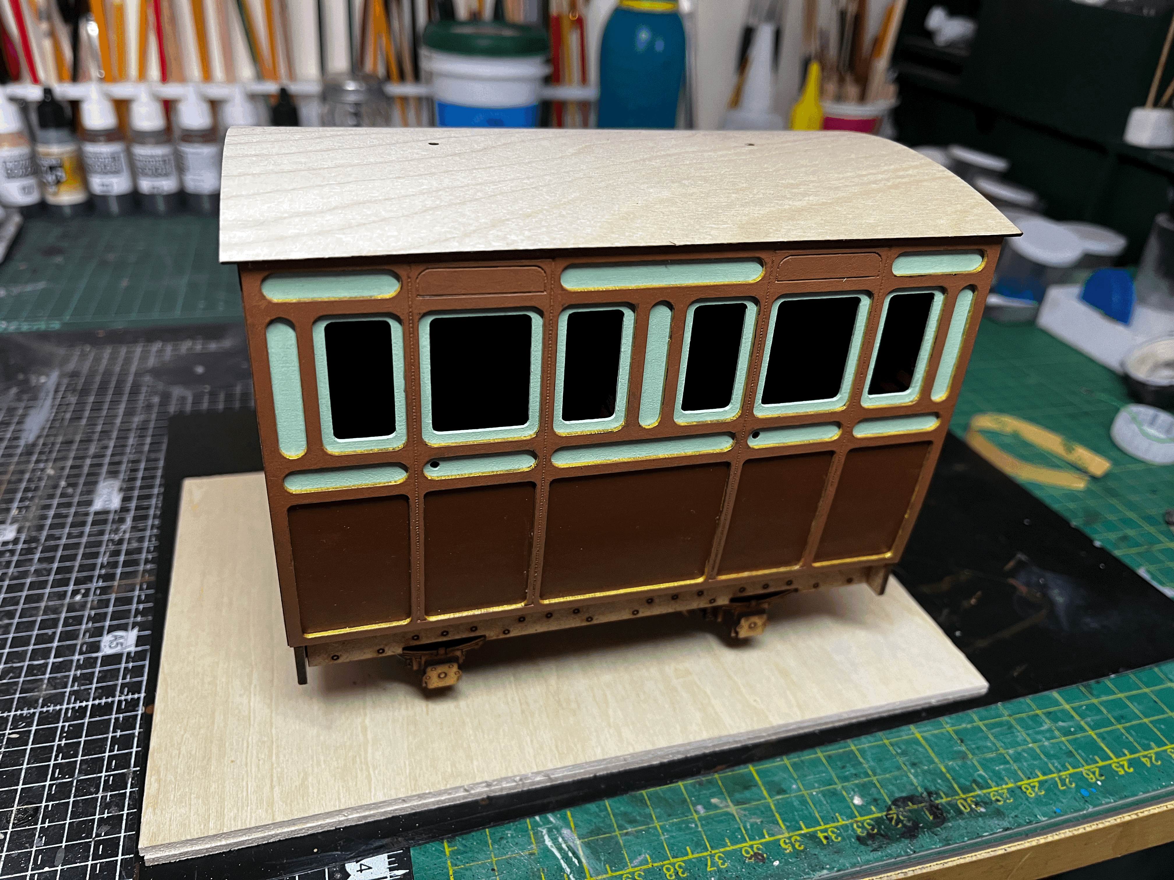

The next job is to fit the roof its self. This is another bit of an awkward job, luckily Jerry has thought about this and at the two end roof supports there are little scribed centre lines for which I forgot to tell you need to be facing outwards when you do the roof supports, because on the roof its self there is also two scribed lines on the inside of the roof to help aline the supports and the roof. You need to put one side on the roof, there are some slightly scribed lines to help with the bend of the roof, then holding the support firmly on the roof, roll it to about half way and put some super glue along the inside edge, this is where the fiddly awkward bit comes into play. Hold it there for about 5 minutes, then turn it around and do the same again. I did put it back into the coach and held it down with some more elastic bands so that it would hold the roof against the supports without leaving any gaps. I also before doing that ran some glue all along the inside of the roof and the supports, I did only put a little dab of the glue on, but you know what capillary action will do :thumbleft:
By the way, in my previous post I said I had snapped off the unwanted bits of the end and centre supports, I did after I fitted the roof has you can see in the last photo here. Sorry :roll:
With the unwanted supports removed after leaving overnight to set. If you did this in the morning of course it you can carry on then if you want to.
With the lights fitted, this is an easy job if you have fitted lights before, you just need to be careful if you haven't because the glue that is on the strip is very strong and if you put too much pressure on while trying to get in-between the supports, you may find it's stuck.
The roof fitted and stained with a grey wash. I find this shows the grain up and because the grain on the bit of ply Jerry supplied looked nice I decided to keep it with the grain. Painting it would look ok, but boring... :thumbright:

Post by Andrew » Wed Jan 18, 2023 12:32 pm
Looking good Rod!
The lighting's interesting - does it come with the kit? Sorry if I missed that earlier in the thread!
