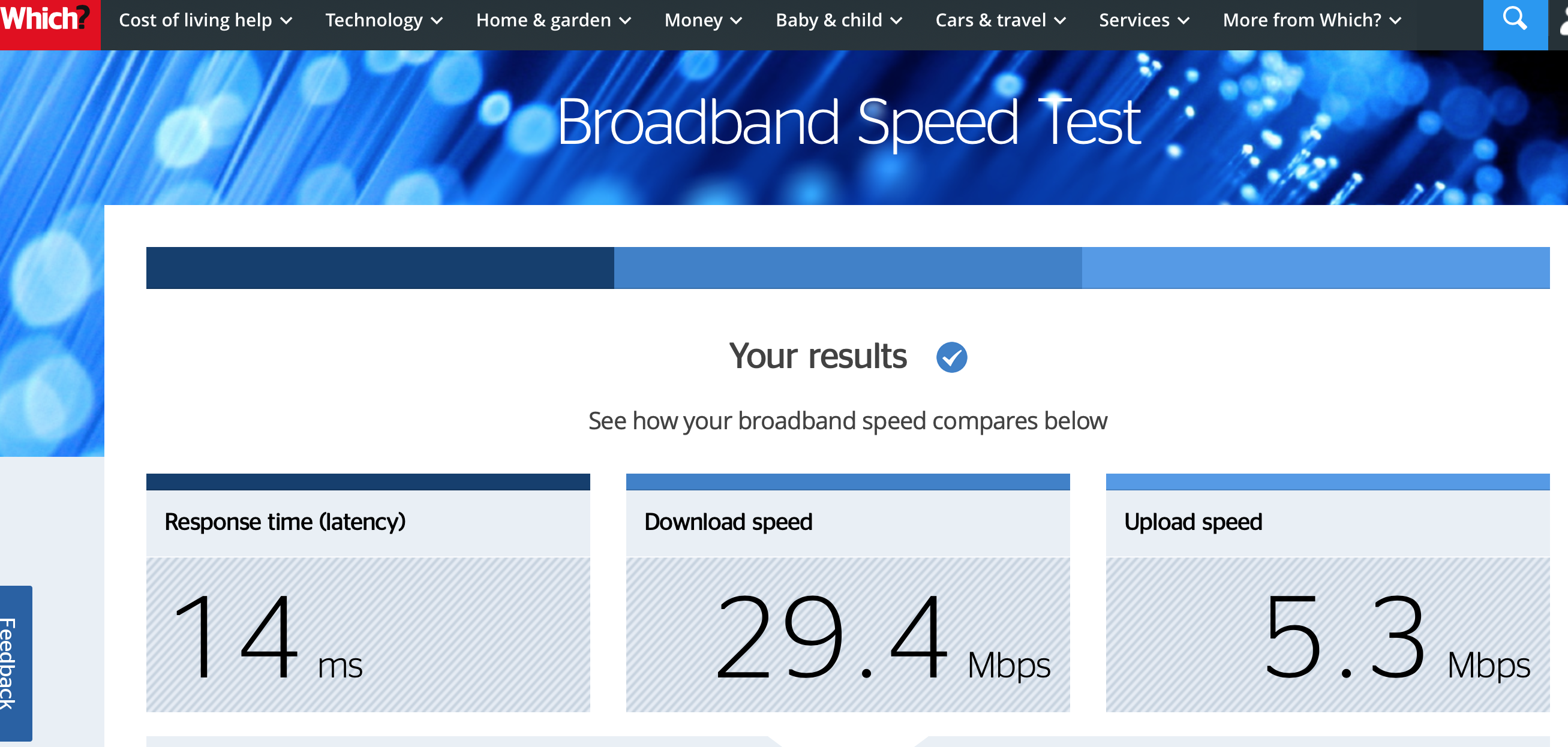

Mmmm interesting this.We have been with BT for 15 years and we still haven't got fibre, all I get when I get in touch with them is, it's due to be installed in the next 5 years.... :roll: Thats been said for the 15 years, I will be long gone before they install it and it also will only be going to the cabinet, so it's not going to be much better than what we get now.
The first screenshot is from www.broadbandspeedchecker.co.uk
The 2nd one is from Which
Not a lot of difference between them. I have looked at Fibre Broadband prices and I am not prepared to pay the silly prices every month for something that I don't really need. We get by with BT's poor service really. Our broadband goes down quite regularly and we have got used to it, but saying that when we moved from our last address, 3 quarters of a mile away, we got nearly 56mbh, strange really even though we are closer to the green box now. There are several green boxes in our area that supply lots of new local houses, that may be the reason who knows :dontknow:
