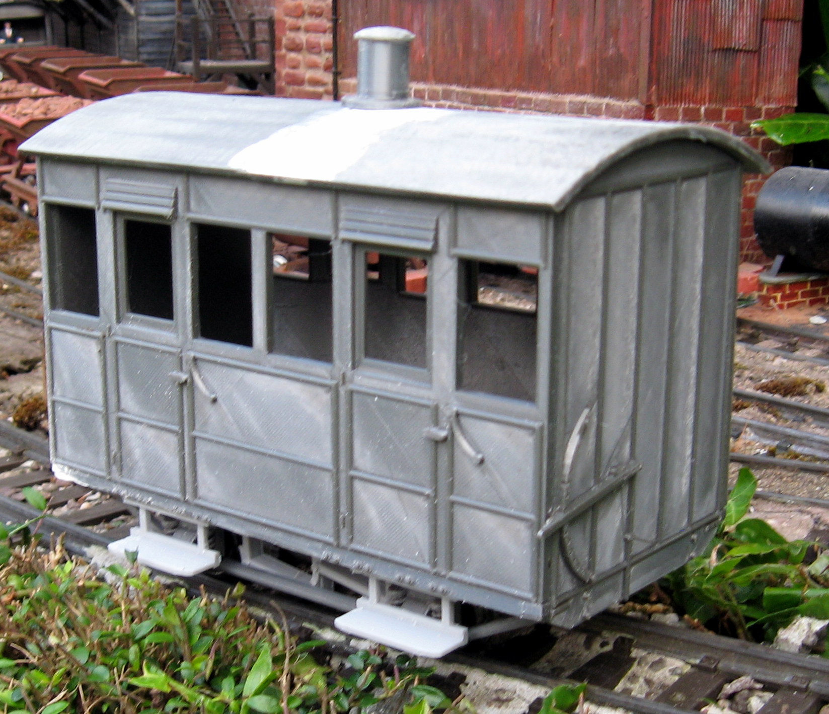

Firstly, a couple of variants of the Southwold Cleminson six- wheeled wagon.
I'm now more or less happy with the design of this (after several trials and tribulations) and so will soon be uploading the files to the 3D files board.

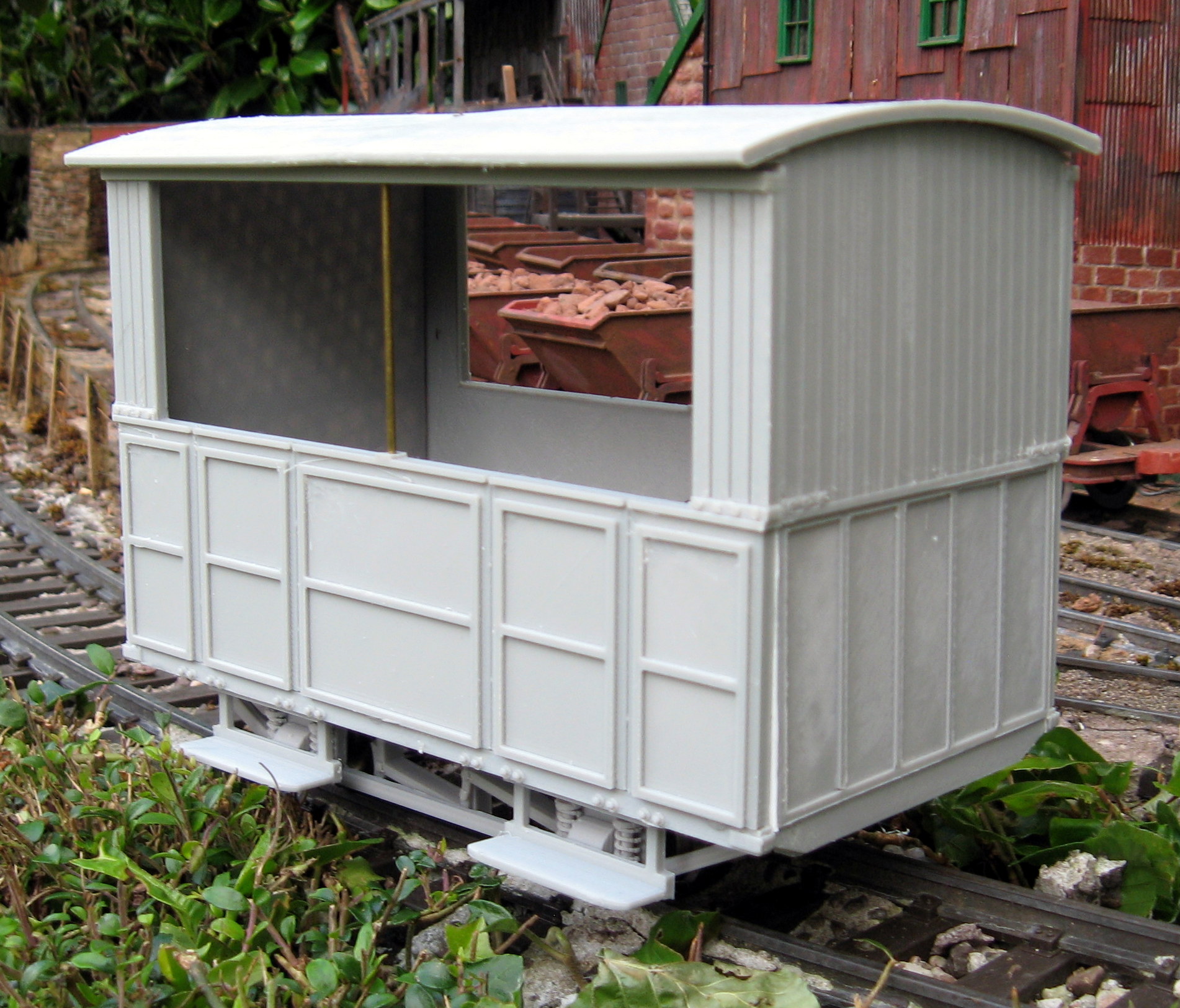

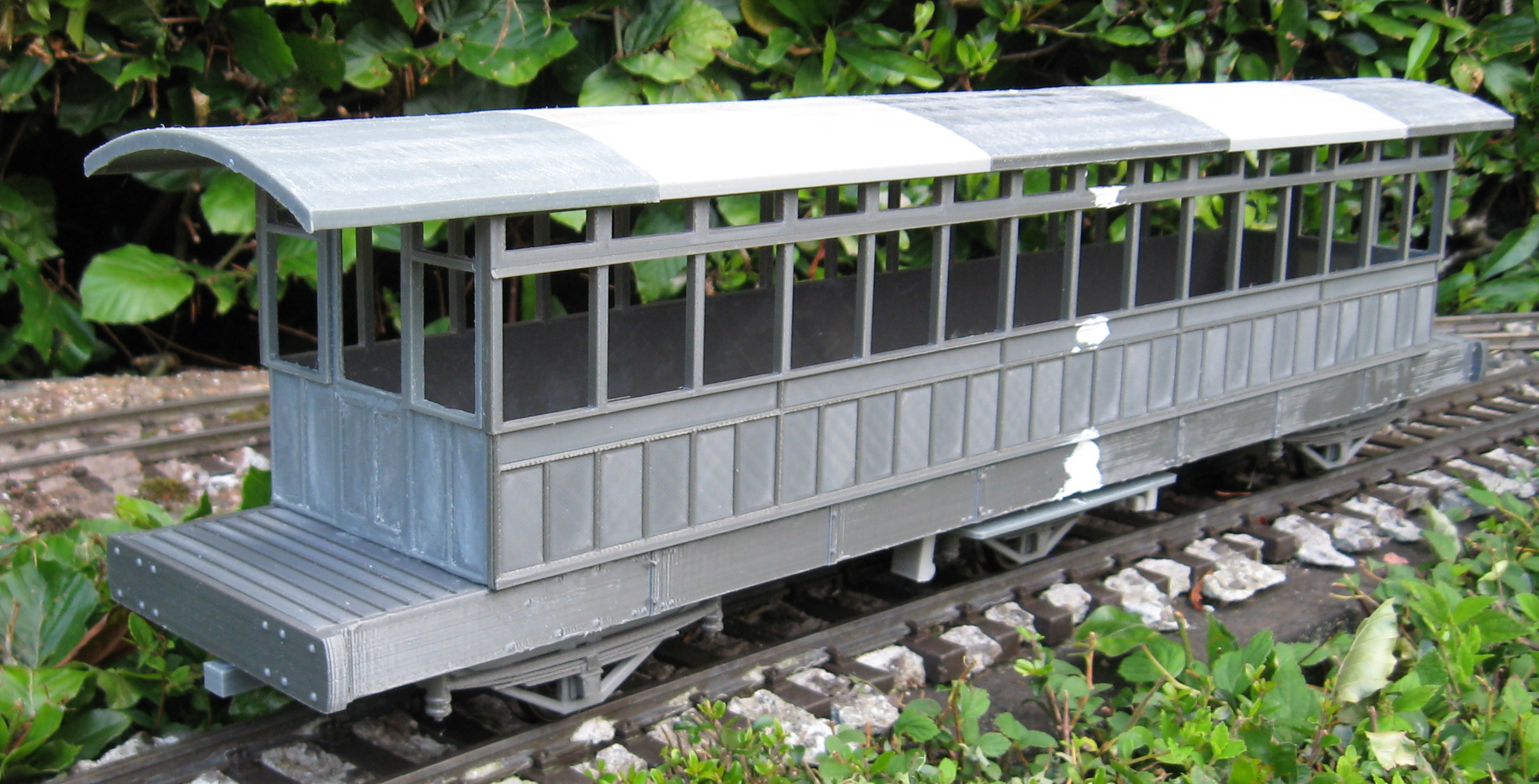

Posted: Wed Jun 15, 2022 7:47 pm
I'm now more or less happy with the design of the Southwold six-wheeled coach. Not a perfect representation but I needed to ensure it could cope with the curves and undulations of an actual garden railway layout. This is the third coach to complete my rake and each one has resulted in a tweak or two and what I hope is an improvement in the design. This still requires a bit more work before it's ready for the paint shop.

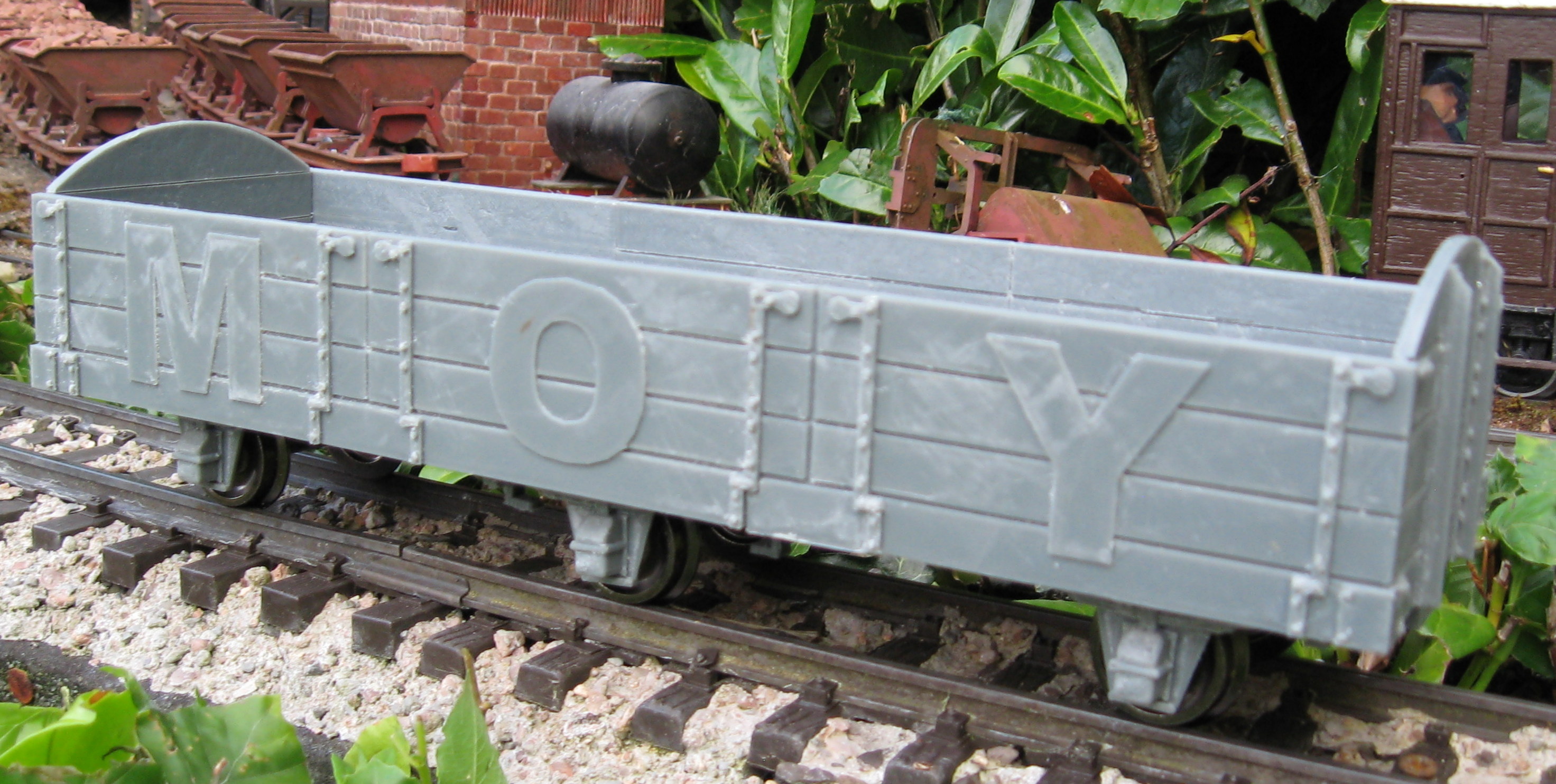

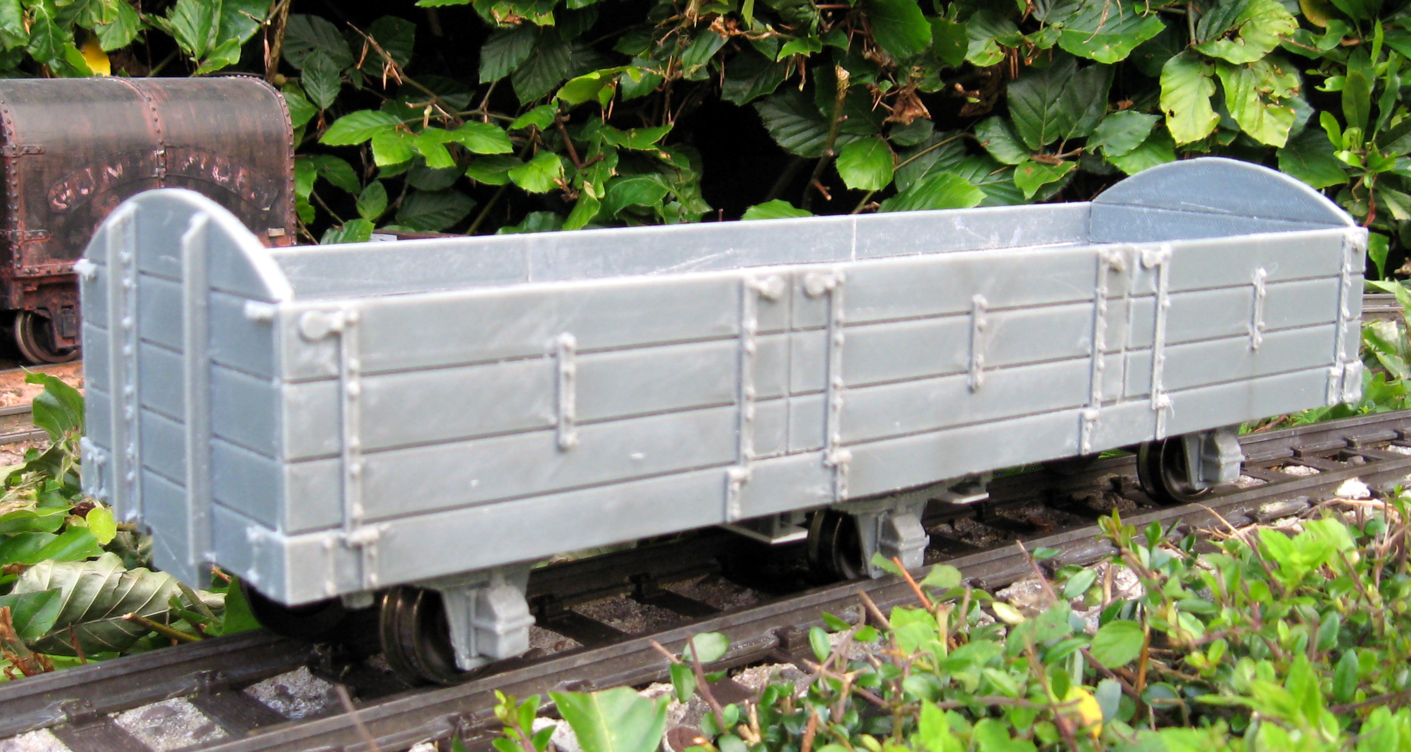

I've also now rescaled most of my 0-16.5 GVT stock to 16mm (and I'm working on 15mm versions as well).
These also will be uploaded to the 3D files section in due course.

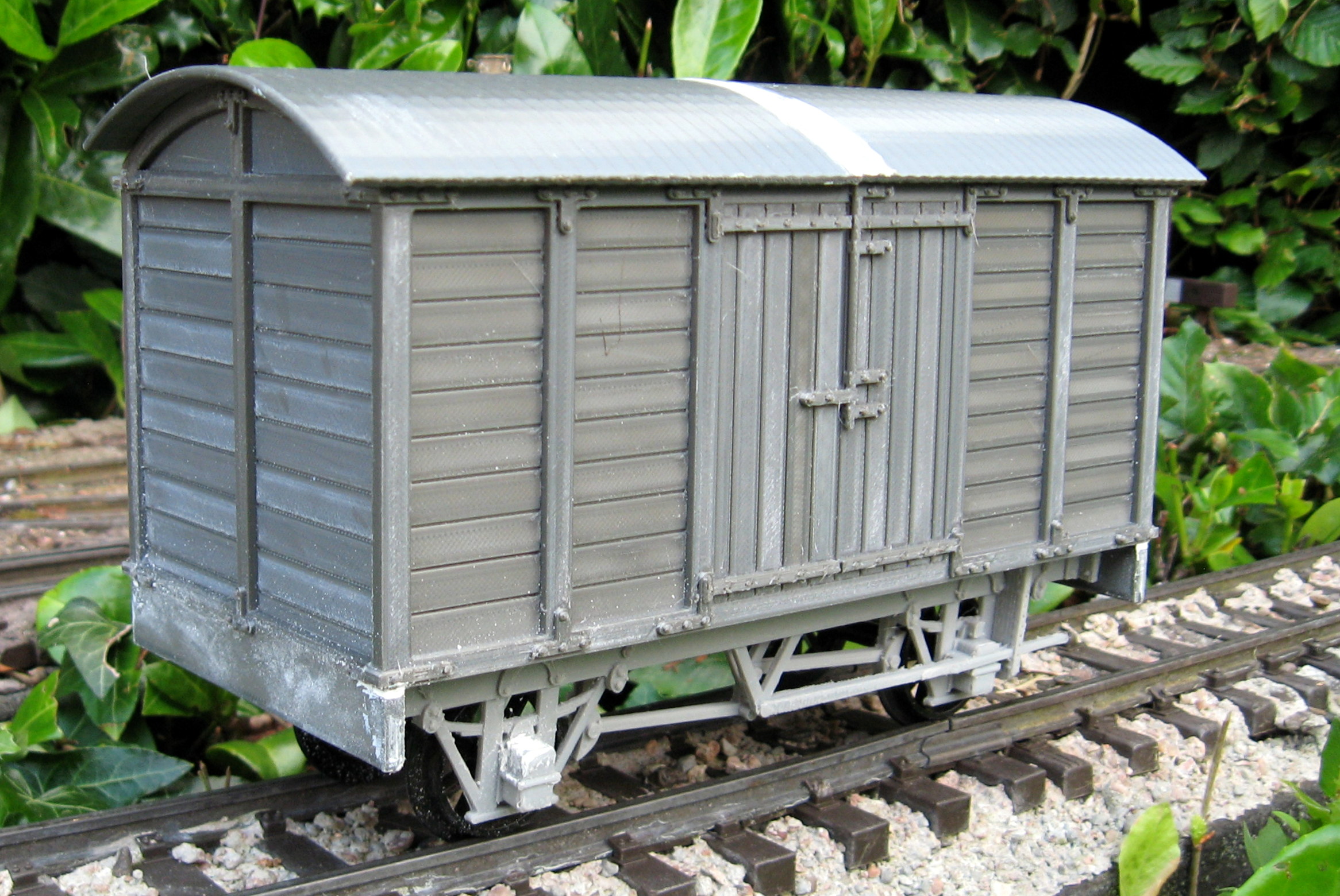

I've also reworked the County Donegal luggage van which was a bit underscale - it was based on just one photo of a grounded body. The Museum in Londonderry which houses one of the vans kindly sent me the key dimensions and so I've now produced a better scaled version of the van.

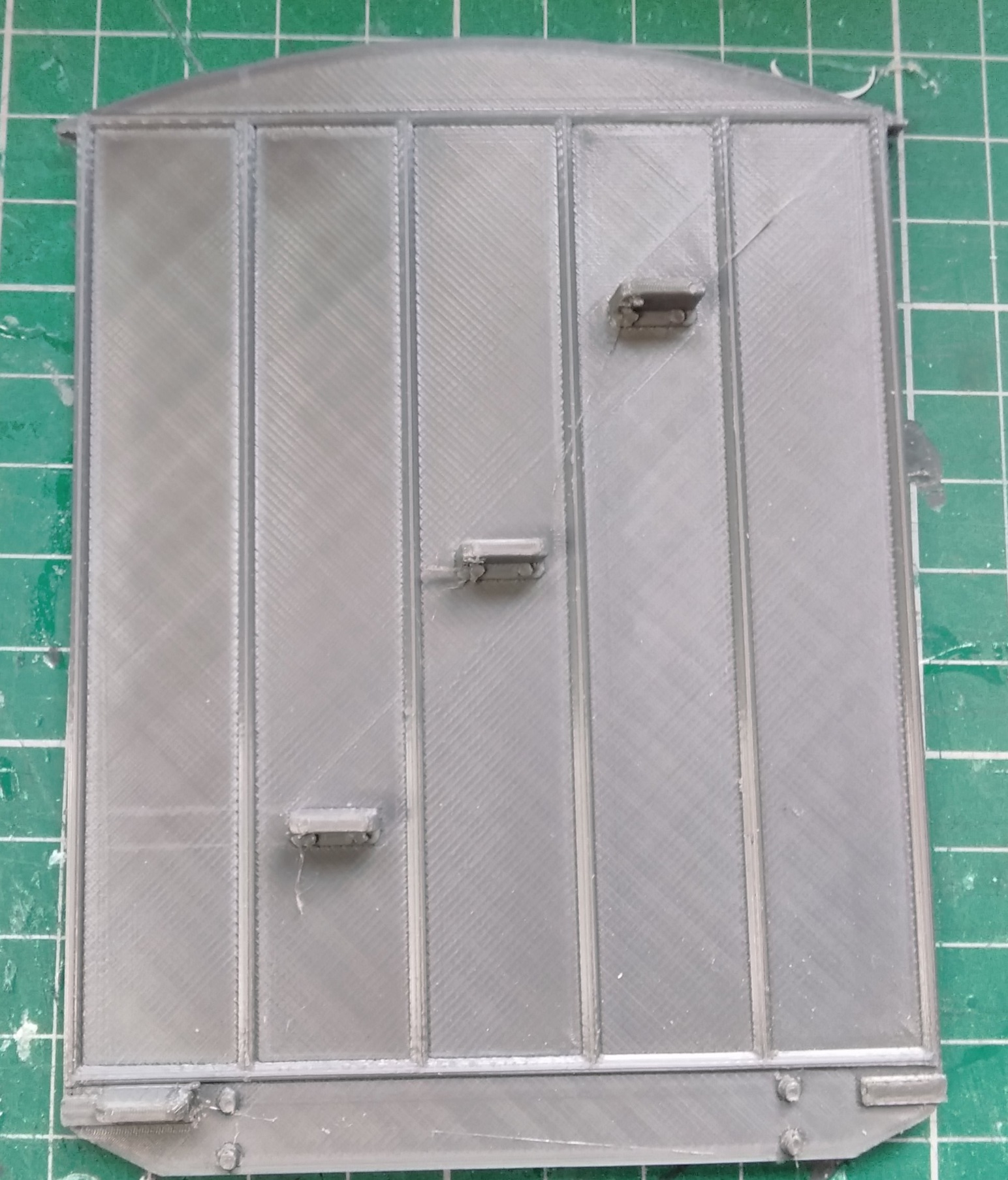

It's much more attributable to luck than judgement. The sides aren't entirely unblemished. I did get some stringing on these prints which I've now reduced by decreasing the hot end temperature from 210C to 200C. The sides in the photos above have been smoothed with a gentle rub from a small piece of Emery. This is how they look straight off the printer.
This is the side without handles.
I was pleased with the spring detail. Again, straight off the printer. A needle file tidied up the stringing.

Have you tried turning on Monotonic Ordering? It might help with the diagonal lines you see where the top infill is broken by an island sticking out of it. It just reorders the lines so they are always progressing in one direction across the layer, barely affects print time but helps with that sort of minor issue.

Not tried that. TBH, I didn't know what it did or what it might cure. I'll give it a try on the next job.
